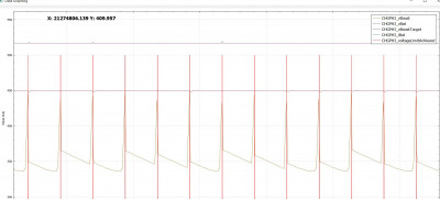

Ok. I've rerun logs using the higher voltage charger. The EVSE is a Juicebox brand with wifi reporting. Watching the related app I'm able to get what I consider to be more accurate charging stats, voltage, amps, etc. Update cycle for the app seems to be in the sub-second range since it reports the HZ of the AC line
Observed Amps: 0.8 amps stable
Initializes and moves directly to .8 amps and holds steady. I've rerun it several times, resetting the board, unplugging charger etc. and get the same results.
SavvyCan527.csvSettings527.rtfSerialLog527.rtf
Please report on accurately I see you mention AC read outs from the Juice box.
So the Juicebox tells you the AC current correct, and this is 0.8 Amps is it not?
Can you please see what it draws when you set the AC limit setting to 10 instead of 5. I might be the stupid command formatting is changed.
Please also do not speculate how values are calculated as all displayed feedback values are purely translated from canbus there is no other math happening. So this looks like an exercises of rescaling/checking all values reported AND sent.

Juicebox shows:
Status: Charging
Current: 0.8 amps (steady, with occasional move to 0.7 amps)
AC Voltage: 247
Next steps:
1. Unplug j1172 plug from socket (juicebox confirms standby and charge amps go to zero)
2. Through serial commands change only item 7. from 5A to 10A
3. Press control board reset button...confirm serial monitor timestamp numbers have started over
4. Plug in j1772 plug to socket
Then Juicebox shows:
Status: charging
AC Volrage: 247

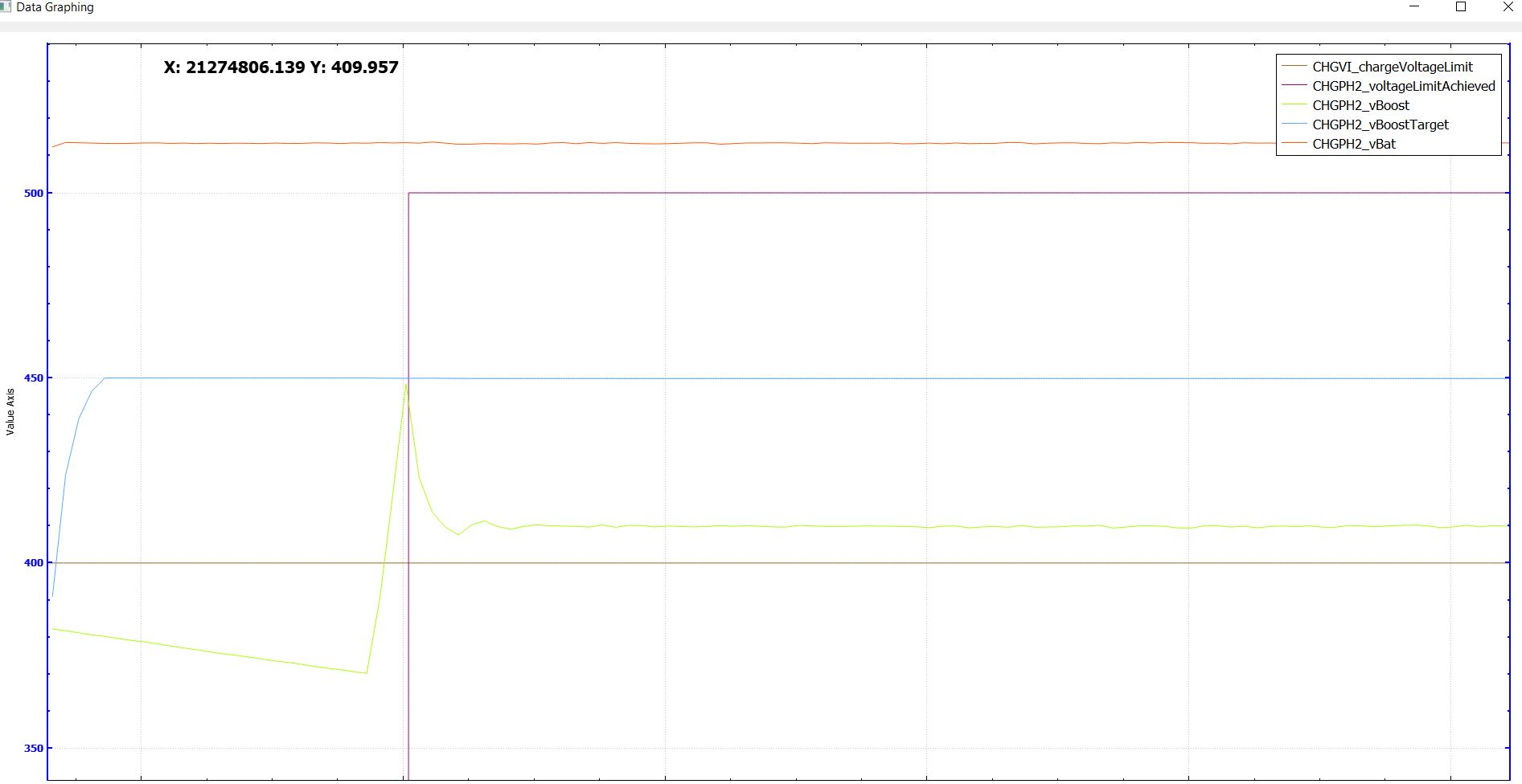

I set item 6. to 550v and termination voltage to 650v.
Reset the board with timestamp starting over.
No change to Juicebox readings.
Status: charging
AC Voltage: 247
In the serial monitor I have never seen the state go to 2. It moves between 0 and 1 as I would expect based on code...but I've not seen it go to state 2.
I believe it is charging...just at the wrong scale.

bulletbug wrote: Wed May 27, 2020 8:54 pm
Status: charging
AC Voltage: 247
I have not seen a can log showing me it is actually charging, no changes in Battery voltage. You mention a few posts back that you can get it to do a 5Amp charge at the beginning of a day got a can capture of that?
I would need to see the reported status transition during that charge session to understand if there is an issue in the setup (grounding ect.) or with canbus scaling.

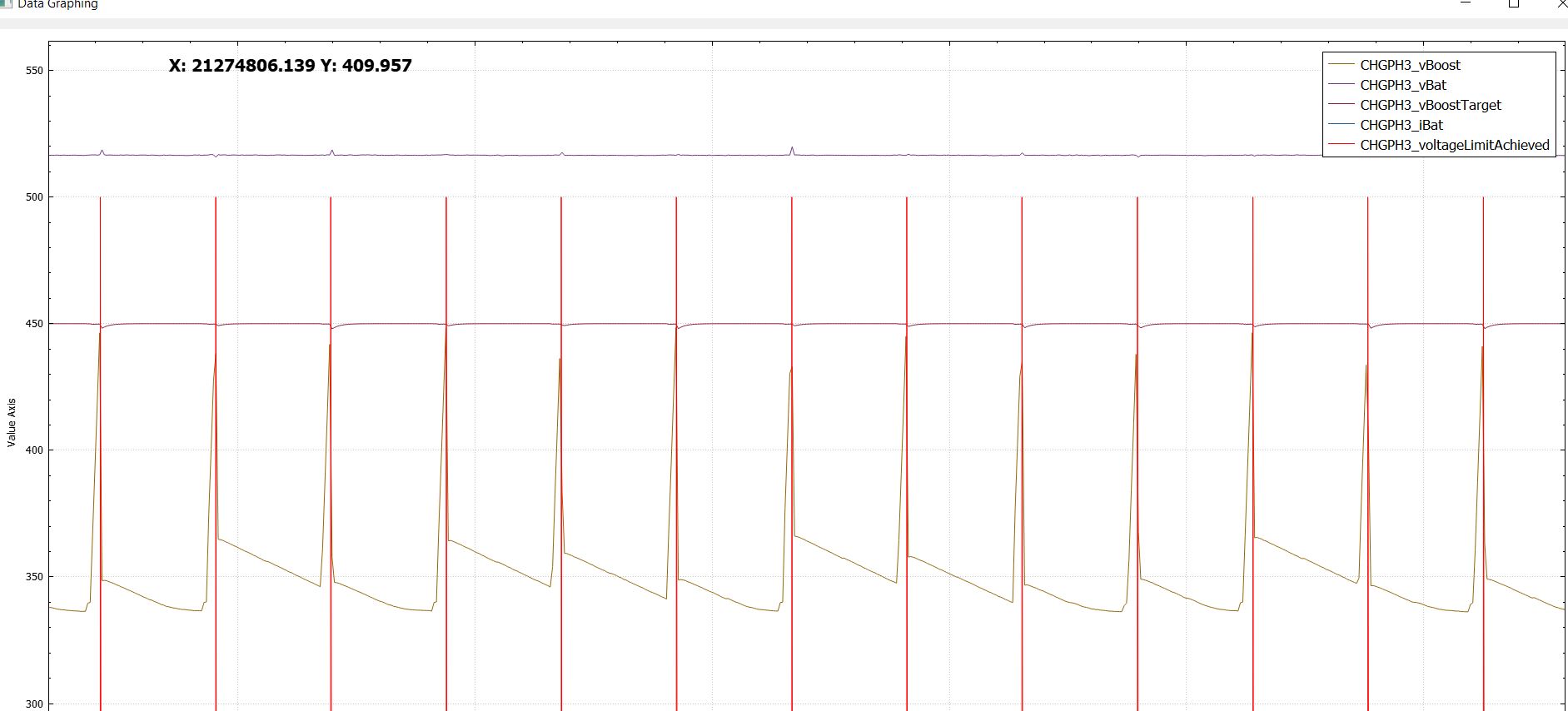

From the serial output line:
Phase 2 Feebback // AC present: 1 AC volt: 248 AC cur: 27.73 DC volt: 380 DC cur: 0.00 Inlet Targ: 60 Temp Lim Cur: 15 25 26 EN:1 Flt:0 Stat:1001101
I'm assuming that:
DC Volt: 380 represents the power modules observation (and reporting via internal can messages) of pack voltage and should match the measurement I would see with a simple voltage meter on the positive most and negative most terminals of my battery pack.
Or should That DC Volt be telling me the voltage that the charger is putting out into the battery?
I have had the battery pack in two locations as I've worked on it. The only situation where I've been able to observe (through clamp meter on negative most post) is not the same location that I'm working now. I have not been able to see anything over a 1 amp reading since moving.

bulletbug wrote: Wed May 27, 2020 9:13 pm May I clarify some assumptions I have to see if the issue may be "baked" into one of those?
I'm assuming that:
This is the voltage measured at the output of the charger.
Was your corrected scaling around 0.0076293945313 ?
I am really struggling to figure out what is going on with your charger, i would almost get to the conclusion the output voltage sensing circuit is damaged in some way, along with the AC current sensing.
You can see the Vbatt is un scaled. However you can see the VboostTarget at 450V, which I believe is a firmware limit.
Due to something not working correctly, most likely there is no current starting to flow for some reason. You see the Vboost shoot up, spike and then a flag of voltage limit achieved being set. Thus most likely something is properly broken.

bulletbug wrote: Wed May 27, 2020 9:50 pm Here is a can capture using the Module 3 only. Module 1 and 2 do not exhibit the additional relay clicking attempts.
Module3Only.csv
Same behaviour unfortunate, but does reset and retry which is not good.

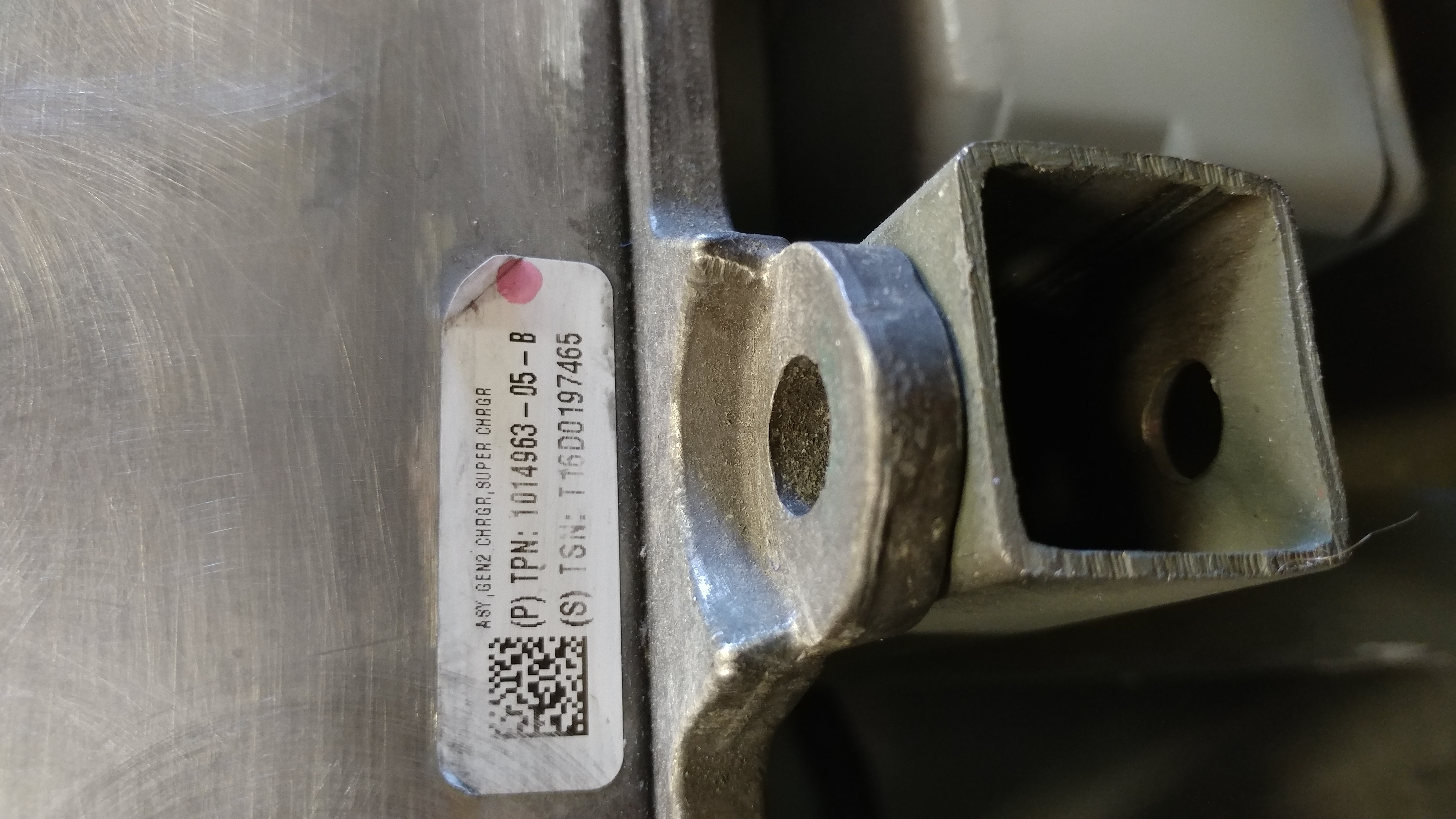

If the DC voltage needed to be scaled to correct it, I'm thinking this implies my charger has either:
* Different CAN messaging at the power module stage or
* Different hardware for detecting voltage and current than other chargers.
Here's a picture of the tag on the charger:
Posts: 2962
Has thanked: 328 times
Been thanked: 847 times
bulletbug wrote: Wed May 27, 2020 10:05 pm If the DC voltage needed to be scaled to correct it, I'm thinking this implies my charger has either:
But you tried that, by bumping the charge voltage and termination voltage and it did nothing....
