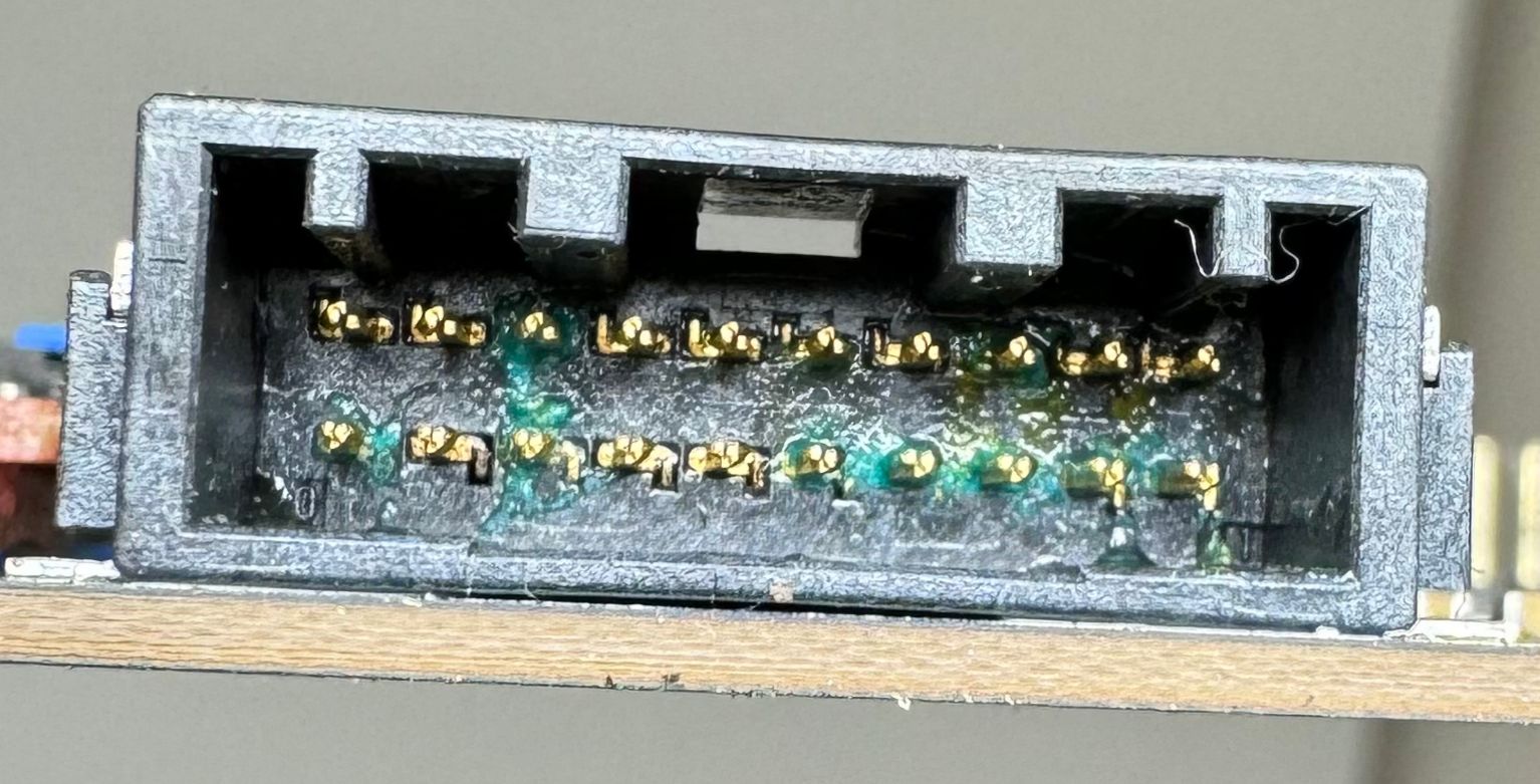

Finally got the new V6 board in. That old V4 card which got wet, had a lot of moisture in one of it's connectors (see picture). I'm sure that caused the random overcurrent errors which eventually caused the car not to move at all. Now new board is in, and wheel turn .. but now there is another kind of problem. Sometimes wheels don't turn at all, and sometimes pressing pedal like 40-45% they start to spin fast. After it gets spinning, I can regulate the speed .. but for some reason, I really need to push the pedal and it agressively gets going. Sometimes it doesn't at all. No errors posted on the firmware. Attached plot .. in the plot, it shows pedal %, potnom % and speed. First pressed the pedal to 100%, and no movement .. then lifted the pedal, pressed brake and pushed the pedal again .. now around potnom 40% wheels suddenly start rotating fast. But as you can see from graph, it requires lot of throttle before that happens.
I copied my previous params manually. Battery voltage is 240-300V. Maybe I missed something?

I sprayed brake cleaner to that female connectors and lots of compressed air to push it out. Hard to see inside of those female connectors though. New board side connectors were of course dry.

I think the moisture was on the board connector side, not on the cable side. So they should be dry..

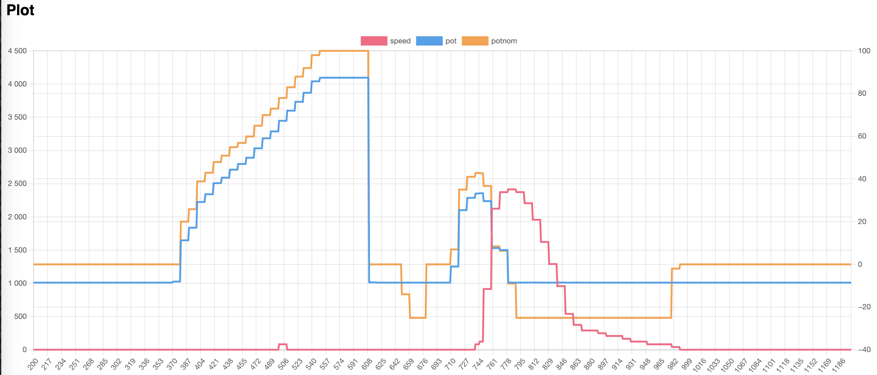

Is there any other value I could plot, to see why motor is not spinning even though potnom goes up?

Flashed the standard firmware, did not help.
I noticed that once motor gets spinning, you can adjust speed and everything seems fine. Problem is that it just won’t get going .. it’s like every 5th time or so, when it decides to start spinning and starts violently.
It’s feels like speed / position sensor issue. Could this kind of issue be caused by loose wire on encoder cable? Like second channel cable disconnected?

It's difficult to trouble shoot the parameters because your udcnom is so much lower than most of the tested LDU parameter sets out there, and everything gets scaled based on that.
Nothing is jumping out to me as wrong. Your boost value is a bit high and fweaksrt is a bit low, but that should be doing the opposite of what you are seeing.
It sounds like a positioning issue or an issue with a phase (power stage or winding.) If you have any suspect wiring fix that first.

Got it working! Yes!! It was one or two loose connector legs on IGBT connector! Some flux and solder, acetone to clean flux and compressed air. Put it back and it starts to spin smoothly!
What lead me to discovery was when I started thinking that it must be one phase not working, so it randomly starts to rotate depending on the rotor position. And when it’s rotating, one missing phase is hard to notice. So I checked phases with diode mode, all were healthy 0,38. Then checked the wiring harness connectors and they seemed to be okay. No red lights on phases when powered. Then pulled out the board and zoomed in with iPhone macro on hard light. Went through each leg with multimeter to see if they are shorted, and when touching the last leg, it moved. I was like what.. this is not good. Then realized this must be a problem..
Funny thing here, that I didn’t solder these myself just for this reason. This is my 3rd board and I wanted to be sure that it’s not my soldering that causes problems. Would be great if these connectors could be done at pcb factory. Probably I’m not the only one having these problems..
Just strike of bad luck here, as the first board got water and broke, second board had chip solder issue and third one has connector solder issue. But I’m so happy that it works now!
Thanks for all the tips and suggestions, they led me to the source of the problem.
