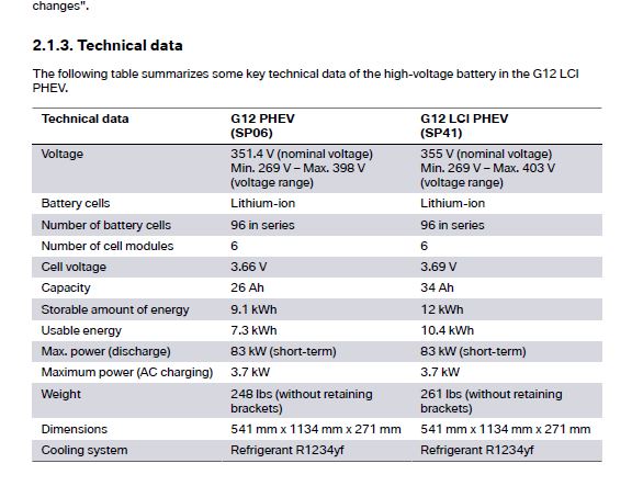

The BMW Datasheet suggests 2.8V - 4.14V for the SP06, so yes does suggest there is a quite a bit of extra capacity to play with

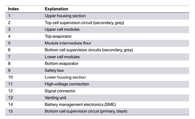

maybe you'll find this exploded diagram useful

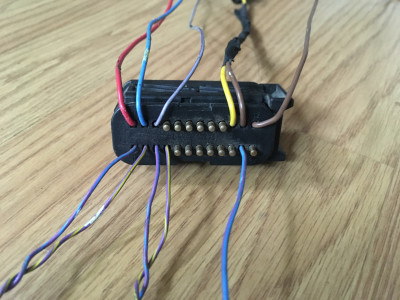

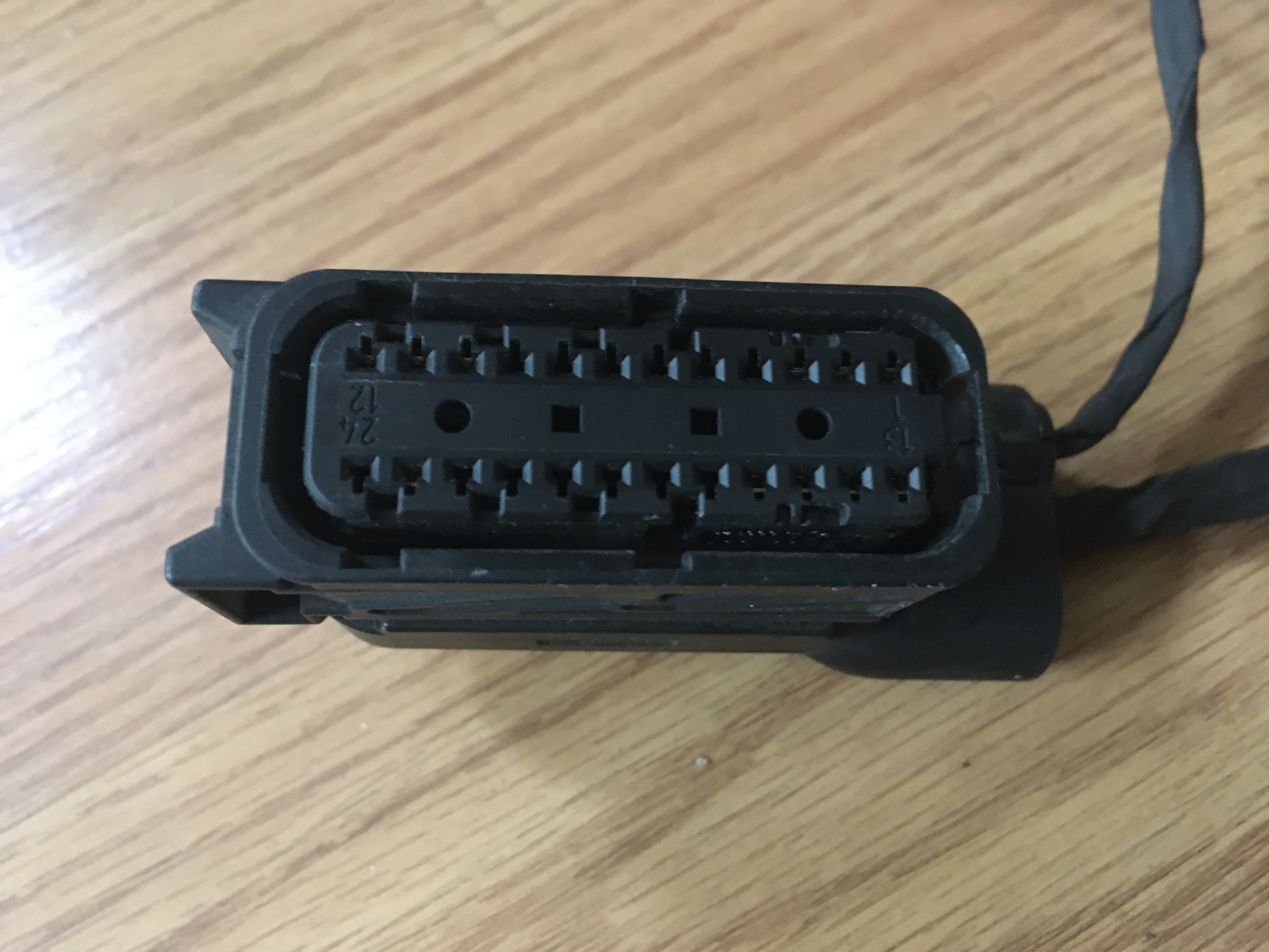

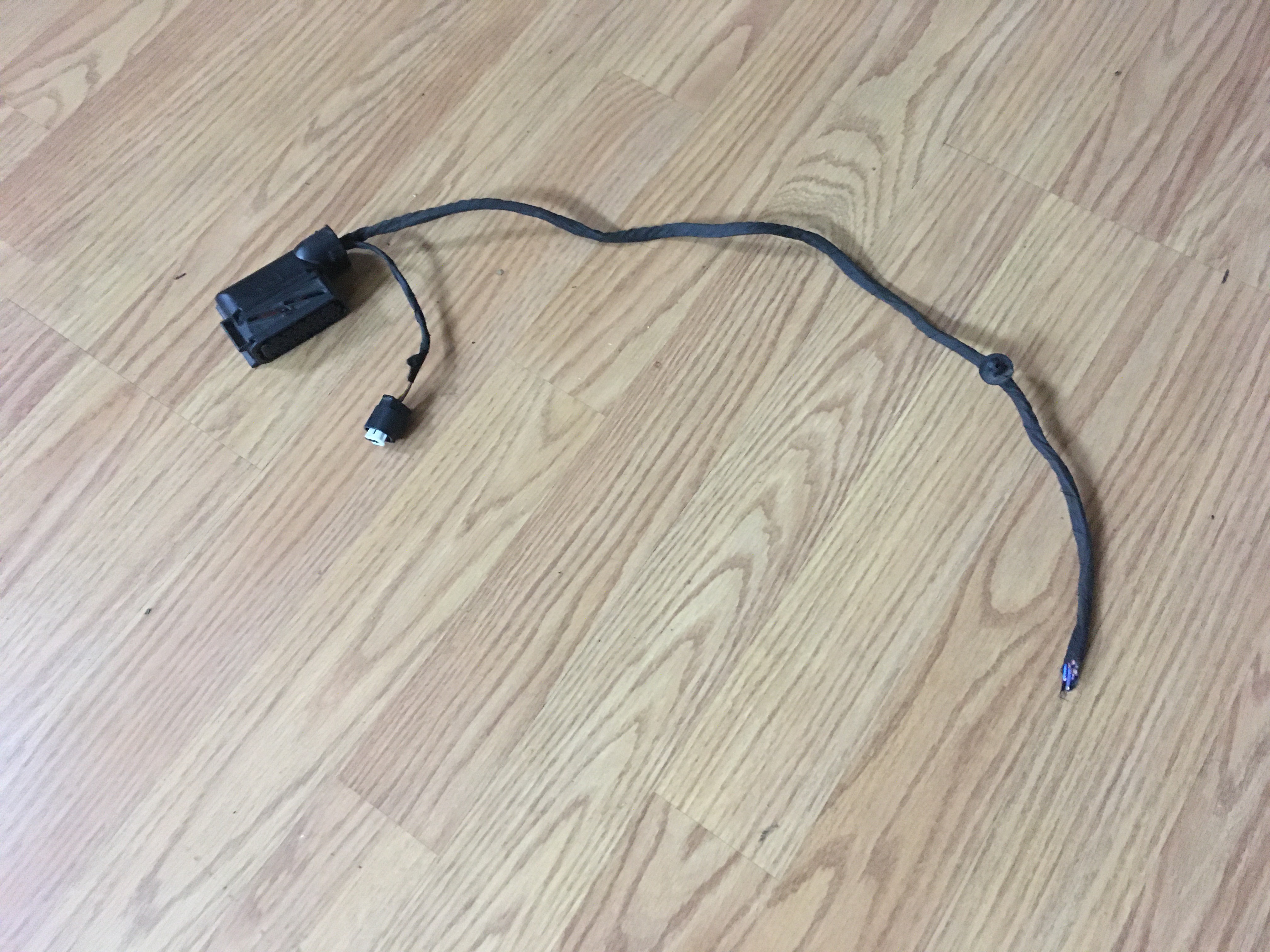

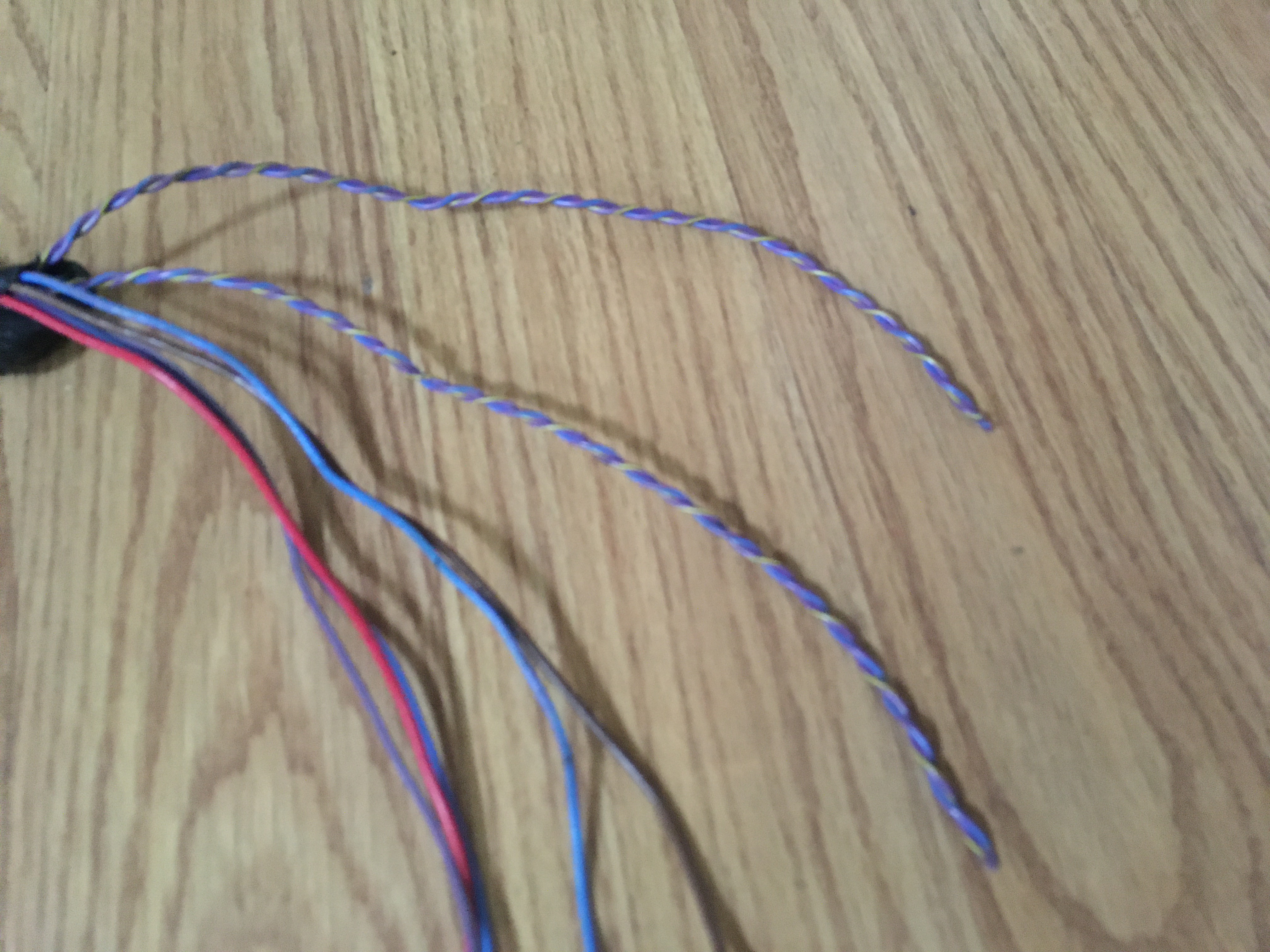

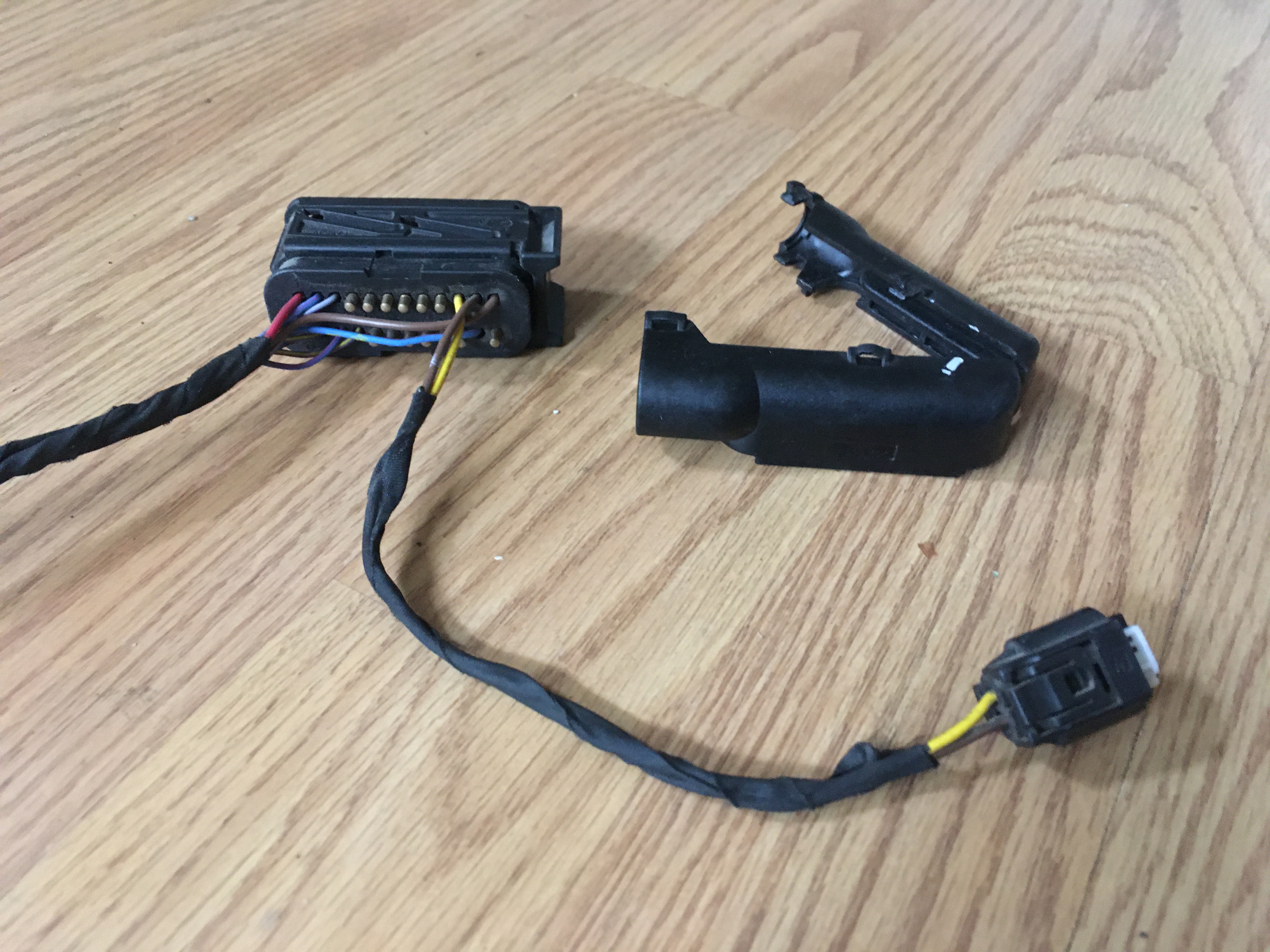

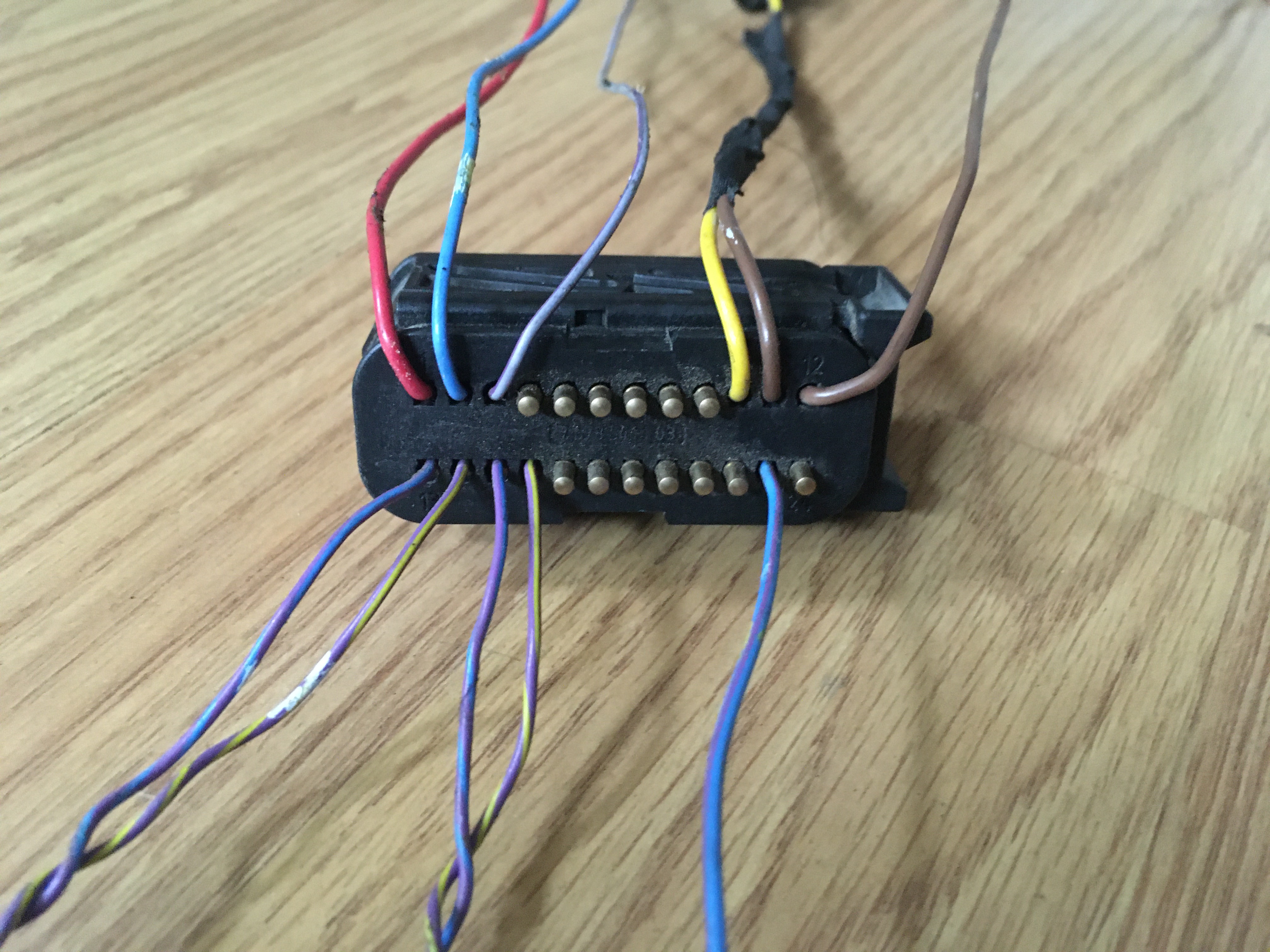

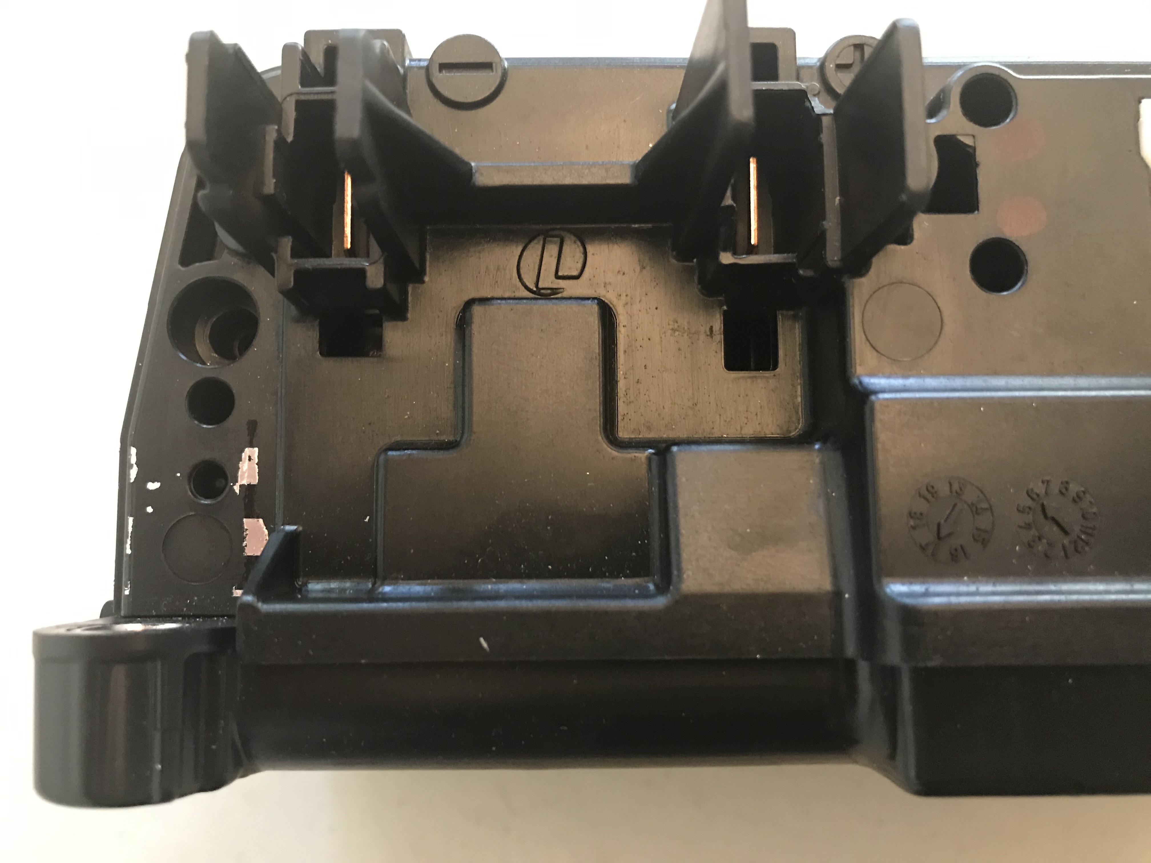

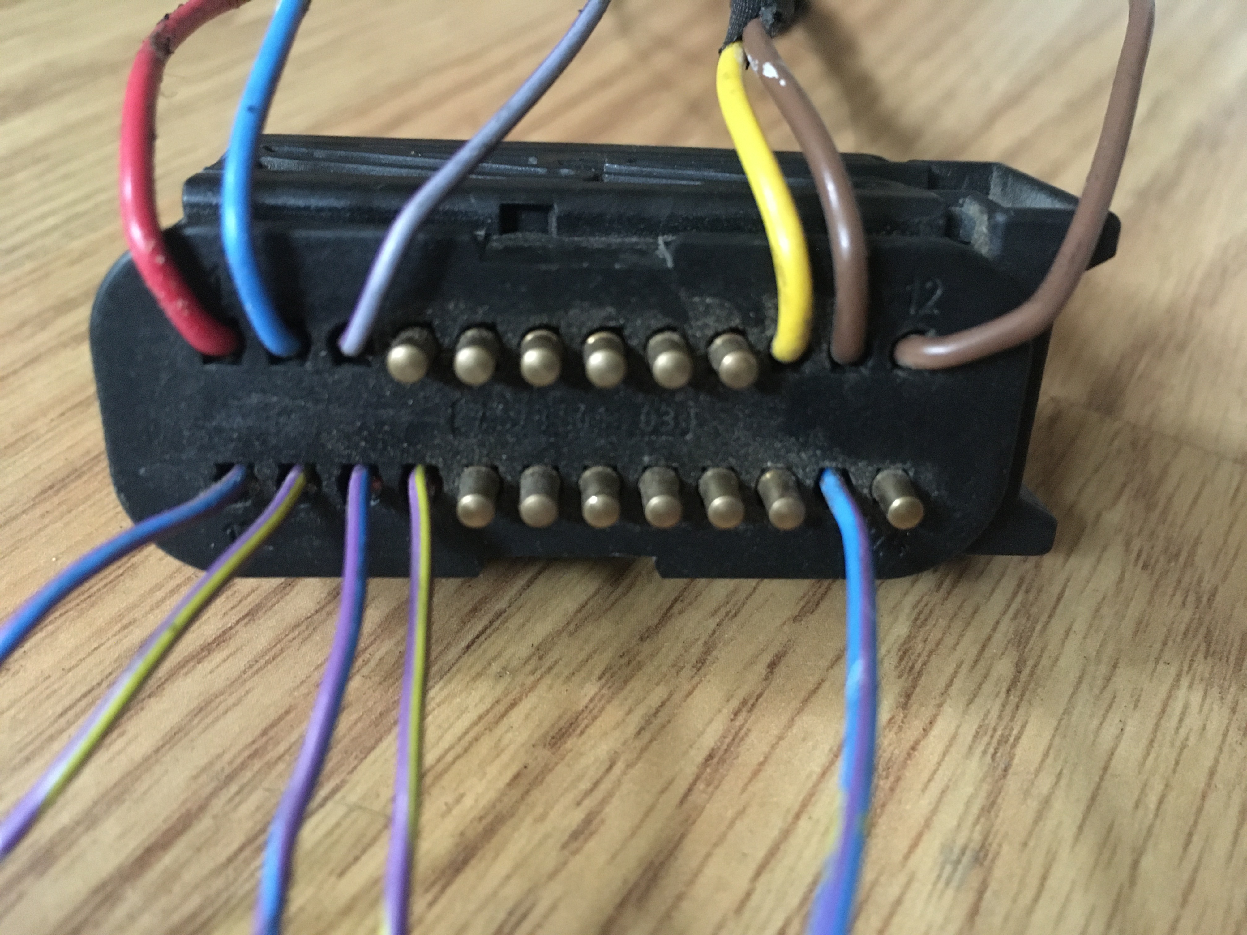

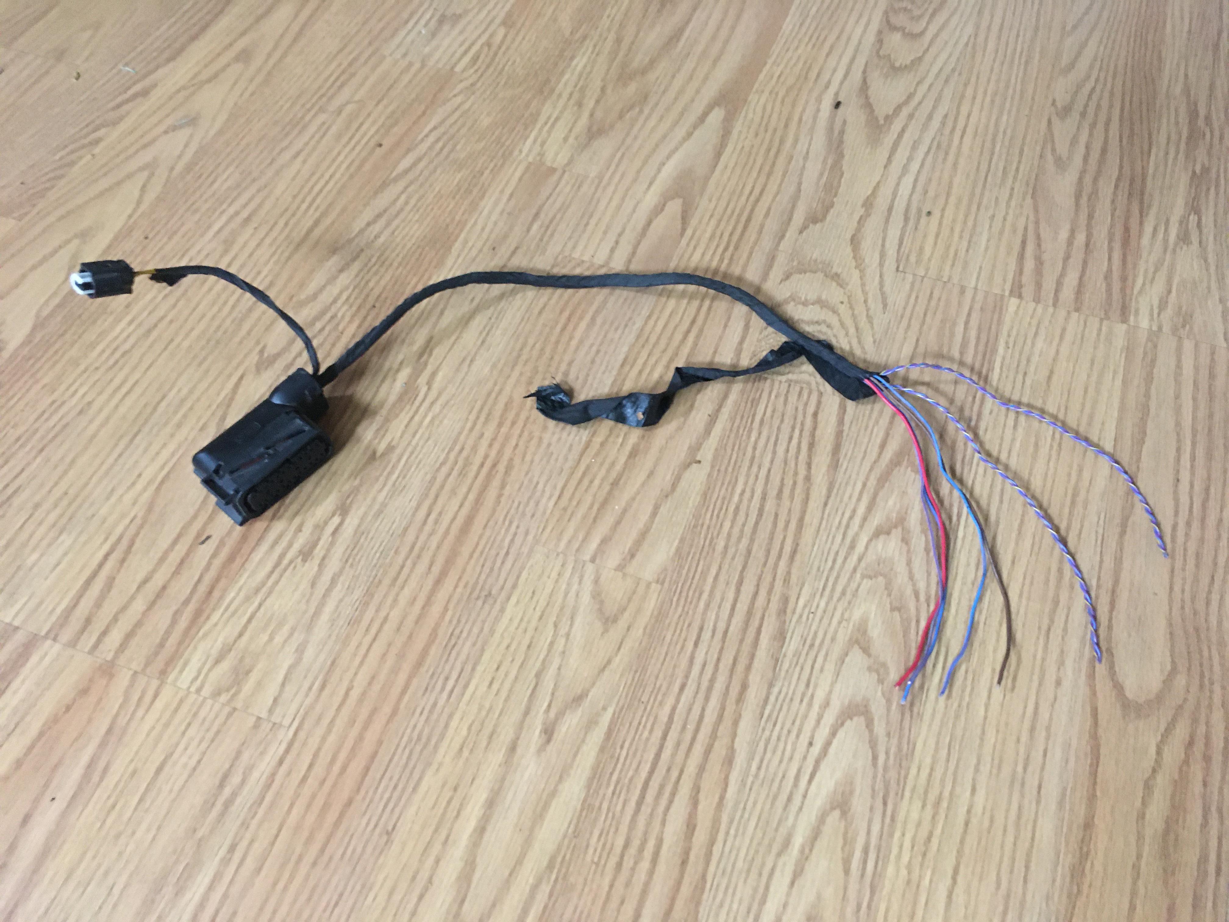

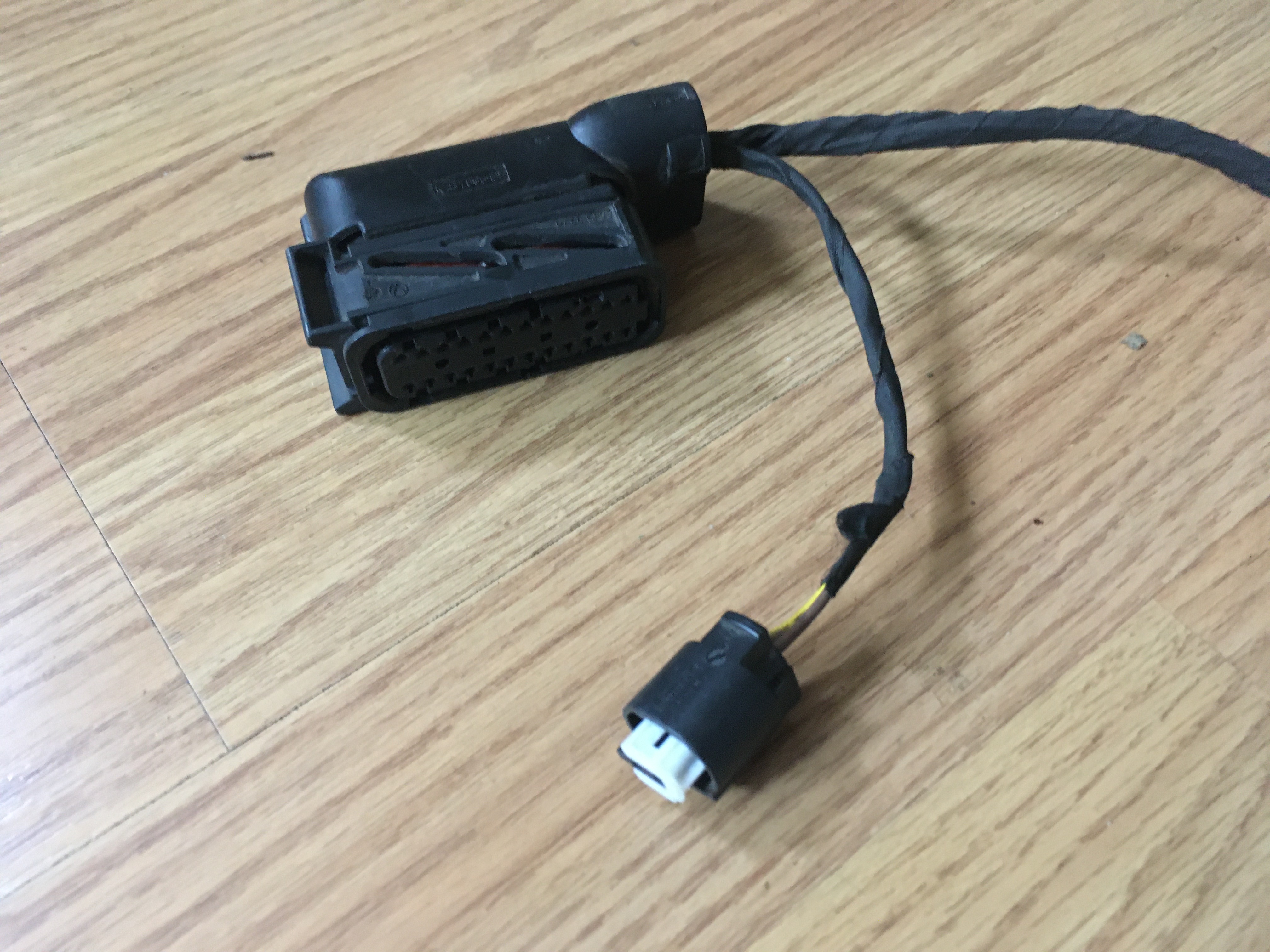

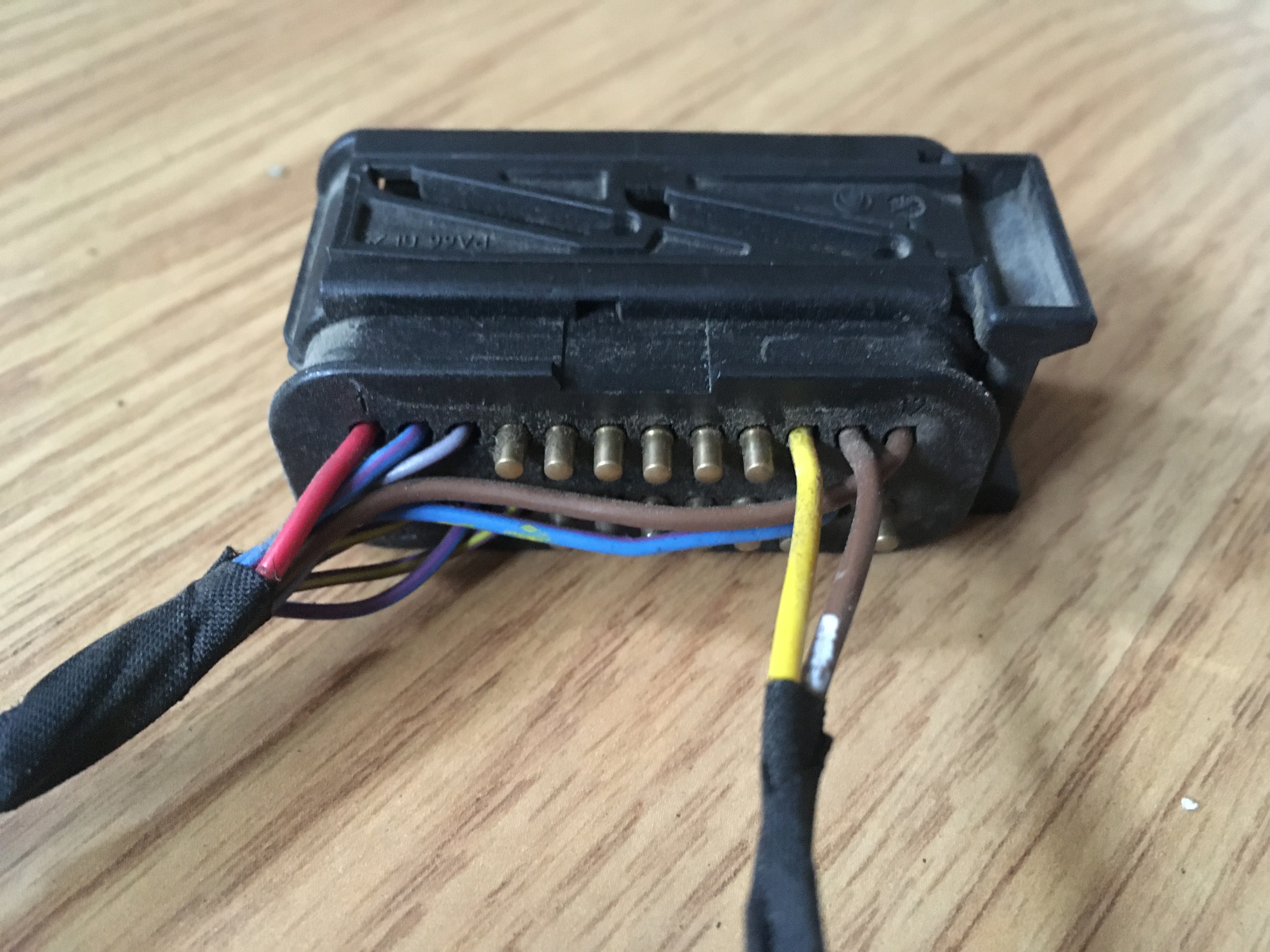

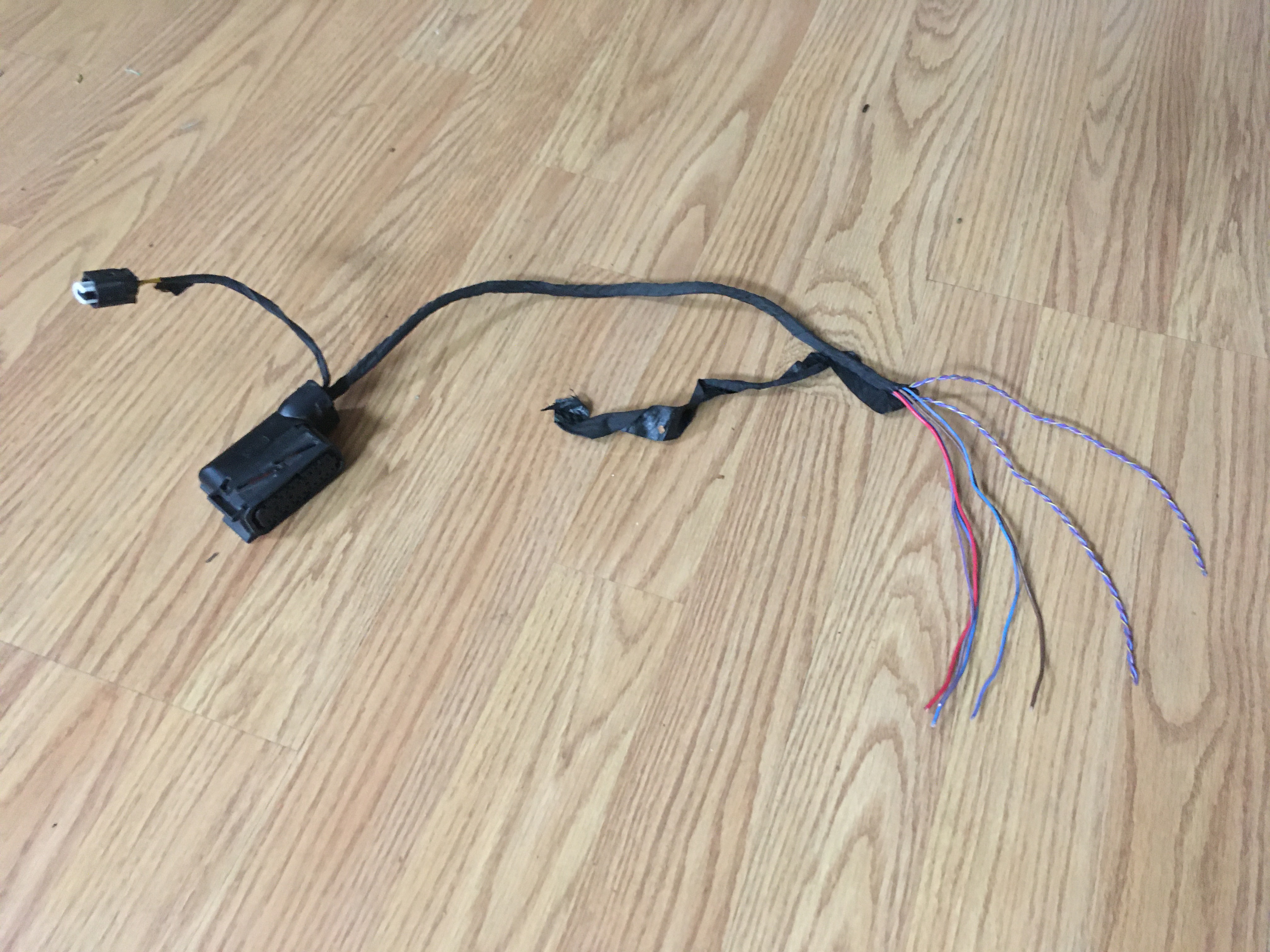

Post by Gregski »
my 2018 530e battery pack came with the signal connector pig tail so I decided to unwrap it to see if it would hep any of those who are metal case cover removal averse
and considering it was covered with honey or molasses or both, which now I have successfully transferred to my hands and now to the keyboard, I really hope someone on here appreciates it

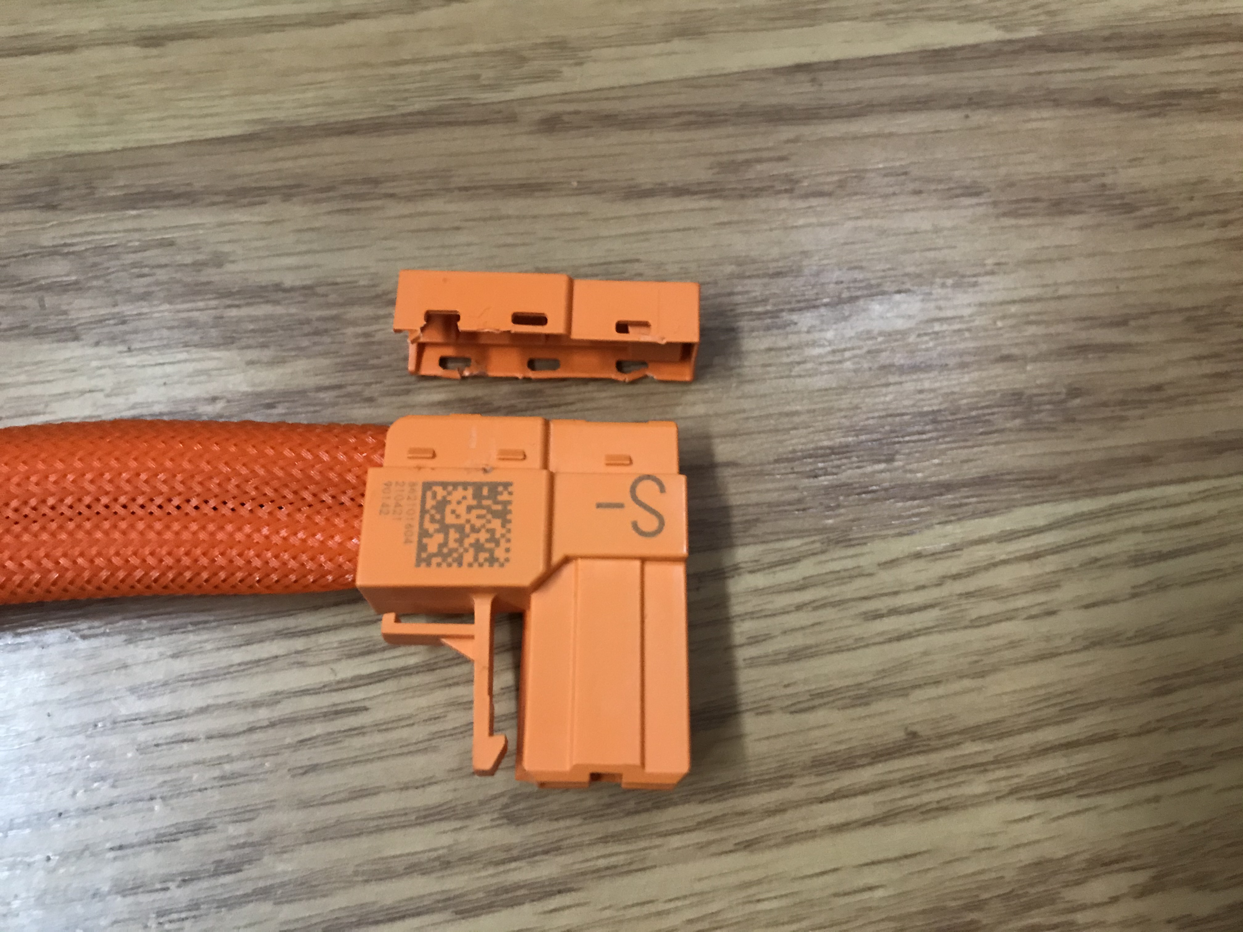

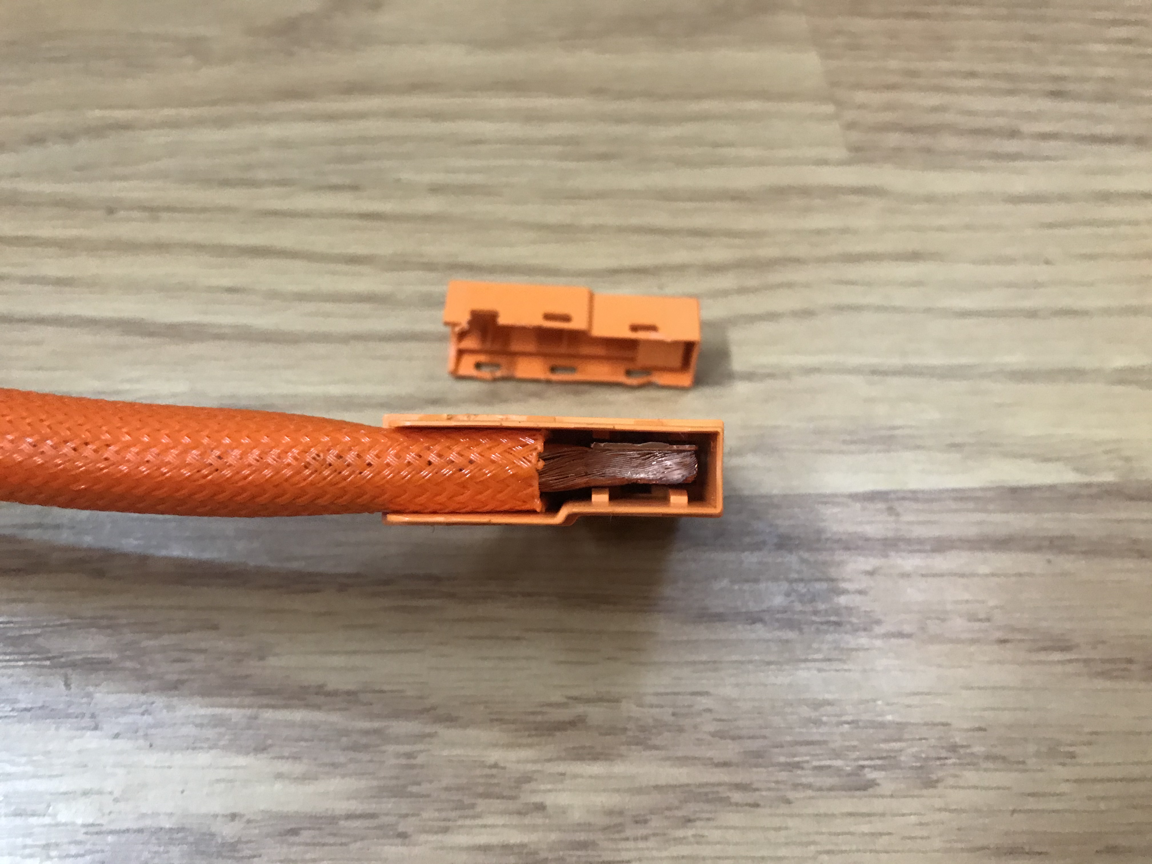

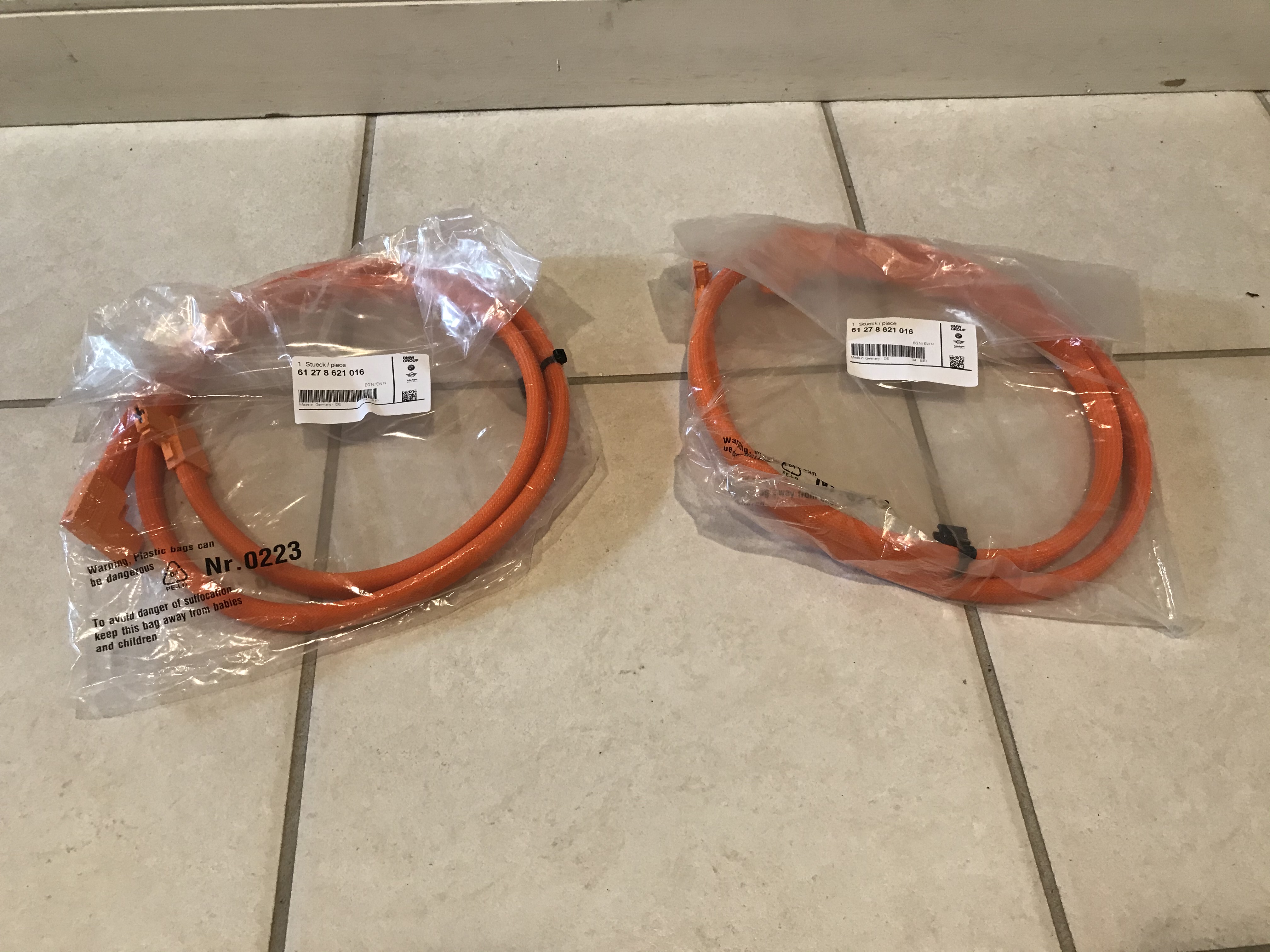

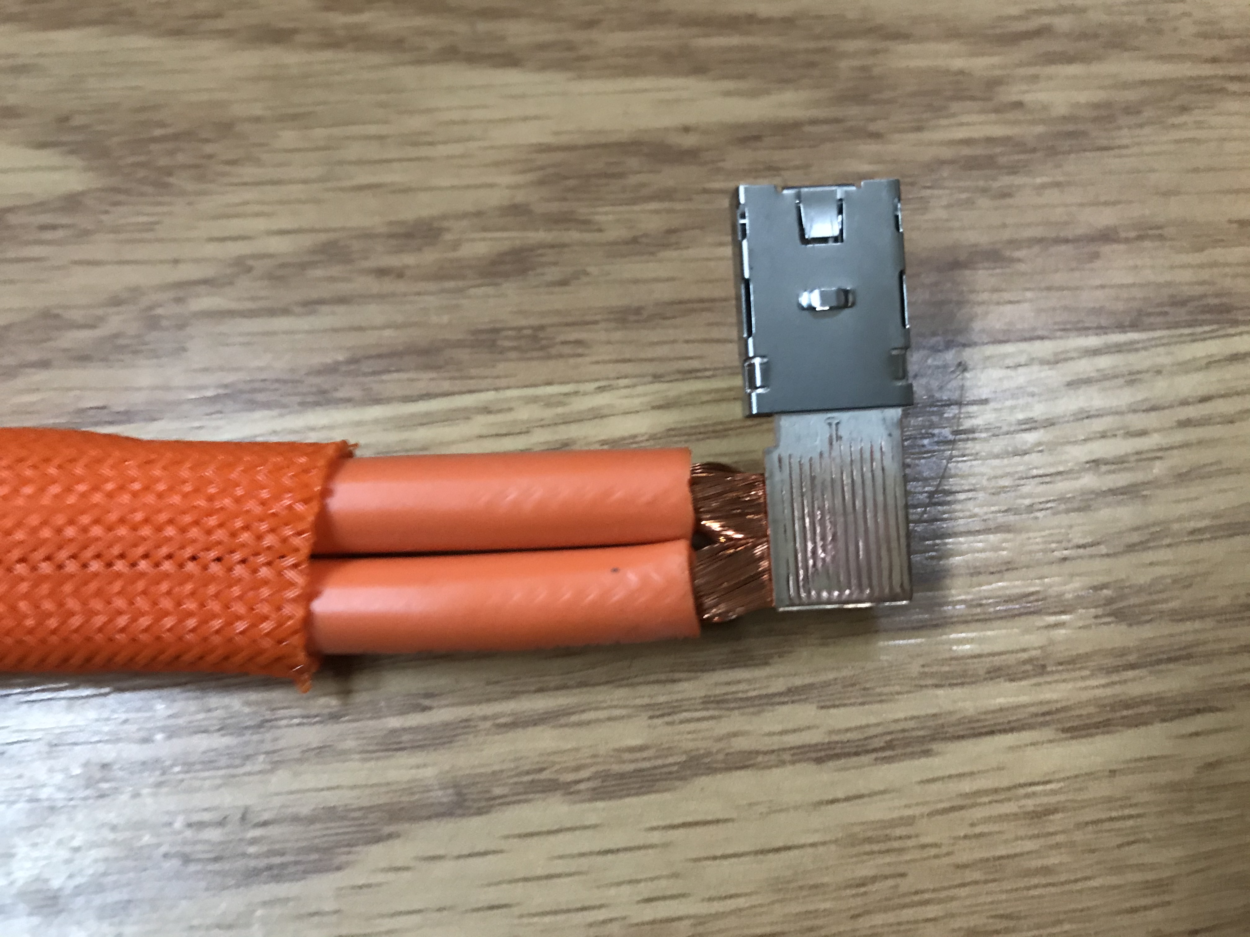

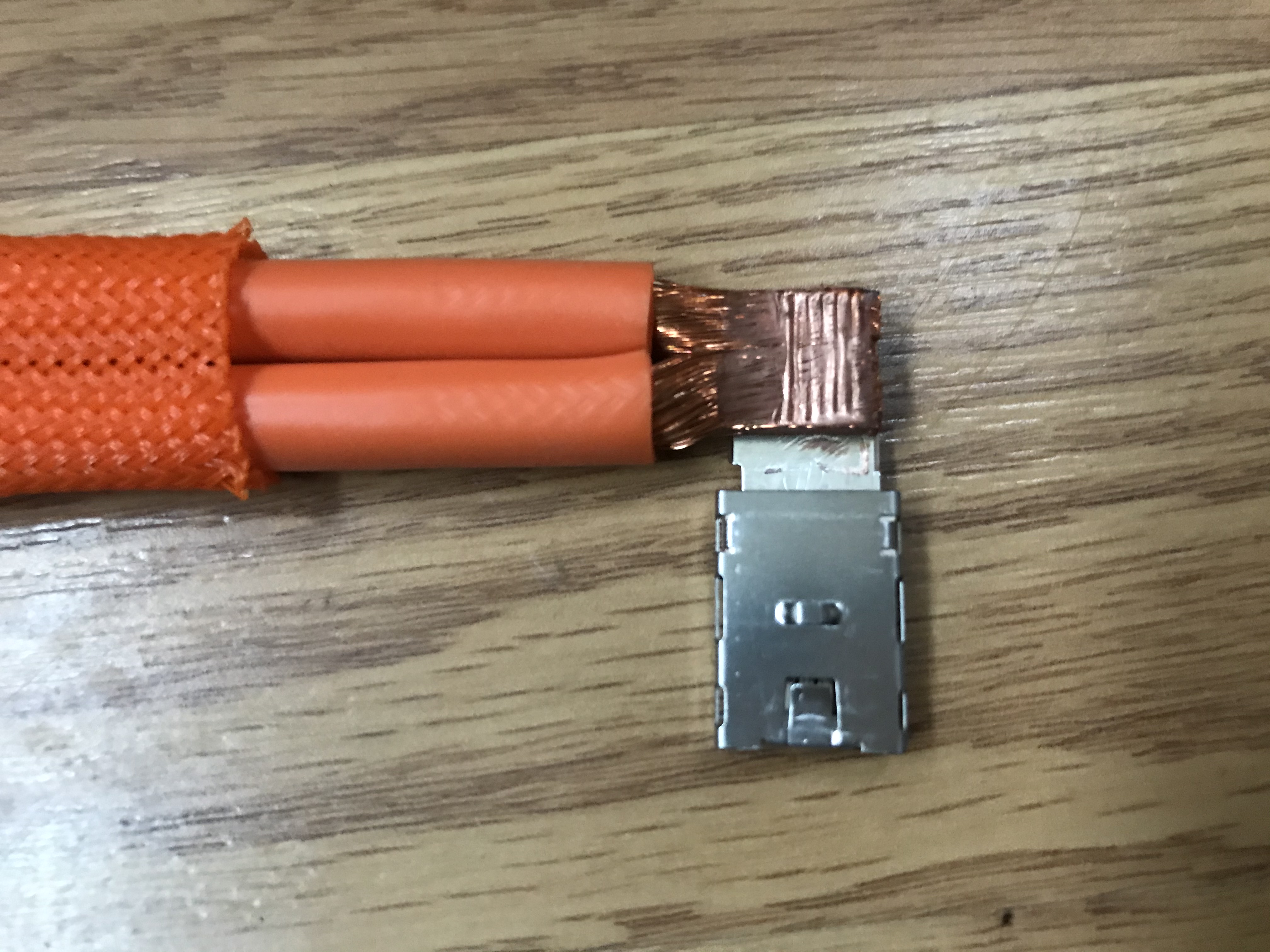

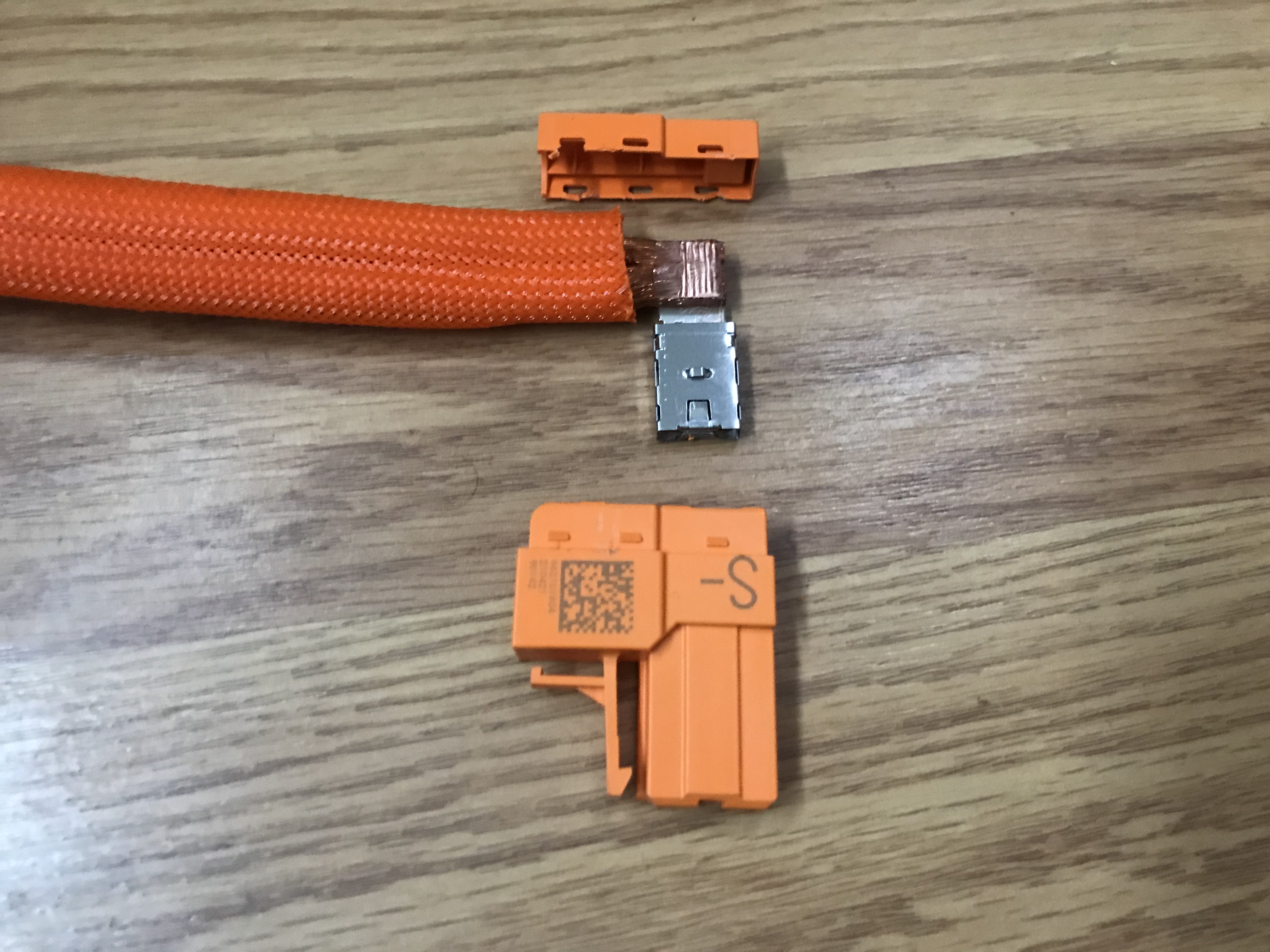

Post by Gregski »

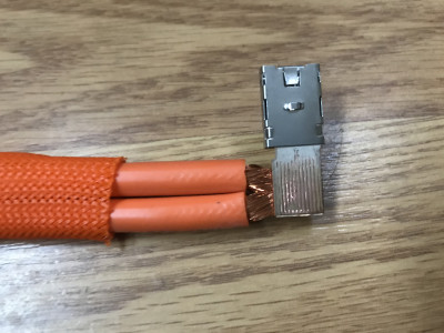

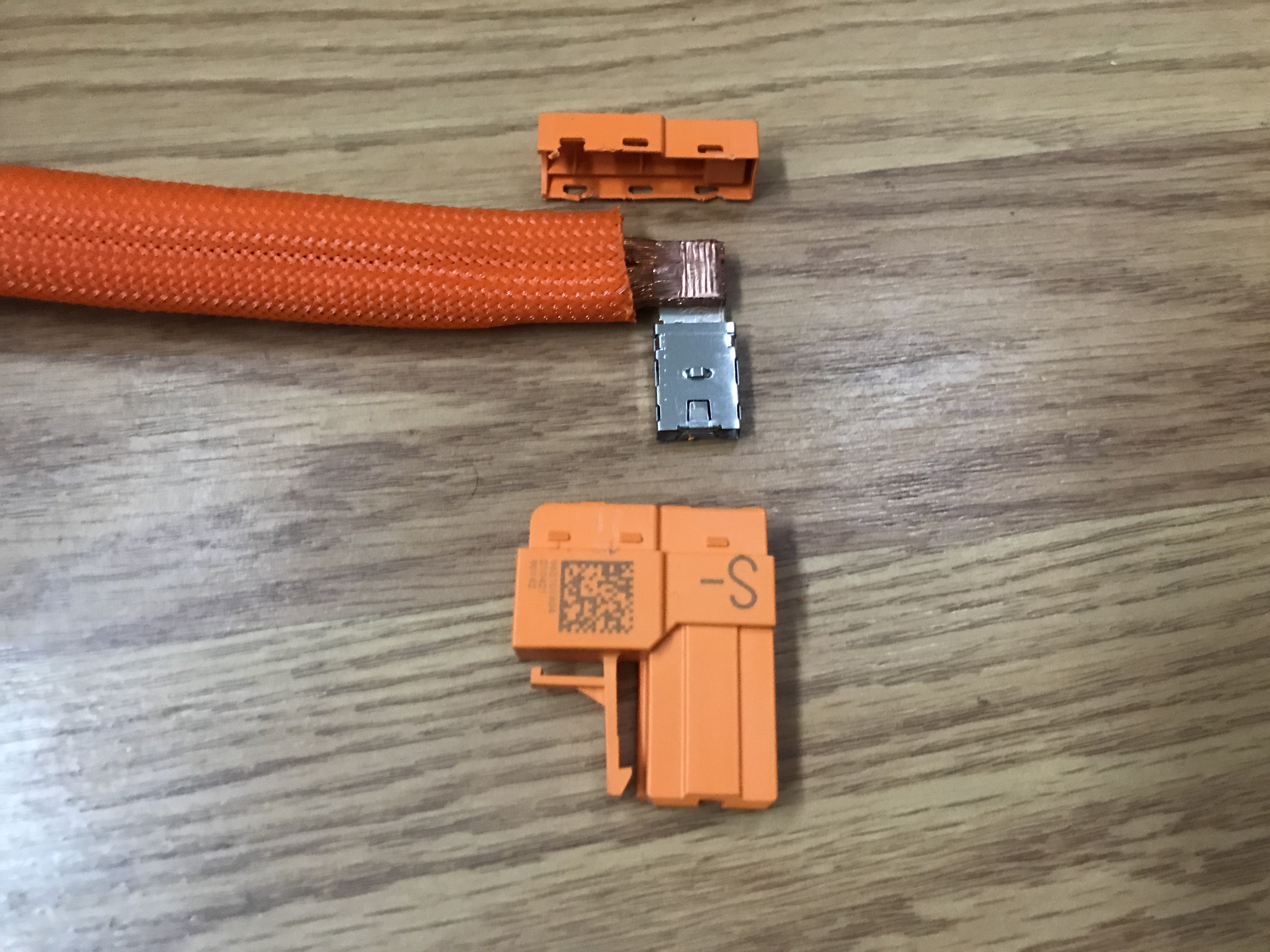

I thought someone may be interested in how the battery cables are built, so I went out and bought two of the #1 cell module main negative leads part # 61 27 8 621 016, this is the longest cable in the pack, I plan to modify the ends on these and use them as my to and fro to the pack
these are keyed, meaning they plug in a certain way
more excruciating detail can be found here: I bought a BMW 530e hybrid battery pack - Now What?

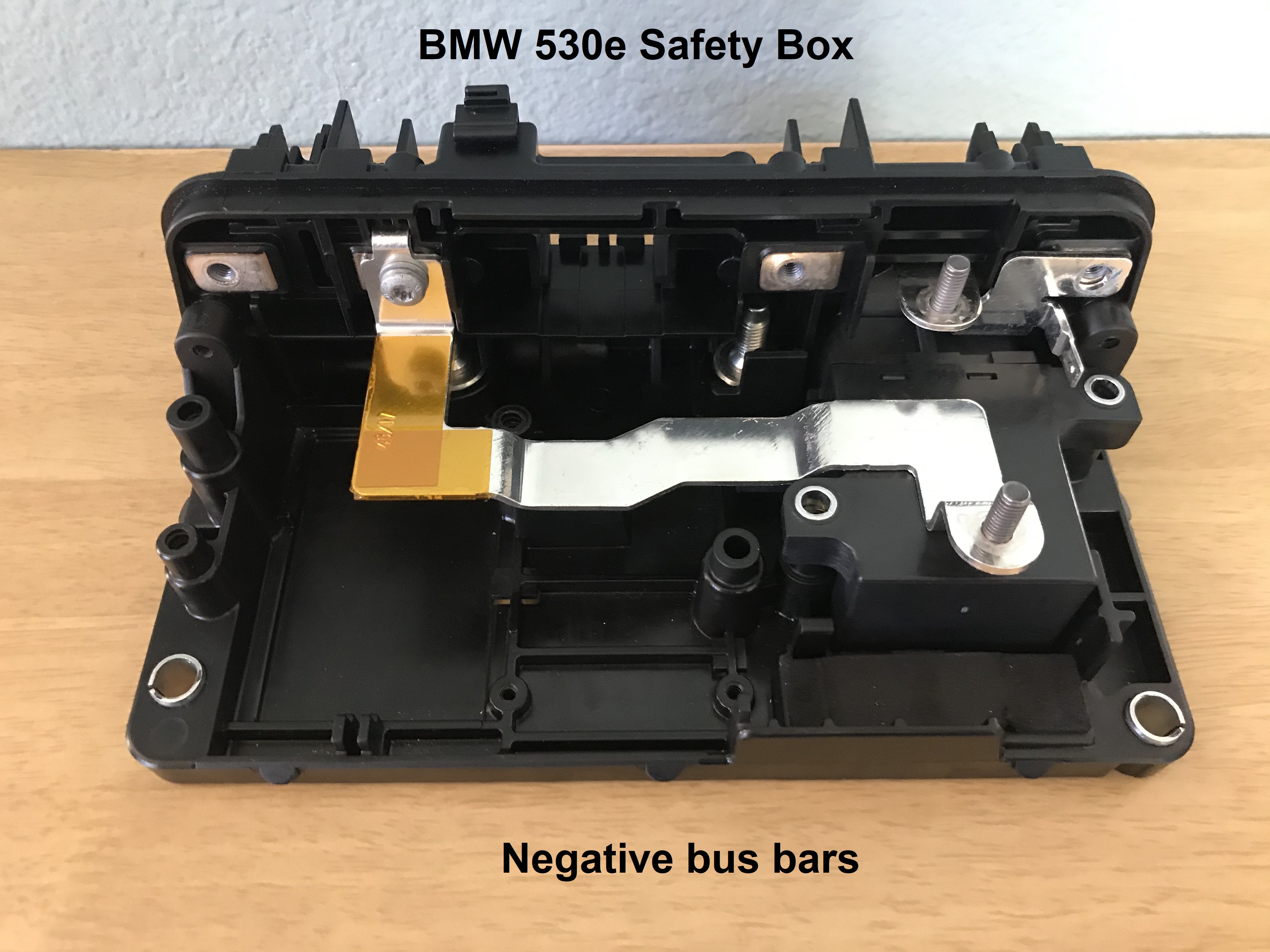

Post by Gregski »

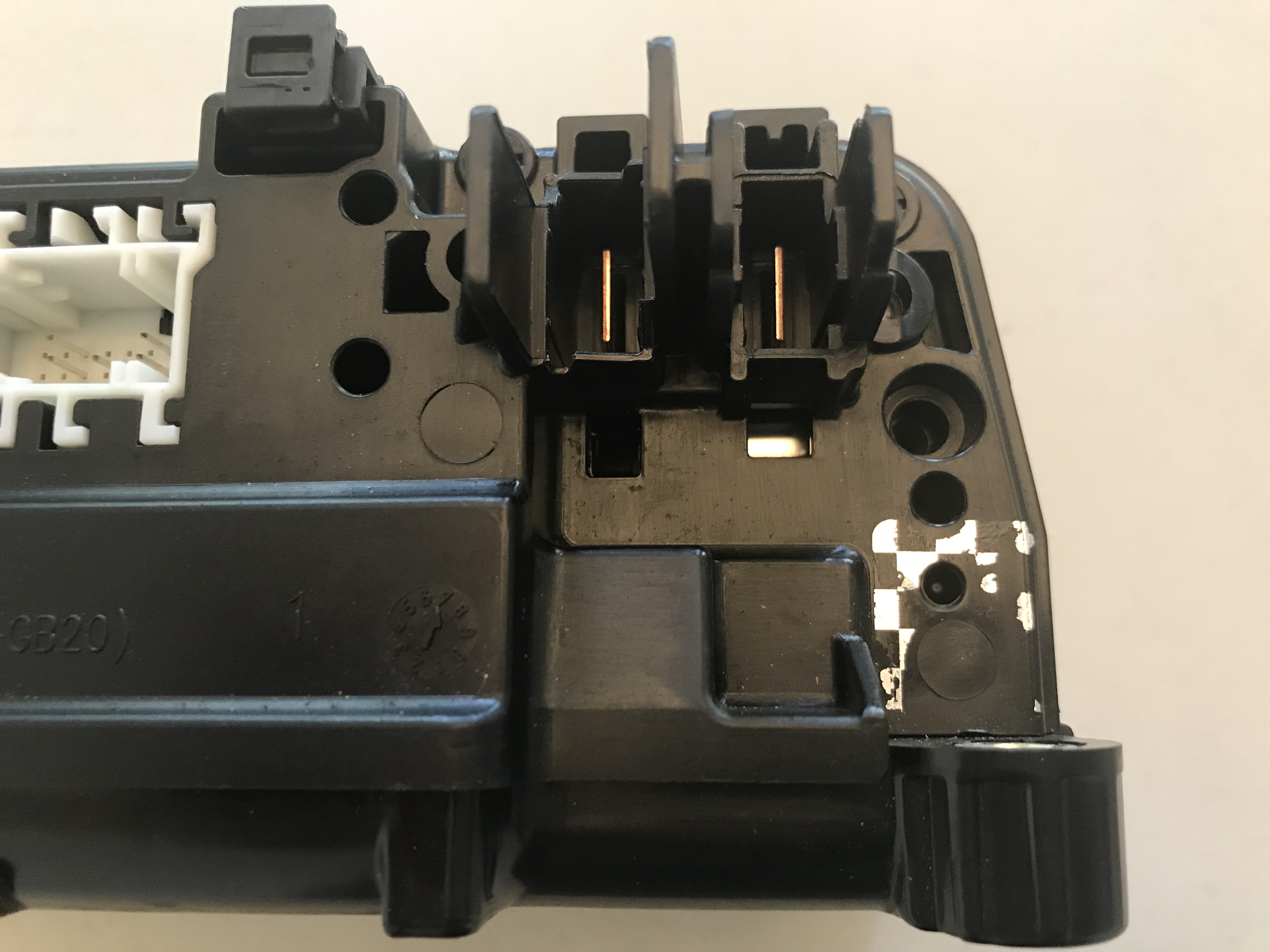

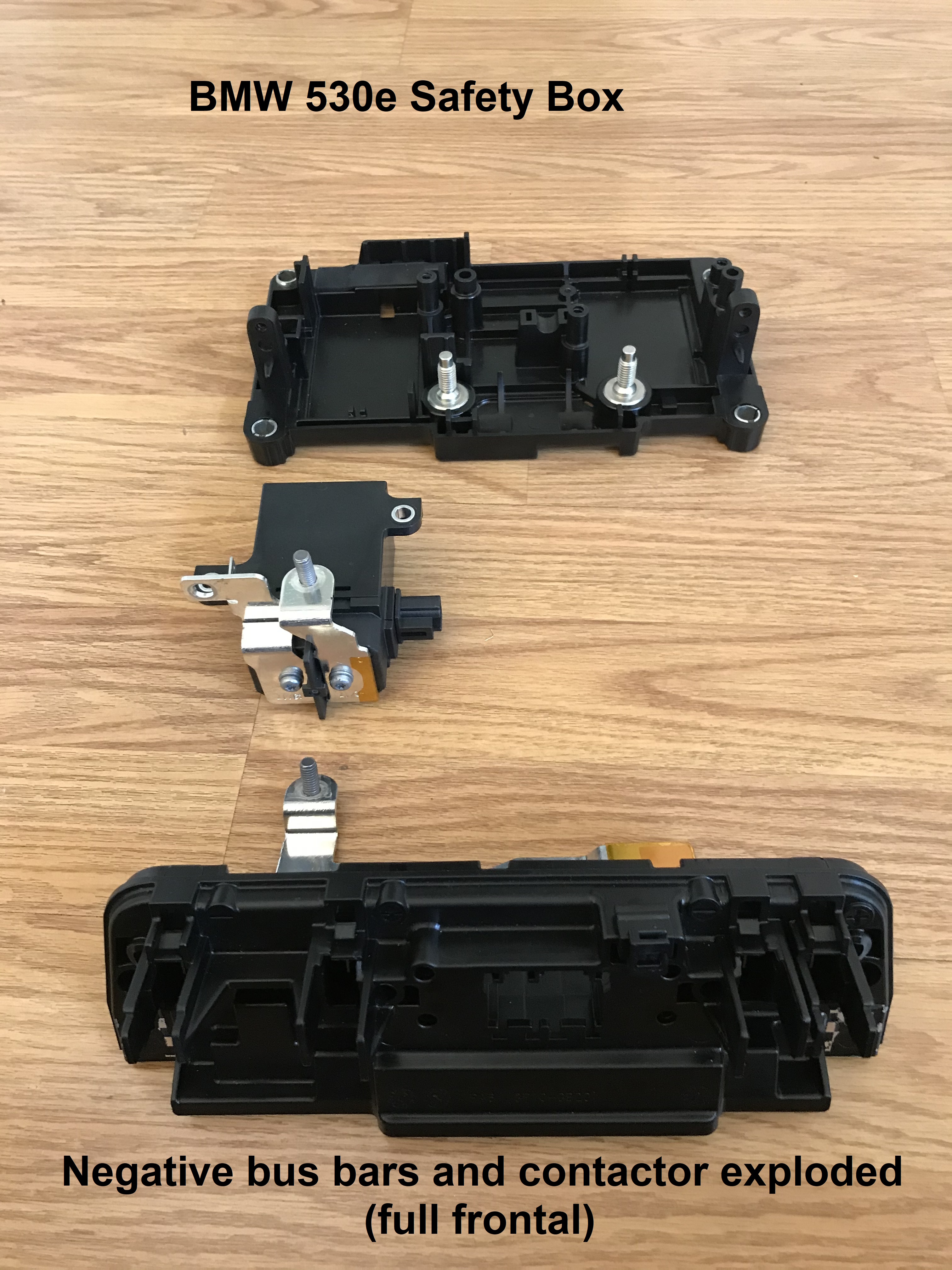

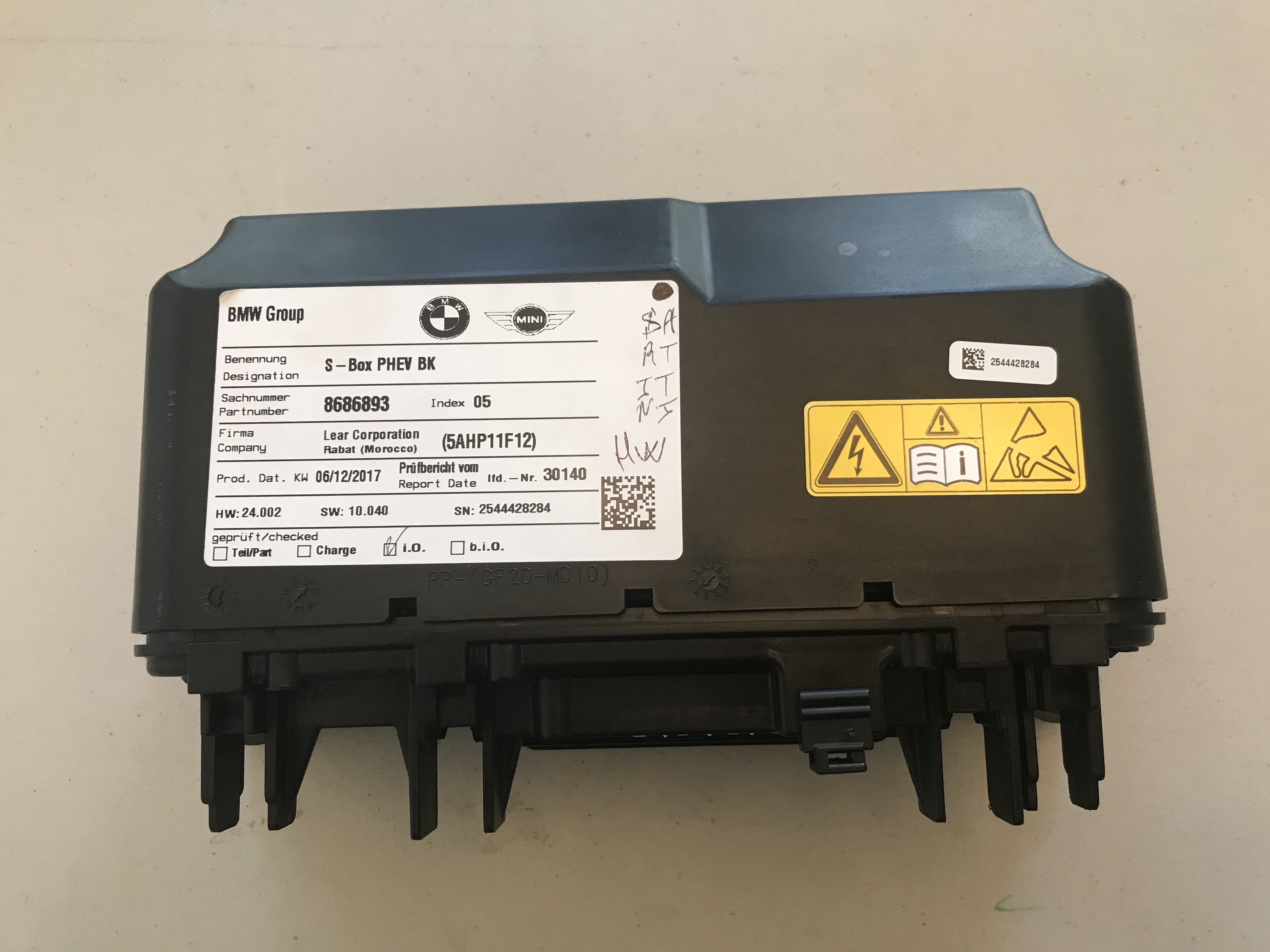

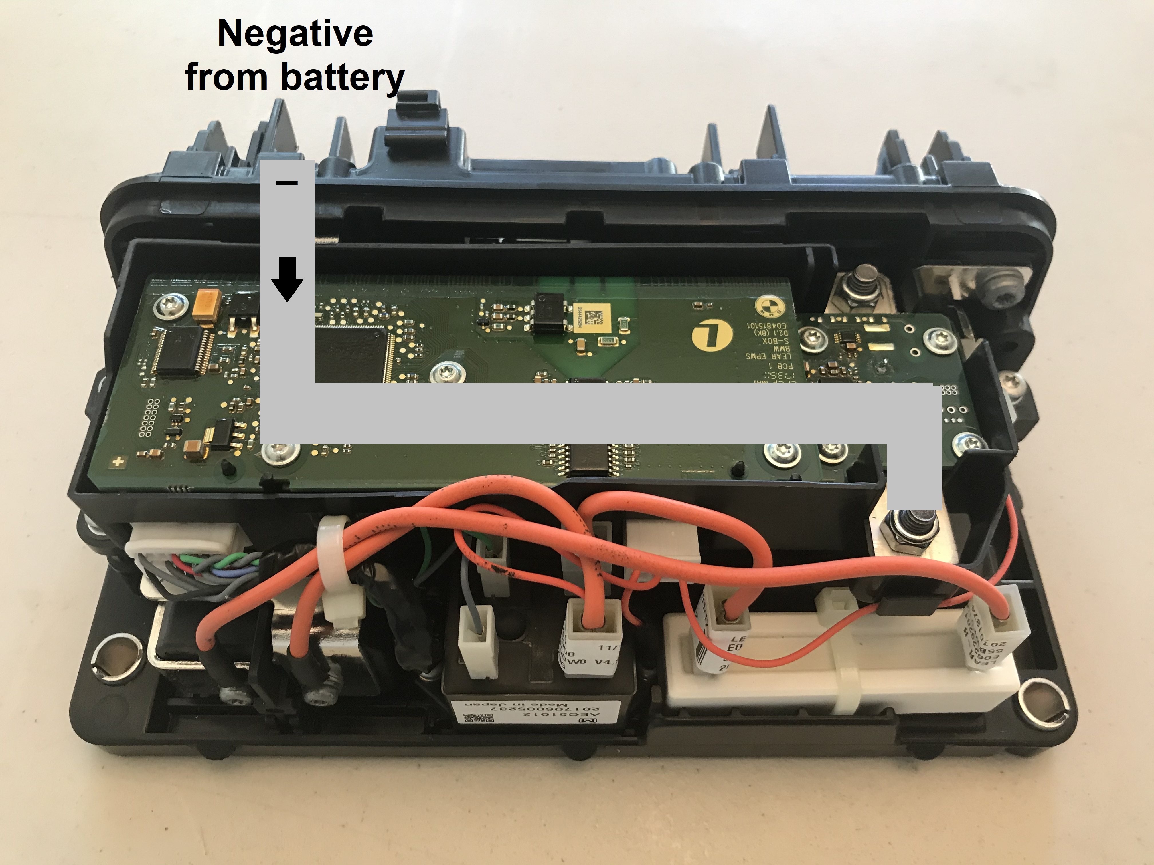

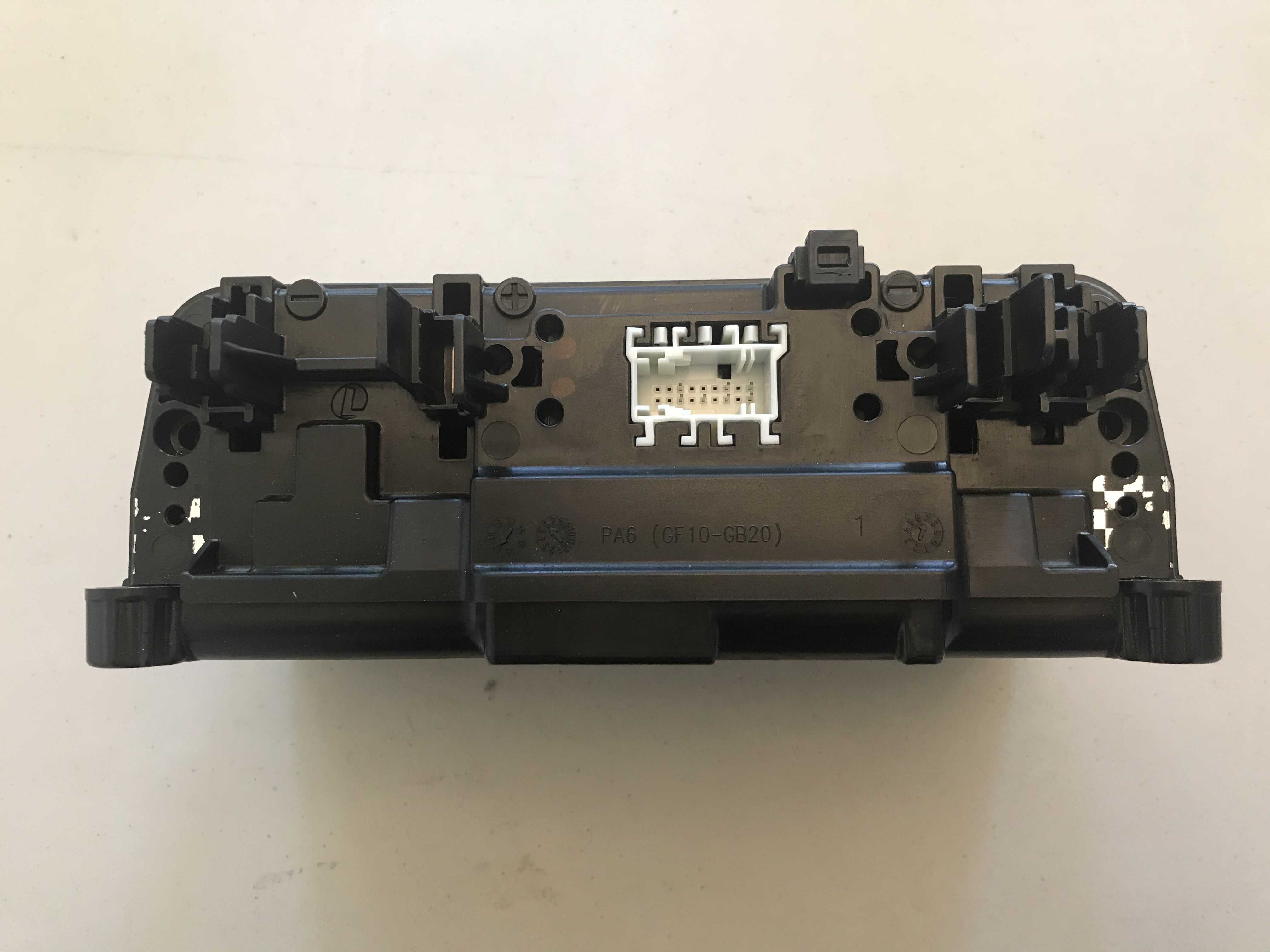

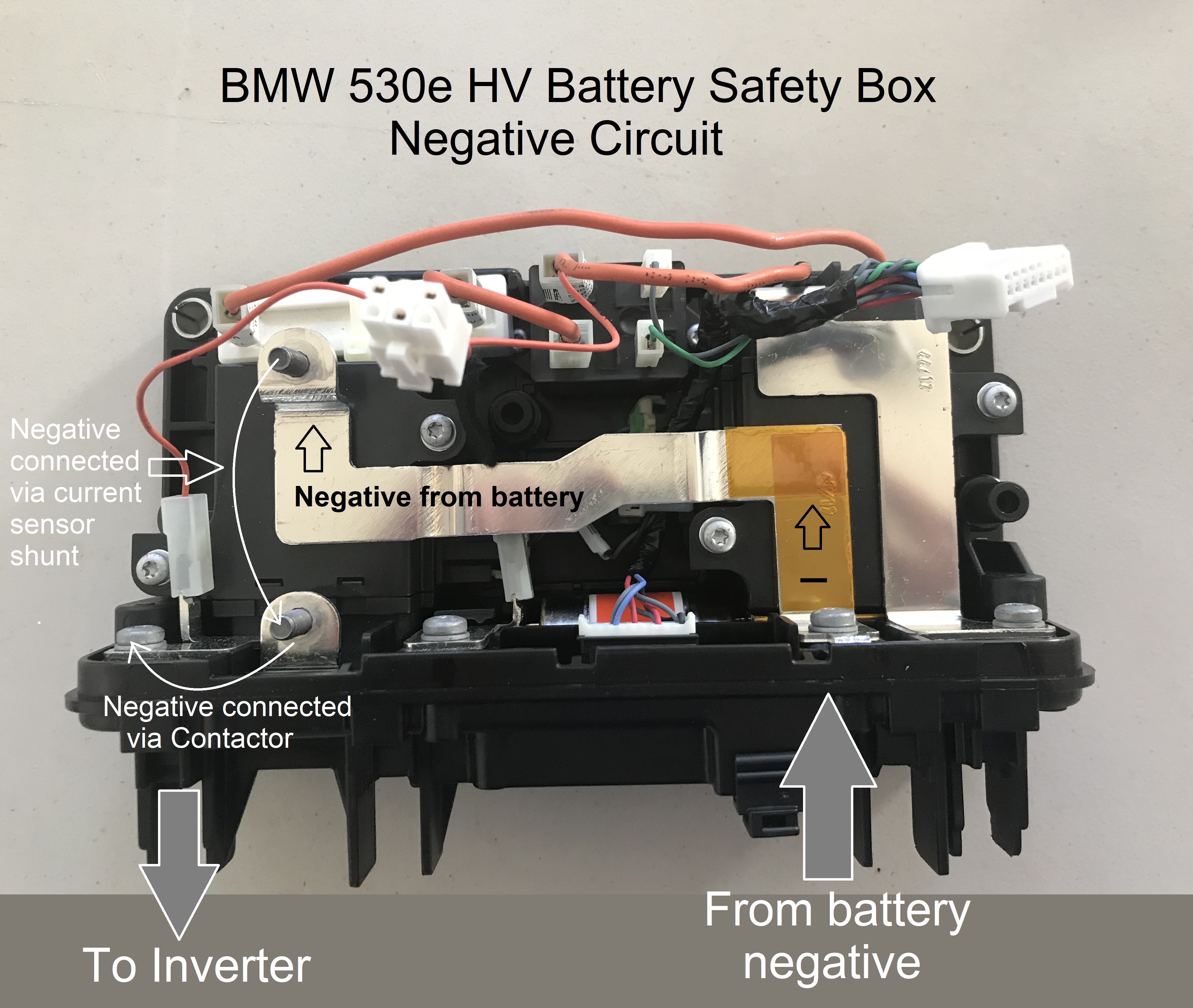

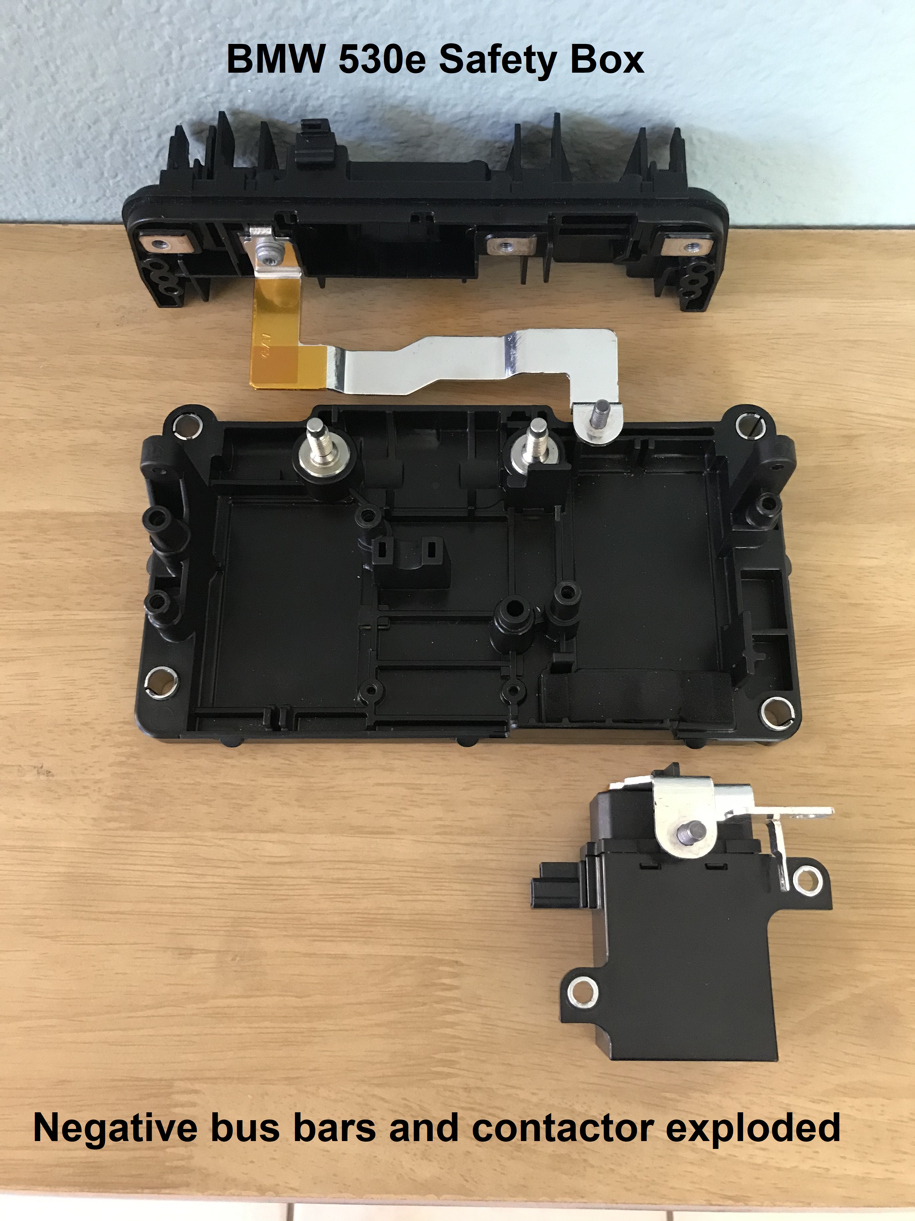

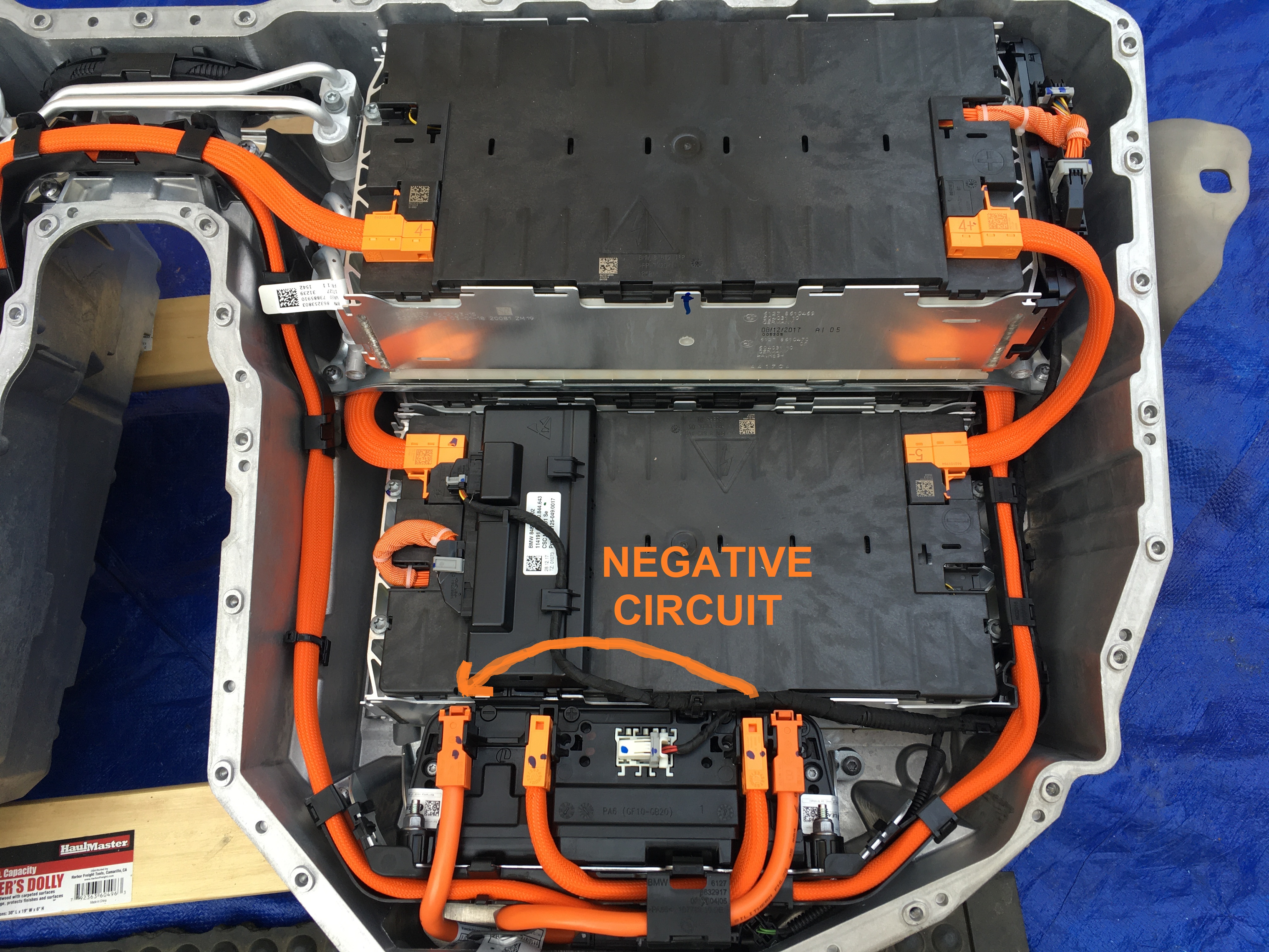

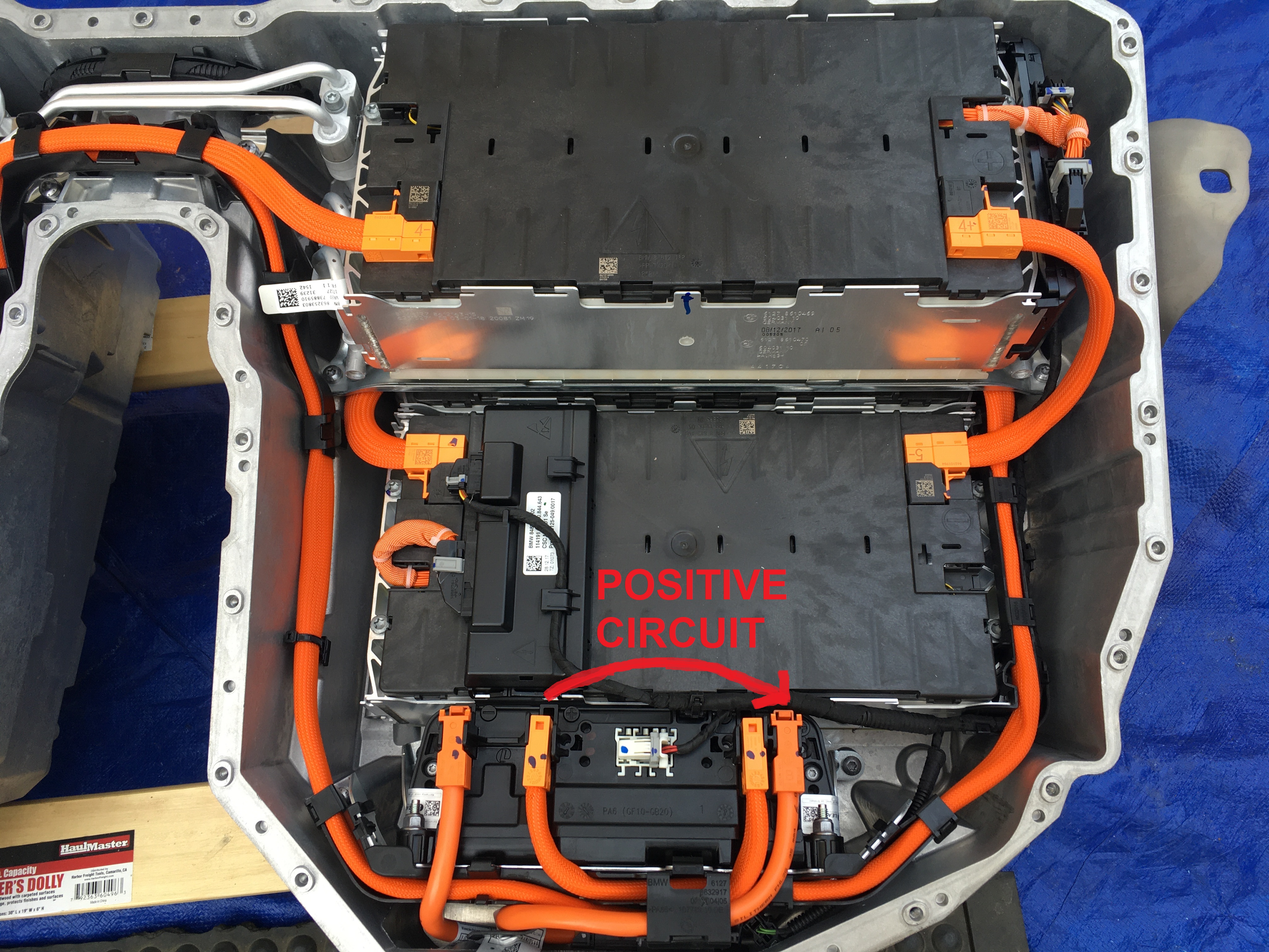

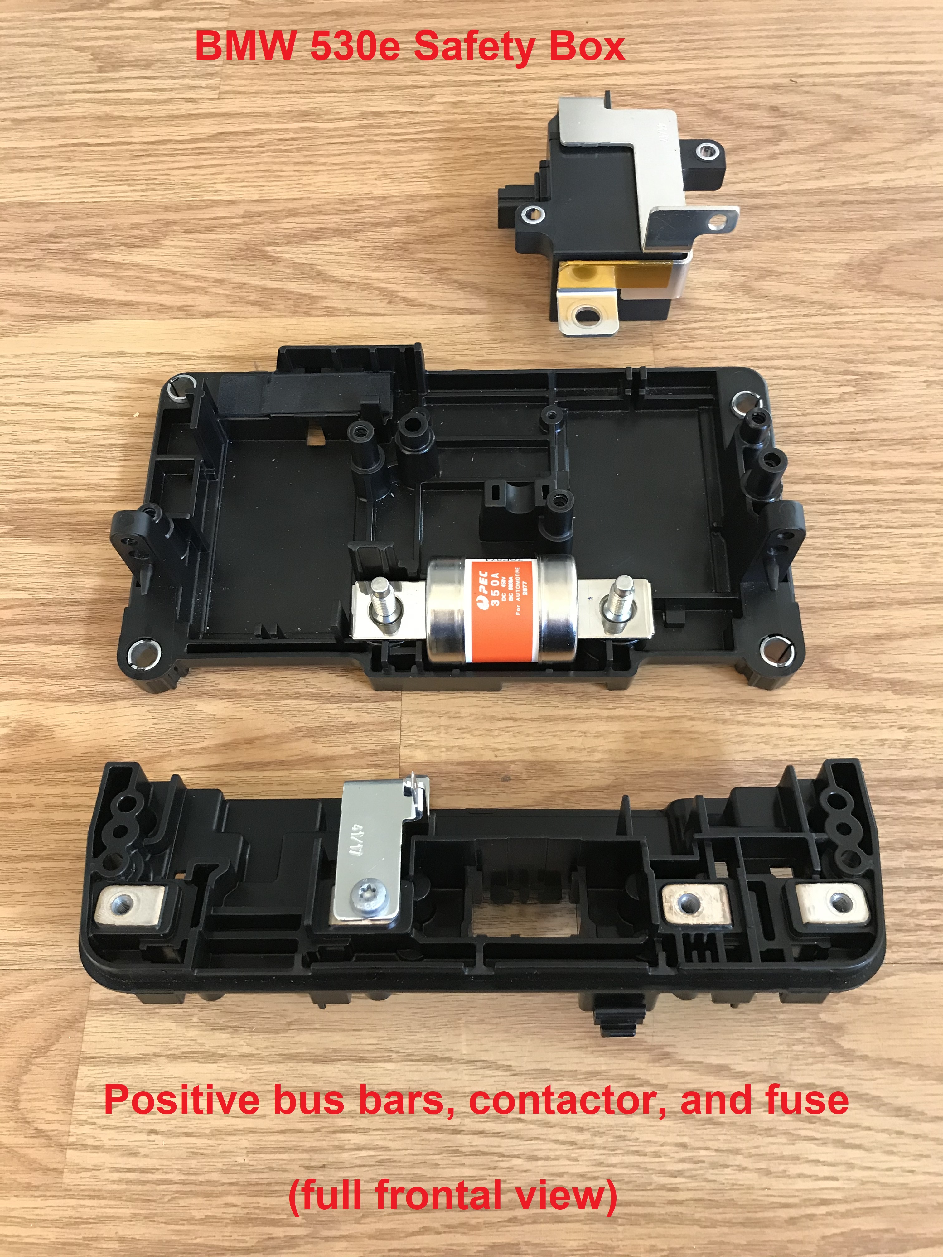

I finally fandangled with my 2018 530e HV Battery Pack Safety Box today and think some of you may find these pics useful, as I was perplexed by all the German zigging and zagging inside of this box
apologies I wish I had the forethought to use the same orientation as above
Gregski
Posts: 3158
Has thanked: 629 times
Been thanked: 1607 times

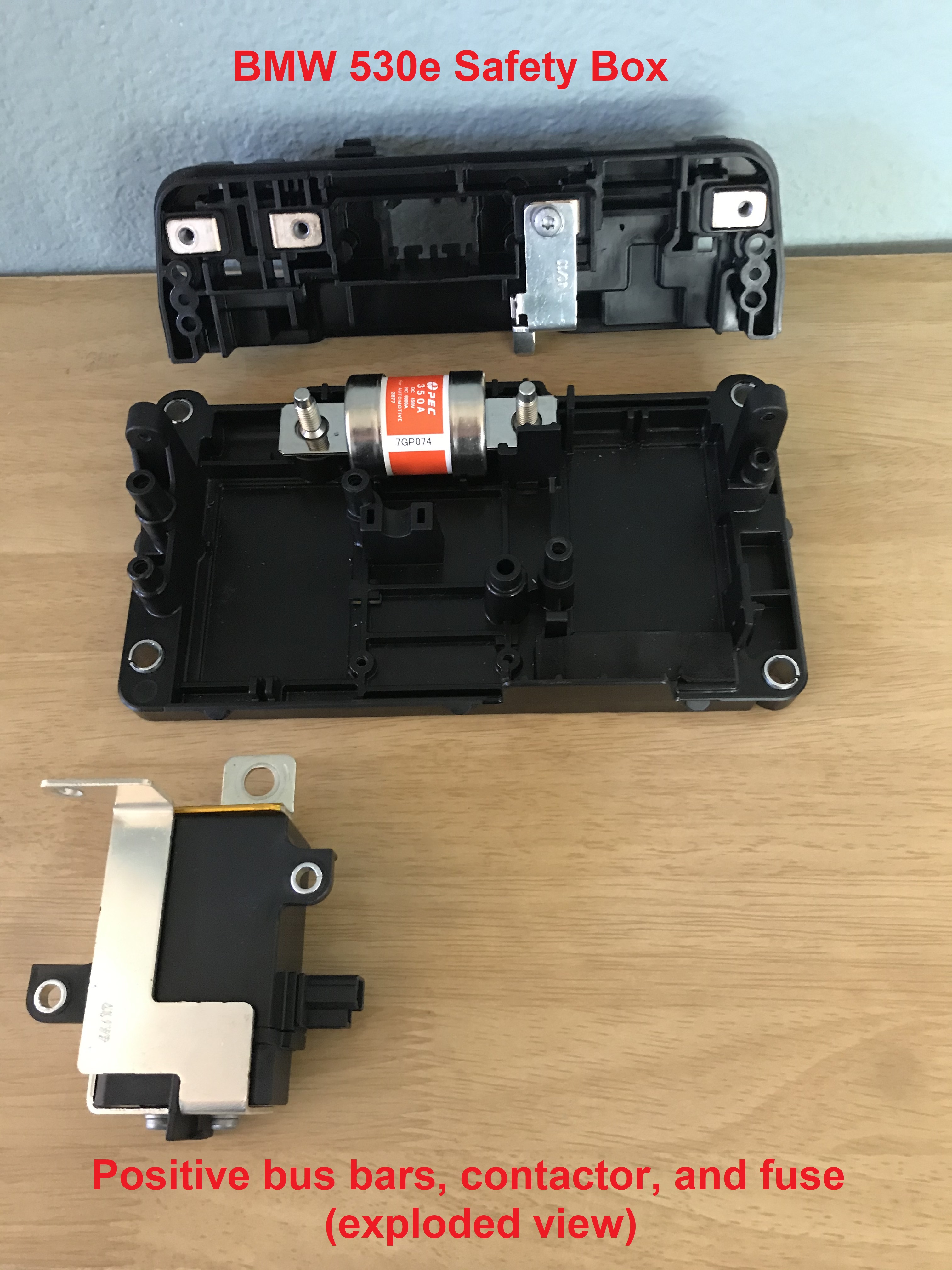

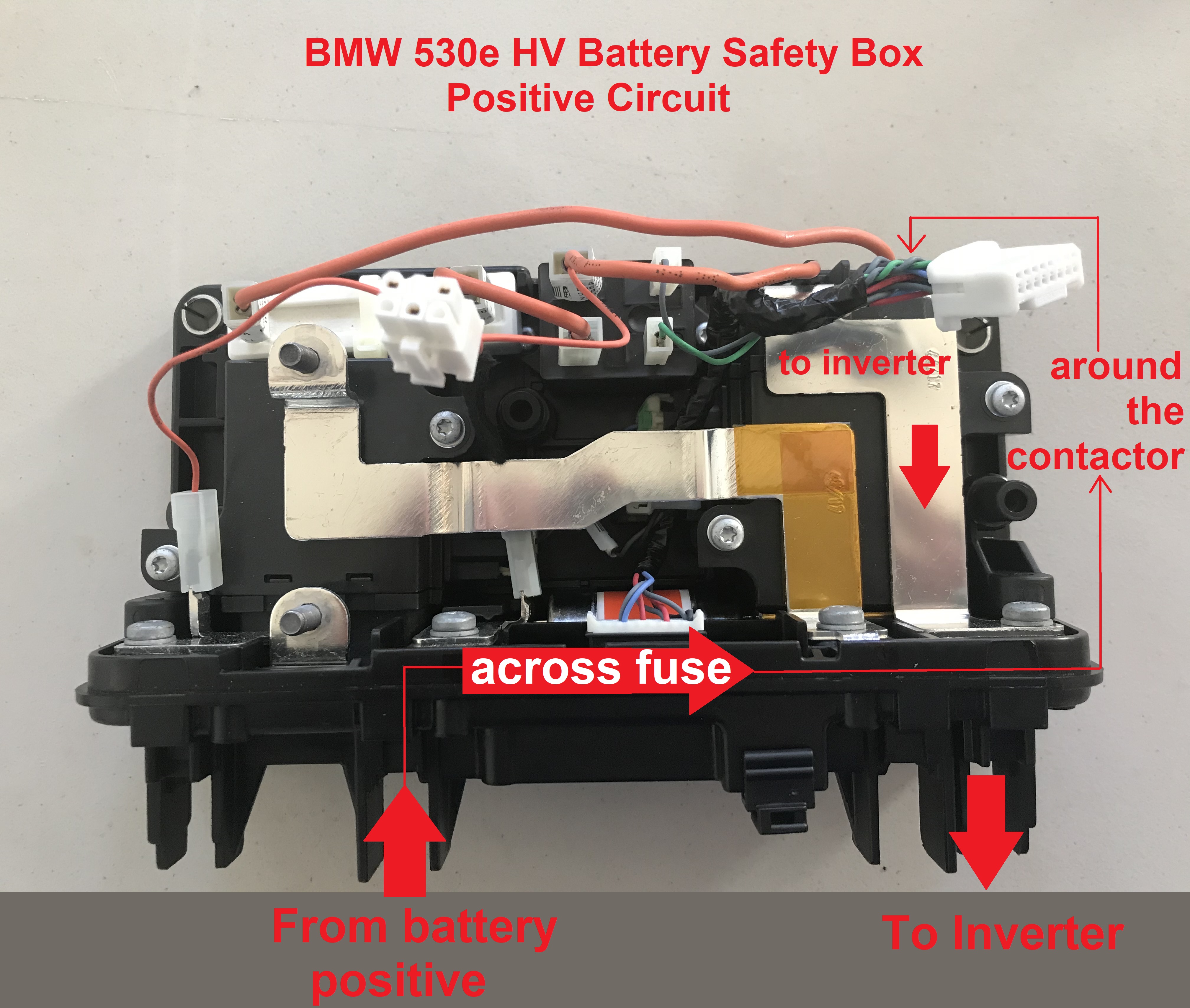

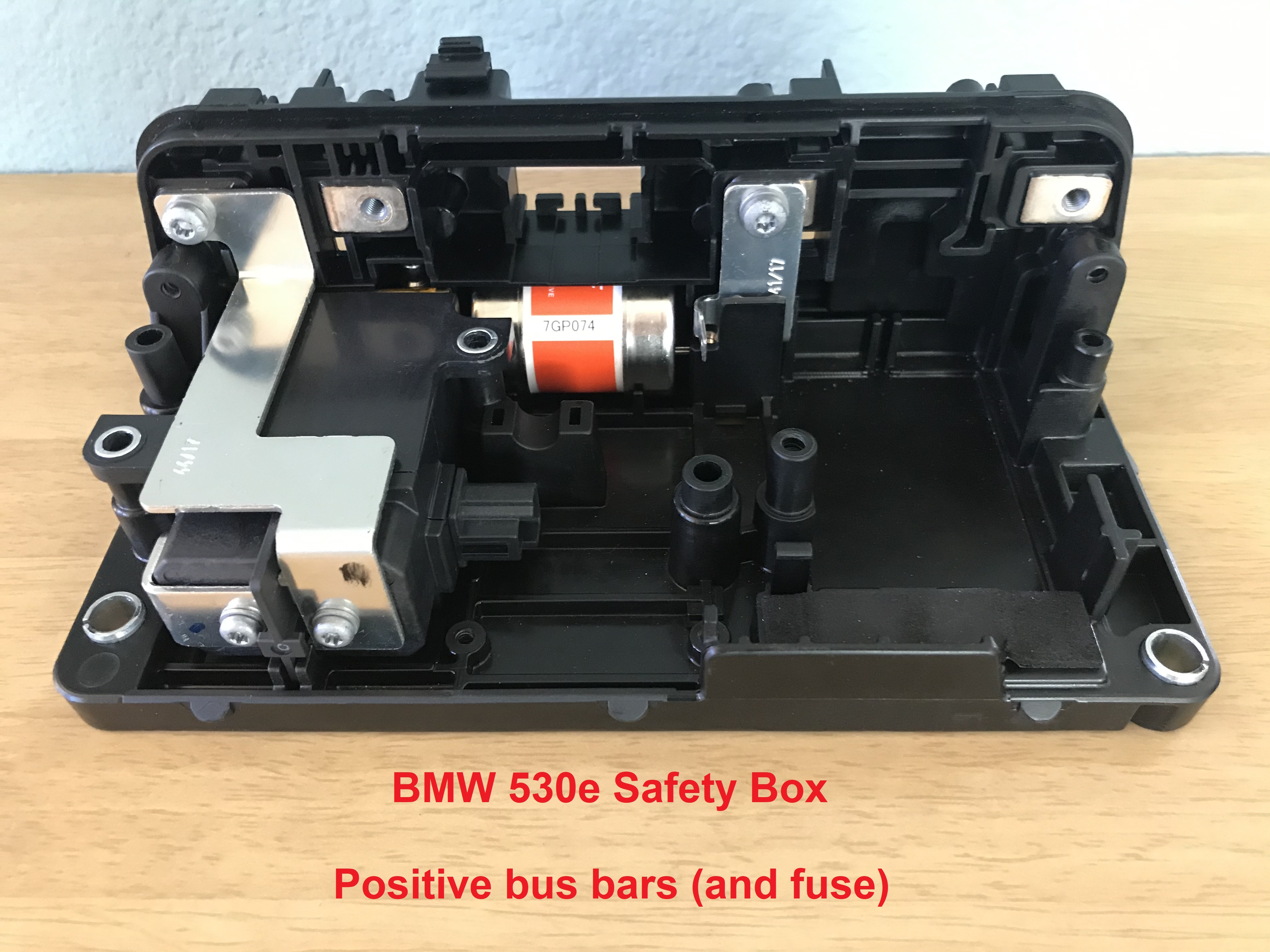

Post by Gregski »
stop being so negative...
cloudy
Posts: 210
Location: UK
Been thanked: 7 times
Post by cloudy »
Thanks! Are you able to get the part numbers from the main fuse (orange cylinder) by any chance?
