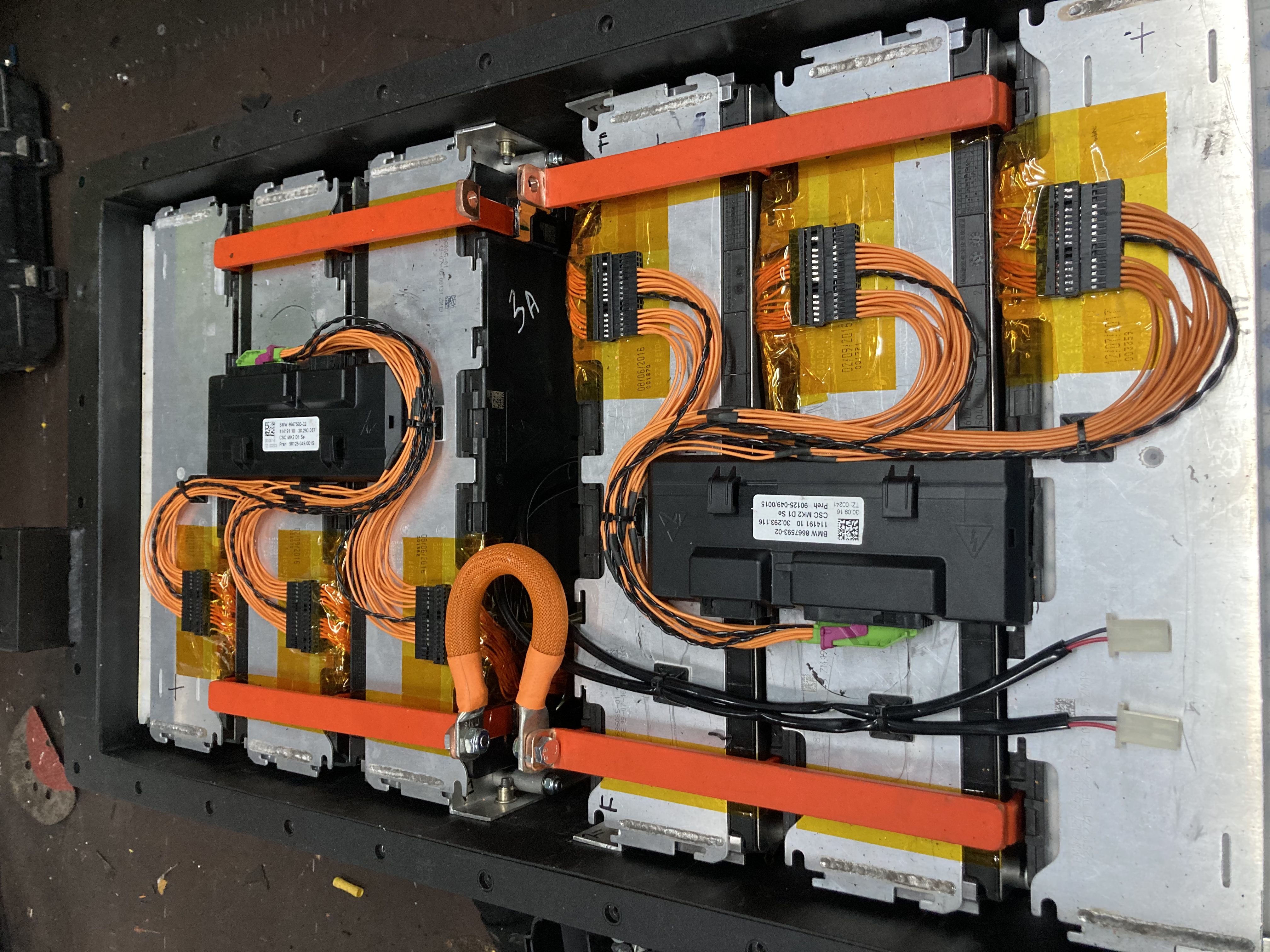

Has anyone installed these modules on their side rather than flat? Is there a good reason not to do so?

I guess since they're cooled out the bottom plate you might want to have their bottoms touching the outside wall of the battery box. Not that they get very hot by all accounts (not firsthand knowledge).

chrskly wrote: Fri Aug 06, 2021 2:53 pm I guess since they're cooled out the bottom plate you might want to have their bottoms touching the outside wall of the battery box. Not that they get very hot by all accounts (not firsthand knowledge).
This was my thinking. But the temps really don't seem to change much, at least on charging. I've only charged at 8A so far but the temperatures didn't move more than a degree.
If I can rotate the modules 90 degrees I can fit five side by side between my chassis rails, saving a load of space in the engine bay and lowering the weight down in the car. Might give it a try.

My front pack they are mounted on the side, and they front pack is normally 3 degrees cooler than the rear pack in the boot

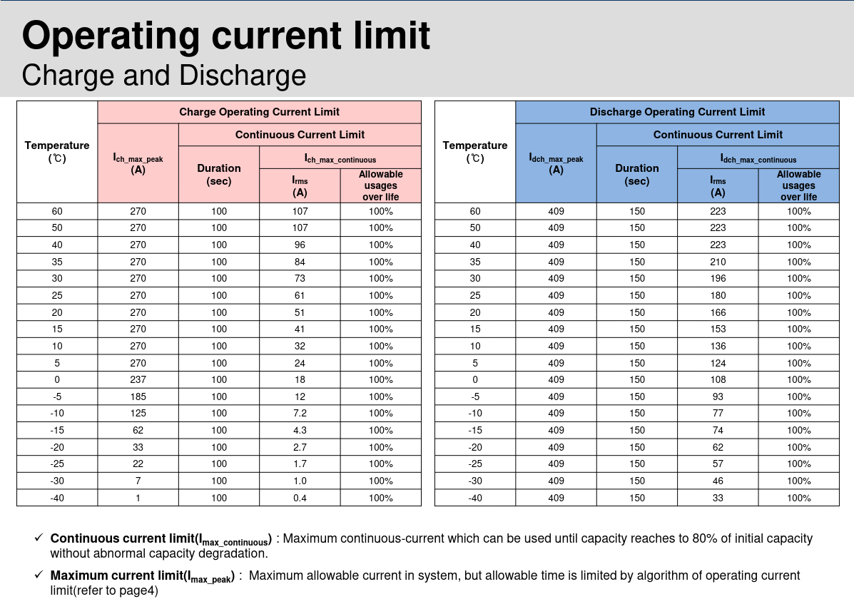

Living in Finland, the first thing I really want to know about batteries is in what temperature they can be charged. I'm planning to use these without active heating, so I needed to find some source of information.
Well, the closest I could get was a datasheet for some Samsung SDI 94 cells, which I guess are used by BMW in the i3. I think these PHEV cells are the same series, but with less energy density and more power density. I'm going to assume these can take about half the charge current of those 94Ah cells:
I think these are pretty good batteries for cold climates, as they can always be charged, albeit with lowered current. No need to waste energy heating them just to charge them.
Even so, if you have just a measly 3.3kW charger, you don't need to even think about current limits before -25°C, which is really nice. You do need to be aware of this for regen though, pretty much right at 0°C.
