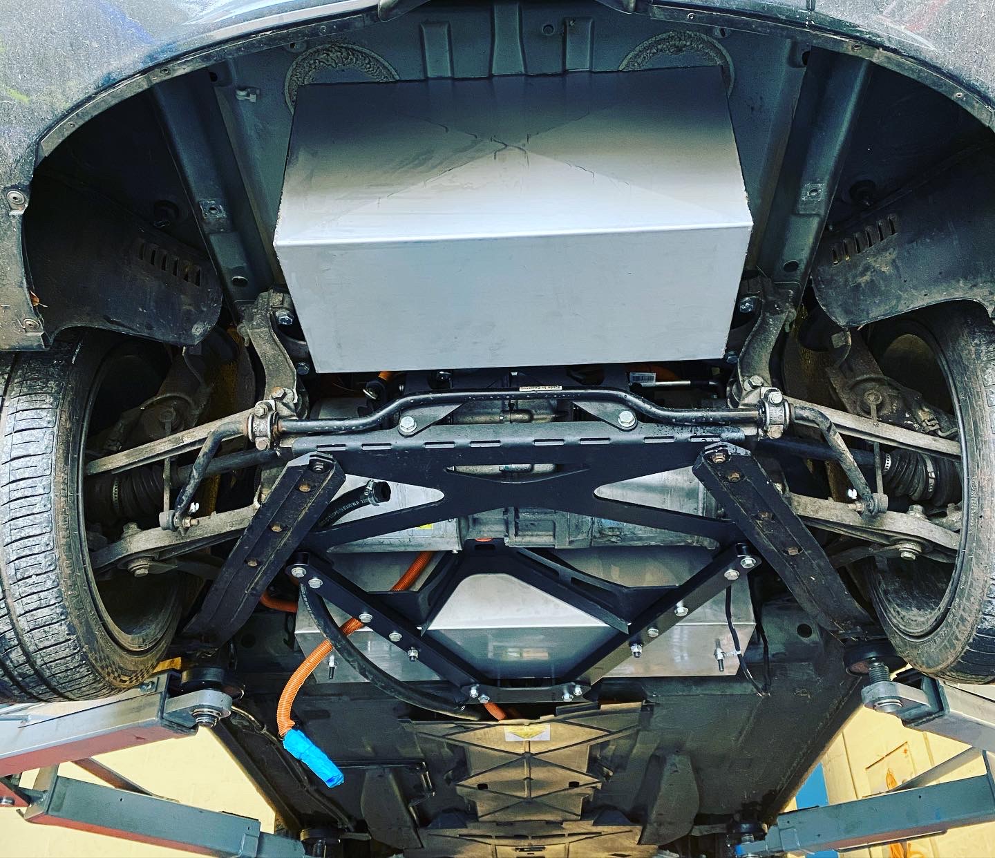

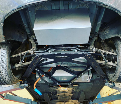

Boxster EV wrote: Tue Sep 03, 2019 5:34 pm As per my post above, the below image shows the mounting of the Hella UP28 vacuum pump (2009 Vauxhall Astra) in the Boxster mid-engine-bay. The system incorporates a Dracarys vacuum pressure switch and non return valve - everything purchased off eBay. The vacuum switch effectively provides a ground to the relay once the system has reached pressure and shuts off the pump. I used one of the existing defunct relays from the ICE relay box and wired it all in to look as OEM as possible (the wiring isn't yet finished). I managed to re-purpose most of the existing vacuum lines and just purchased a little extra to incorporate the new hardware. Total cost of everything was about £50
Everything works as expected. The only modification I think I'll need to make is to provide a vacuum reservoir to the system, as presently the relay can flick on and off a little too quickly with the slightest of pressure change and I think this would be improved with more volume in the system.

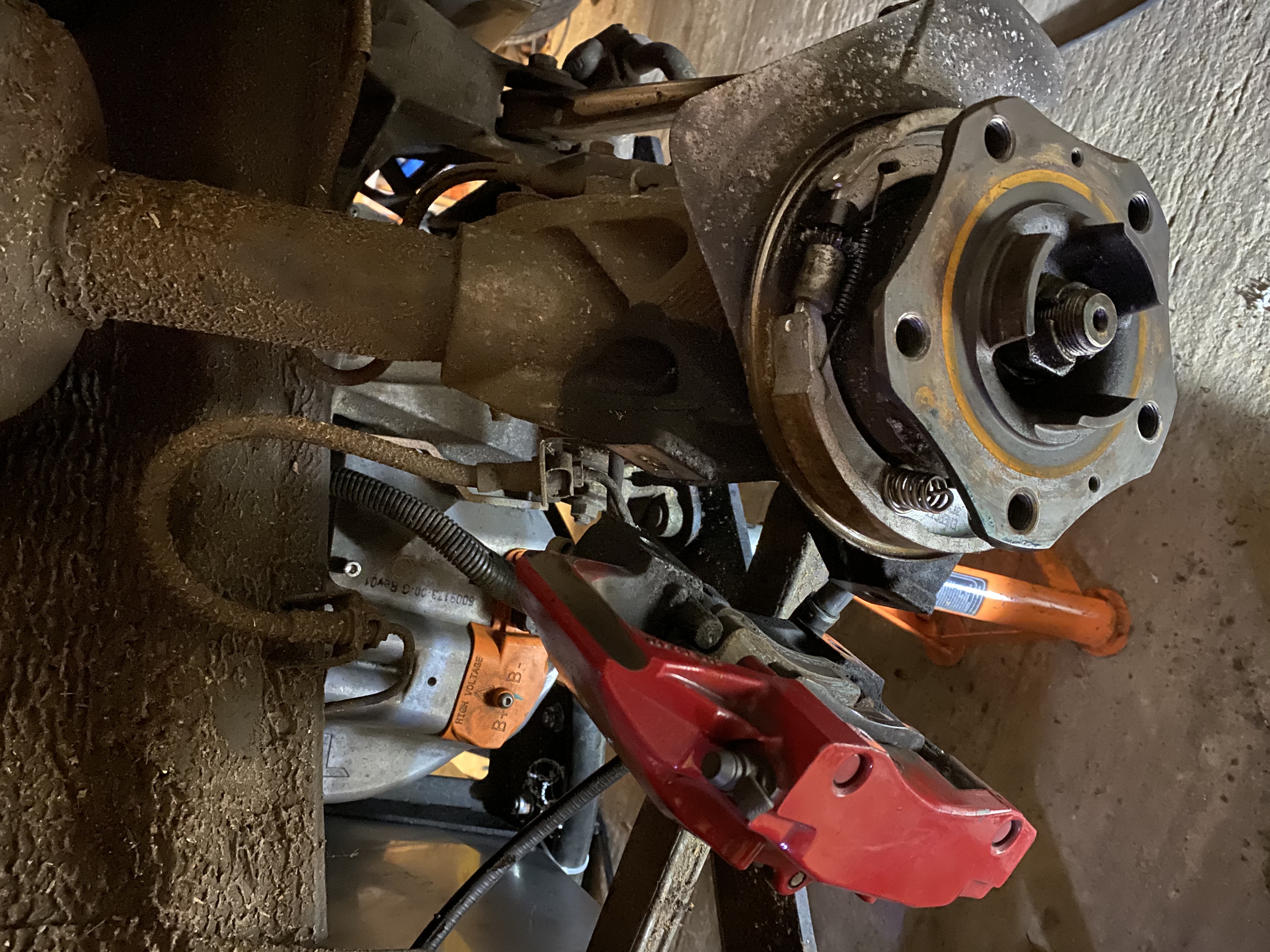

The power steering pump is a TRW unit from a Vauxhall Zafira. The mountings I've used are a little Heath Robinson however I've managed to use existing hardware and mounting holes. I've also managed (just about) to use the existing high pressure line without any modification whatsoever! The low pressure side required extra tubing. The pump spools up really well and seems to work fine - again I used an existing relay, 50 amp fuse and have wired everything to look OEM.
Here's a picture of what the car looks like underneath with just the coolant, PS, brake and A/C lines in place. I'm intending in using the existing fuel line clips to mount the high voltage cables which'll run to the cars front batteries and type 2 charge port.

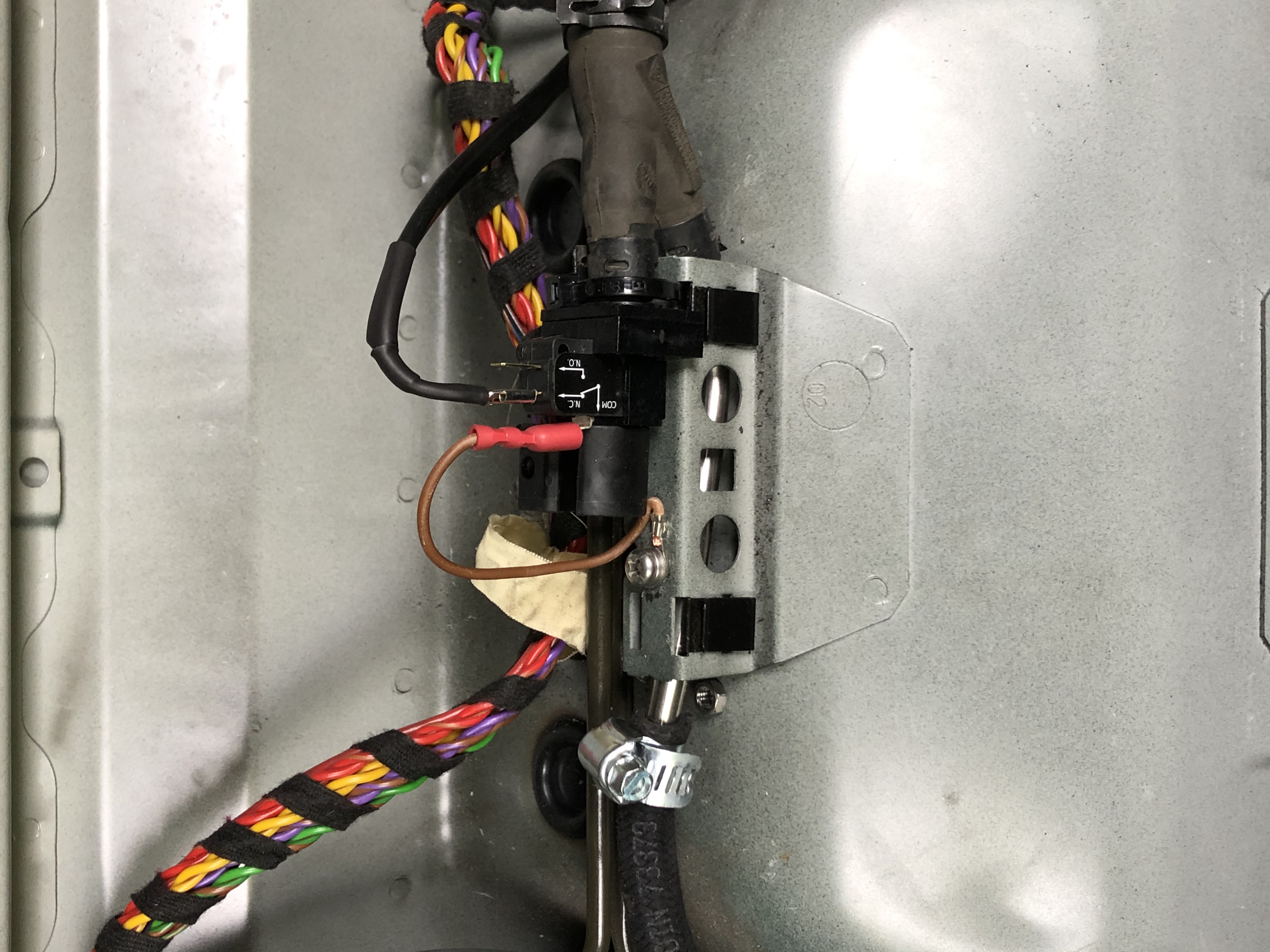

Let me update this info. I absolutely hate the mentioned switch. For a time it seemed it would only require little maintenance (WD40 spray) with copper shimm as seal and it would work nicely for 3 months. But lately it started to act up. I think membrane would stick and switch wouldnt conduct. Then servo would dry up and brakes would be heavy... I could still brake effectively, but with a heavy foot...
It now requires for me to strike it in the morning (with no13 spanner :)) and it would work through the day...
I ordered the volvo vacuum switch and i will test it when it arrives. Maybe it will fare better?
Location for vacuum pump should be somewhere you can easily have access to in case you need to reattach hoses or exchange the pump.
You want to use some lenght of hose so it acts as a buffer for your vacuum. Also dont forget to put non-return valve before the switch!

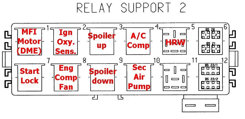

Just to respond your specific questions: For the brake booster I repurposed a defunct relay from the relay 2 support panel which is in the boot/trunk. You could use 2, 5, 8 or 10.

Some more update on the vacuum switch...
Since i sprayed the insides of the switch with welding nozzle spray (anti spatter) i got much less freezes of my Vacuum pump. It really seems like a contact would weld itself to the membrane with use. I dont have this happening with Mazda MX3 though i use the same kind of switch.

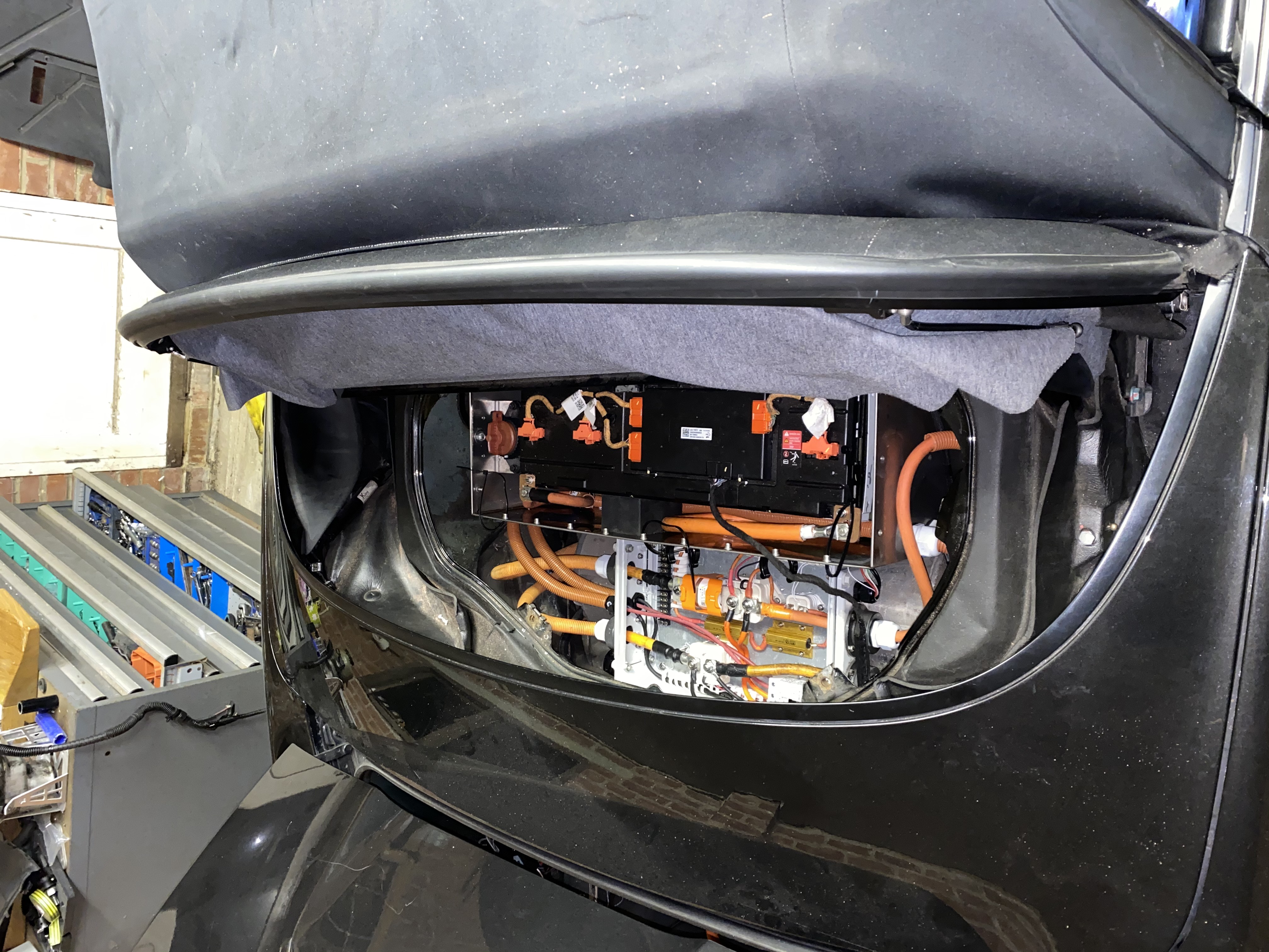

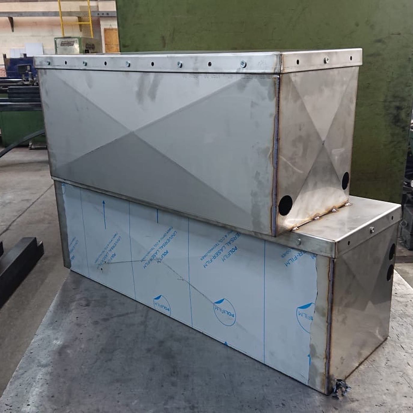

I'm just getting the components for the main contactor box together. So far I have the fuse, two - 700Amp main contactors, one 50Amp contactor, the and the two resistors.
A few simple questions:
1 - what was the size of your original Contactor box?
2 - where did you find a one with a clear lid?
3 - what is the black item between the two main contactors?
4 - What are the white fuses for in the box?
5 - what is the black/grey appendage just outside the fuses?
6 - do you have a manual disconnect for the contactor box?

Are you doing a Boxster 986 conversion? If so, don’t use such a big HVJB - where are you putting the box? The black contactor was intended to be for my charger but I never used it. I have another contactor in the front that breaks the pack in half in emergency.
The white fuses are for the charger and the dc2dc. I have upgraded them since with HV DC fuses.
You 110% need a HV disconnect. Get the gigavac version from EVWest.
I’ve got loads of pictures to update this thread. Will try and do that in the coming week. Alternatively you can see most of them on my Instagram.

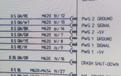

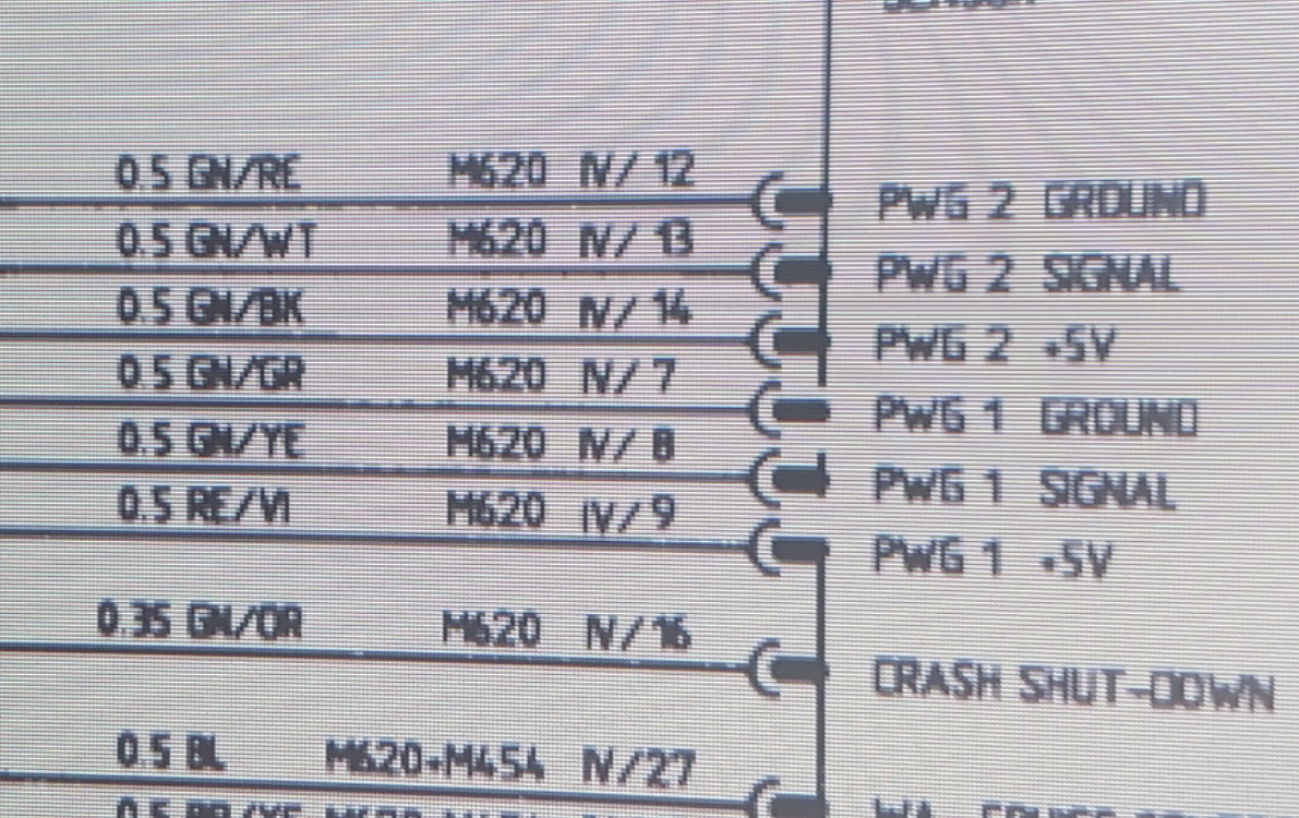

Another questions regarding the accelerator.
Did your Boxster 986 have cable or an electronic gas pedal?
The '02 Boxster S has an electronic pedal so hopefully I can tie this directly into the Tesla Open Inverter motor controller.
What electrical wire(s) did you use go from the throttle pedal to the motor controller?
Yes, my one has an epedal as standard (hall effect). The wires you’ll need to use for the throttle control go to the Porsche motronic ecu in the boot.
Here’s the diagram to connect to the drive unit (the colours should be self-explanatory:
You’ll just need to use one set (it’s a dual pot throttle).

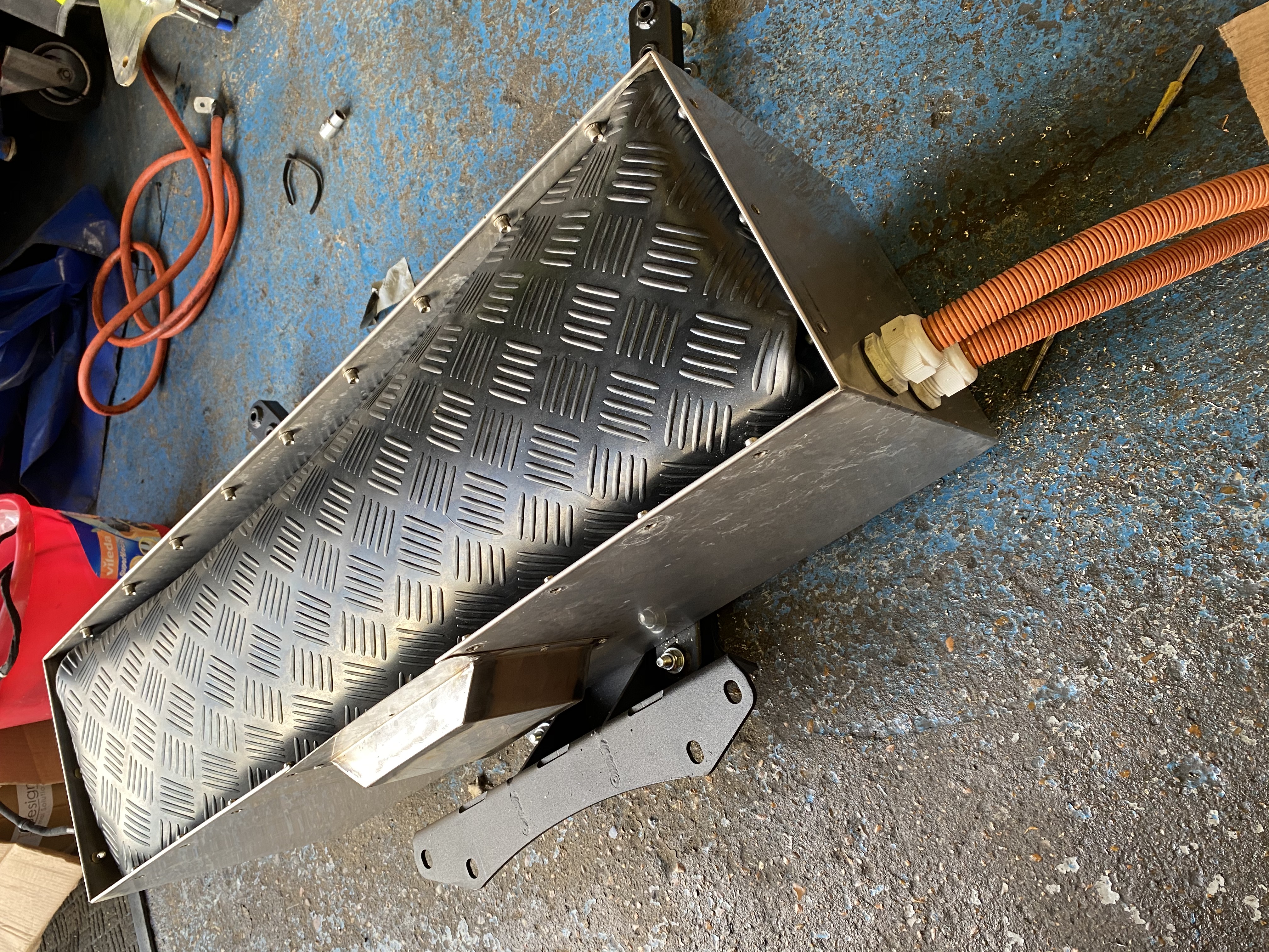

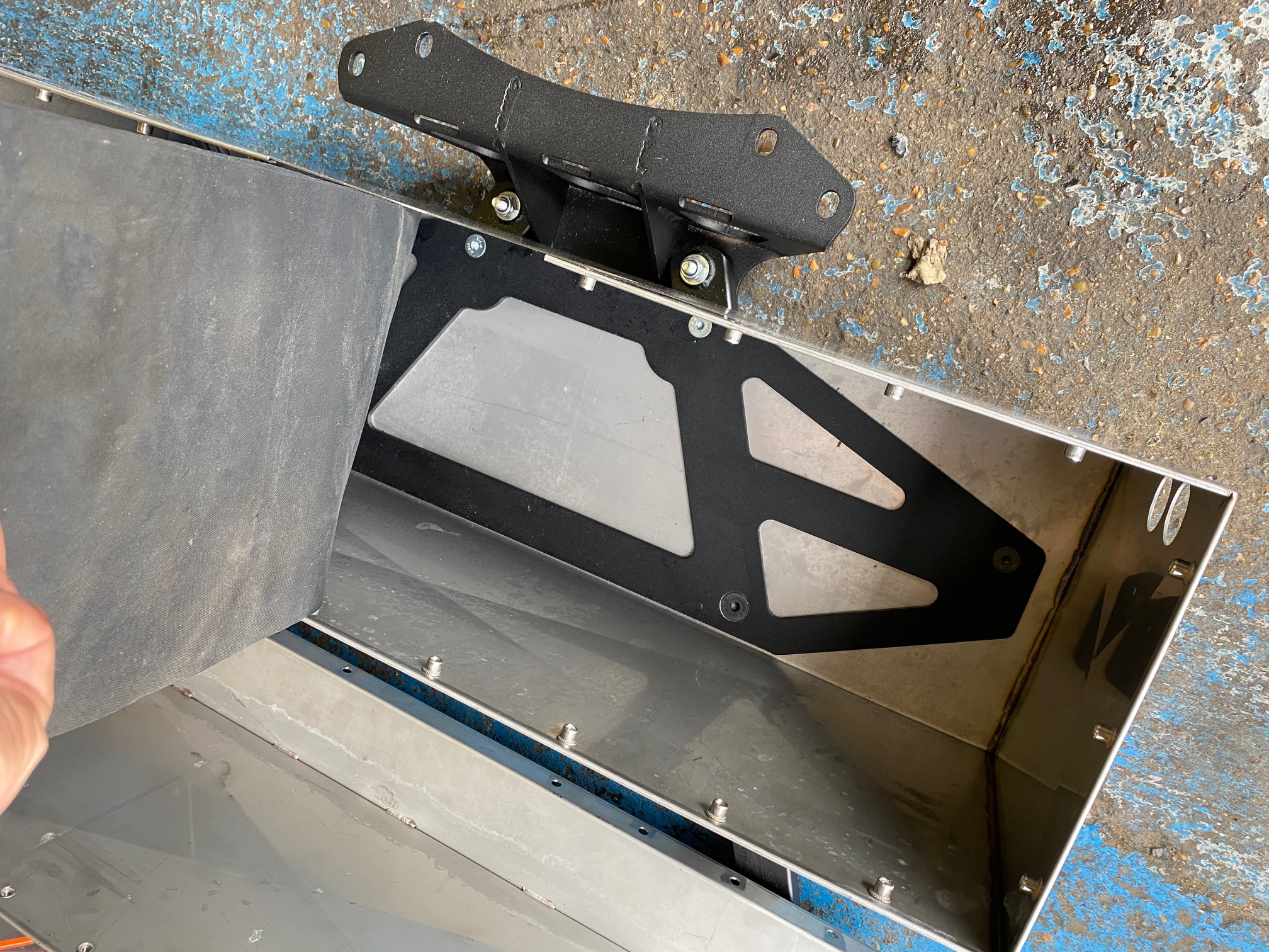

Over the past few weeks and months I’ve slowly been improving the car with battery boxes, newly redesigned HVJB and PTC cabin heating. My knowledge of messing with Arduino code has also improved (although I’m still useless), largely thanks to Jon Volk’s signposting and this has opened up other opportunities to control systems within the car.
With the assistance of a friend we (he) fabricated some stainless steel battery boxes and fitted them in engine bay and beneath the boot floor. They’ve been designed in such a way that the frame system can be dropped out of the car in one piece in about 30 minutes; battery and motor attached; and a minimal amount of unplugging. This is a huge advantage for maintenance reasons. I just need to find some decent quality shut-off valves for the coolant lines so the system doesn’t need to be fully drained each time. I’m also on the hunt for some reasonably priced IP rated HV plugs so that I can easily disconnect the front battery upon removal of the frame system.
This picture shows the largest of the boxes and the strengthening at the base, which bolts into the frame system below it. Copper battery terminal bus bars were fabricated to reduce the need to contort the HV cables and help when paralleling the packs together (the boxes are rubber lined). We also integrated small bulkhead into the lower box to accommodate the coolant lines. The bottom lid is welded to the box above it.

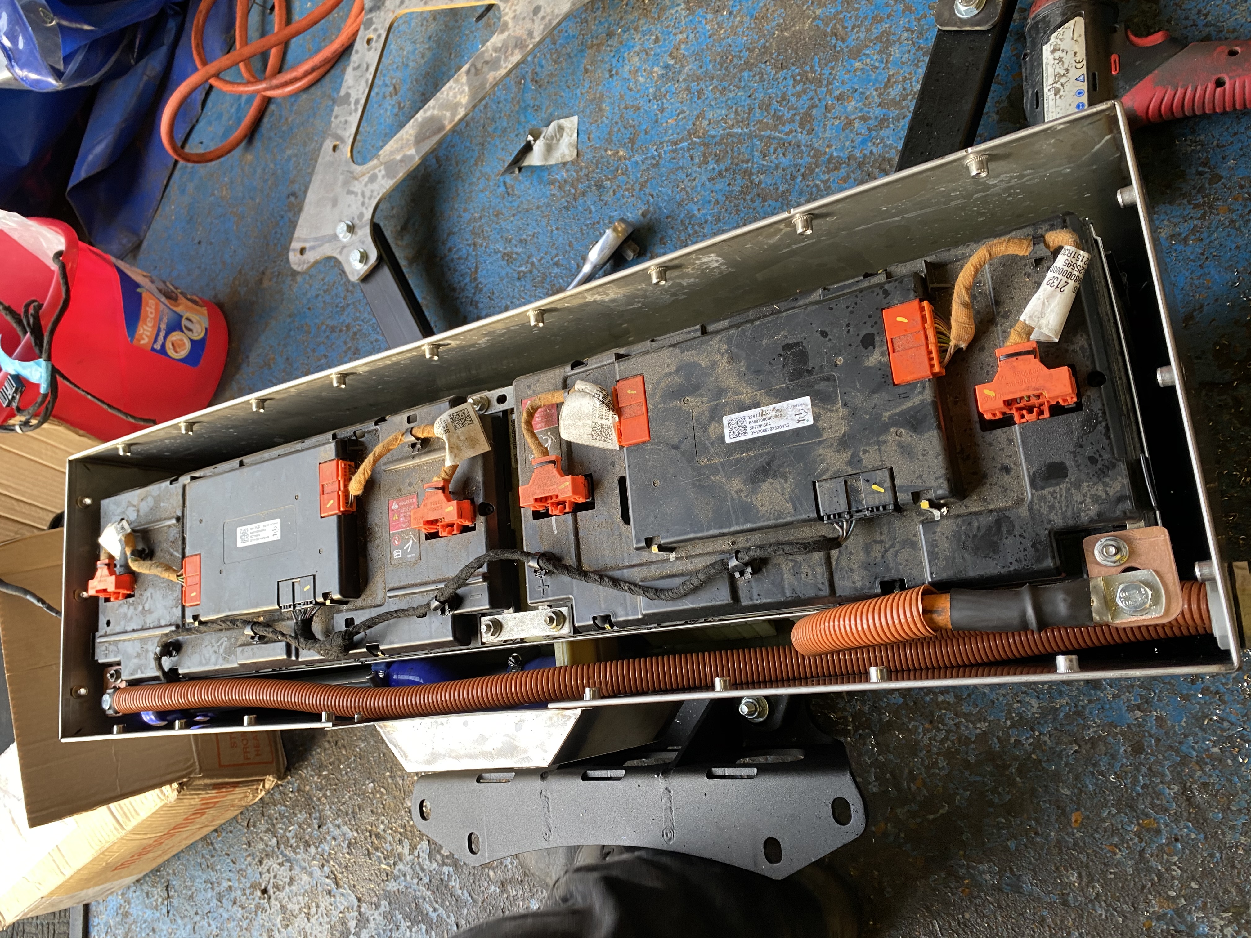

Unfortunately, during the installation it was unforeseen that that the handbrake cable would not fit around the outside of the battery boxes and therefore a bespoke cable was ordered at a stupidly expensive price – this delayed things a week or so. I took the opportunity to replace the brake shoes at the same time, which complimented the recent service on the drive shafts – new bolts, boots and CV grease.
Lower box in situ with no lid yet to be fitted (The lids attach with M6 bolts.).

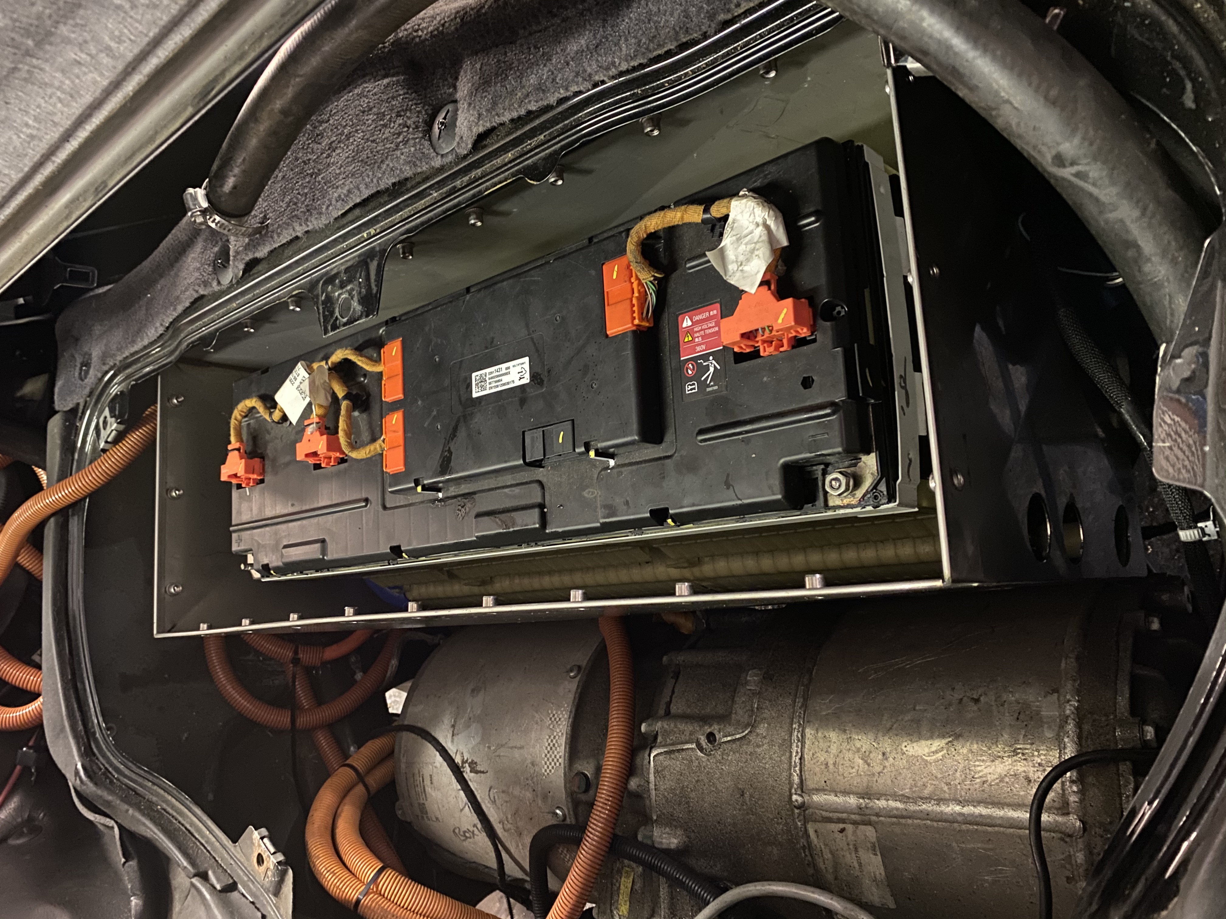

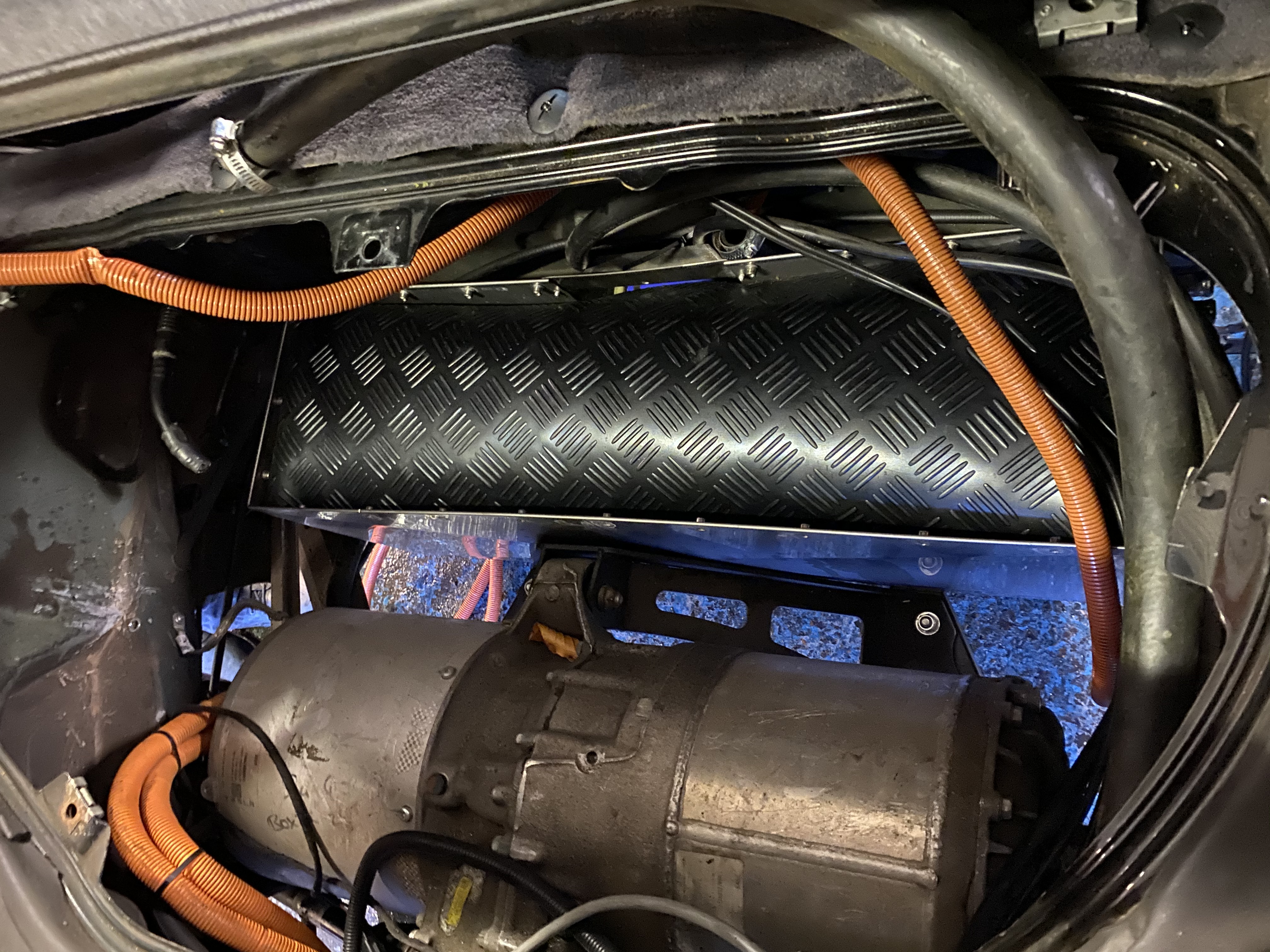

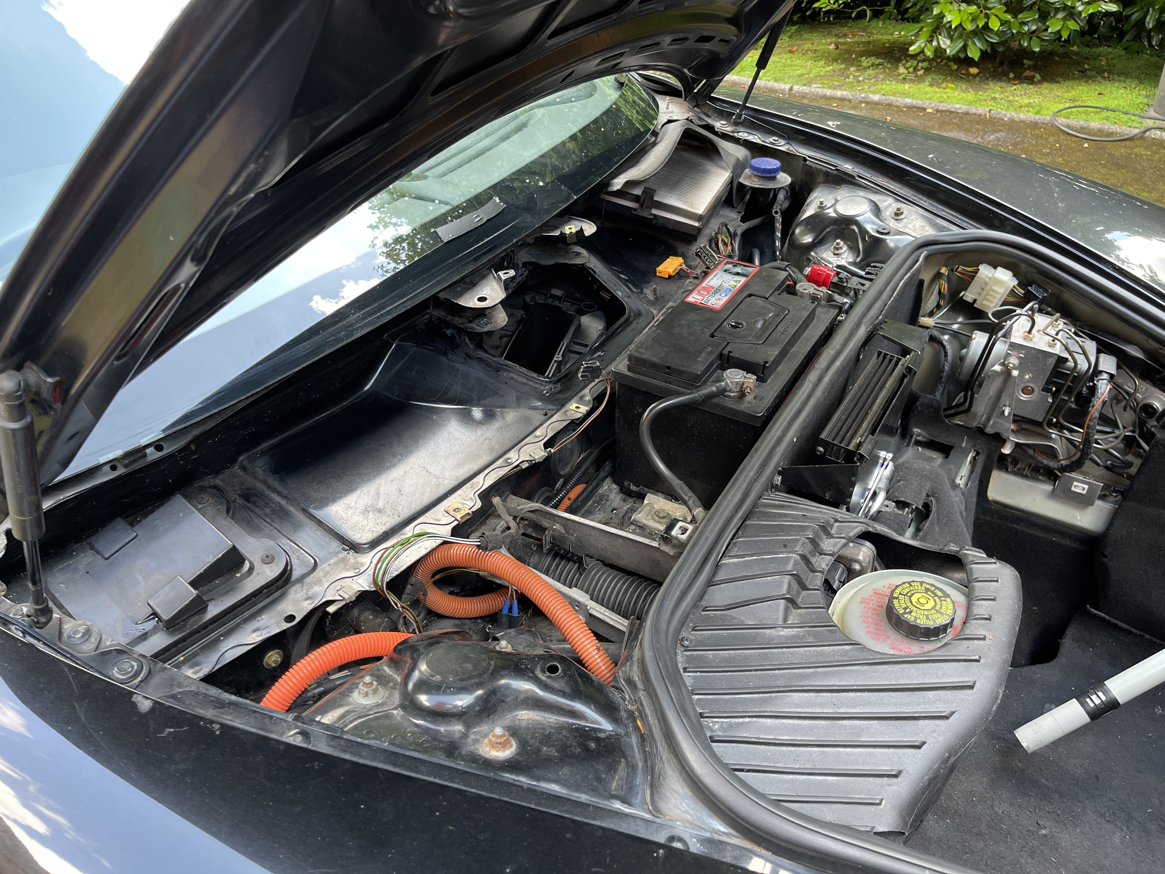

This picture shows two battery boxes in situ inside the engine bay. Before production we were careful to measure all of the dimensions accurately and this paid off as there’s about 10mm to spare between the top of the box and engine bay cover. I can categorically say this wasn’t a fluke. ;)
Underneath the car looks like this: The rear box houses the second mid-size battery brick and is welded into the boot floor of the car. I’ve not included a picture inside the boot at I’m still working on the rats nest of OEM LV wiring and waiting for my mini VCU to arrive. The Porsche DME motronic system still needs to see some signals in the car in order for the ignition and auxiliary power management to function, therefore going through the process of depinning and removing the unwanted ICE elements of the car’s harness is painstaking. Trying to make the conversion as clean as possible therefore didn’t want to stuff unwanted wires out of sight and forget about them.

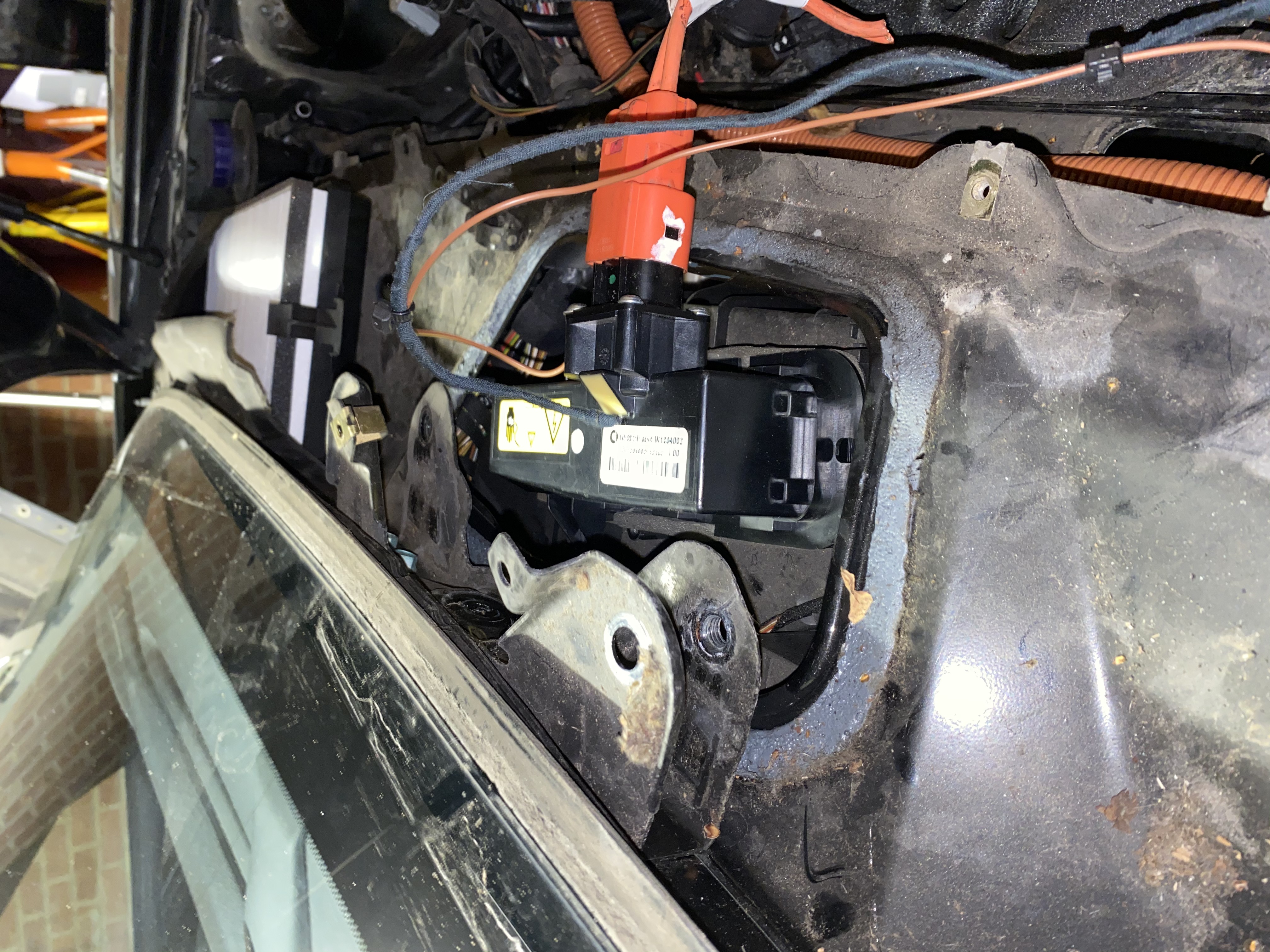

One thing that I hadn’t considered is whether my HVJB would fit in the engine bay after stuffing it full of batteries - It doesn’t in the current form factor, which was a bit of a blow, meaning that I had to knock-up a smaller one, and I spent a whole day doing just that. However, because I’m an idiot, I wired the LV side in such a way that enabled the DC2DC under load before closing the main contactor (and left it like that for about 30 minutes pulling current through the pre-charge circuit) and melted the side of PVC HVJB that the pre-charge resistors were bolted to - I could have cried. Therefore, I’m now onto HVJB V3 with both DC2DC and PTC heating only enabled after the main contactor closes. You live and learn. But hey, at least the DCDC HV is connected on the OEM side of the contactors, right, Arber333? ;)
HVJB V3:

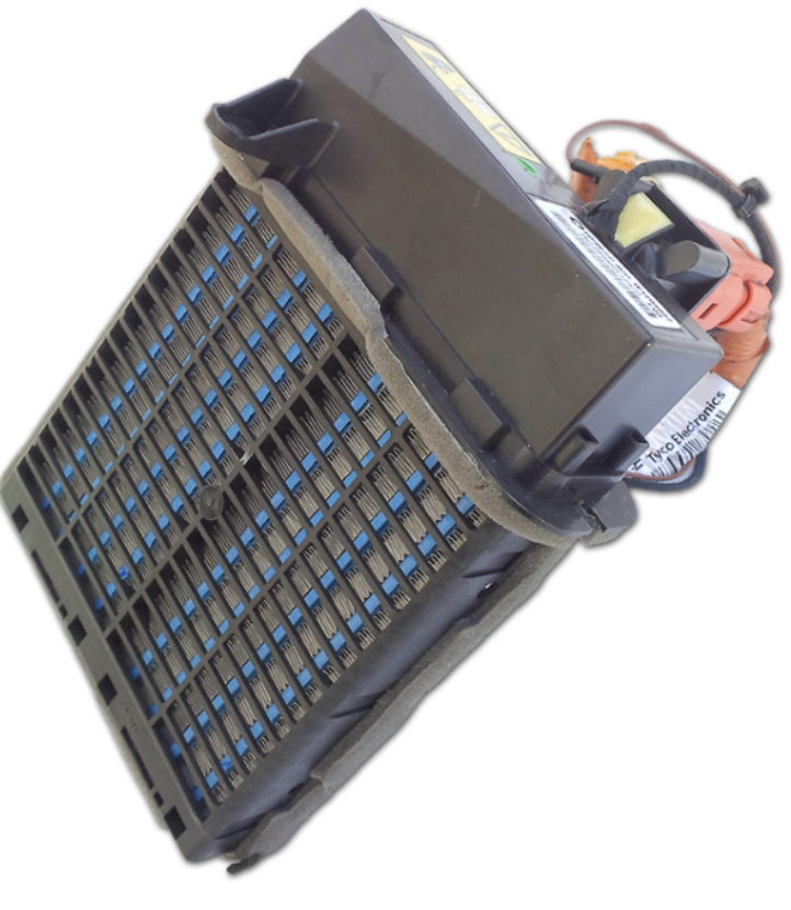

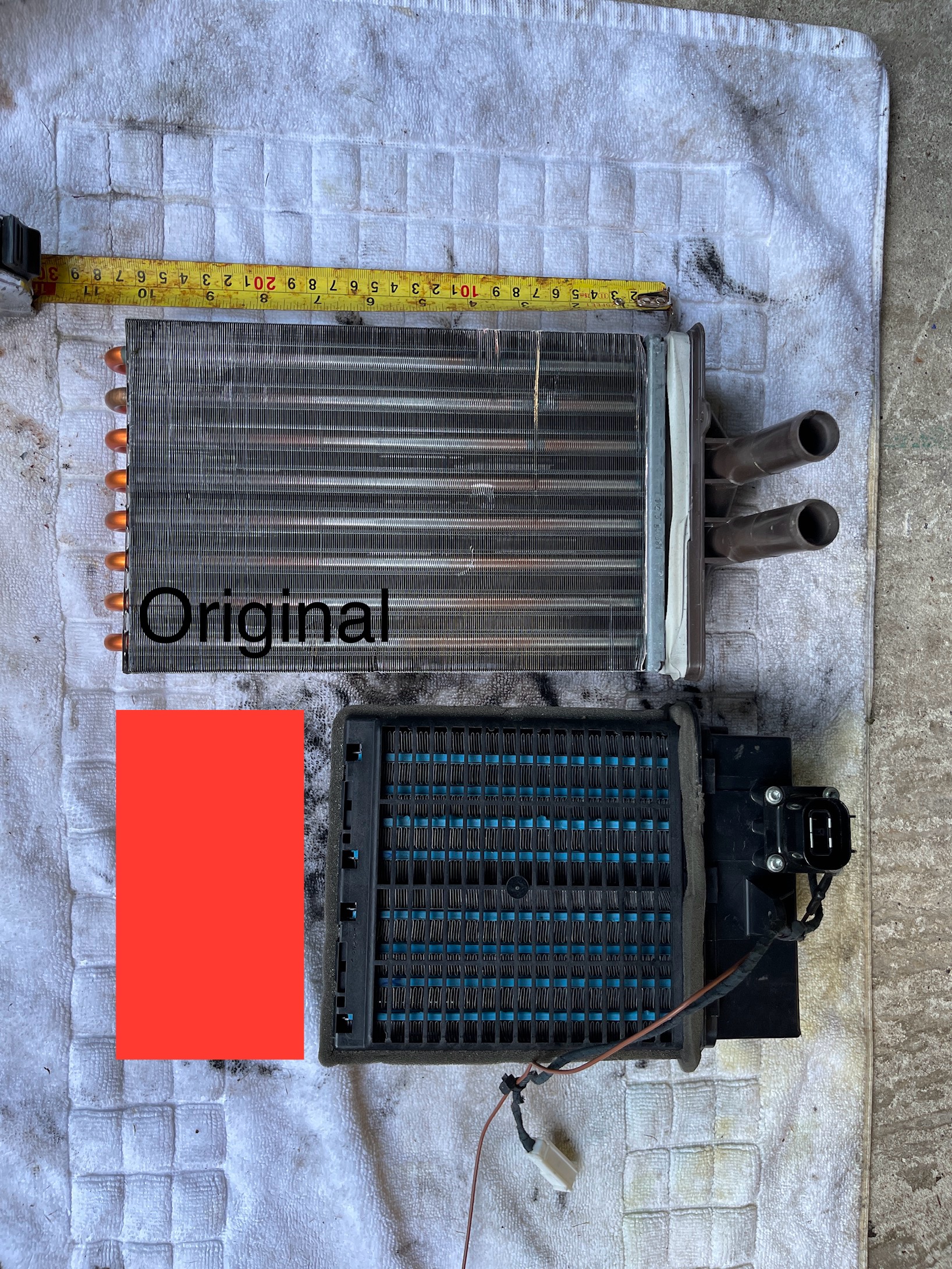

Moving on to the cabin heating, I sourced a PTC heater from EVWEST that fits perfectly into the aperture of the car’s original coolant based heater core. Following some help from Zero EV, I’ve actually got it working via the car’s OEM digital climate control panel (analogue signal sent to Arduino to close relay → to close HV contactor) – it’s fairly simple, but does the job – need to just wrap fan speed signal into the equation. Here’s a few pictures showing how neatly it fits (Waterproof membrane and cowling not yet refitted):
