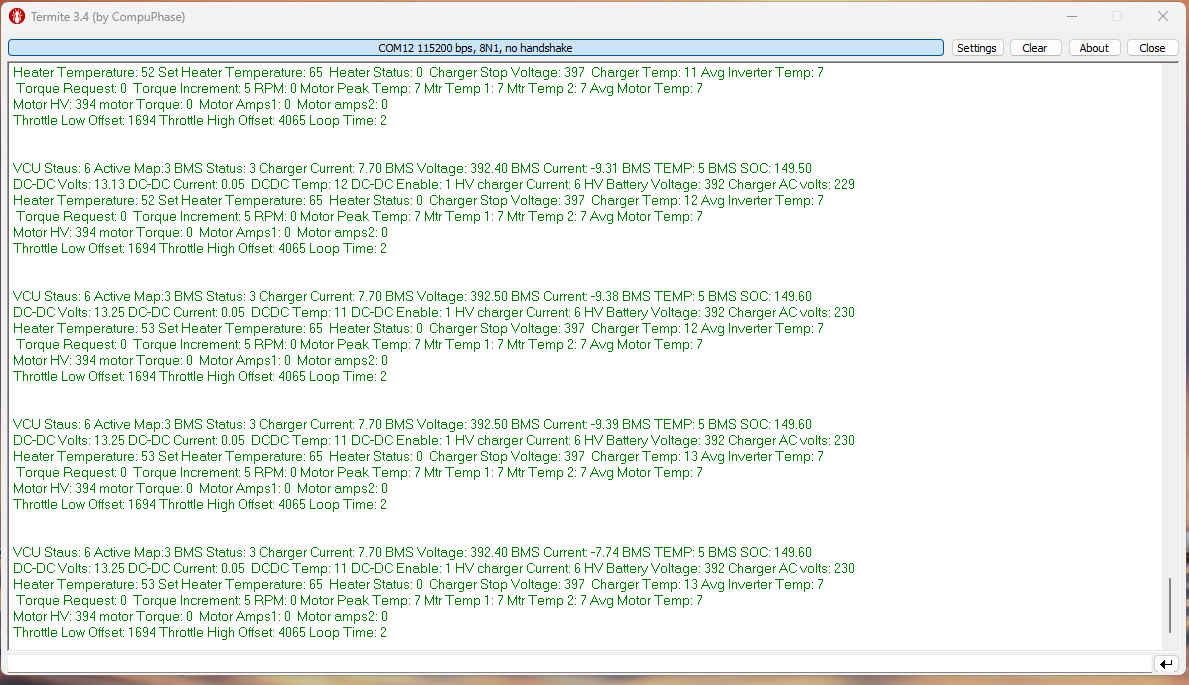

From some posts back i developed new Teensy 4.1 VCU board here...
https://evmeganetech.wordpress.com/2025 ... velopment/
Part of design was curiousity and making the most out of the wiring. But i also wanted more options for controling CAN decvices such as ZEVA BMS.
My VCU allready operates on CAN2 channel and there are Inverter, Charger, Heater and AC compressor on that line.
Plan was to fully utilize ZEVA CAN reporting on channel CAN1 to gain actual Voltage, Current, Temperature and SOC reports from ZEVA.
End goal is VCU integrated BMS and CHADEMO charging which should be operating on its own CAN bus. That would be CAN3 then.
There was just ONE obstacle! And that would be my VCU couldnt read ZEVA CAN traffic. Could as well be a mile apart!!!
I tried to change CAN transciever, replacing 120R resistor, i even tested another ESP32 board connected to the same CAN.
To make long story short, i forgot that mailboxes for FlexCAN library specify which ID AND which type of message would be filtered in.
So i forgot to set them up to receive extended CAN messages....EXT.
I really needed to cleanup the code...

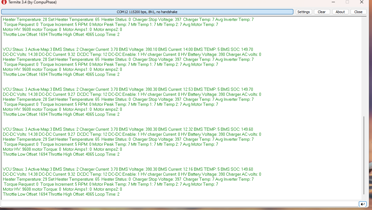

Now that i received something i setup reading functions to gather data. Of course data was in form of 16bit and 24bit integers. Because there would be some aritmetic involved i decided to use float values
For the current sensor ther is an offset to allow positive and negative values. I prepared equasion to substract offset and divide by milliAmps.
The EVMS should receive battery current over CAN bus on ID 40. The packet contains a single 24-
bit value (big endian format) for instantaneous battery current, in milliamps. The value is unsigned
but with a 8388608 offset, i.e subtract this number from the received value to get a signed value
for current in milliamps.
float BMS_24current = 0; // current value is 24bit value for milliamps
float BMS_voltage = 0; // voltage value is 16bit value for 0.1V
float BMS_SOC = 0; // value is 16bit value for 0.1Ah
uint8_t BMS_temp = 0; // Temperature of the BMS - 40
void canRX_28(const CAN_message_t &msg) // receive telegram ID40 in 24bit value
BMS_24current = (((msg.buf[0] << 16) | (msg.buf[1] << 8) | msg.buf[2]) - 8388608) / 1000.0f; // 8388608 is sensor offset!
// We need to receive voltage as well
void canRX_1E(const CAN_message_t &msg) // receive telegram ID30 in 16bit value
BMS_error = msg.buf[0]; // We also receive the error status from byte 0
BMS_SOC = ((msg.buf[1] << 8) | msg.buf[2]) / 10.0f; // SOC status in AH value
BMS_voltage = ((msg.buf[3] << 8) | msg.buf[4]) / 10.0f; // Voltage
BMS_temp = (msg.buf[7]) - 40; // Voltage
Result is a good value in serial report. Evident from screenshots...
Works with heater on as well as in charging bome with negative value current report.
Now i can move to another step with CHADEMO signal programming.
