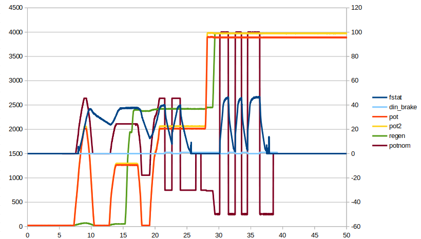

Bit more done. The serial port to the ESP32 now runs at a fixed 5.25Mbps which is the fastest speed that both the F405 and ESP32 are happy with. Looks OK on the bench with no dropped characters but will have to see how well it copes when more motor amps are flowing. This means that the binary logging, which is now ported across, can still capture all the data at the new control loop rate of 16kHz.
The binary logging is mostly working but there are still a few bugs with the data formatting on a couple of parameters. The logging also now has en extra set of buffers which allows most of the code to run in the terminal thread without the danger of missing packets when the 10ms and 100ms interrupts run.

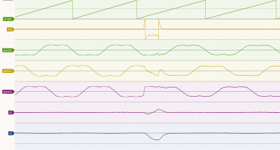

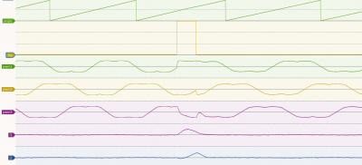

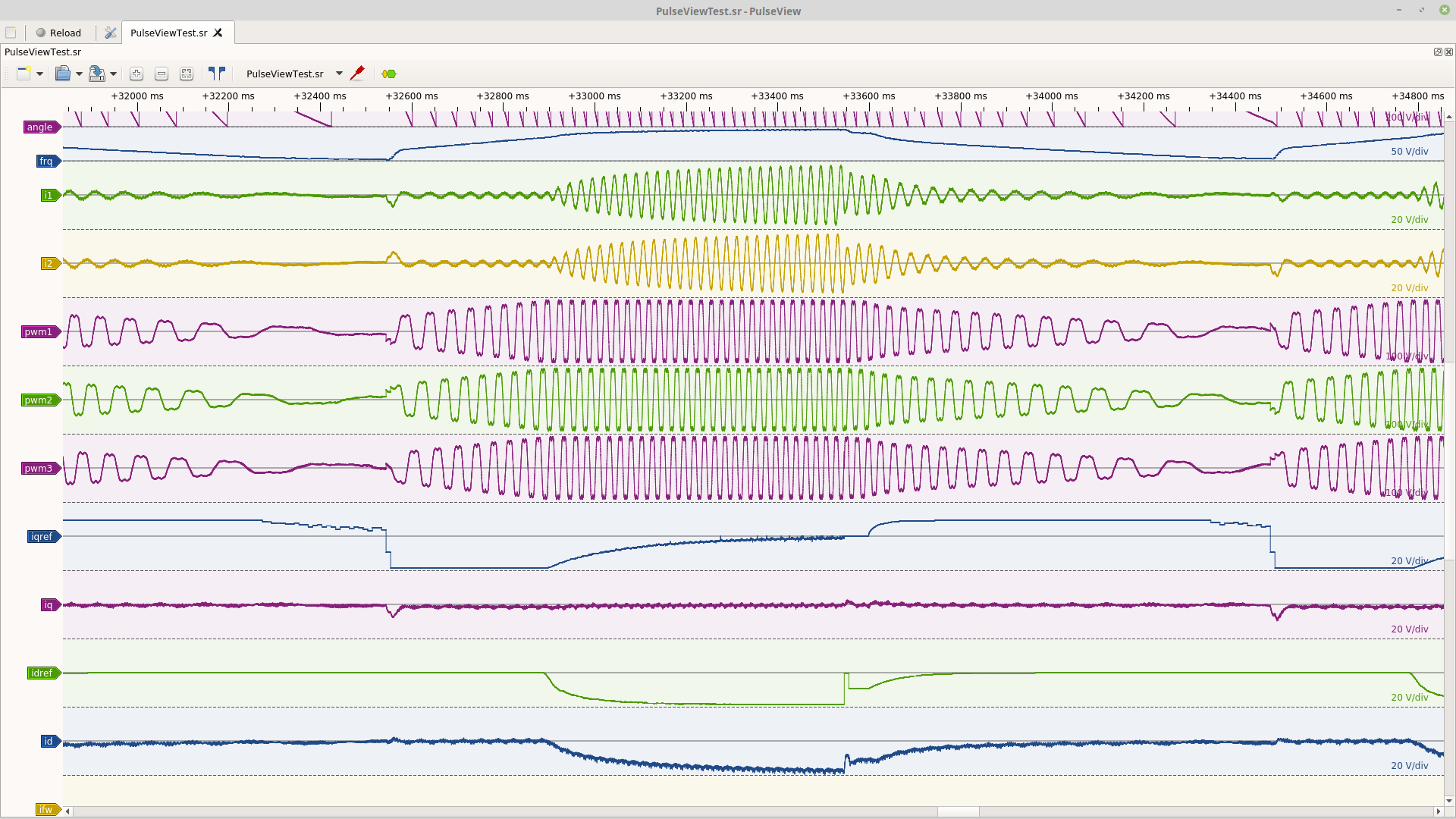

Good news - the binary logging is now working

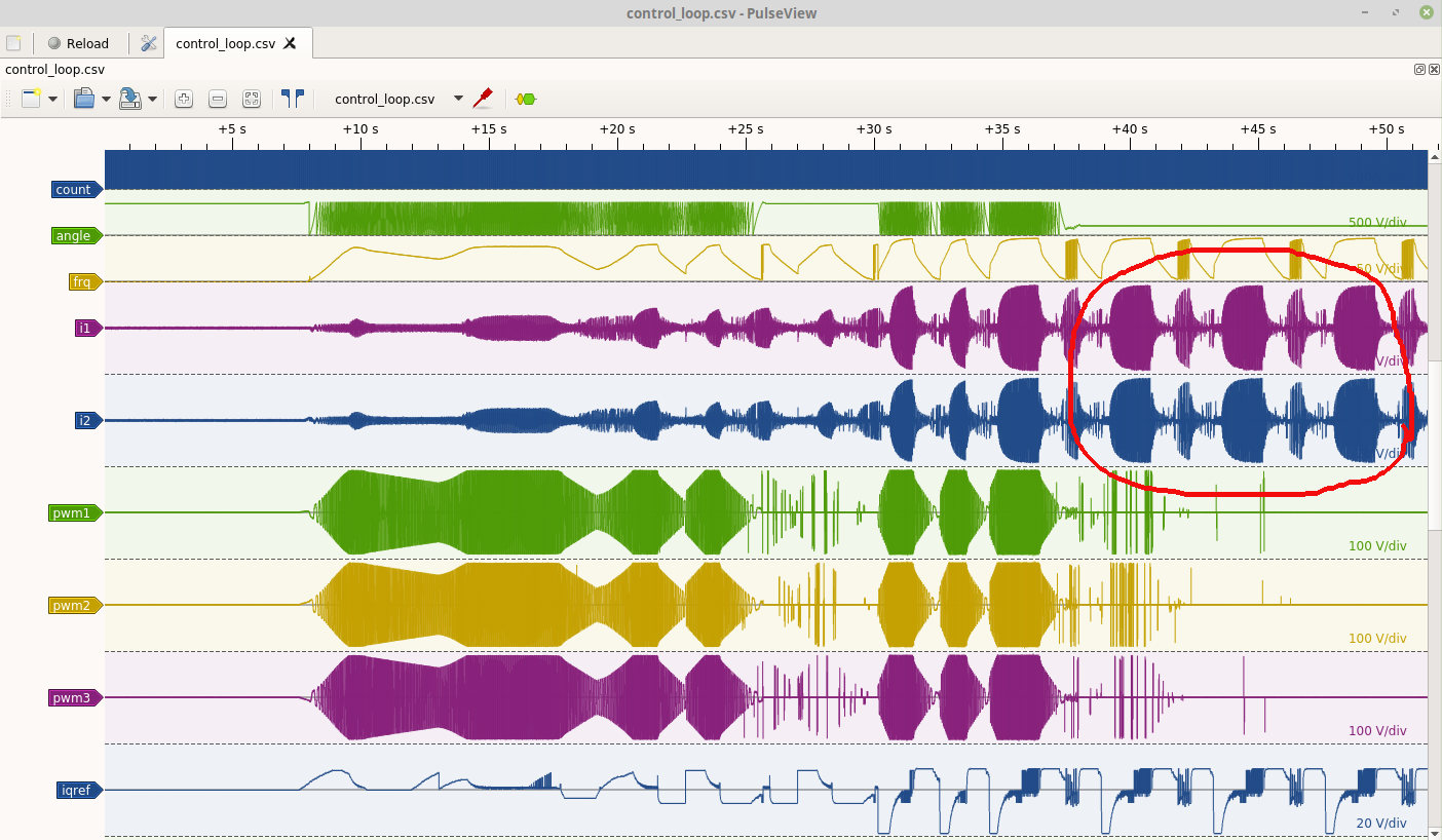

Bad news - it has shown that the hiccup when running is not a poor connection but something more serious - no idea what
This is a typical plot from the binary logging opened in PulseView. It shows the key input and control values during every pass through the control loop: You can just about see one of the hiccups at 1.31. This is what it looks like zoomed in: What seems to happen is the PWM values go a bit strange for around a quarter of a cyle for no obvious reason and then just go back to normal. The motor currents, setpoints and angle all look fine at the point it happens. The odd PWM values then cause a fairly big current spike which causes the audible knock from the motor. The only thing I'm slightly suspicious of is the resolver, I would expect to see a variation in the angle plot during the disturbance but it looks clean - wondering if the resolver IC is loosing lock for some reason? Need to do a bit more digging, and add checks on the resolver error flag, but not today!
There also seems to be a bit of noise on the motor current waveforms around the zero crossing. Not sure whether this is real or an artefact of the way the logging data is sent, again bit more work needed.

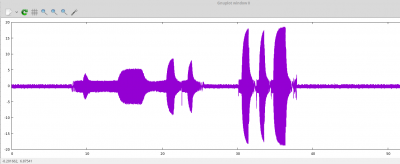

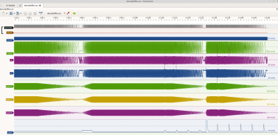

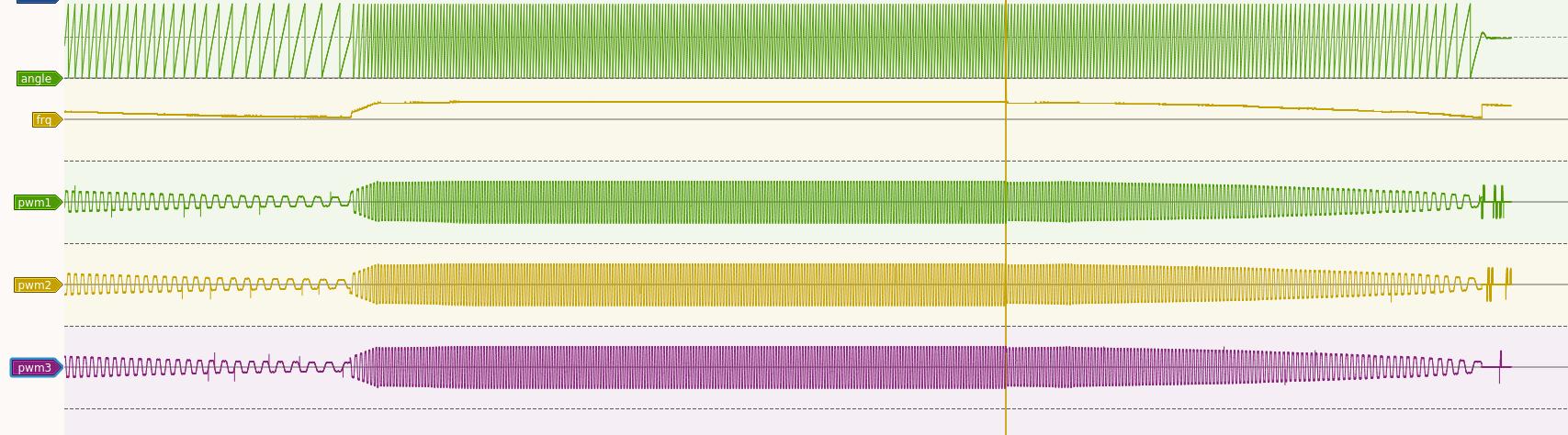

Couldn't leave it so ended up having another look.
First the resolver was throwing an error but it wasn't actually affecting the measurement. It was complaining about being overdriven so I added a 33R resistor in series with the feed to the resolver (temporary bodge - don't want to tune the drive levels properly as this is just the HSG test motor) which brought it back within limits. Reran the test and no change, no resolver errors anymore but the hiccup was still there.
Next had a good look through the code and noticed that I still had syncadv in (which I thought I had commented out for initial tests). Now this could explain the results. On the plots is looks like the angle rapidly advances and then drops back, exactly the kind of thing a misbehaving syncadv could do so I commented out the line and tested - no hiccup. Syncadv is dependant on the filtered motor frequency so next I replaced idc with frqFiltered in the logging and re-ran to see what was going on.
First a plot just to check the new frequency logging code is working: Looks reasonable, the motor can be seen speeding up and slowing down and the hiccup can be seen around 2/3 of the way though. Zooming in gives: I've had to change the scale to get it to plot correctly but the frequency, which is normally around 20, shoots up to around 1500 before coming back down (note it's overflowing on the plot as I only scaled it to handle 1000Hz) exactly at the point the hiccup happens (and slightly before anything else changes). This clearly explains why the PWM goes a bit nuts.
Next to try and figure out the root cause! Glad I ported the logging code across, not sure I'd have ever found this without!
Edit - Just done another capture of frq rather than frFiltered and this is the result: So it's still there, frq goes up to about 1500Hz too. Now this is largely back to the standard integer arithmetic F103 code (just with a cast on the result to get to a float and a different resolver interface but neither of these should make a difference) which suggests that this might also be in the standard F103 code??
Edit - no idea what the root cause is, it all looks fine - going to have to look at it fresh another day.

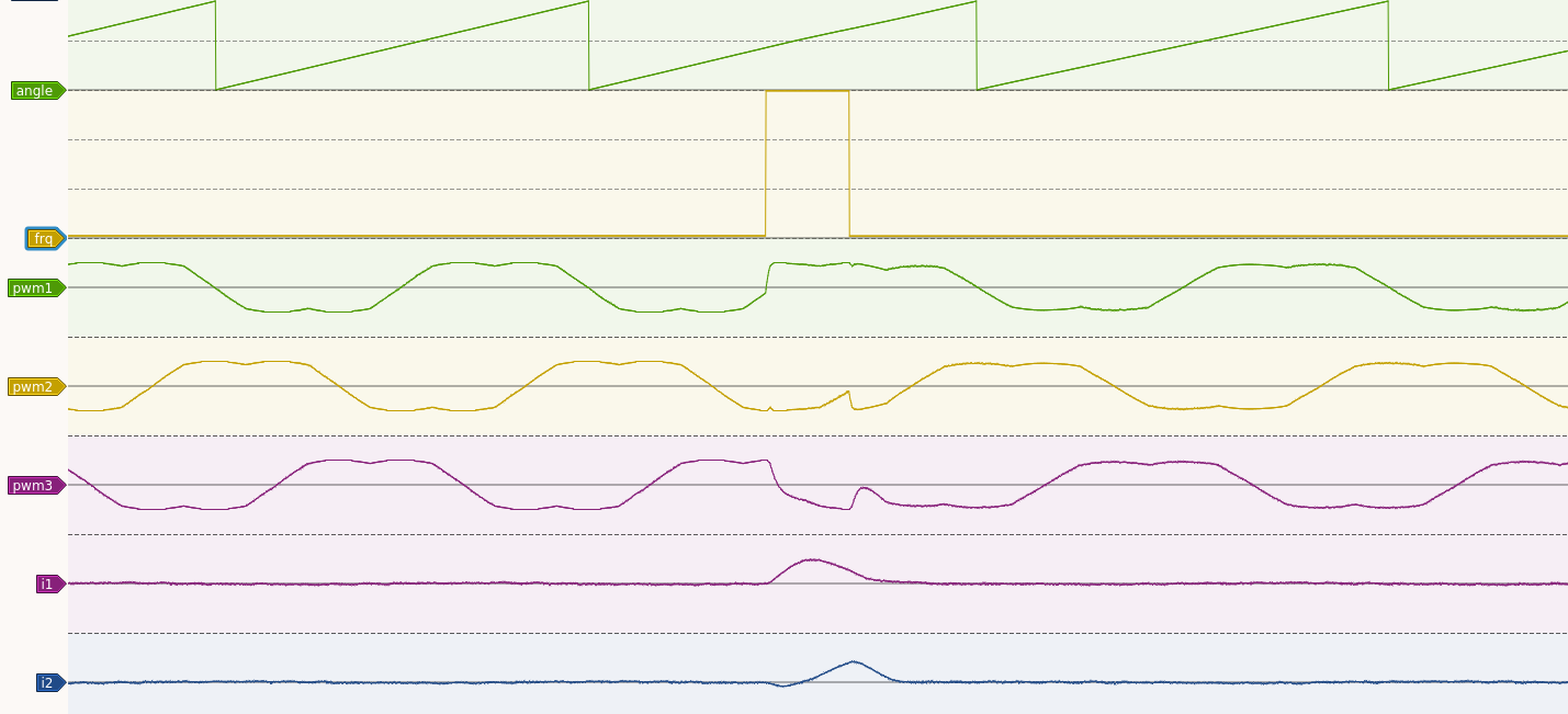

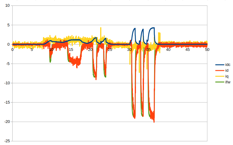

Hopefully fixed
It's been running for a while and no hiccups yet.
Haven't got a definitive cause. I'm 90% sure that it was due to the UpdateRotorAngle() function (which updates the rotor position from the resolver) being called from the PwmGeneration thread while the UpdateRotorFrequency() function (which uses the updated rotor position to calculate the speed) was called from the scheduler thread. I think what was happening was that the UpdateRotorFrequency() function was being interrupted mid calculation by the UpdateRotorAngle() called from the PWM ISR (which has higher priority). If the timing was just wrong this would upset the calculation and produce the error.
I tried all the usual tricks to fix the problem while maintaining the original code structure but nothing seemed to work - wondering whether the compiler optimisation was doing some clever code reordering that I don't fully understand. In the end I moved the UpdateRotorFrequency() function into the PwmGeneration thread (essentially it runs once every 160 runs of the control loop so maintaining the original 100Hz update rate). This seems to have fixed it.
So a question - is there a good reason why the UpdateRotorFrequency() should be called from the scheduler thread?

Interesting, should probably behave similar on the F1 and also on async machines.
Probably what happens is UpdateRotorFrequency() does its calculations, is then interrupted and when returning sets turnsSinceLastSample=0. Since the latter was increased by the PWM ISR that increase is now lost leading to a miscalculation of frequency on the next call. Frequency is used for syncadv, so it would be audible. The filtering probably keeps things in check but also prolongs the hiccup.
The main reason why it is called by the scheduler is because of the appropriate update rate. Of course it also works your way. I was always a bit reluctant to have code execute every n-th cycle because you might then under-estimate execution time of the ISR.

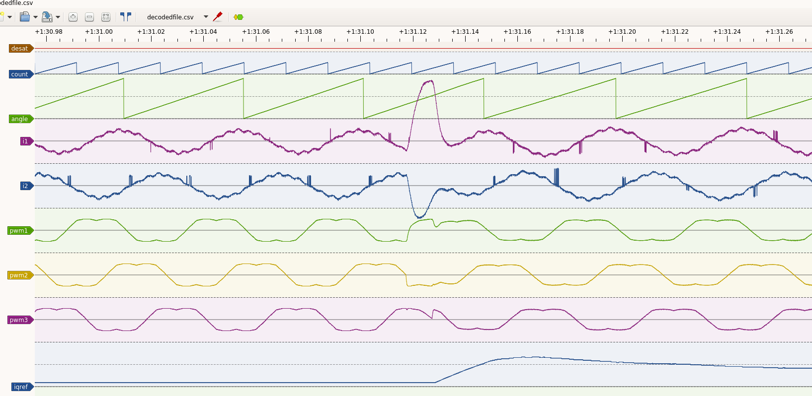

That was my first thought but it doesn't quite fit the data (it might be happening as well but would be a lot less noticeable than the one I'm capturing). On the one I'm looking at the frequency doesn't drop to zero or double it jumps from 20 to 1500, stays there for 10ms and then drops back to 20. I'm a little suspicious of the ABS macro, the define hides a bit of complexity and multiple reads of turnsSinceLastSample and if that went wrong it could have bigger consequences??johu wrote: ↑Sun May 21, 2023 6:10 pm Probably what happens is UpdateRotorFrequency() does its calculations, is then interrupted and when returning sets turnsSinceLastSample=0. Since the latter was increased by the PWM ISR that increase is now lost leading to a miscalculation of frequency on the next call. Frequency is used for syncadv, so it would be audible.
Not sure it really helps. In one of the plots above you can see the filtered data and all it does (once you allow for the logging overflow) is slow the edges slightly. I reckon the filter time constant is only around 1ms. This would equate to 2ms on the F103 code (my isr runs almost twice as often, need to remember to adjust the IIR filter to compensate). Compared to the 10ms update time it doesn't do that much. TBH you wouldn't want to slug it much more as 10ms is already slow enough to start to affect syncadv accuracy when the motor is accelerating quickly.
Agree completely but weighed against the simplicity of everything being in one thread I think simplicity wins. Plus it's only a dozen lines of fairly simple code so probably around 1/3us execution time on a F103 so shouldn't be a big source of error.
I'm also wondering whether to increase the rate the frequency update runs at to say 1kHz (every 1ms), that should fit nicely with the current filter time constant to give a quick but still smooth update. It could be a little problematic at lower motor speeds but I think it can be made to fairly efficiently and gradually revert to the current 10ms period (or even slower) as the motor slows down to maintain good low speed resolution too.
I'd still like to have fully diagnosed the problem (I hate fixing things without being able to fully explain all the symptoms) but there are other things that need doing more urgently!

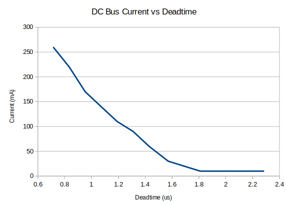

Been curious about the deadtime setting on the Prius for a while so decided to measure it. Ideally the measurement would be made using a high freq current shunt on the DC bus supply (to measure the shoot though pulse amplitude) but I haven't got one so have just measured the DC bus supply current while adjusting the deadtime:
The line is a little shaky as I just used the bench PSU current which only has 10mA resolution bit I think it's good enough for now. It's also just a 32V supply - I'll redo the measurement once it's on a HV supply.
With the ideal deadtime there should be no overlap where both IGBTs being on, and so no shoot through but also no time where neither IGBT is conducting. In real life the actual value used has to be a bit of a compromise due to the shape of the IGBT switch off waveform (it has a bit of a tail).
The two points of interest are 1.6us (deadtime set to 130 in the web interface) and 1.8us (deadtime set to 140 in the web interface). 130, the default value for the Prius, looks about right.
Does anyone know how load current and heat affects the IGBT turn off tail? Does it get better or worse as load/heat goes up?
Edit - It seems the tail gets worse with increasing temperature so a slightly higher value for the deadtime may be beneficial. Will probably try 135 once the car is running to see if it drops the inverter temperature at all.

The logging with combined binary data and sport values is now working and the results look pretty good. The data is logged to the card whenever the inverter is running and there is no wifi connection to the ESP32. The file can then be copied off the SD card and decoded using a PC app. It generates two csv files, one for the control loop data and one for the spot values.
The control loop data looks like this and contains a line every 62.5us:
While the spot value data looks like this and contains a line every 16ms:
Both can be imported straight into a spreadsheet to allow the data to be plotted, for example a couple of graphs generated from the spot values on a 1min test run:
The control loop data can also be analysed in a spreadsheet but the files are large so it is pretty slow. The plan was to use PulseView to analyse them (see the logging thread for more details) but there is a problem. This is what's plotted:
The problem is most obvious on il1 and il2 and is most easily seen in the highlighted area, the motor is actually stationary here! Plotting the same data file using gnuplot gives:
Which is what il1 should look like. Looks like PulseView may not be able to cope with these files
Have tried a few things to fix it but so far no luck so now looking for another application to use for analysis.
Happy with the SD card logging now anyway.

It look like it is the PulseView CSV import that's the problem. This is what it looks like when exported directly to PulseView format:
The data has been read in perfectly
It's still a bit hacky, and I'm having to manually create the metadata file and zip up all the data to create the PulseView file but it proves the principle. Fairly sure this has been an issue from the start, the data is much, much cleaner now. This is what a zoomed in section looks like: It has the added advantage that the csv file for a minute of data was 90MB, the same data in PulseView format is only 12MB.
Happy with that, will tidy up the code and get it to automatically create the complete file later in the week.
The only issue is that it does show how much the FW is limiting the available iq - need to have another look at that!
Edit - Not sure it is the FW limiting iq - something isn't right there, definitely need to have another look through the code.
Edit2 - Think it might be running out of control loop gain. This is a high inductance motor so would already need high gains but it's also only running at 30V so needs the gains to be around 10x higher than normal to compensate for the low volts. Will try increasing them a bit more but will probably have to rebuild the code first to increase the maximums on the ki and kp parameters.
