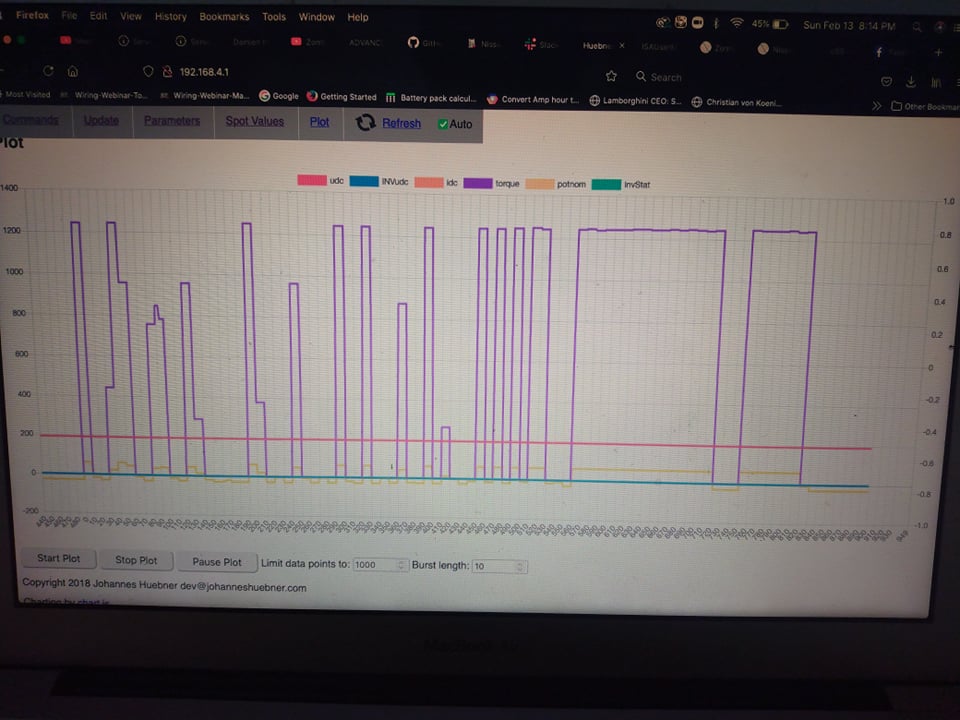

Ok just so I'm understanding this problem correctly. You are pressing the throttle in neutral and then selecting reverse? If so that would be an unexpected input sequence to the vcu and is not something I have tested. The "normal" way that I would operate would be to release throttle fully, select direction and then apply throttle.dadiowe wrote: ↑Wed Jan 19, 2022 2:39 pm Does anyone have a solution for KOPPI's post on December 11th 2021 as I have exactly the same problem.
If reverse is selected when the throttle is applied the motor runs at a constant speed in the reverse direction and no throttle or brake input makes any differance. The only way to stop the motor is to take the reverse input off and put a forward input in, or power off the system.

Re: ZombieVerter VCU Support
Thanks for the reply Damien. I am actually a patron of yours (Rob Shephard) but I know what you are up to at the moment so I did not want to bother you.
I have reviewed your zombieverter "trilogy" on many a desperate evening. Shows you how keen I am!!!
I now see how missing out a simple comma can mislead the reader. (If reverse is selected, when the throttle is applied the motor runs at a constant speed in the reverse direction)
I have a positive terminal that I either connect to the Zombieverter Forward, pin 54 or Reverse input, pin 53. Everything works great in forward.
When I select reverse and operate the throttle I have to move it to about 20% travel (guess) then the motor starts running in reverse direction at a constant speed. If I then increase or decrease the throttle the revs stay the same. If I disconnect the 12v feed to the reverse input the motor continues to run. The only way to stop the motor is to power off the system or connect the positive input to the forward pin (54) then everything works correctly until I try reverse again.

Ok I understand now. Lets get some diagnostics going :
1)Is your motor loaded or unloaded? ie on a bench just spinning itself or in a vehicle?
2)When you get the constant speed in reverse problem what is the value of the "torque" parameter under spot values?
3)As (2) but Speed value?
4)If you set revlimit parameter to a low value (say 500rpm) does the problem persist and if so does the speed in reverse obey the revlimit parameter?
5)What type of leaf motor/inverter combo are you using and did they come from the same vehicle?
Ok Damien, thank you for the file, I now have correct throttle response in forward and reverse.
I could not get the system working with the older, october bin file, probably the stm 32 got a bit upset with being invaded by the vcu firmware. So I just ran your blank .bin file then installed your firmware, but as you said Regen is not working ( even though 2 is selected).
Thanks for the help, you can get back to home renovation for a while now

Ok looks like we have a bug in the regen code. Given the different numbering systems and sign flips we do I guess I'm not surprised. will be a few months at least before I can get back to this so if anyone else wants to jump in ...

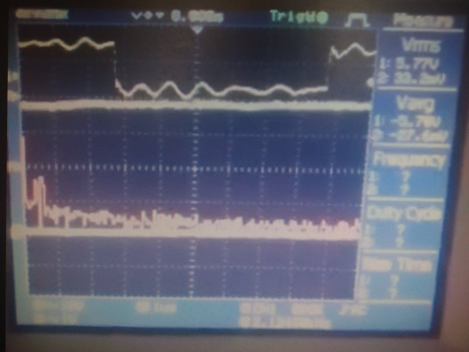

Hello all,
I am running into a bit of trouble with the VCU and 2nd gen leaf motor and inverter. I have a new ISA shunt and went through the steps to initialize it. When I go through the start up process T15 is on, it passes pre-charge stage and i can measure pack voltage across the inverters positive and negative terminals. The forward position is on. The duel channel POT is calibrated and Pot nom goes between -30% to 100% and I can see both POT channels cycling through their resistance and I can see a torque spot value go up to 2000 and back down with the throttle but the motor won't spin.
the invstat is off and the invudc is 0, but on udc i can see full pack voltage. Does anyone have an idea of what may be going on?
- Posts: 4005
- Been thanked: 1129 times
You obviously have no can comms between inverter and vcu.

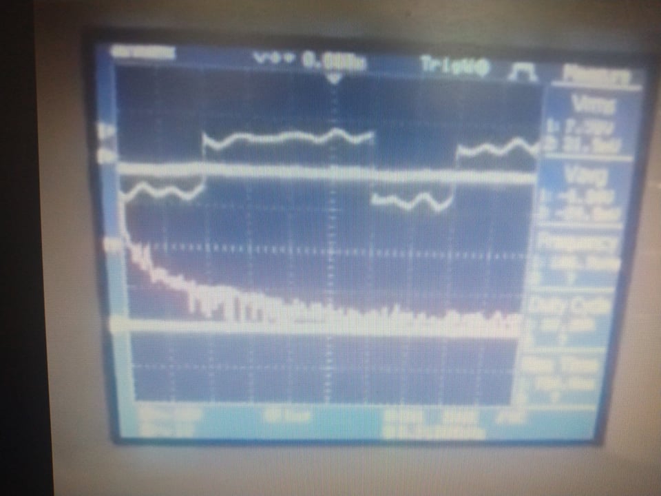

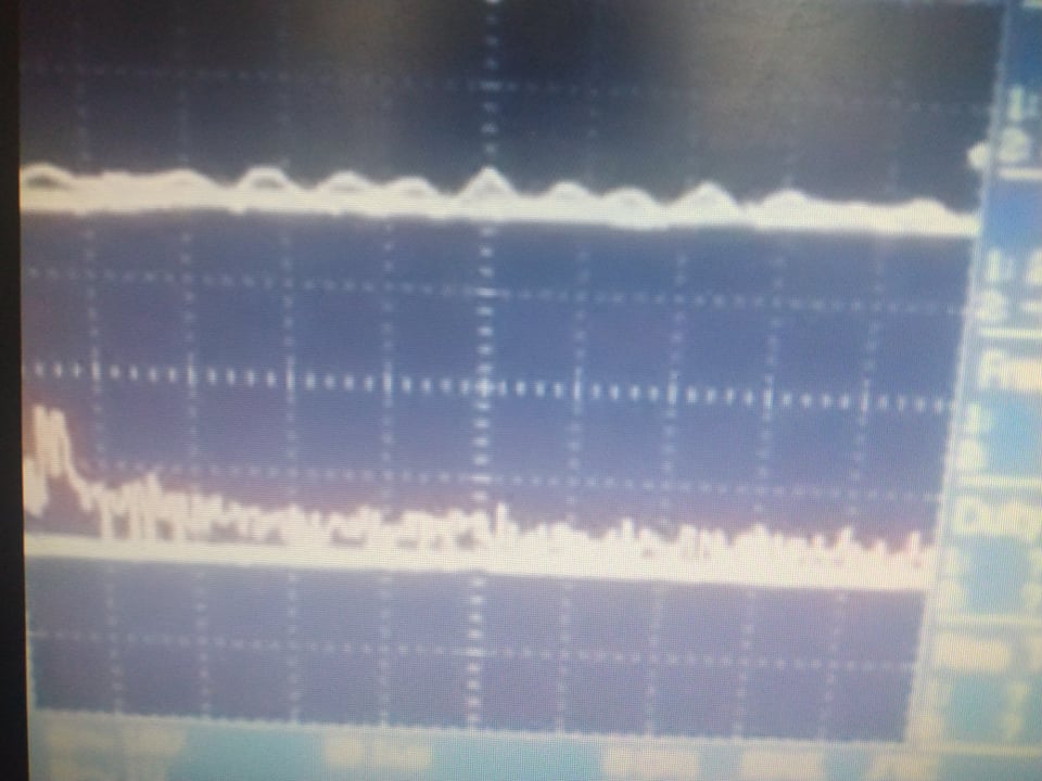

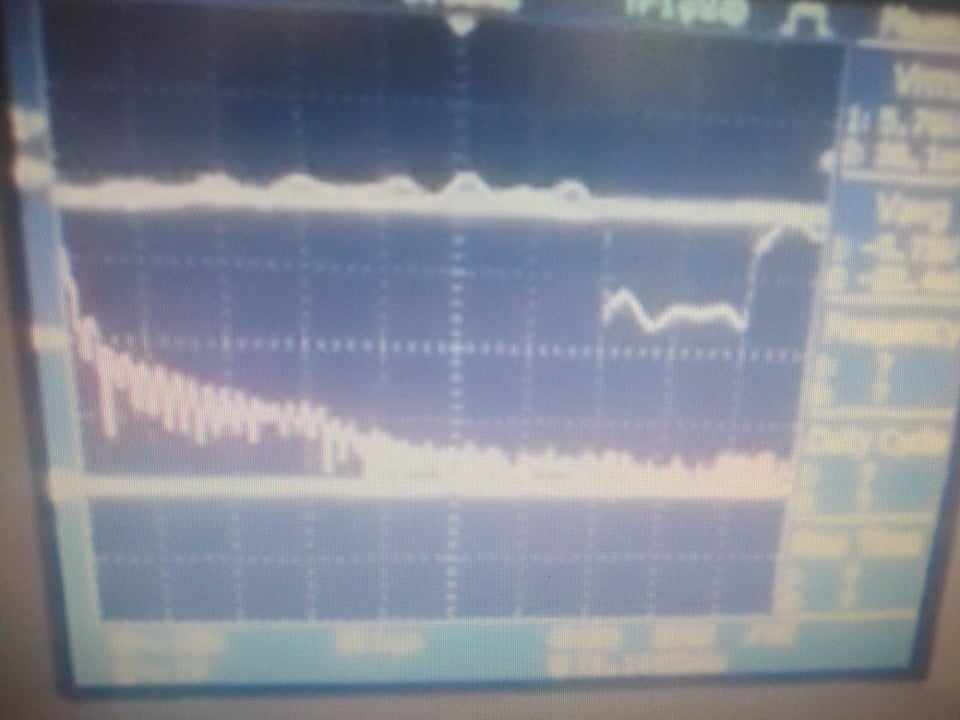

Thank you, I was thinking I was having a CAN communication problem. This gave me a direction to go.Jack Bauer wrote: ↑Mon Feb 14, 2022 8:29 am You obviously have no can comms between inverter and vcu.
I started to think about what all can give me issues with CAN communication so i decided to start with the basics.
1) I verified all CAN ext are wired correctly for H & L and tested for good continuity with my DMM which each wire had about 1-3 ohms. I made sure that there were no shorts on the board or a wire strand that may be sticking out, etc.
2) I made all the 12v perm., and ground connections better and verified continuity
3) I made all the CAN connectors better
4)I verified ground on the motor casing and battery too, to each ground connection.
5) I made a new twisted pair for the shunt to CAN EXT2 and that helped to clean up the signal a bit along with new wire for the power and ground for the shunt and made a new lead for the single wire connector. Then I have a 120 ohm 1/2 watt termination resistor, that measures 119ohms, on the middle two pins of the shunt. I had the single wire lead connected to the inverters positive terminal and I was unable to get the pre-charge to complete and was getting a pre-charge error. until I moved the lead to the main contactor and then it was able to read the voltage and complete the pre-charge. After that I moved that lead to the inverter and the pre-charge still is able to complete.
a) for the pre-charge I am using a 100ohm 100 watt power resistor. and I have the positive cable from my pack going to the main contact. at this terminal I have a wire that goes to the pre-charg contactor and then on the other side of that contact it goes to the power resistor and then the other terminal on the main contactor and then that hv cable goes to the main fuse and then the inverter B+ terminal.
b) For the negative side of the battery pack I have the cable going to the side of the shunt that is marked negative. and then on the other side of the shunt the cable goes to the inverters neg terminal.
c) I have the main contactor wire and pre-charge wire leads from the VCU going to the contactors and then the wire that is B+ contactor ls switch going to my main relay for switched power.
6) I made a new twisted pair for the motors can wires, I am not using all of the stock harness only the small amount that is needed for this that includes all the paired wires for the resolver (pin 17&18 resolver s2-24) (pin 19 and 27 for motor resolver r1-r2) (pin 20 and 21 for motor resolver s1-s3) (pin 44 and 45 for thermistors), perm. 12v, ground, and switched power (pin42 on motor harness) that goes to the relay. Pin 46&48 of the motor harness I have both connected to perm. 12v. power source and pin47&49 of the motor harness going to ground I have VCU can ext H going to pin 14 CAN-H for the motor and CAN EXT L going to pin 15 CAN-L for the motor.
Next after verifying all the wiring is correct and I have good continuity to all points in the wire harness and individual components. I was looking at what can cause the CAN errors and I was looking at the switched power possibly being the issue, but the relay is working properly and measuring voltage to pin 42 on the motor. I was curious to see if this would make a difference so I changed out the relay for a manual switch that I can control and made no difference so I put the relay back in.
In the videos it was said that there are two switched power connections but per wire diagrams I only see one which is pin 42 on the back of the motor, what is the second switch power lead? I do not have the PDU connected and I am only running the motor and inverter together.
Next I plan on decoupling the wires at the motor for the can and measure the resistance of pin 14 and 15 on the motor to see if I have any excessive resistance or not. and also test the voltage to pi 14 and 15. I was also going to make a shield from foil and wrap the can wires for the motor to see if that helps to clean up the signal any.
Still sorting out what is causing the CAN communication problem. I put my scope on both the shunts can and motor can when it was in run mode and also tried hitting the start inverter manual mode and see if it made a difference which it didn't. and I have attached some images of the video i took when I was testing them. the signal I am getting from the shunt is much cleaner than the one for the motor.
Later this afternoon I am heading back to try and do some more problem solving on this.
any ideas?

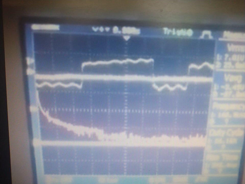

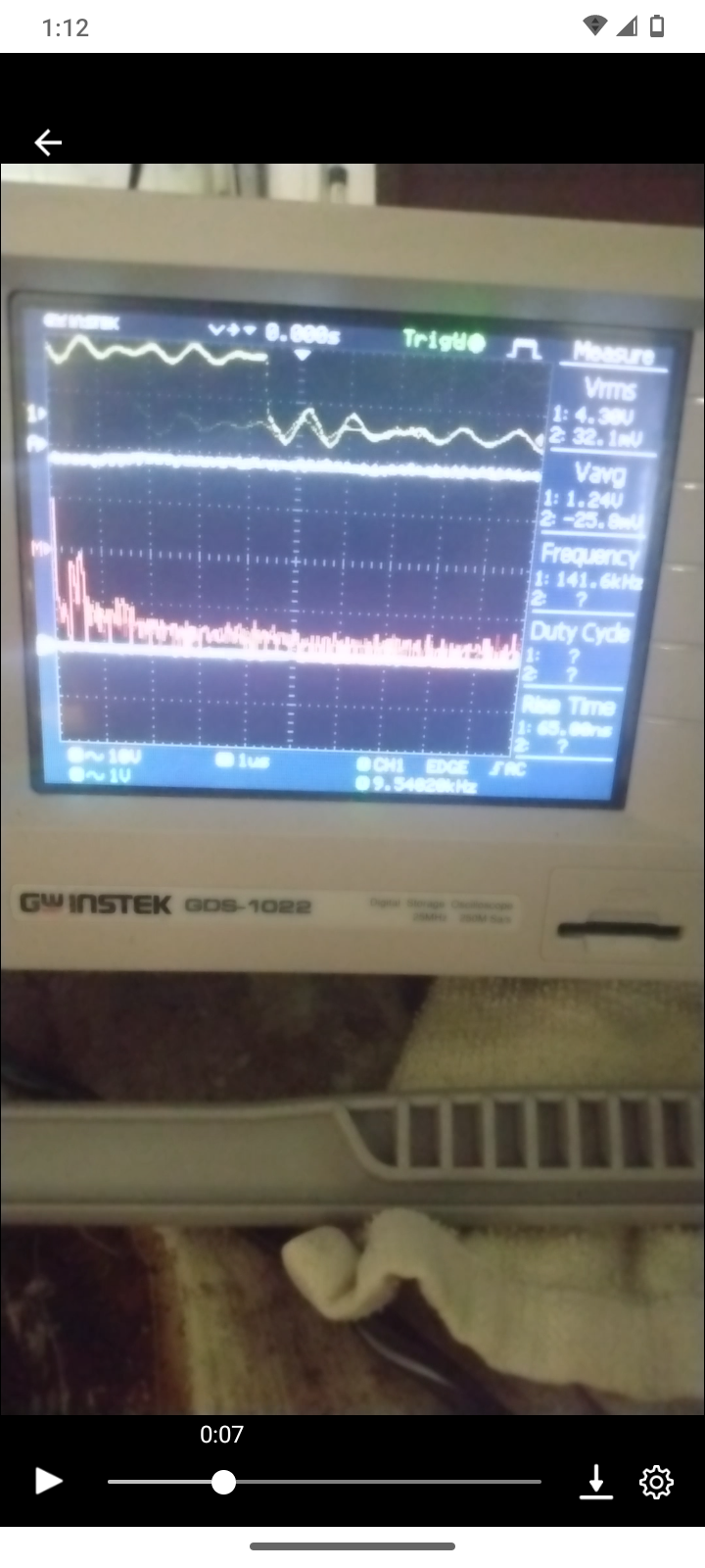

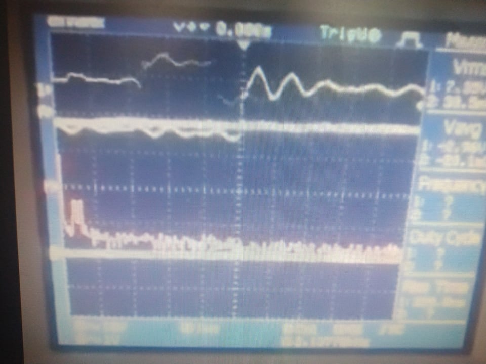

Quick update:
I was able to do some more testing focusing on trying to diagnose why I am having some CAN communication problems.
I verified all the wiring is correct along with the polarity of the shunt and inverter connection.
I started data gathering process:
With a DMM:
With the system off and connected to Aux 12vdc:
CAN Ext1 H: 2.427v
CAN EXT1 L: 2.423v
Shunt H: 2.446v
Shunt L: 2.466
With Aux 12vd and T-15 on: No changes to values
With Aux 12vd and T-15 and ignition on no changes to values
With T-15 on, ignition on, start on, run mode on, pre-charge complete:
CAN Ext1 H: 2.453v
CAN EXT1 L: 2.411v
Shunt H: 2.497v
Shunt L: 2.353v
Hz:
CAN Ext1 H: 186Hz
CAN EXT1 L: .92-.79kHz
Shunt H: 5.713Hz-0Hz
Shunt L: 768Hz
Duty cycle:
CAN Ext1 H: 0%
CAN EXT1 L: 3.7%-0%
Shunt H: 99.9% holding
Shunt L: less than 5% and cycling 0%

Checking for can signal on the scope at the motor connection and I can see a signal being sent to the inverter but no motor movement.
In the VCU web portal:
Motor is in run, t15 on, pre-charge is done, no errors, but the inverter udc and invstat is off and has a value of zero.
Next, I am going to see if I can find out what the leaf’s gen 2 inverters can resistance is supposed to be as 52 kohms seems really high to me when all other is 120 ohms.
