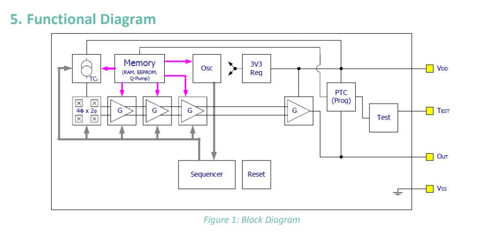

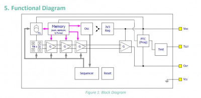

Well the sensor is programmable...
Default seems tobe 50mv/mT do we know the actual value in the Tesla unit / our application?
