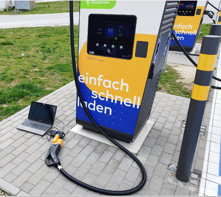

Foccci for laptop charging
Laptop during DC charging
The laptop power supply had no problem with the DC current.

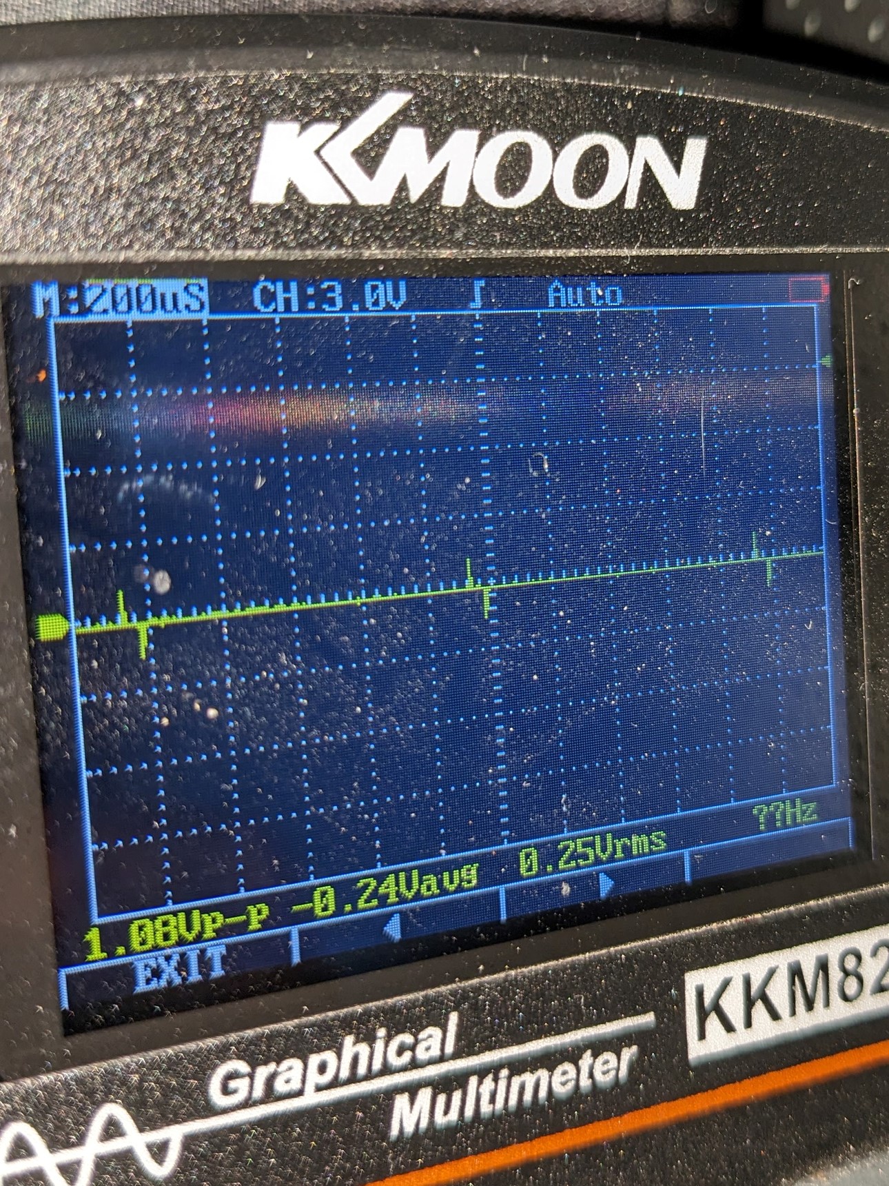

I went back to ionity.
CP is ok, PWM is detected at 5%
But no communication. :cry:
Here are the oscilloscope tests
CP :
Input Modem RF (Test to R25 resistor) :
RX_N / RX_P / RXIN_N / RXIN_P : 0V
TX_N / TX_P / TXOUT_N / TXOUT_P : ~1.2V constant
Log SM32 :
Test_Ionity.txt
(190.17 KiB) Downloaded 399 times

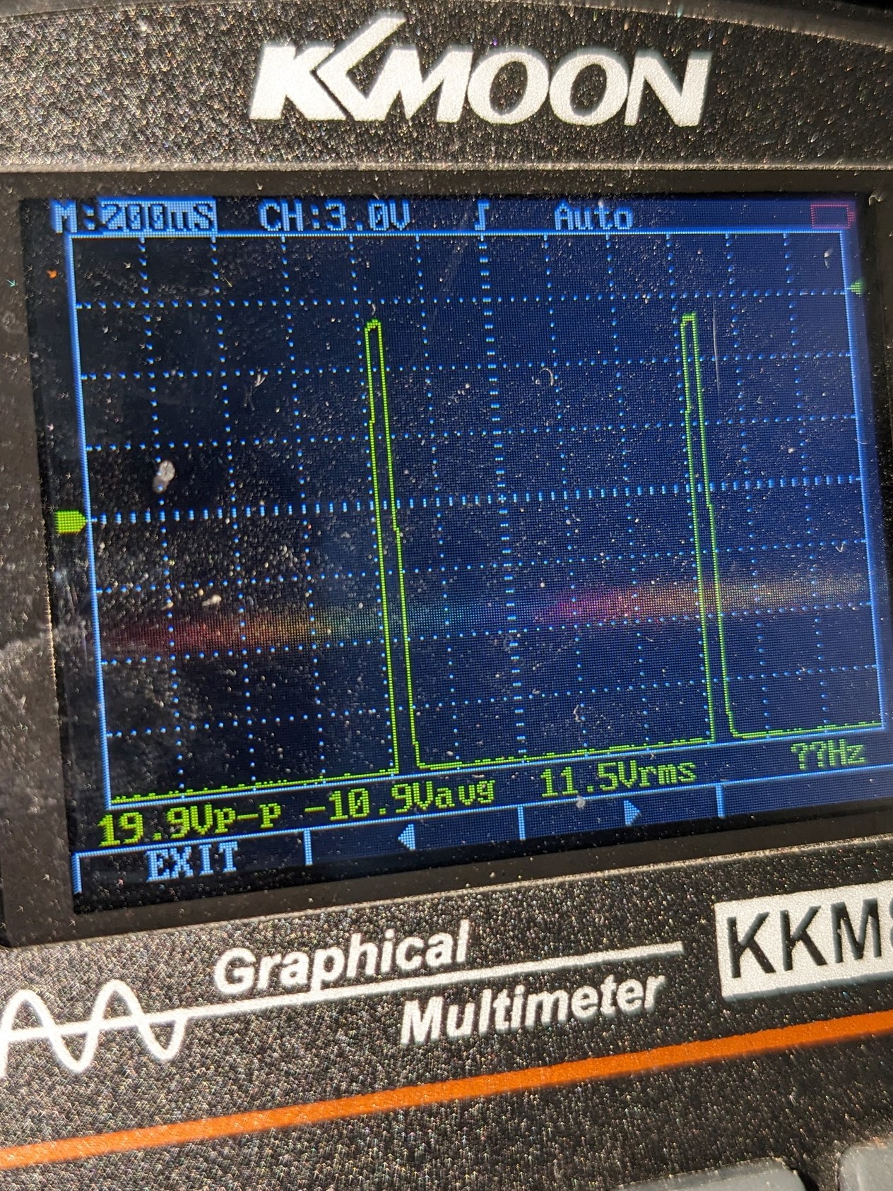

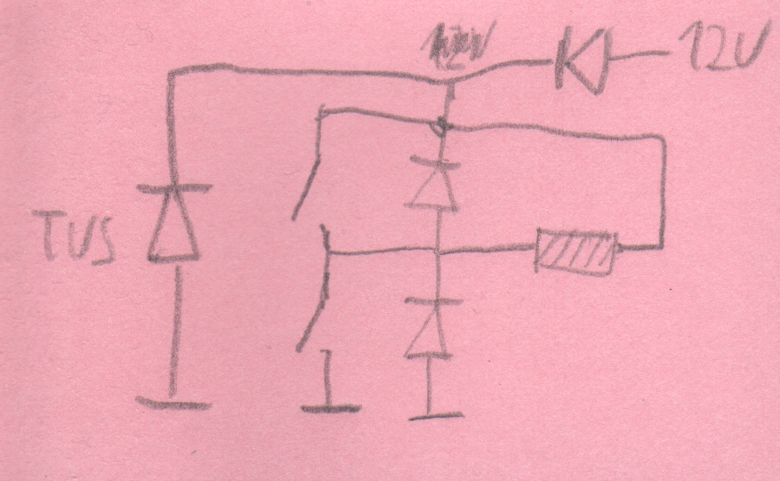

I'm testing the latest revision now (https://github.com/jsphuebner/foccci/tree/wakeup)
The wakeup now (almost) works as expected. I found the 10k pull-up on the button is too high. With the 100k+22k divider for the uC sense pin it sits like 0.7V below supply voltage and that is already enough to trigger the mosfet and activate the 5V regulator. So I lowered it to 1k for now and that fixes it. Maybe 4k7 or 3k3 would also work, haven't tried. Same goes for the PP pull-up.
Wakeup via CP works beautifully, as long as I keep the PWM running Foccci stays on, 10s after I stop PWM it shuts itself down. All the other wakeup also react as expected.
The new contactor driver works well but you have to keep in mind it forms a boost converter:
Safer to run the relays to GND. Otherwise it's just the TVS limiting the voltage and it failed to do so once when I tested with a higher value inductor - 5V regulator was fried. I think the reason why the TVS didn't limit effectively is the thin trace going to it and also trace inductance.
I also think running the contactors at 100% duty for 1s when starting is a bit long. Usually it will have pulled in after 50ms or so.

I do not see the boost converter in the picture. As long as the lower switch is on, the current through the L rises. If the lower switch is off, the current keeps running via the upper diode or upper switch, the voltage is only rised by the forward voltage of the upper diode in worst case. Everything perfect, what is missing?
Posts: 6969
Has thanked: 455 times
Been thanked: 1771 times
Re: Develop a QCA7000 board?
argh, the picture is wrong. The relay is connected before the reverse polarity diode.
I saw it on the scope that while the relay was on supply voltage (behind the diode) had risen from 12 to 20V!

quentin42 wrote: Thu Apr 04, 2024 2:29 pm
[70] [PEVSLAC] received GET_SW.CNF
For MAC 00:b0:52:00:00:01 software version BootLoader
If the QCA reports "Bootloader" as software version, it was not able to load its firmware from the SPI flash. I've never seen this before, but just tried: De-solder the SPI-flash, and I get the same message. Added into the trouble shooting hints: https://github.com/uhi22/foccci#clara-s ... tis-normal
Also you voltages on RX and TX look strange. Directly on the QCA, I measure around 1.6V on TX and RX pins. Added this into https://github.com/uhi22/foccci#no-comm ... r-possible

quentin42
Posts: 7
Joined: Thu Nov 30, 2023 9:12 am
Post by quentin42 »
SO,
U1 was not flashed, it's a big mistake on my part. I had seen the documentation, but I thought it was an old procedure for flashing the STM32. :?
After the flash, the QCA was recognized. RX/TX were at 1.6V. :D

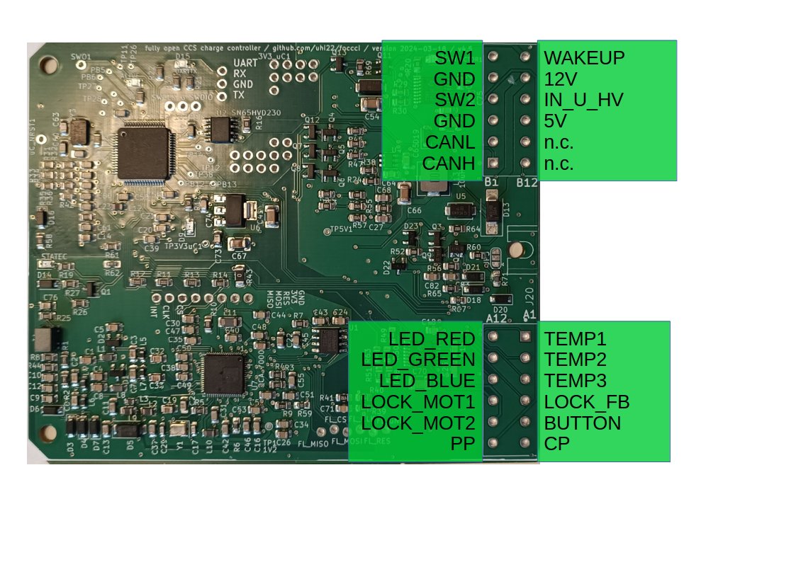

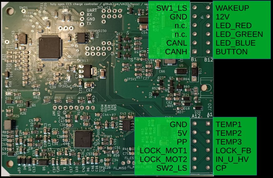

On another note I wanted your input on this. Here is the current pinout:
The two contactor outputs are on different plugs. The LEDs and button are not on the plug that is more charge port oriented but on the car oriented one. Now I thought it would be more stringent to arrange like so:
That way all wires going towards the charge port are in one common harness and so are the ones going to the car. I'd assume the voltage sense board to be mounted with the charge port contactors.

That new pin ordering makes a lot of sense. The contactors and the voltage monitor are likely to be located in a junction box that is very much a "car side" thing. Are all of the pins other than LOCK_MOT1 and LOCK_MOT2 referenced to ground? This would mean the only signal you need to bring to the charge port in addition to the "charge port side" pins would be ground, which is reasonable enough.

celeron55 wrote: Sat Apr 13, 2024 8:00 pm Are all of the pins other than LOCK_MOT1 and LOCK_MOT2 referenced to ground?
Yes exactly. PE should be solidly connected to the chassis not far away from the charge port so that would serve as a ground reference for the signals
I guess the design is still young enough for shuffling pins
