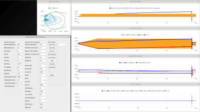

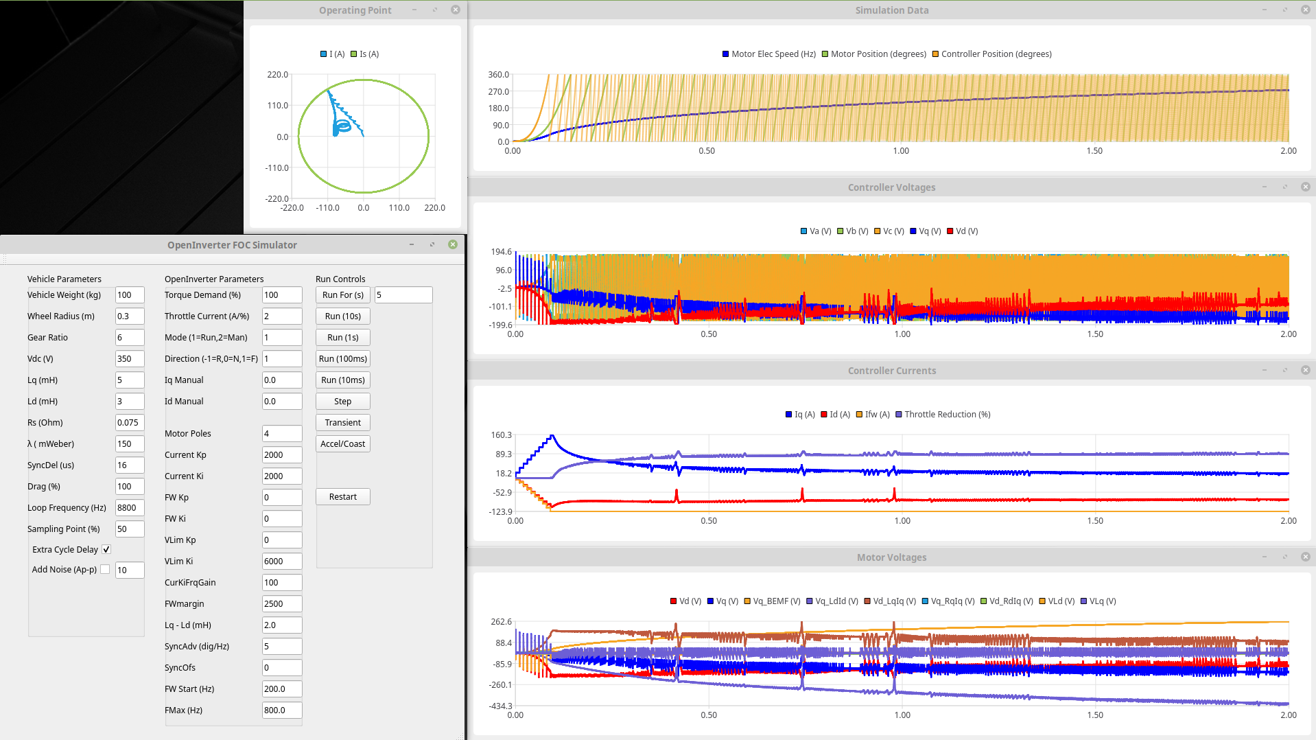

Tried the improved scheme. First plot with the limiter just aiming the trajectory at Icrit:
And next one that tried to adjust the trajectory to limit the amount of Iq reduced if there is plenty of margin on ud:
The second one, which should be slightly better, is slightly worse. What is happening is that the mod causes a bit of instability in the limiter control loop (seen in the disturbances on the Id and Iq traces) and this instability does more harm than the improved trajectory does good. Now this is for Icrit of 550A, it's quite possible that for motors with lower Icrit (but still outside the current limit circle) it may offer more benefits but I don't think it is worth it so am going to bin it for now.

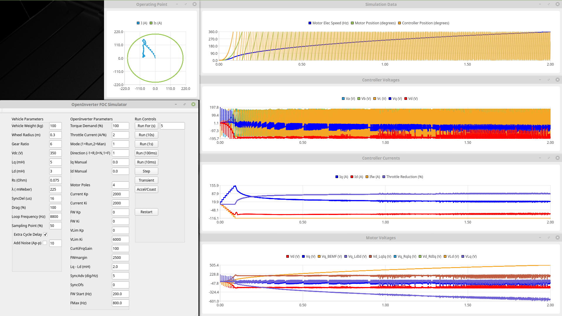

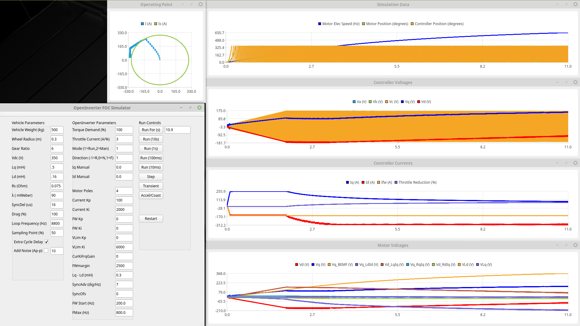

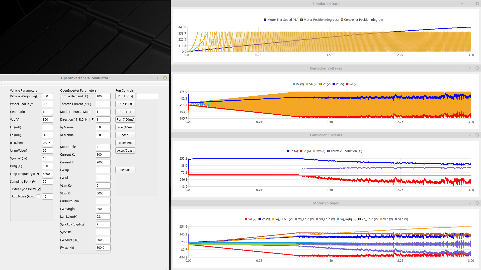

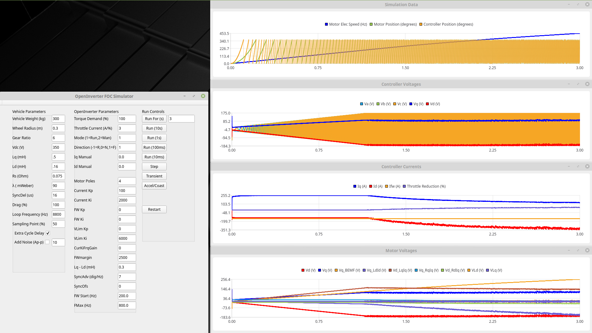

More plots!
I've now added the polar operating point plot for Iq Id. It's not as nice as I'd like as the QT chart doesn't seem to be able to put the axis in the center but it will do. It shows the Is (max current circle) and the trace shows how Id and Iq moved during the run (the start of the trace is at the origin).
I've had to run the plots 10ms at a time for the first sec while ramping the throttle to get a nice trace (the throttle ramps should do this with the real firmware).
First a low L motor: You can see the current following the Mtpa curve up to the Is limit and then moving towards Icrit as the voltage limiting kicks in. Once Id hits the neg limit it then starts ramping the Iq down towards zero. I'm not too sure why it isnt following the circumference of the circle as it moves towards Icrit but I think it's because I dont recalculate the max Iq following the change to Id (Iq = root(is*is - iq*iq) ).
Next what happens if you push the speed so high that there isn't enough Id to keep the voltages under control: You can see that the currents start circling round Icrit when the controllers go open loop. This is at around 11krpm (not a good idea to get to this point in real life!).
Next a high L motor: This time Icrit is 75A so once the limiter comes in it starts moving the operating point almost directly down. On different motors this could move to the left or right too dependant on how Mtpa's Id and Icrit match.
If the icrit parameter is badly guessed then this is what you get (motor model icrit at -50A, controller parameter at -75A): You can see the controller aiming for what it thinks is Icrit but actually ending up circling the real Icrit.
All interesting stuff - just hope it's somewhere close to reality!

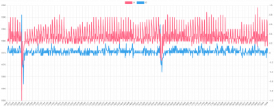

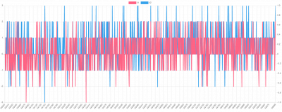

Just test drove A2 with the angle set before the transforms and it was terrible. Totally shook the car apart. I wonder if calling the ISR twice per PWM cycle has anything to do with the sketchy behaviour with the Prius system. Compared to the Leaf system it has a life of its own. I never know
- Is it the software (and which part of it)?
- Is the inverter doing something "intelligent"
- Is it the high inductance motor?

s32fp il1 = GetCurrent(AnaIn::il1, ilofs[0], Param::Get(Param::il1gain));
s32fp il2 = GetCurrent(AnaIn::il2, ilofs[1], Param::Get(Param::il2gain));
Encoder::UpdateRotorAngle(0);
CalcNextAngleSync();
FOC::SetAngle(angle);
if ((Param::GetInt(Param::pinswap) & SWAP_CURRENTS) > 0)
FOC::ParkClarke(il2, il1);
else
FOC::ParkClarke(il1, il2);

They are pulled from the DMA data, but the earlier done the closer to the middle.Pete9008 wrote: ↑Fri Oct 28, 2022 5:42 pm Are the currents actually read or are they pulled out of the streamed DMA data. Btw, did you see the post regarding current measurement in the logger thread?
Odd isn't it?
That is an excellent point and one which I hadn't considered at all. It definitely wouldn't help stability and would easily make it a fair bit worse. Its also something that the simulator doesn't reproduce! Would expect it to be worse on low L motors though.
Are you talking about your comment on current ripple? Those 120A were what I calculated and deemed implausible but it might well be. I think the reason it works is although the ADC is not synchronized it will only drift off 4us maximum (half of one conversion round) plus it takes the median of the last 3 values.
EDIT: I should add: I run the Leaf motor at 8.8 kHz (so less ripple) and consistent ISR calls at PWM center while I run the Prius inverter at 4.4 kHz because it doesn't like being run faster.
I could try skipping the calls at period start and only call UpdateAngle() to keep resolver excitation running.

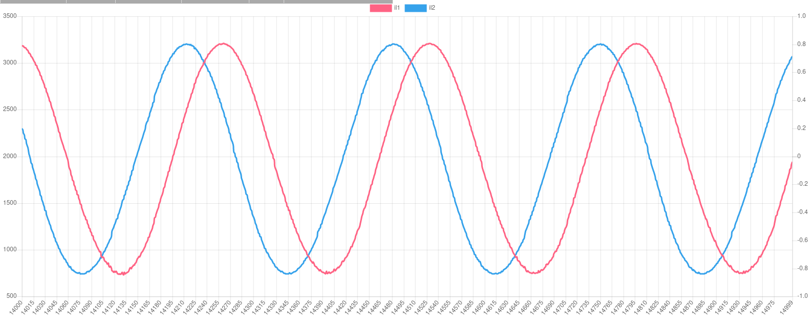

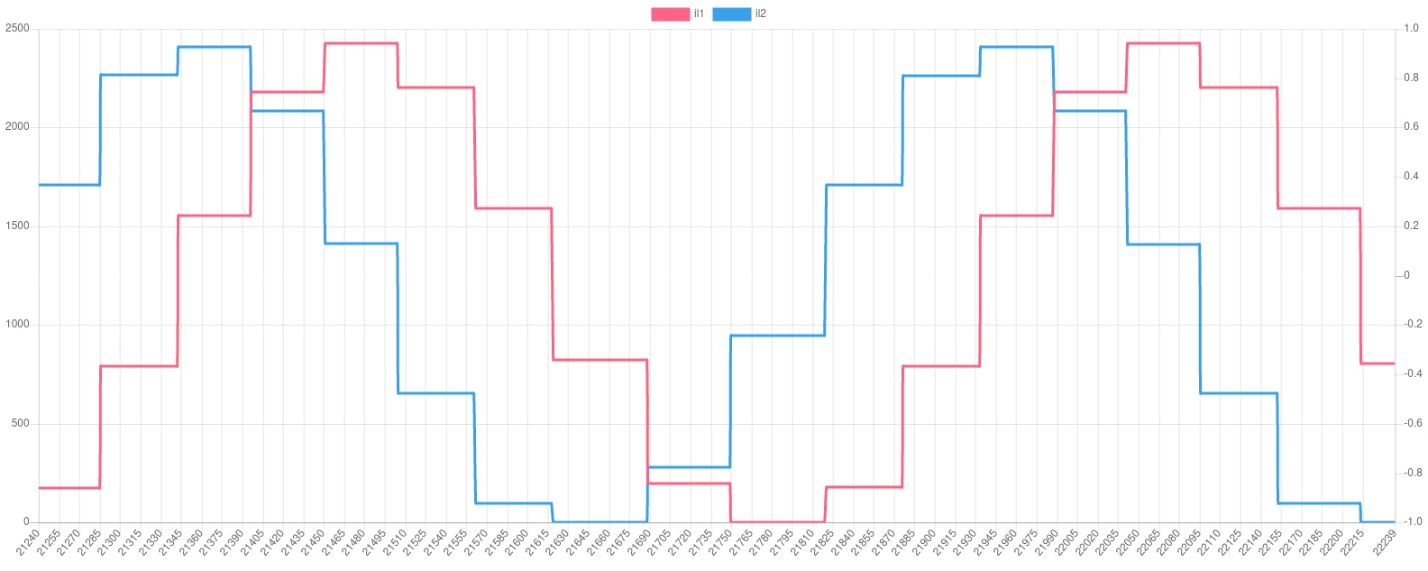

Yes we do have ADC2

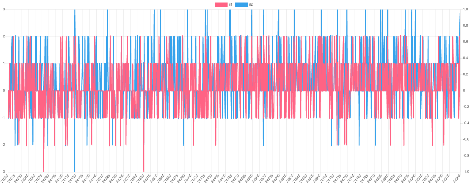

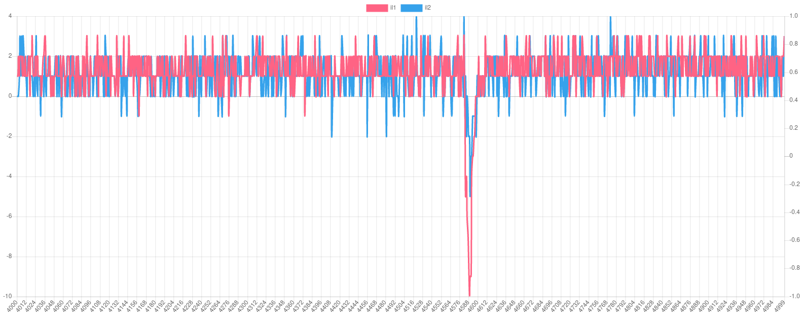

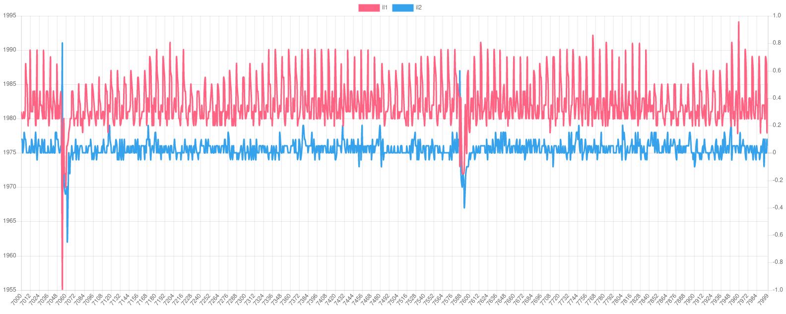

Those are injected samples in the 10ms task stimulated with a 10 Hz sine wave with 90° phase shift

- Been thanked: 1914 times
Now I'm thinking how to best make use of it.
a) "injected simultaneous mode"
Have ADC1 first convert sin-signal and ADC2 cos-signal (at the very same time) and next in sequence il1 and il2
That way there is virtually no offset between currents and angle sampling. Downside: no averaging or median takes place. That said no averaging is done on the resolver anyway and it isn't too noisy. Other downside: currents are not sampled at mid-PWM
b) leave resolver sampling as it is and trigger injected conversion of il1 and il2 on ADC2 at mid-PWM
c) Have ADC2 free running with DMA like right now, just not disturbed by sampling the other 6 signals. Not that trivial as ADC2 doesn't have its own DMA channel but uses the upper 16 bit of ADC_DR(ADC1)

Id do b) but using a burst of regular conversions (so that you can have a longer sequence) alternating between i1 and i2, so i1, i2, i1, i2, maybe even a total of 8, and then average the measurements. Not true simultaneous but a lot better than it is at the moment, synchronised to the pwm and less likely to break anything else while making the changes!

More news from ADC2
Noise level: Again the least noisiest way seems to be discarding the first sample. Averaging of two samples didn't reduce noise. I think the spikes are from the wifi module of my rather old test board. Newer ones have better filtering.
And a nice sine wave (20 Hz) In comparison noise level of 3-median ADC sampling: I'd say it's about half the noise

The typical noise level on that last plot looks pretty good, what are the big negative spikes though?
Interesting that averaging doesn't reduce it, that suggests that its not true random noise. Also interested to know what causes the first sample noise, I've used the adcs in these chips in that mode before, in fairly high precision measurements, without seeing the effect.
Which sampling scheme are you going with?
Edit - if set up right Im hoping the A2 motor will like it a lot
The only bit I'm slightly worried about is controller stability
Definitely wifi module.
Here is a chart with it removed and not even discarding the first sample:
