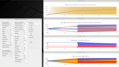

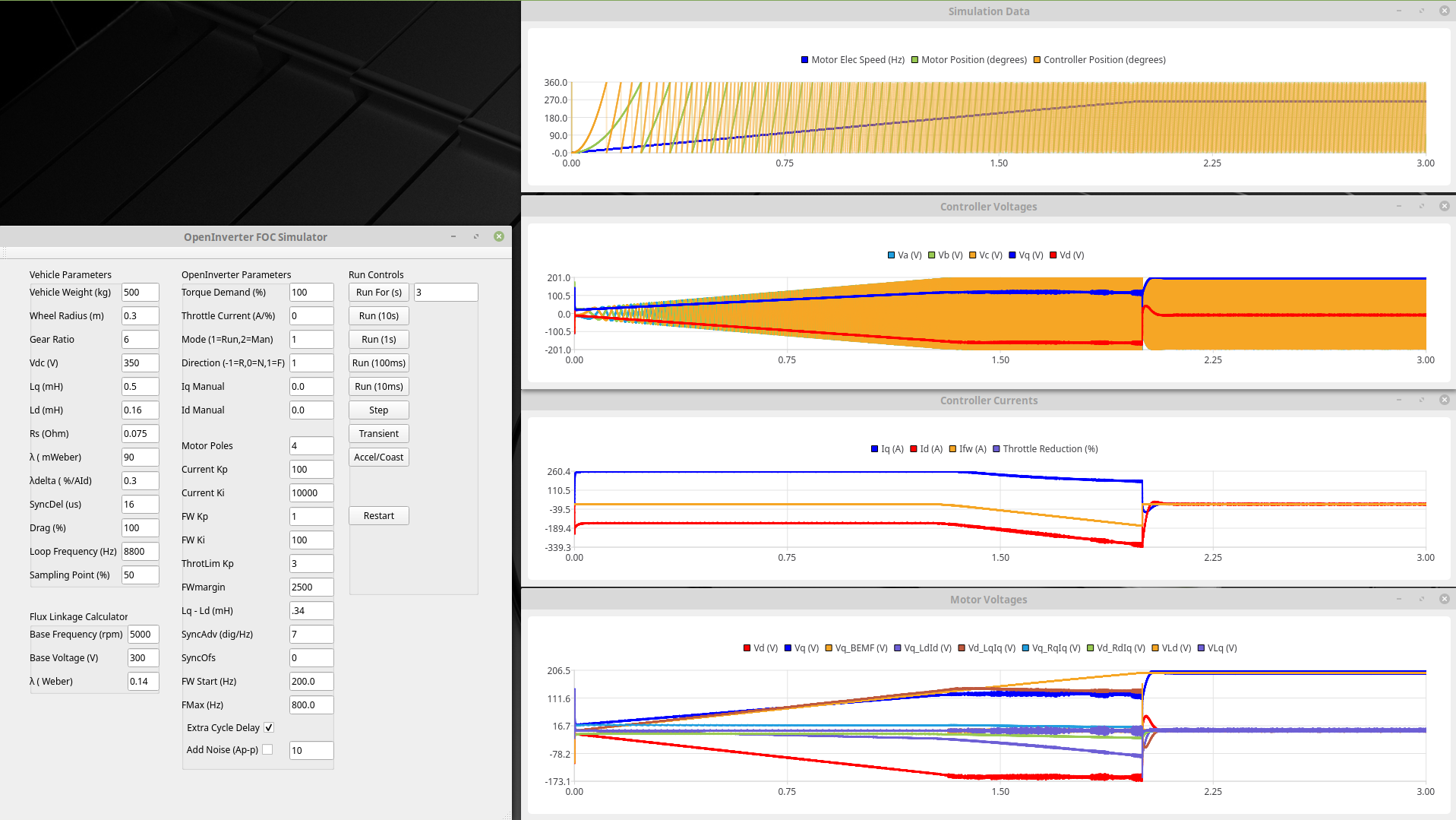

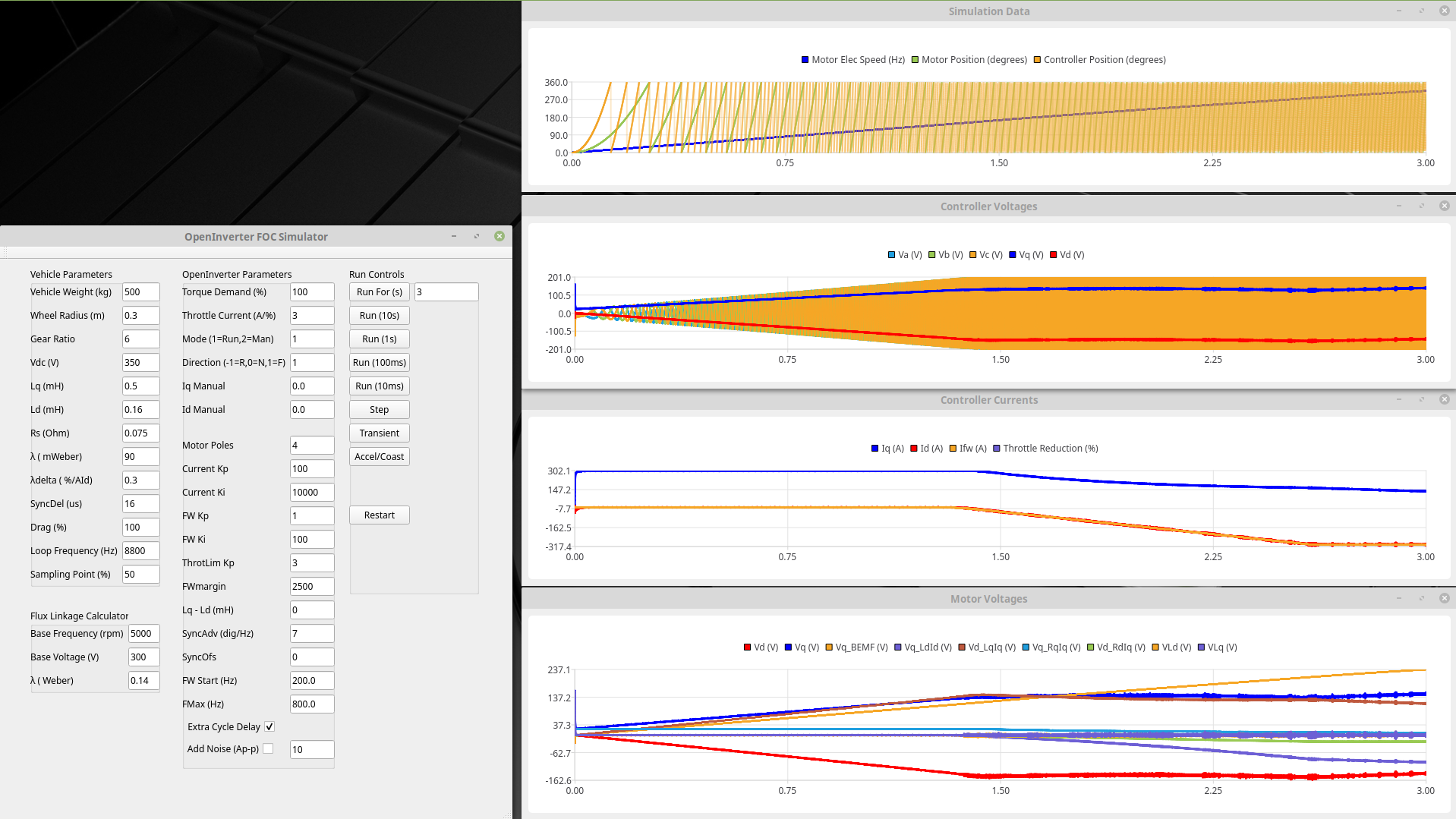

Not sure whether this looks right or not, going to post anyway in case anyone has any thoughts...
The following plots are with the revised simulator which uses the full motor model. It is using the low I values of 500uH and 160uH for motor Ld and Lq. The motor currents plot is replaced by one showing the voltages in the motor model. Also worth noting that throttle limiting is disabled for these.

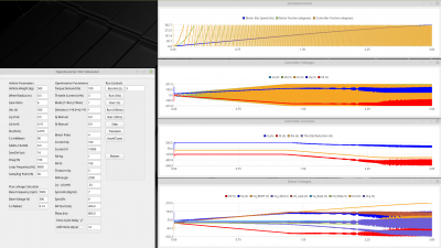

First plot, no field weakening, no MTPA: It can be seen that the motor accelerates to around 3900rpm with the torque reducing at higher speeds. On the motor voltage plot you can see that the bemf tops out at 200V (which I think is the battery voltage of plus the space vector modulation allowance). Pretty much as expected.
Next plot, FW added: It now accelerates much more linearly reaching 4950rpm. While it would accelerate to higher frequencies it can be seen from the Ifw plot that the field weakening has already topped out and so the control loops will be starting to saturate.

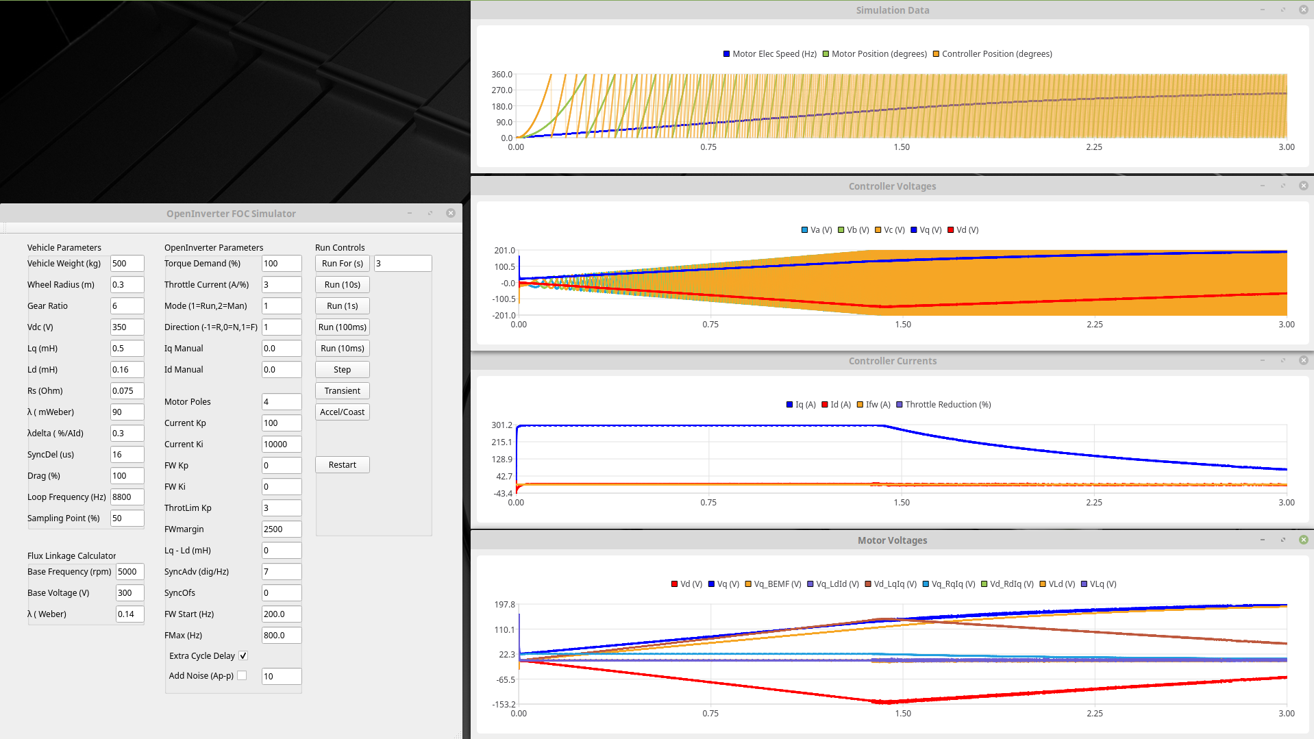

Next plot, FW and Mtpa added: Bit better acceleration, bit better top speed (~5400rpm), more instability in the FW control loop, still into saturation.
And finally two plots showing the effect of saturation. First one where the simulation stops accelerating and starts coasting before getting to saturation: Behaves as expected and coasts.

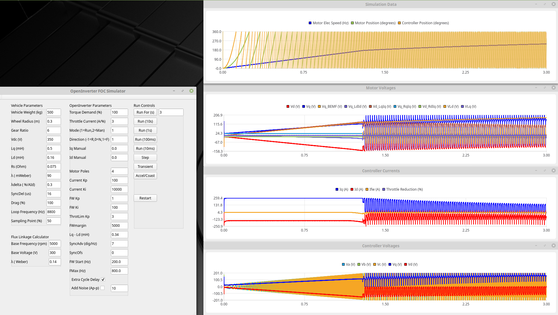

And finally one where the model accelerates into saturation and then coasts: Strong unwanted regeneration. Due to saturation the loops are running open loop and don't have the authority to keep control.

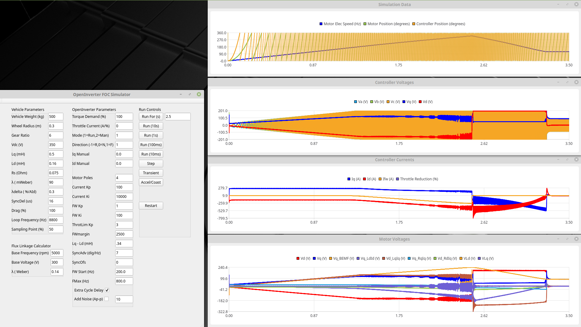

Edit - For completeness here is a plot with throttle limiting enabled: Works but the loop stability needs a bit of work.
It looks like this is modelling most of the behaviour seen in the real world, in particular the Vd and Vq voltages look much closer to the real world. Also worth noting that the control loops now seem to need a lot more integral gain than before presumably due to the significantly larger changes in Vd and Vq with speed (so it looks like I may have been wrong with my earlier thoughts on P and I gains
The big issue is that the motor is only getting to 50% over base speed (bit over 60mph by my sums!). I don't know whether this is representative of the Outlander motor in the real world or whether the model still needs some work on the bemf side of the model (but I haven't been able to find any reference material on how to improve it). Back to needing more data!
Comments welcome!

Looks like you made a big step towards physical reality
Nice.
I test drove the throttle limiting and it is not drivable. I can use the rev band up to 4000 rpm as before and also more rpm at little throttle but as soon as the limiter kicks in the motor vibrates and no longer produces torque.

Hope so, it's definitely made it a lot harder to tune things!
What are your thoughts on how far it should be possible to go above base?
That makes sense from what I've seen. I can get it a bit better in simulation by using P=0, I=100 but not really good enough to use.

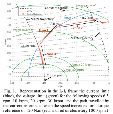

How about decreasing iqref and idMtpa by the same factor? In FW region it's not in MTPA anyway but merely MTPV
1-s2.0-S2405896318334931-main.pdf- (775.56 KiB) Downloaded 446 times
Pete9008
- Posts: 1801
- Has thanked: 102 times
- Been thanked: 350 times
That looks about the only option at the moment. Not keen on going back to the fixed point Mtpa implementation as with the smaller L value it would really struggle (probably ought to rerun the checks on the float version and check it is happy with lower L values, may need to look at the param file too and possibly store in uH, using mH with the fixed point only gives 30uH resolution).

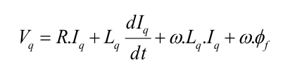

That paper is interesting, it's made me think about a few things in a new way. The critical point definition in particular: It would appear that this comes from setting the last two terms of the Vq equation to be equal to zero (and ignoring the voltage dropped across the winding resistance which would be small by comparison): Which backs up the way the model is currently set up (the voltage produced by the wLdId term balances the wx(flux link) term.
Edit - fairly sure that there is an error in that equation, it should be wLdId not WLqIq!
The Fig1 diagram is also interesting: It's not quite right for our motors though. Using current parameters gives a critical point of 90mW/160uH = -560A. This means that it is well outside the current limit circle (I'm setting Is to 300A) meaning that we can never fully field weaken the motor which means that the maximum speed will be limited. This again backs up the results that the model is currently giving. The critical point being outside the circle also changes the angle of the optimum trajectory when moving from Mtpa to something else/Mtpv.
Edit - In terms of our current control methodology zone 1 on the plot is arrived at using Mtpa, zone 2 is missing in the simulations as we follow Mtpa all the way to the current limit circle, zone 3 is the field weakening and zone 4 is the throttle limiting.
Edit2 - If we scale Iq and Id in throttle limiting that would give us a trajectory towards the origin, which probably isn't ideal but not sure what we can do that is better without a whole load more maths!
Edit3 - Looking at the graph again initially reducing Iq might be best (intuitively it feels wrong though). This approach would give the highest maximum speed which occurs when Iq = 0 for a critical point outside the current limit circle.
The above all goes wrong though if the critical point is inside the current limit circle though, does this ever happen on our motors? Not too sure would happen in that case but fairly sure it would not be good!
Edit4 - For a critical point inside the current limit circle scaling Iq and Id together would probably be the best approach. Wonder how difficult the maths would be to aim the trajectory towards the critical point, that would work reasonably well in all cases.
Edit5 - Don't think it would be too bad, can probably even avoid any trig and just use scaling. Might give it a go once - going to try simulating a high L motor first though.

Have you thought about the critical point of the high inductance motors?
- Posts: 6969
- Has thanked: 455 times
- Been thanked: 1771 times
Yes, things are starting to repeat, celeron55 called this "characteristic current" search.php?keywords=characteristic&t=1683&sf=msgonly
So for the Prius motor that would be way less, if I remember 90mW and 2 mH, so 45A only!

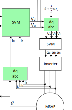

Also for the first time I see syncadv for the inverse transform in a paper: Look in the upper right corner
