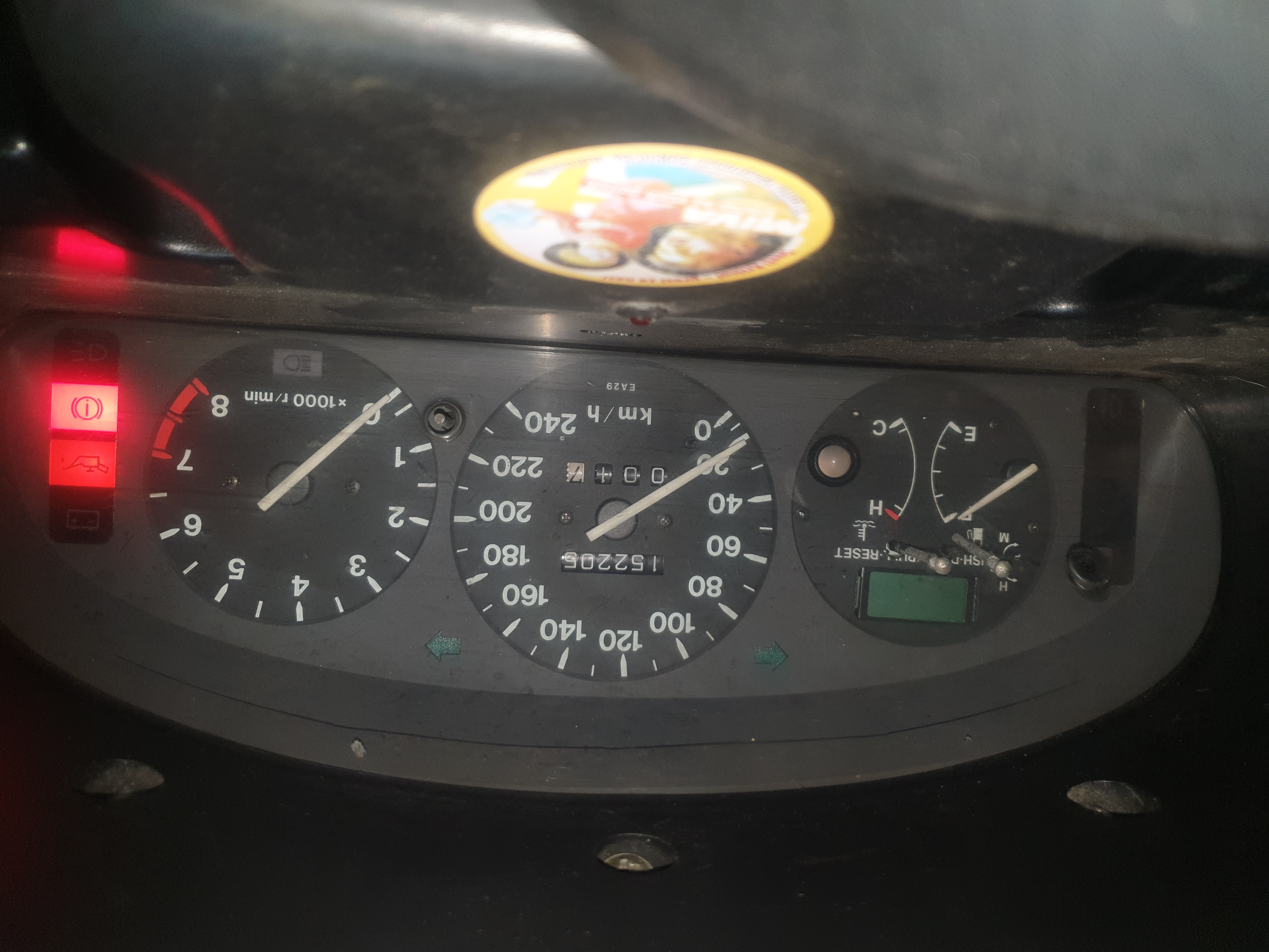

Do you have a preference which function to use for Teensy PWM frequency modulation? Or should i simply use analogWriteFrequency(pin, frequency)? Would that interfeere with your other functions?
Or should i use tone function tone(pin, frequency) Would that be any easier? I can also add a film capacitor to transform the square weave to sine function if needed.
I need to map PWM from 12Hz to 220z which would mean 3km/h to 160km/h.
final drive ratio is about 7:1
Wheel size is 15in 195 R55 which is about 0,595m diameter. Circumference should then be 1.87m and that is the distance for one revolution.
I see about 1.375Hz/km/h ratio from 30km/h to 160km/h. Before the function is a bit skewed...
v [km/h] = (RPM * circumference) / 1000.
Then i can map v [km/h] to [Hz] and output it through Out7 pin.

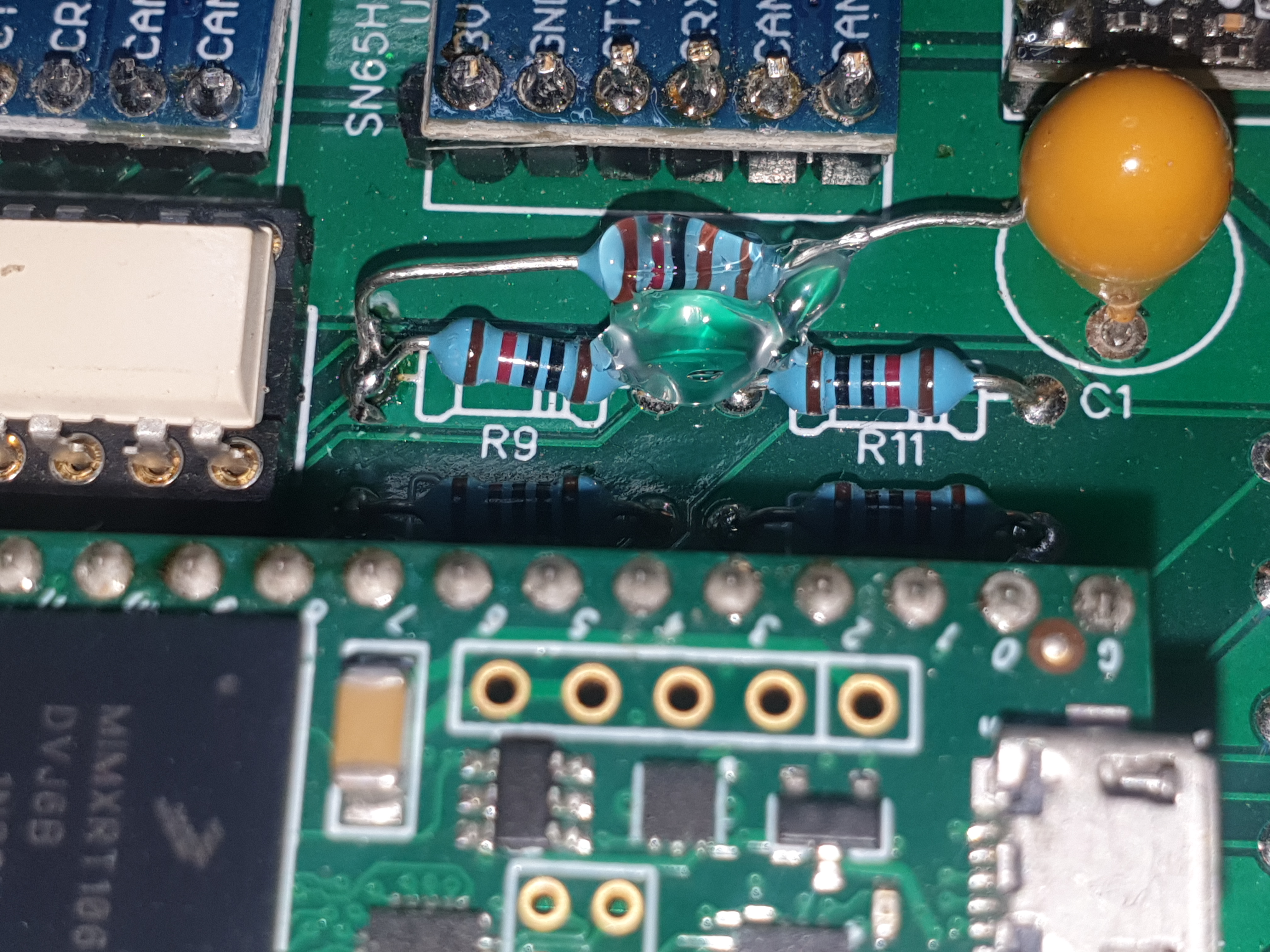

Some report back...
I managed to wire additional 10K resistor to ISO8 pin which keeps opto activated so Teensy will think charger is not connected.

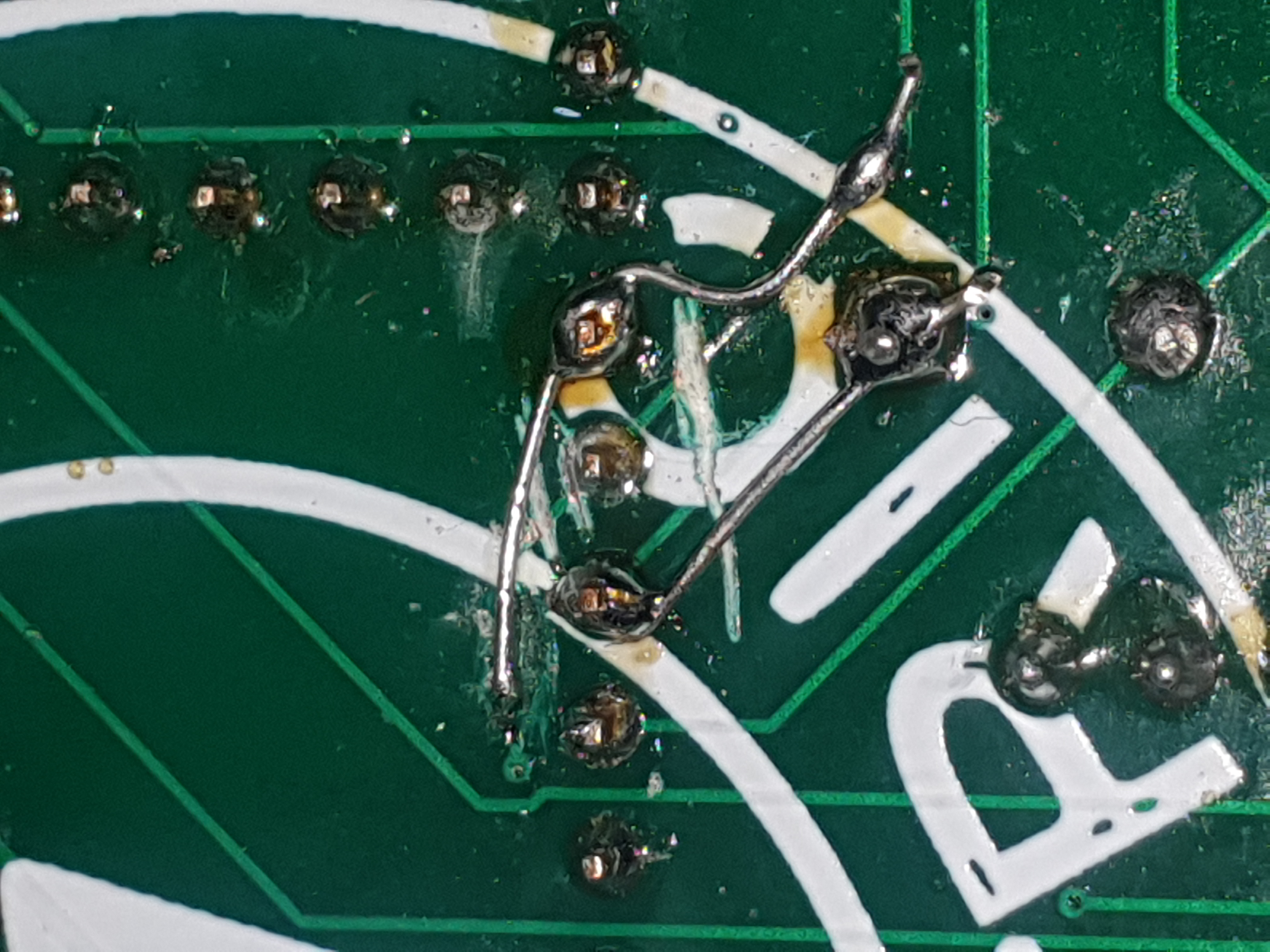

There is another issue though.When i tested both ADC inputs i get smooth sgnal on ADC0 and some 1 trough 5 jumpiness on ADC1. This got me to investigate signal further and i can see diodes clamped down on the signal. I removed diodes and replaced them with 4K7 / 10K resistor divider which gives good signal ratio when teensy is not inserted. However when i insert Teensy i get 3.2V signal on ADC0 nd something is clamping down on ADC1, giving only 0.5V when it should show 2.4V.If i remove Teensy signal jumps back up.
This leads me to belive ADC1 (A16) is toast. Is there any other ADC channel close so i could simply rewire to it? I could cut the line to ADC1 and pull a wire to A15 input close by and then declare the A15 in code as POT B. What do you recommend?

D39 and D38 are right next door so could jump across to those.
Before doing that can you test the teensy on a bread board or similar?
The diodes are there for input protection as we all know how easy it is to kill one of these boards.

I already did that. pin40 is drawing too much power and not reacting to analog input.
I had to cut traces to pin40 and replaced it with pin39. In my haste i managed to damage trace to pin41 as well and so i enhanced that line as well.
Now when i connect throttle i get a good singal to calibrate from both channels.
I added 1K2 resistor as pullup for ISO8 pin to work with my PP signal from charge port. I use J1772 charge port which has 2K7 pulldown resistor inside. Charging action is activated when a switch inside charge plug connects 1K3 pin in parallel creating stronger pulldown. To counter this when not connected i had to add 1K2 resistor as pullup.

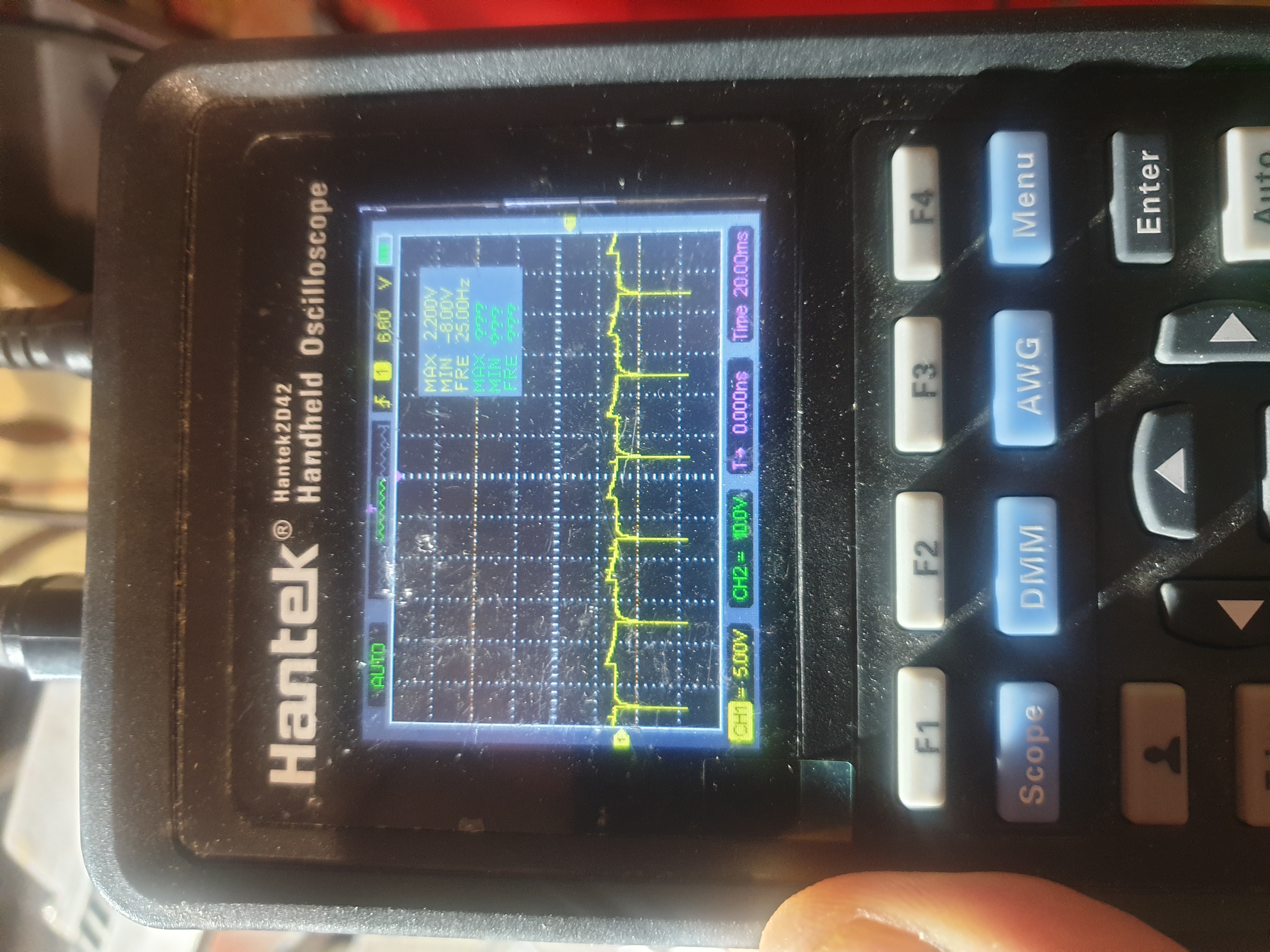

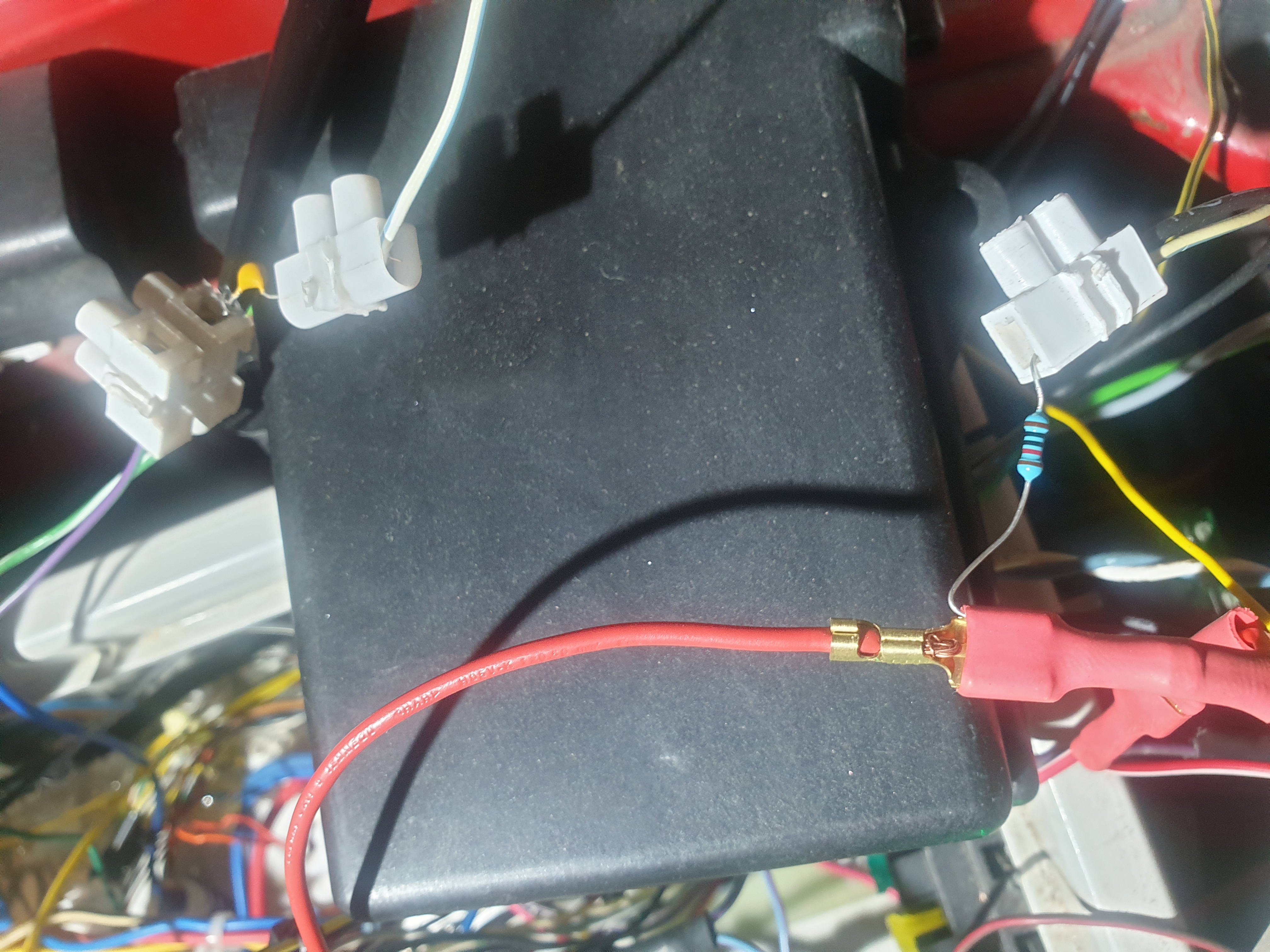

EDIT: I managed to wire for frequency modulated PWM signal for speedo on Out7. I first connected 10K pullup to 12V directly and applied tone() function at 25Hz. I couldnt get speedo to move so i remembered i had similar problems with Peugeot RPM dial. So i added one 1uF film cap on the line in series. This made signal go down and cross 0V and i got speedo to run!
