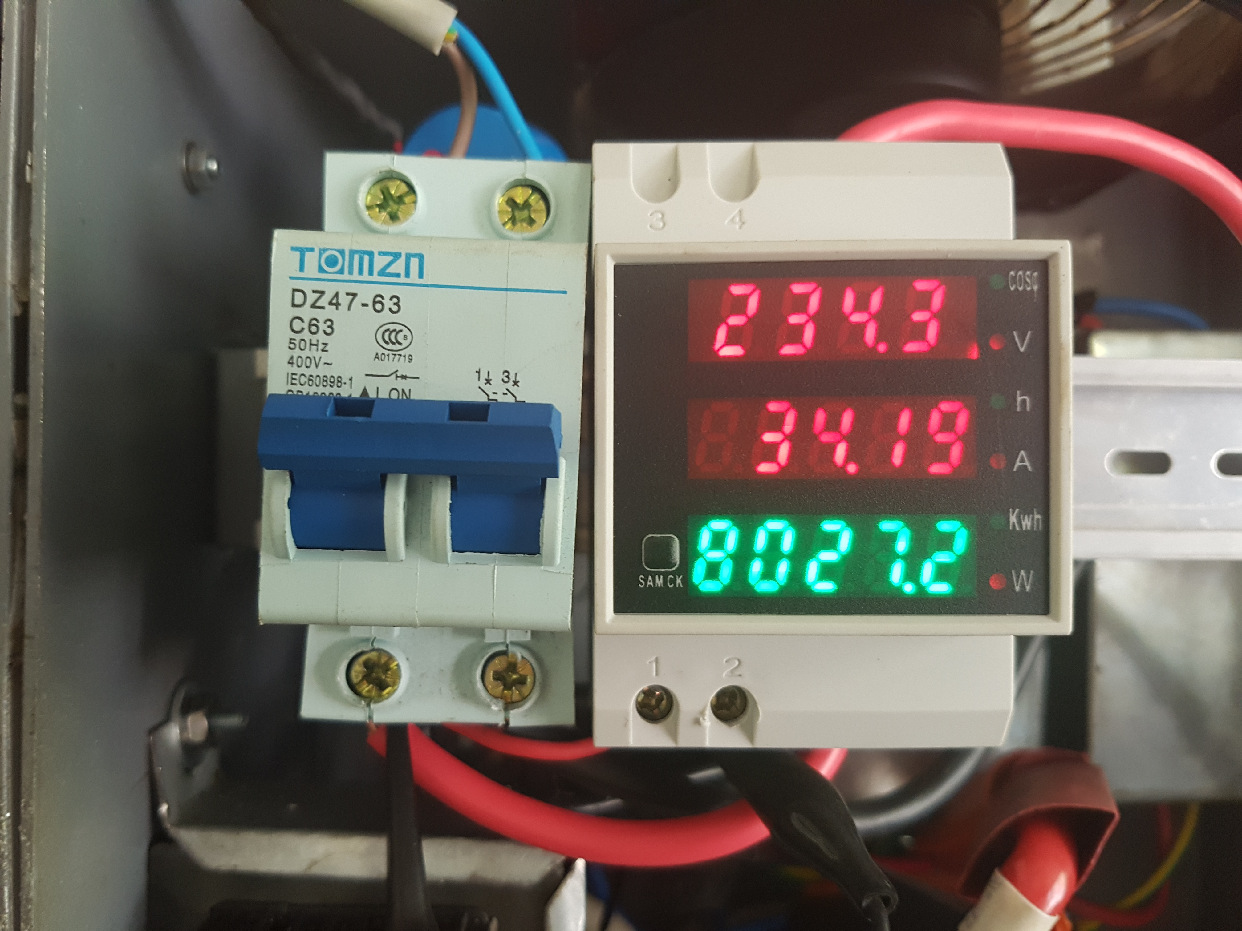

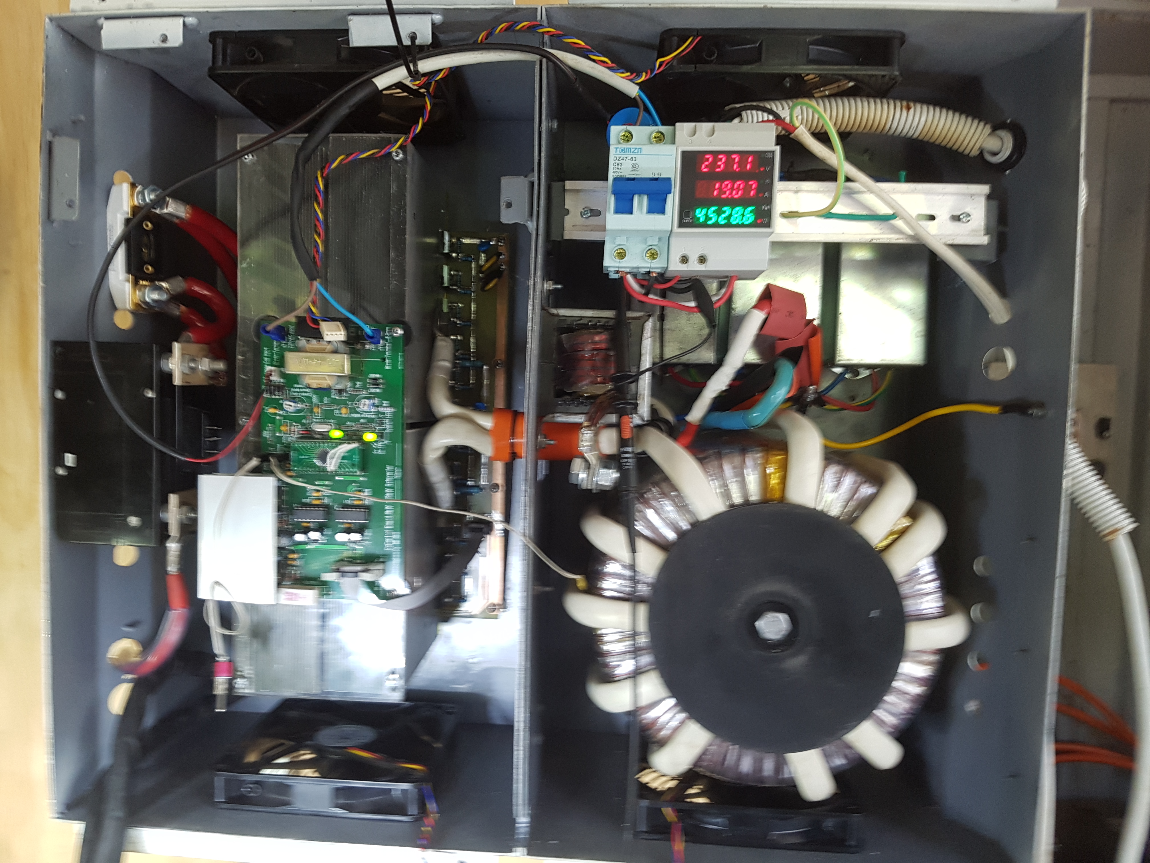

I run my house off of a home built 8KW 48VDC to 240VAC Inverter that I have built myself. However, I was wondering if anybody has attempted using a Prius Inverter to do this? My first thoughts were to use the MGM2 inverter connected to a Toroid as I use now to step up the SPWM with an 1:8 ratio and possibly going 3 phase with 3 Toroids. Another option I am thinking about is would the DC to DC converter be able to work with 48VDC to step up the battery voltage to a level where no transformer is required to step up the output.
Has anyone tried this, I have searched here but could not find any reference to this.

I am only interested in off grid, here and in many countries connecting non approved equipment to the grid can result in very large penalties. There was a case in USA where someone lost their house as a result of it.
With my current setup it is also using grid-tie inverters, they synchronise with the off-grid inverter and any excess power is fed back into the battery.
The Inverter I use now uses a EG8010 IC which does work well, section 6.6 is the basics of what I am using ATM. Also I am working with another Arduino based system that I plan to change to 3 phase.
