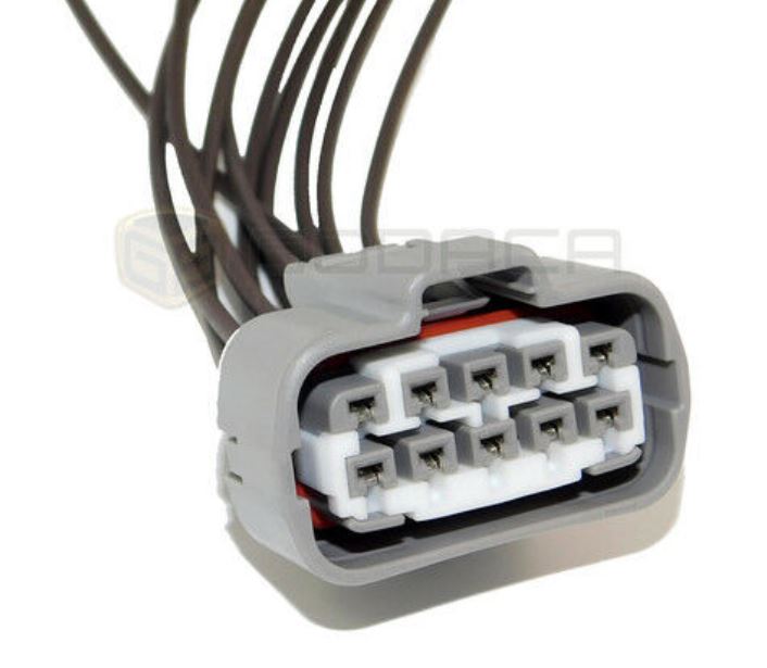

I had this in my thread but I thought I would add it in here to the Hardware thread. DC/DC converter I am using is the TDK unit from the AZD Transit Connect conversions. I gathered a lot of the info from various locations including from lars rengersen who fitted one to his Amazon.
100A water cooled (I did read somewhere that it was 80A if air cooled, tbc).The control pins:
Pin 1 is to disable. Pulling the enable pin to ground, turns off the power supply. Good direction from Lars here was to enable Pin 1 only after precharge is complete as you want the precharge energy to go do the inverter capacitors and nothing else. I actually tried this out inadvertently earlier and sure enough, the main connector wont close if the DC/DC is operating.
Pin 3 controls the output voltage. Not connected it is 14.5v. Pulled to ground is 13.8v.
Pin 6 is a fault pin. Not connected and have not found anyone who uses it yet.
The connector can be found on Alibaba - 90980-11658 10 hole Transmission solenoid valve plug for TOYOTA
http://www.kinkong-connector.com/produc ... ID898.html More info here on the unit.

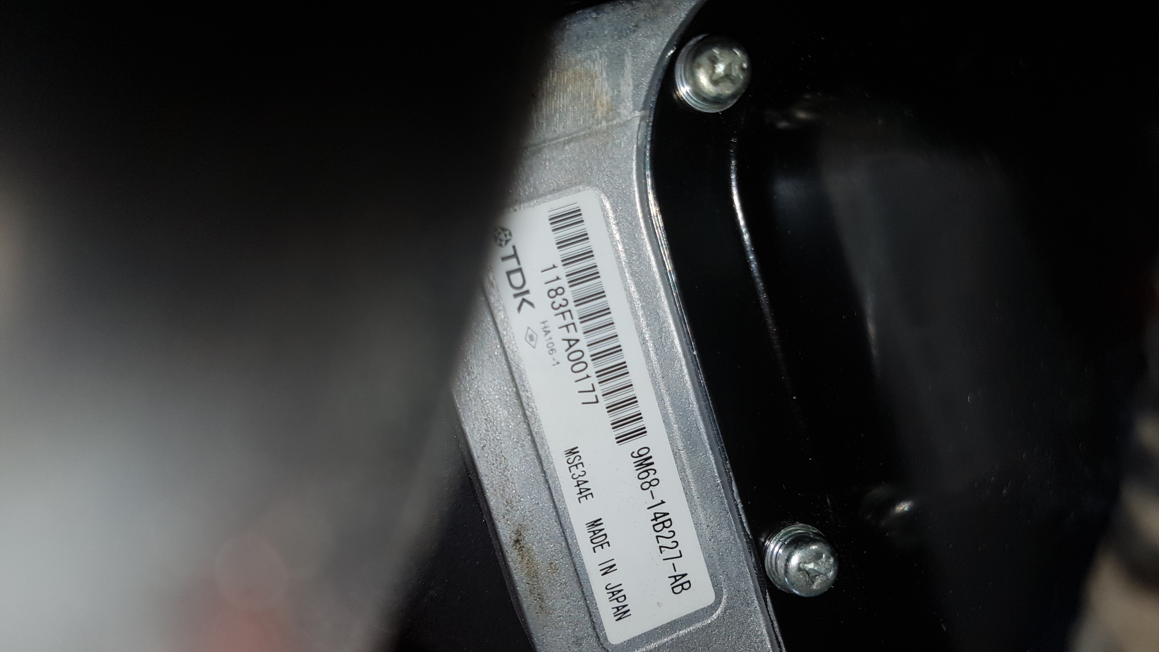

Ah, sorry. I forgot to add in the vital piece. the TDK 9M68 14B227 AB. Here is the label

I just bought the ford escape hybrid version, 8M68 14B227 AB, supposedly rated for 210-397V HVDC and with 1,5 kW max output(?). I'll try it out later and report the results hereCookie6000 wrote: ↑Fri Sep 25, 2020 8:04 amAh, sorry. I forgot to add in the vital piece. the TDK 9M68 14B227 AB. Here is the label

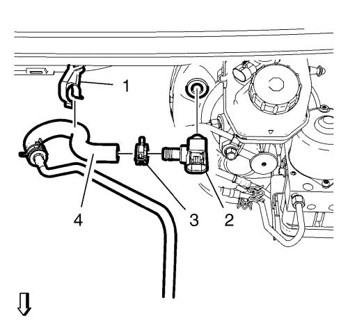

Edit: I have been looking around for more alternatives and came across the Bosch 0265 005 321 Vacuum Brake Servo Sensor from the Zafira C.
https://www.ebay.co.uk/itm/Opel-Zafira- ... SwboFeWXco
You can see here it fits directly into the vac boost servo and the vac pipe out. They all seem to be out there for between €15-€30 so, I might as well get one and give it a test.
On the other hand the same kind of switch in my Mazda works from 2016 without any issues. Go figure...
That looks interesting since i got my UP28 from Zafira. Should have taken the whole pneumo lines with me...
Care to test it under vacuum?

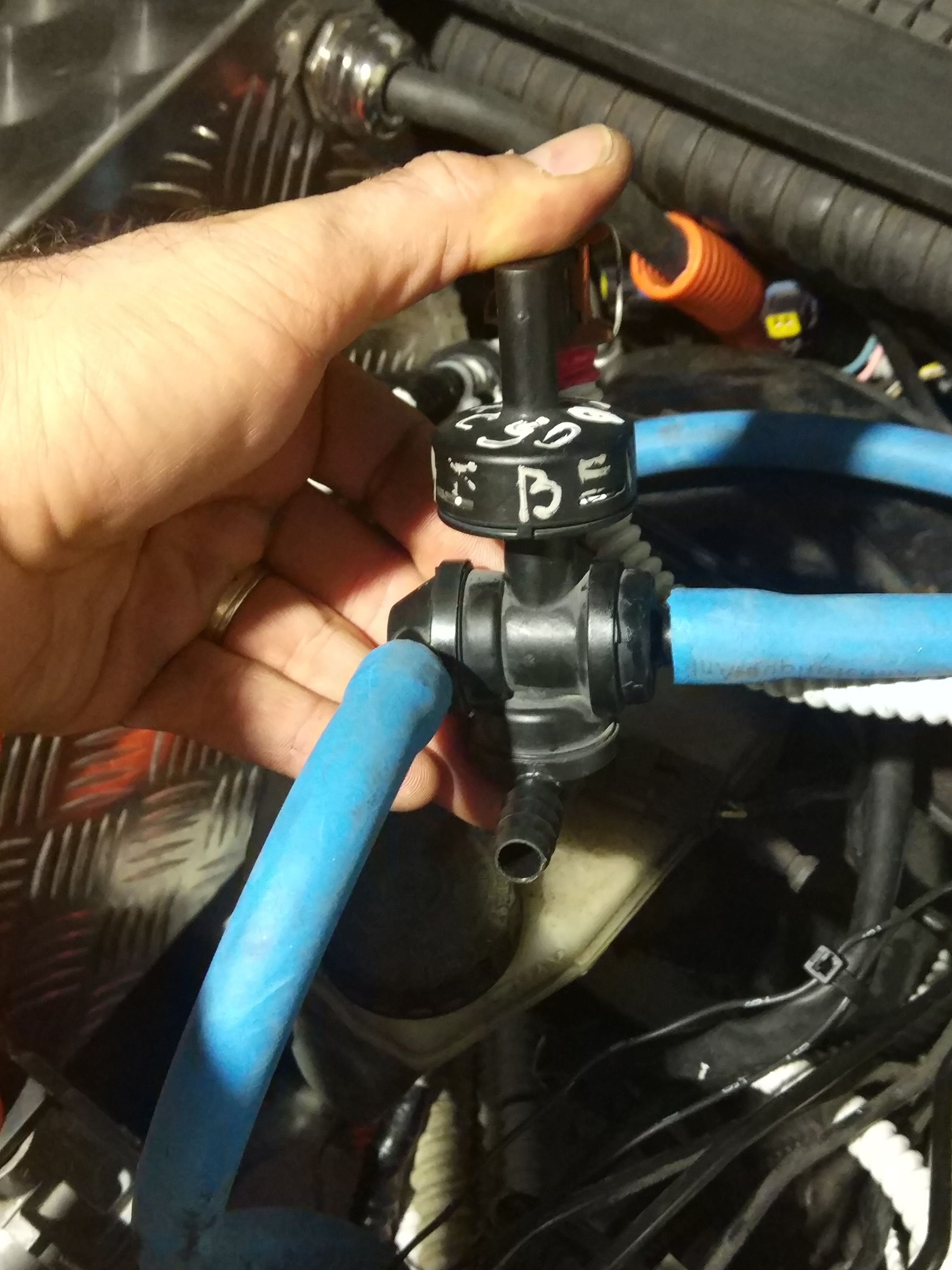

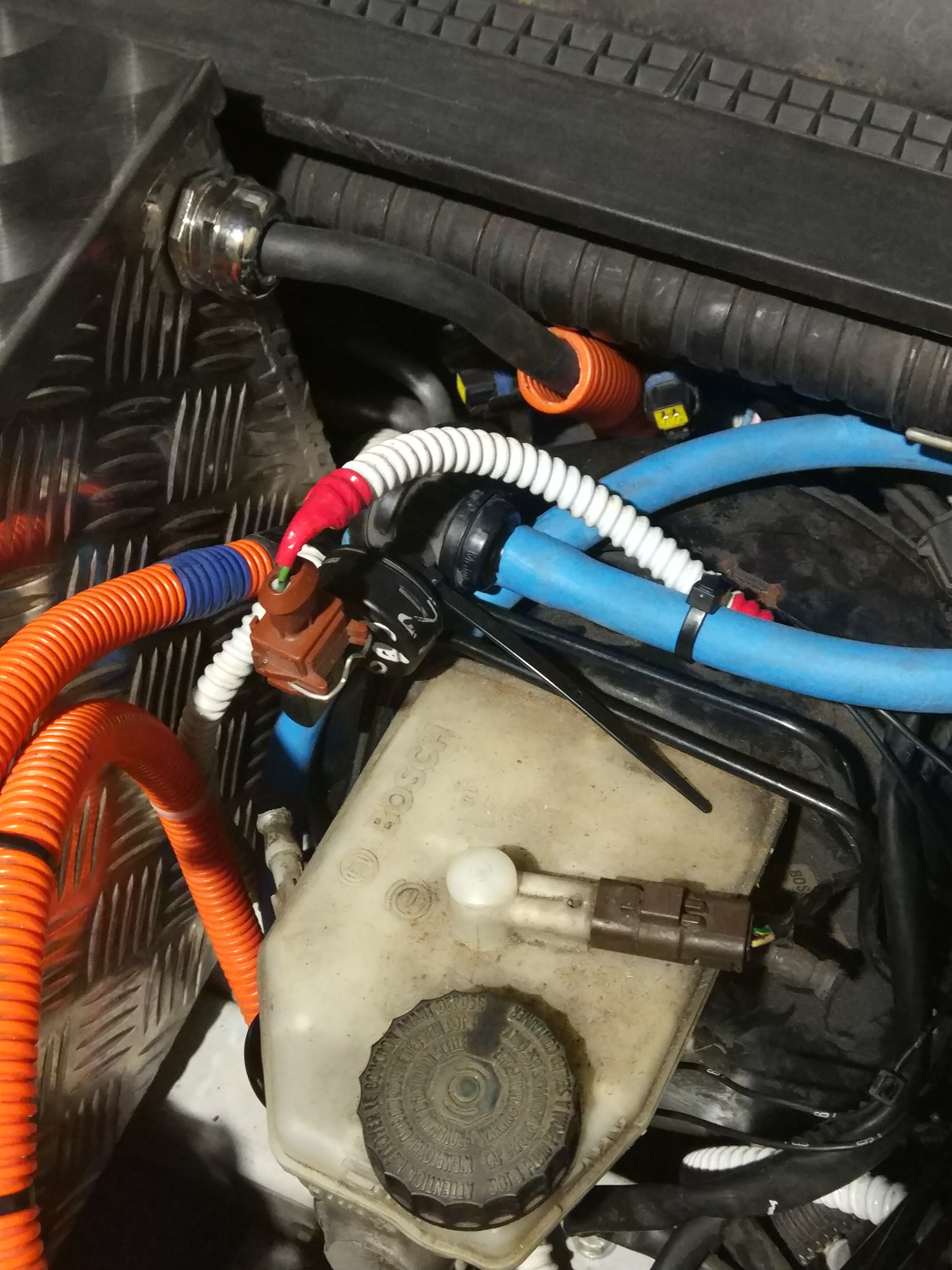

I finally replaced the pesky Dracarys brake switch. It was sticking when operating and i couldnt do anything worth to get it working reliably.
I replaced it with Volvo XC90 switch. See here...
https://www.eeuroparts.com/Parts/178401 ... -31400608/

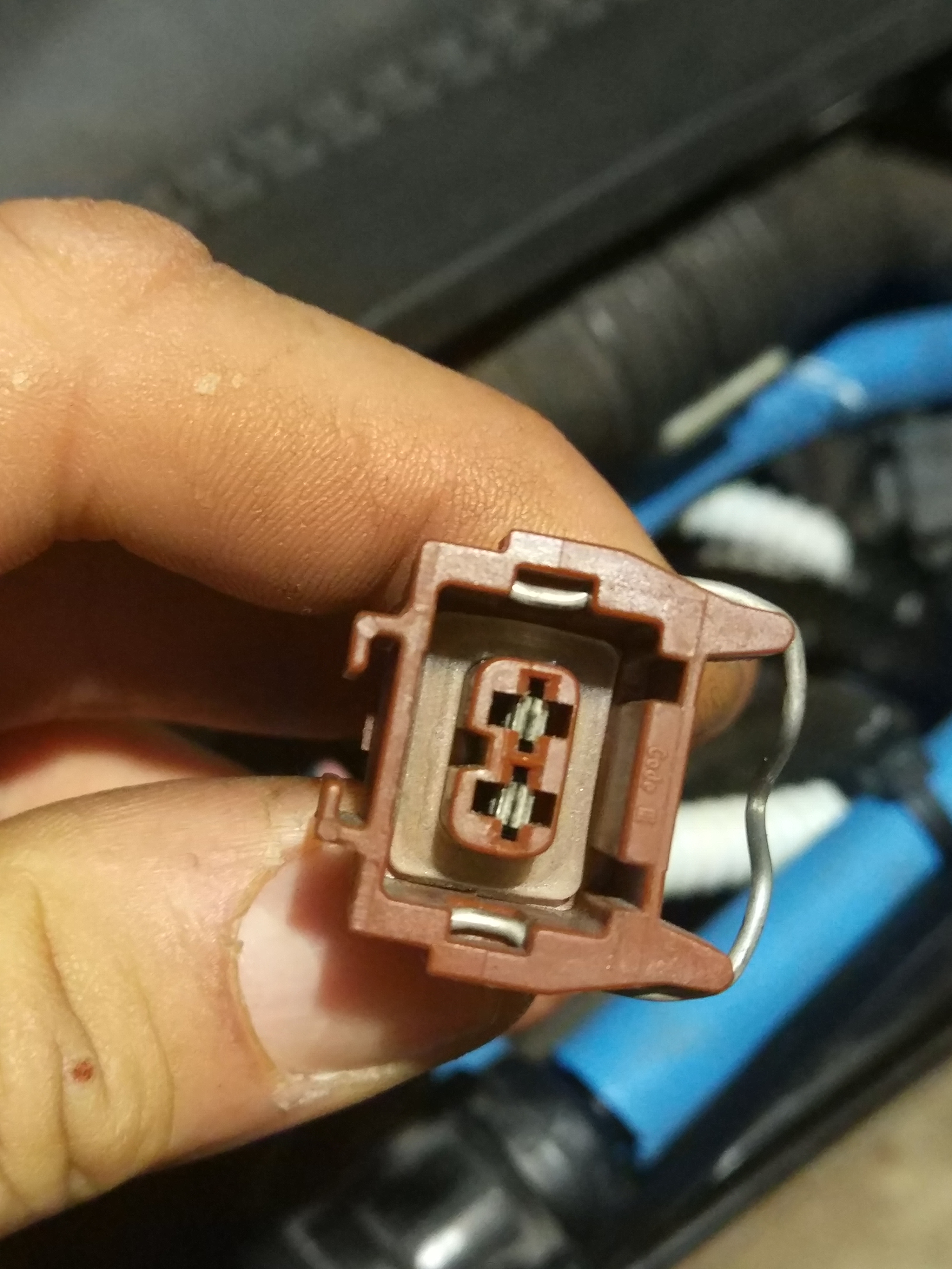

Connector is Bosch of some variant... One line goes to GND and the other one connects to the relay which is powered by fused 12V on the other side.
It has 3 ports. Each port has its own non-return valve. Two ports (1, 2 from leftmost going CCW) vere setup for underpressure flow and one (3) is setup for overpressure flow. This lets me connect the hose directly to 1 and 3 with one port (2) in the air. You can see the 1 port is connected to the pump with 3 port going to the cylinder booster.
For the hose i used blue gas hose since it has double sleeves. I fixed it temporarily directly to brake booster lines.
So far it works without any issues. It keeps vacuum surprisingly long.
Edit: yes, now I can confirm Volvo vacuum switch is definitely worth using. Not only it has a good reliable sensor it also has one way valves built in. Essentially it is a plug and play item. I highly recommend it.

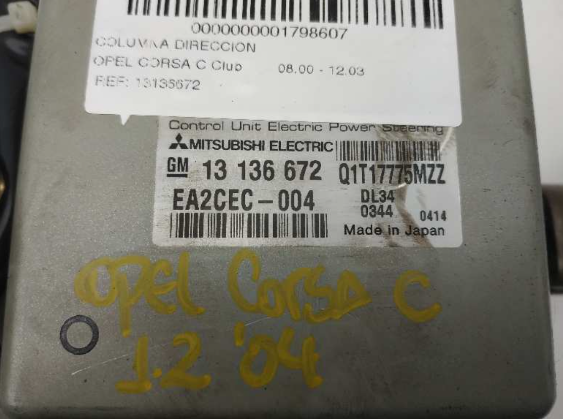

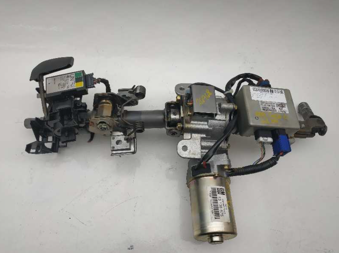

Has anyone come across what the Volvo EPAS pumps want to see doe CAN input? Running in failsafe now and it’s a bit overboosted at higher speeds. Feels perfect when low speed maneuvering but as with everything, adjustability is better.
I’ve searched a bunch and can’t find anything relevant.
- Posts: 3795
- Has thanked: 166 times
- Been thanked: 411 times
Here is one discussionjon volk wrote: ↑Wed Nov 25, 2020 6:48 pm Has anyone come across what the Volvo EPAS pumps want to see doe CAN input? Running in failsafe now and it’s a bit overboosted at higher speeds. Feels perfect when low speed maneuvering but as with everything, adjustability is better.
https://www.diyelectriccar.com/threads/ ... ost-180484

Hi all
Just something I stumbled across today. I was out in the car and showing it to my local mechanic who also specialises in rally and track 1960's Mini's. He showed me what is used as a weapon of choice in small rally cars these days and according to him, takes an incredible amount of abuse and very rarely fails... unless you have a big crash
. The Corsa C steering column, motor plus its own ECU which just needs 12v. Very tidy unit and it even fits the limited space offered under the dash of a 60's Mini. Loose when you are doing slow turning (they like it especially for autotest cars) and it tightens up when you are at speed. They usually hook it up to a speed sensor on a rear wheel but like my own, I could take the feed from the elec speedo pulse coming from the gearbox.
https://www.ebay.co.uk/itm/13136672-ste ... SwmtFfrEgQ
Has anyone fitted one of these before? They have come way down in price and from looking at eBay, they sit between £60-£150 which is incredible. They used to sit around £400. I am going to pick one up and see if it is a viable option for the 8e to remove the constant whine from the TRW Zafira pump. I may even be able to maintain the Audi's rack and be able to remove all hydraulic to free up space.
