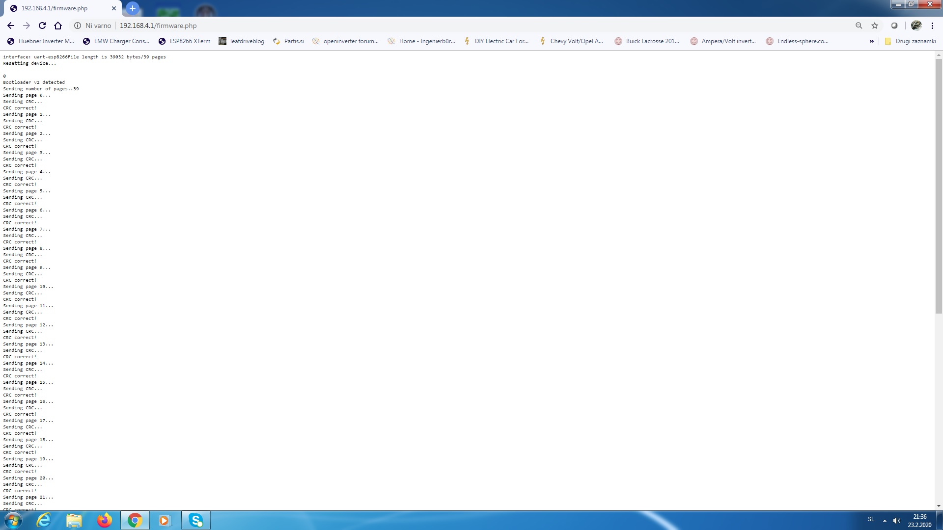

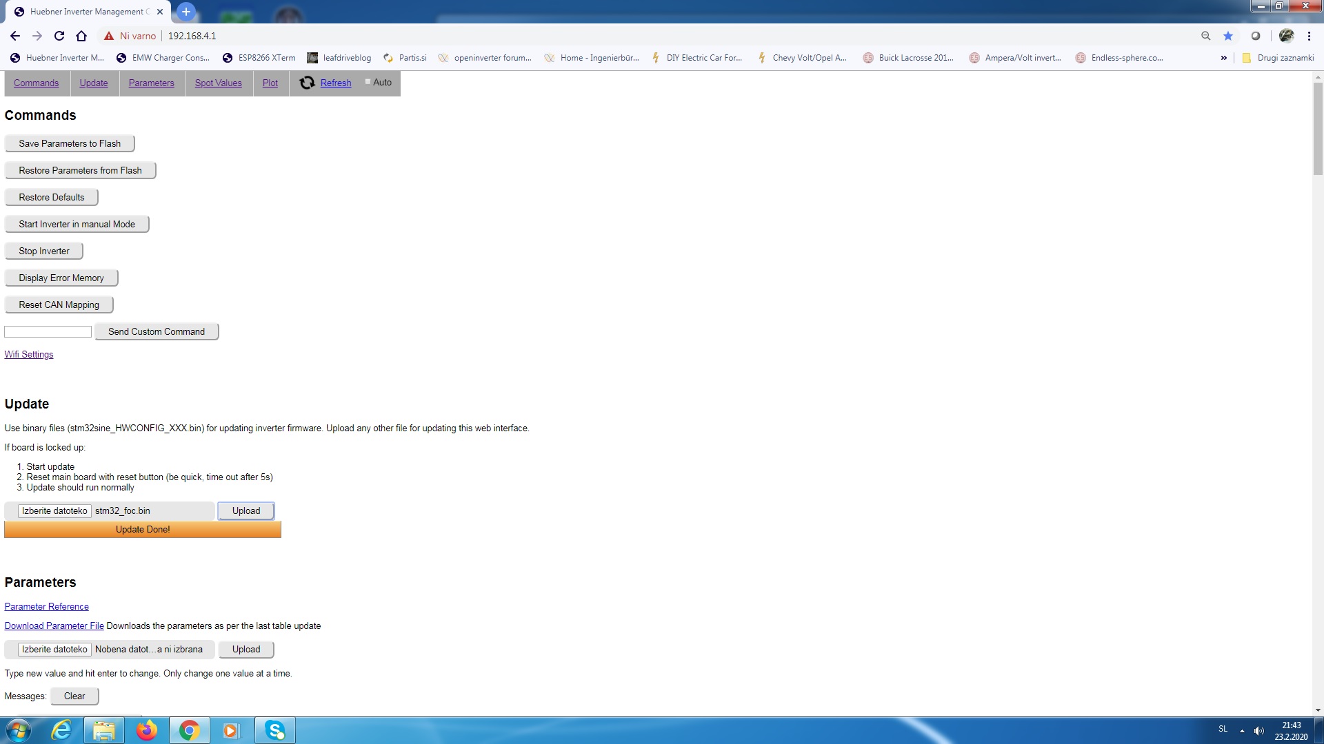

Well i tested with one old Olimex with 4.21 code on it. However i used Weimos D1 with Dima interface loaded. Beautifull!
Second i tested Olimex ESP where i expected to have some problems. BUT no problem uploading latest FOC code on latest SINE code!
I used latest Johannes ESP interface with this.
So for future use i think the problem would lie in updating your Wifi module to latest spiffs.
See some screen grabs...
