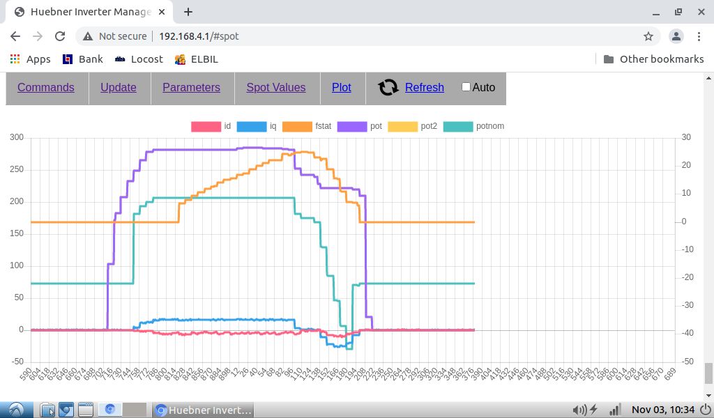

I tested this SW for the first time yesterday and can conclude that the accelerator pedal behaves differently.
When set to "DualCAN" I get full regen as soon as I put pedal below the mid point. When set to "CAN" I get no regen at all below mid point.
With the old 5.06 I had the desired behavior with linear increase in regen with decreased acc pedal below mid point.
Isn't "DualCAN" suppose to be dual values for redundancy?
What has changed and what can I do to fix this so I don't slam the regen when I go slightly below acc pedal mid point?
bexander
Posts: 897
Location: Gothenburg, Sweden
Has thanked: 78 times
Been thanked: 102 times
Re: Inverter Firmware v5.12.R
Post by bexander »
Here is a short plot,
EDIT:
Attached my parameter file as well,
Prius_MGR_FW5_13FOC_2021_11_05.json
(1.38 KiB) Downloaded 367 times

bexander wrote: Thu Nov 04, 2021 8:06 am I tested this SW for the first time yesterday and can conclude that the accelerator pedal behaves differently.
Are you sending anything to pot2? If so, pot2 will scale your regen as well. Check pot2min and pot2max
bexander
Posts: 897
Post by bexander »
Yes, I'm sending the same value to pot2 as to pot1 and both pot1 and pot2 parameters set 0-775 min-max , so they have the same value.
Using 5.06 the DualCAN worked well this way but now it has changed I guess.
Been thanked: 1913 times
Strange, will check
