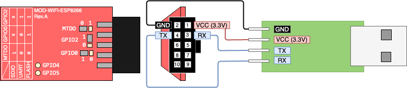

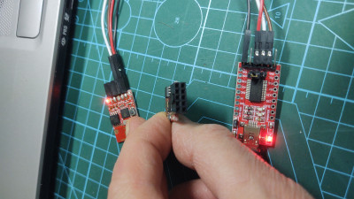

Method 1: Hardwired to UART (TX/RX)
!!! Warning !!! 3.3v only, some USB-TTL have 5v.
Solder GPIO0 to 0
Tool: https://raw.githubusercontent.com/espre ... esptool.py
python esptool.py --port COM1 --baud 115200 write_flash 0x000000 flash-sketch.bin
python esptool.py --port COM1 --baud 115200 write_flash 0x100000 flash-spiffs.bin
To seal the flash, solder GPIO0 back to 1

Error?
Olimex site and schematic says pin 3 is RXD and pin 4 is TXD
https://www.olimex.com/Products/IoT/ESP ... e-hardware
dima
Posts: 157
Re: HOWTO: Flashing ESP8266
Post by dima »
Depends which perspective you are looking from. RX port but coming from inverter TX "into it". Only one wrong :) unlike 4-dimentional USB port.

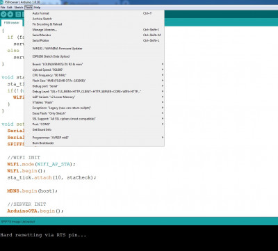

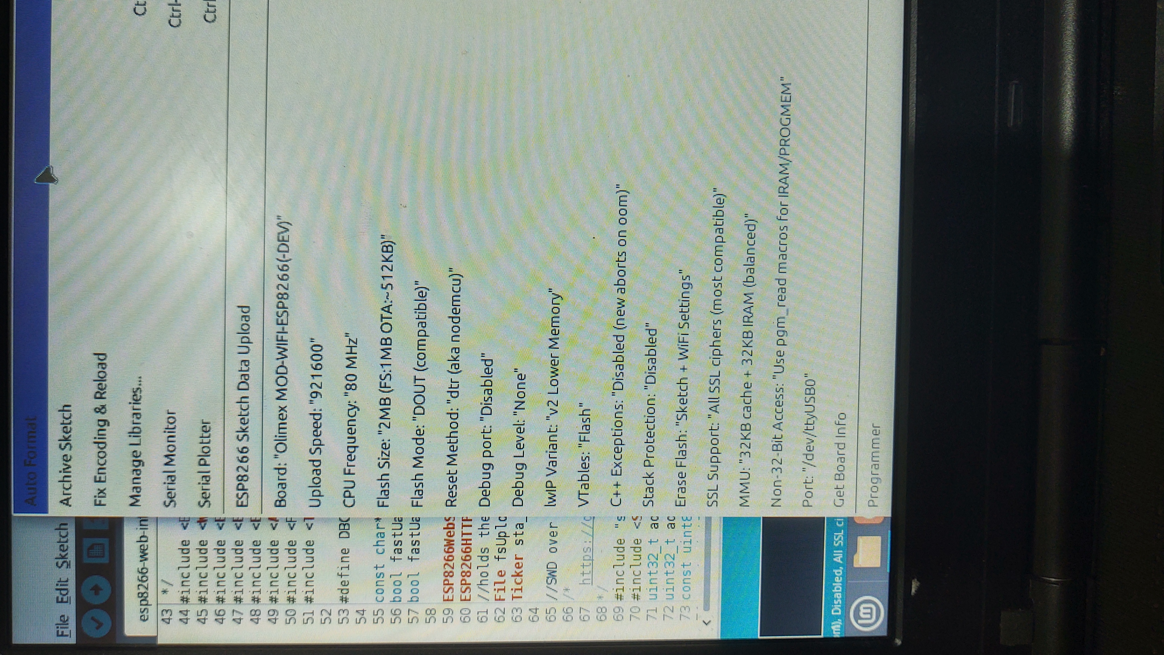

A problem!
I took a brand new ESP8266.
I uploaded Johannes ESP8266 web interface ino file.
Then i installed the SPIFs.
Then i got inside web interface and set wifi password and SSID. I get into web interface no problems.
Next i connected wifi gizmo to my off-car V2 board. But web interface wouldnt load parameters! I tried changing the tx/rx wires, but both setups show exactly the same view. Waiting circle rolling at parameter line...
Any ideas?
I loaded flash onto Olimex ESP8266 mod board as well as on Wemos D1 mini. The latter is much easier to program. But still i cant connect to the board data stream effectively. What am i doing wrong?
I am attaching my settings in arduino.
tnx
A
Been thanked: 1918 times
Try switching off all debugging (Debug Level). I think it dumps messages via uart that confuse the inverter
Posts: 3796
Been thanked: 413 times
johu wrote: Thu Dec 26, 2019 10:40 pm Try switching off all debugging (Debug Level). I think it dumps messages via uart that confuse the inverter
We have connection! I turned off debugging like you said and everything works now. Thank you.

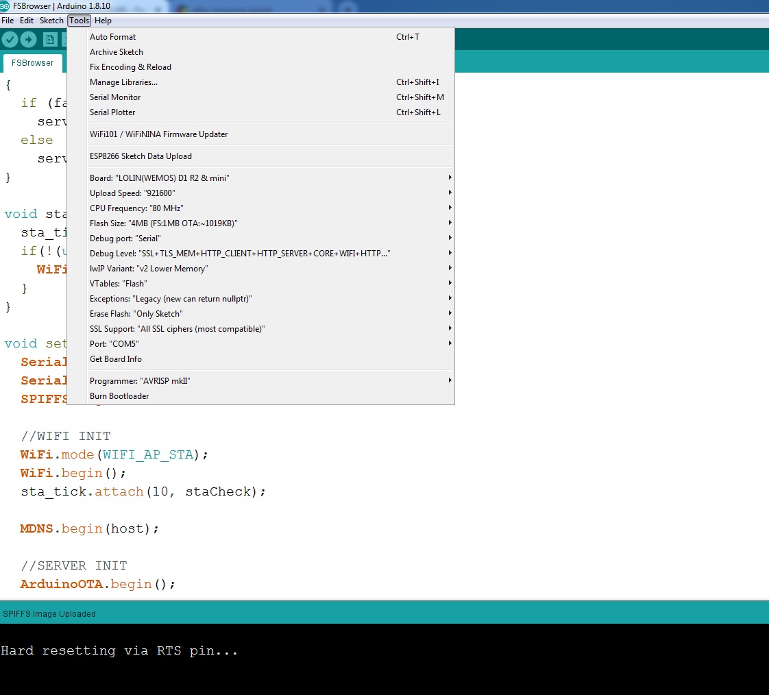

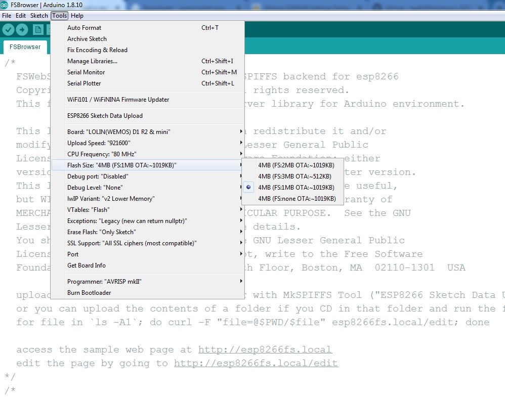

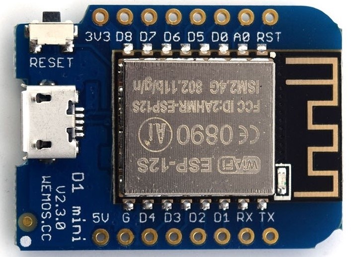

I decided to try to use Weimos D1 mini for Wifi adapter.
It has some more I/Os vs the Olimex board. Also it has USB poirt and its own FTDI. But i consider one thing really good. That is it can be flashed without jumper soldering. I messsed up one Olimex board because tracks fell off from soldering tiny jumpers.
Here are some instructions for anyone:
1. Download latest Arduino IDE and install it to PC
2. Buy a Weimos D1 mini ESP8266 board with FTDI and get CH340 driver from https://www.wemos.cc/en/latest/d1/d1_mini.html
3. Inside Arduino IDE install ESP8266
- open the Preferences window
- enter https://arduino.esp8266.com/stable/pack ... index.json into the Additional Board Manager URLs
- open Boards Manager from Tools > Board menu and install esp8266 platform. I select LOLIN D1 R2 mini board, settings are in the pic
4. Install ESP8266 Filesystem Uploader
- Download https://github.com/esp8266/arduino-esp8 ... n/releases python support files
- extract file to Arduino IDE tools folder like you see here https://randomnerdtutorials.com/install ... duino-ide/
- restart Arduino for changes to come into effect
5. Download Johannes Web interface code here: https://github.com/jsphuebner/esp8266-web-interface
- put the code in the same dir as the ino file, default FSBrowser
- make another dir Data inside first and copy everything here again (i am not sure which files are correct, so i just copy them again) this are the SPIFS
6. Connect board to USB and select correct COM port and rest of settings
- if you used a new board you have to select "erase flash: sketch + wifi settings" so the board will erase its password
- click upload and wait for interface to reset the board
- select tools/ESP8266 sketch data upload and wait for the board to reset

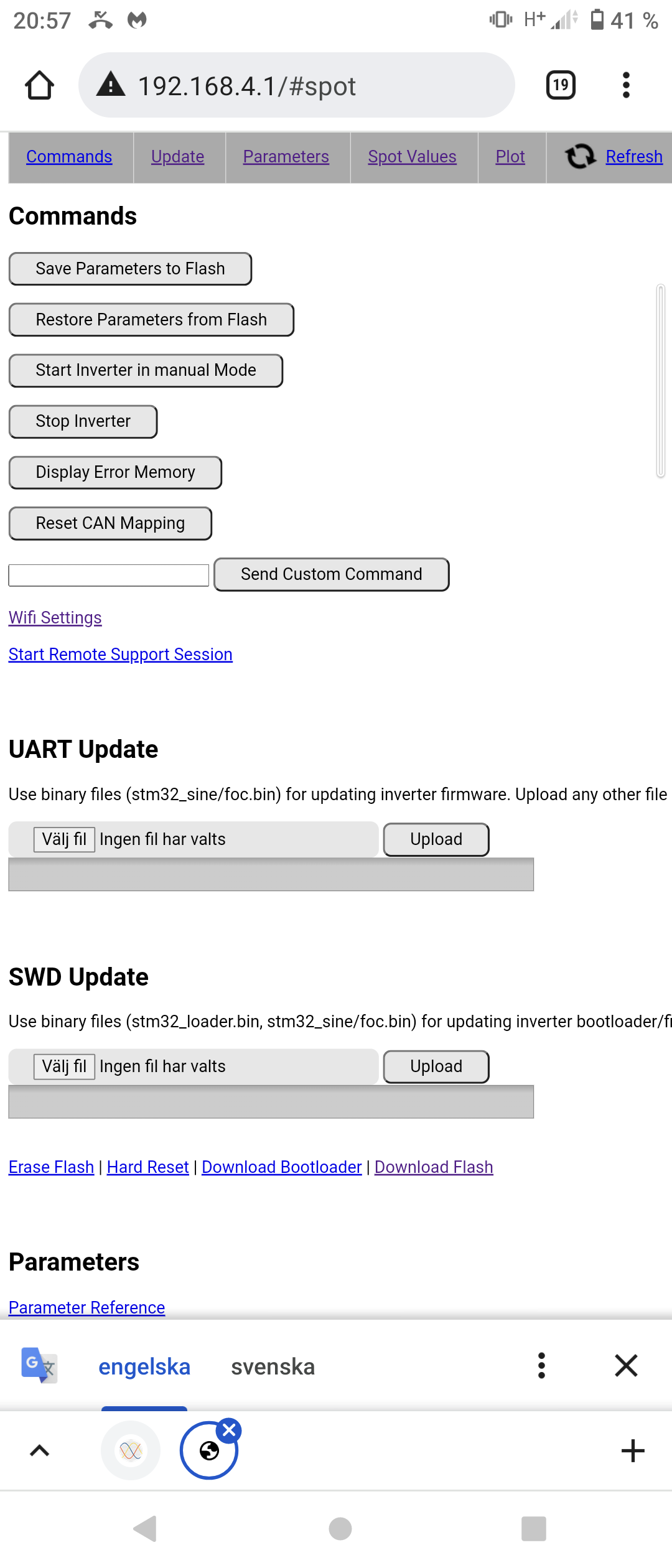

- connect to the board and go to http://192.168.4.1/ to set your wifi settings inside interface
- connect your board to Johannes board...
Feel free to correct me if something is not correct. I installed everything over a month or so and because some time went by i may not remember everything i have done...

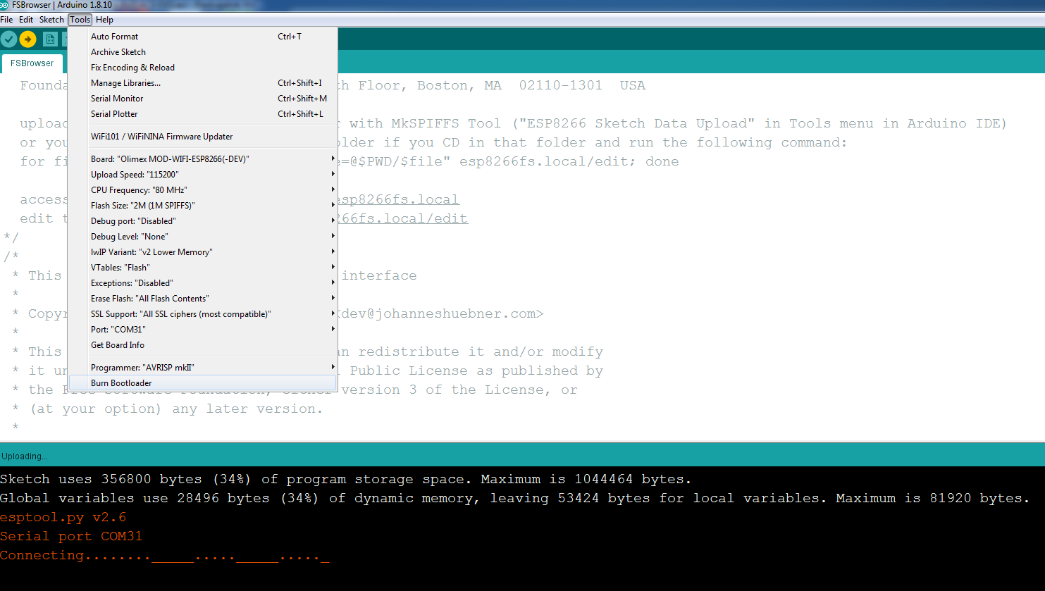

DOH!

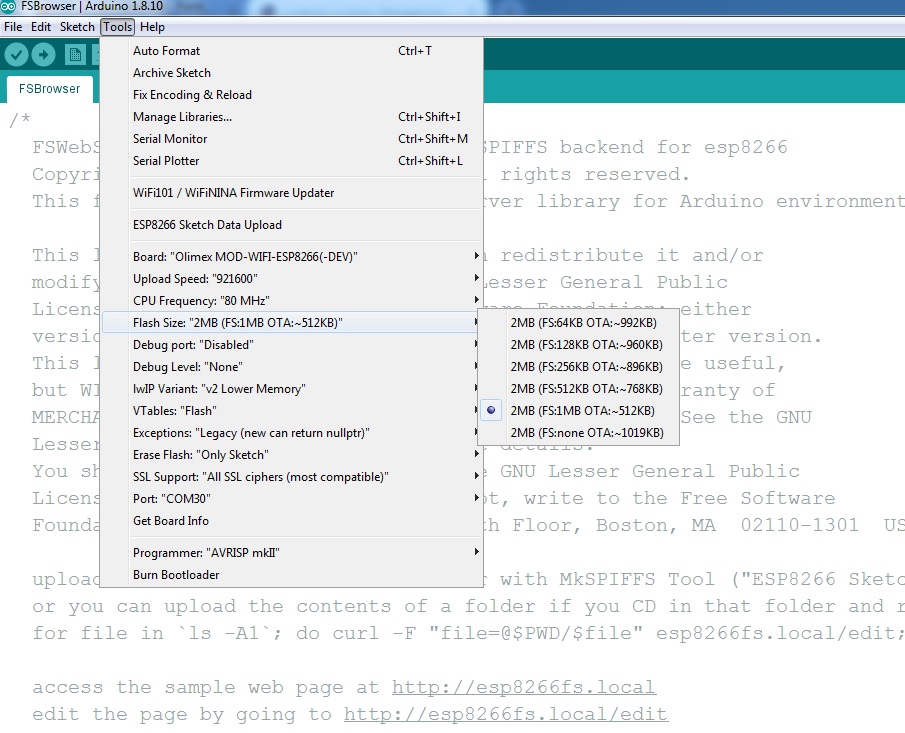

Again i am at a loss. I tried to programm Olimex ESP8266 MOD gizmo and i was successful. Also i uploaded SPIFSs without a hitch.
Then i resoldered the jumper and tried it on my desk Rev 2 board.
I got web interface, but i couldnt get any data through. No parameters.
I upload my screen capture. Can you tell me what else is wrong here?

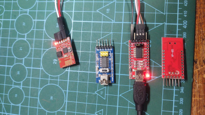

But the simplest method would be to use one FTDI USB cable and load Linux on some work laptop.
Linux has better support for Pyton.
But you have to learn yourself the language and command line use.
I do not want to hassle with cable, because at 380Vdc EMI causes interface to freeze or interfere with its work in some way.
Wireless is just better.

I went driving with newly flashed D1 mini and i must say it is a success! Everything works. I even noticed new data logger. Didnt see that before on my older Olimex ESP8266.
Additionaly i just had a success with flashing the older Olimex ESP8266 module. It seems the problem was that i didnt reset the main controller when i plugged the module on. Therefore it didnt restart comms but was stuck in the middle.
Now it works the first time i plugg it in...YAY!
I plug it in, it does it's little beep and wiggle for new device found.
... Where am I selecting COM port and rest of settings? It doesn't popup and I can't see anywhere that I set COM Ports (never did find it).
I wasn't sure what this was referring to. But I finally found it. You're referring to the Arduino IDE, under the Tools Menu, down near the bottom is "Erase Flash: Only Sketch", you have to click that, go to the submenu, and change from "Only Sketch" to "Sketch + Wifi Settings". Unintuitively, the Arduino interface menu options change what they're named to reflect what they're currently set to. So you can't find that setting. I.E. If at MacDonalds the menu said "Burger: Chicken" and you were told to select the "Burger: Beef". You scan but you can't see it. Beef isn't an option, you have to know that you're selecting "Chicken" and then turning that into "Beef" and then the name for that option is now "Beef" instead of "Chicken". Every little thing that isn't quite what you expect it to be makes it harder for someone who doesn't already know what they're doing.
I found 3 different upload buttons:
- In the "Sketch" menu there is an "Upload" option.
- In the "Sketch" menu there is an "Upload with Programmer" option.
- In the "Tools" menu there is an "ESP8266 Sketch Data Upload" option.
If I select the 3rd option, it spits out SPIFF and COM port errors.
If I select the 1st option, it chokes on COM1 and asks me to reselect, then for the first time lets me pick (only 2 options, COM1 and COM13). I picked the other COM option and it appears to have worked. I still don't know how to select a COM port other than through this error screen, I imagine if I was connected to multiple devices I could easily ruin some of them by not getting to pick a COM port unless the connection fails. Hrmph.

8. When you are satisfied everything is setup use the "right arrow" ison to upload the board with ino code. After successful uploading Arduino will tell you it has reset the board.
9. Now go to menu tools and click on ESP8266 sketch Data upload line. This will upload everything from Data folder and Arduino will again reset your board.

D1 will run ff 5V of 3V3. I recommend you look underside of D1 there pins are declared. On Bluepill it can be discerned from viewtopic.php?f=3&t=220&start=20#p2623 Pic shows pins on the pill as well aas Wifi lines.

Okay, new WeMOS D1 Mini board arrived today. Reflashed it and am ready to go.
Not sure I know what to do with it though. No one has any screen captures of what I'm expected to see or what I'm supposed to do with it. I'll take some when I understand enough about what I'm supposed to be doing.
When connected interface should show default parameters. If there are no parameters loaded i reset the main chip and try to connect again.
When inside web interface i search for "Wifi settings" and change SSID and Password. Then reconnect.
I don't know if I can see if any parameters are loaded.
Here's what I see:
Is there a way of testing things or initially setting things up for a test run or knowing if the Blue Pill is even working before I hook a motor up and see if it spins?
