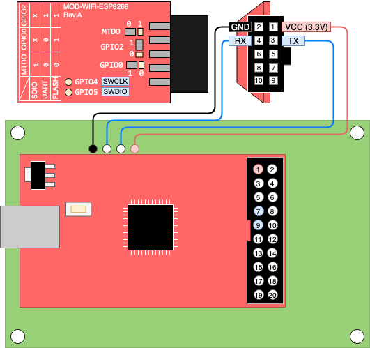

If Putty returns "2D" it means you flashed the bootloader but not the firmware :roll: can you issue inverter commands and get response back? example "get version"
I recommend going ESP8266 route. I'l do more troubleshooting on my end.

If I issue "all" I get back a full listing of parameters. "list" gives a listing of all the available parameters, and their acceptable values. So I'm pretty confident I have both bootloader and firmware flashed. Plus I have the flashing green LED on the Olimex, which would indicate the timer ISRs are running.
Does the ESP8266 firmware include any php pages? Or is is a simple conversion of the serial link to TCP/IP and WiFi? It may be best for me to simply stick with a puTTYtel session if I want to use the serial port directly.

ChazFisher wrote: Sun Sep 08, 2019 4:36 pm Does the ESP8266 firmware include any php pages?
Yes it is a compressed version of php pages.

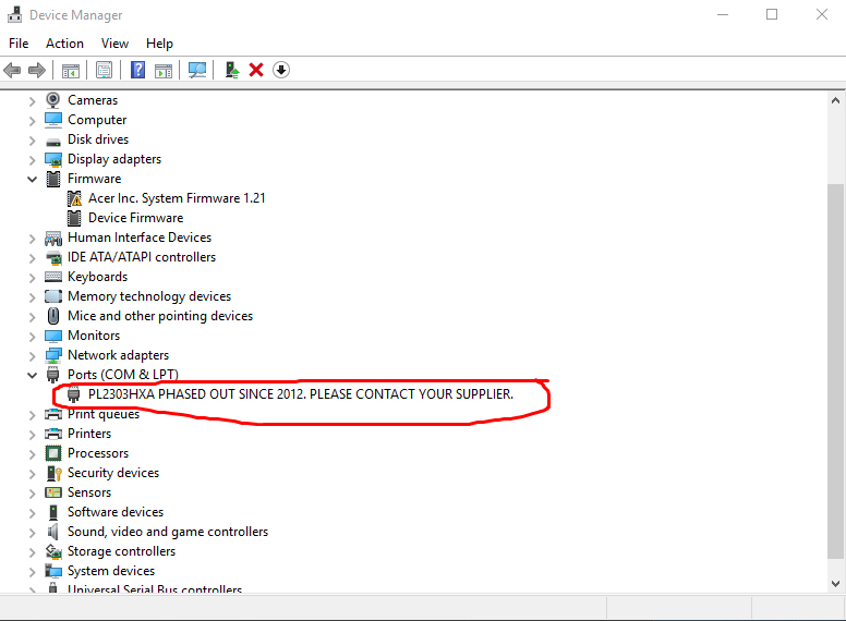

Watch out for (Chinesium) Prolific USB-TTL adapters. They show OK for drivers but don't work properly.

For Windows CH340 based is much safer than FTDI: https://www.zdnet.com/article/ftdi-admi ... nt-update/

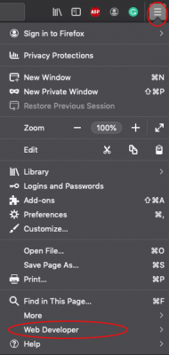

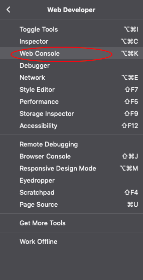

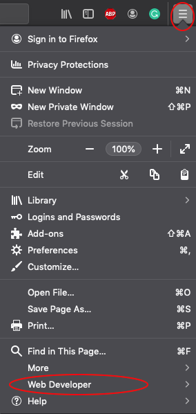

Wow I am curious now, I tried it on multiple computers with multiple adapters with HW ver 1 and 3 cannot reproduce the issue.
Help troubleshoot this, using Firefox (not IE) go to Menu-> Web Developer -> Web Console and then open http://127.0.0.1:8080
Post here the console messages.
Also what happens if you go directly to http://127.0.0.1:8080/serial.php?init=115200
