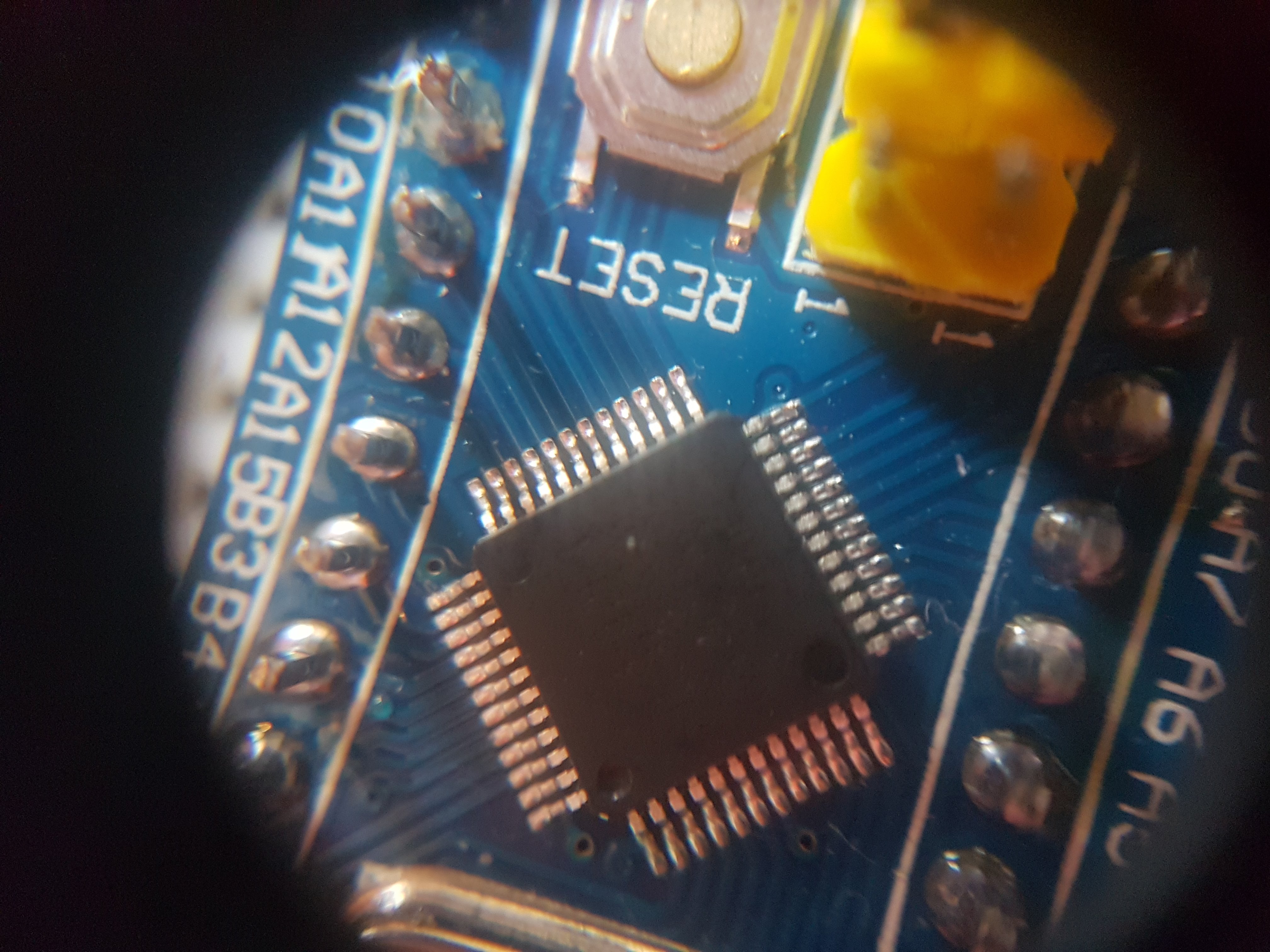

Apparently there's a lot of fake chips on these bluepills. https://www.cnx-software.com/2020/03/22 ... m32-fakes/
I think it's safe to say I have a fake.

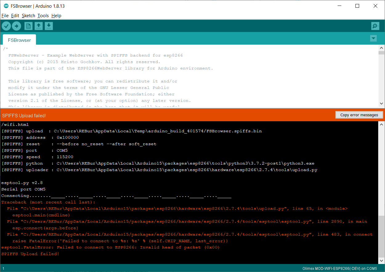

I am trying to flush ESP8266 but getting error when I am trying to compile Arduino code.
Arduino: 1.8.13 (Windows 10), Board: "LOLIN(WEMOS) D1 R2 & mini, 80 MHz, Flash, Disabled, All SSL ciphers (most compatible), 4M (2M SPIFFS), v2 Lower Memory, Disabled, None, Only Sketch, 921600"
In file included from C:\FSBrowser\FSBrowser.ino:69:0:
sketch\src/arm_debug.h:130:49: error: 'StreamString' has not been declared
void hexDump(uint32_t addr, unsigned count, StreamString &data);
C:\FSBrowser\FSBrowser.ino: In lambda function:
FSBrowser:624:46: error: no matching function for call to 'ARMDebug::hexDump(uint32_t&, uint32_t&, StreamString&)'
swd.hexDump(addrNext, addrCount, data);
C:\FSBrowser\FSBrowser.ino:624:46: note: candidate is:
sketch\src/arm_debug.h:130:10: note: void ARMDebug::hexDump(uint32_t, unsigned int, int&)
sketch\src/arm_debug.h:130:10: note: no known conversion for argument 3 from 'StreamString' to 'int&'
exit status 1
dima
Posts: 157
Re: HOWTO: Flashing ESP8266
Post by dima »
This is new revision with SWD mod
"src" folder must be inside C:\FSBrowser\
"sketch"? Do you have other .ino files open? Only "FSBrowser.ino" should be open, close others.

I have updated esp8266 board package up to version 2.7.4 and sketch compiled correctly and I managed to upload sketch to Olimex board and program SPIFFS.
next test it on the board

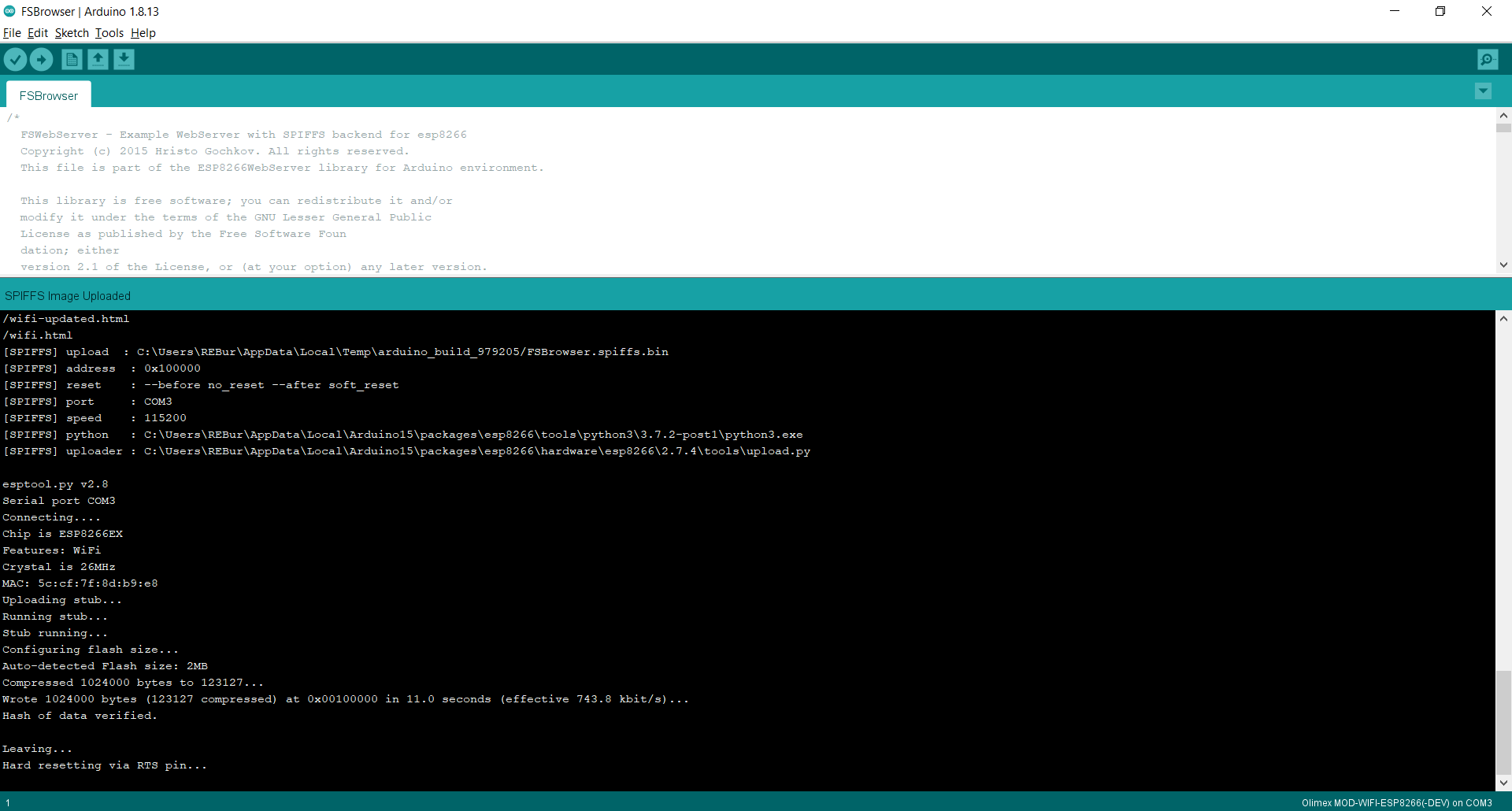

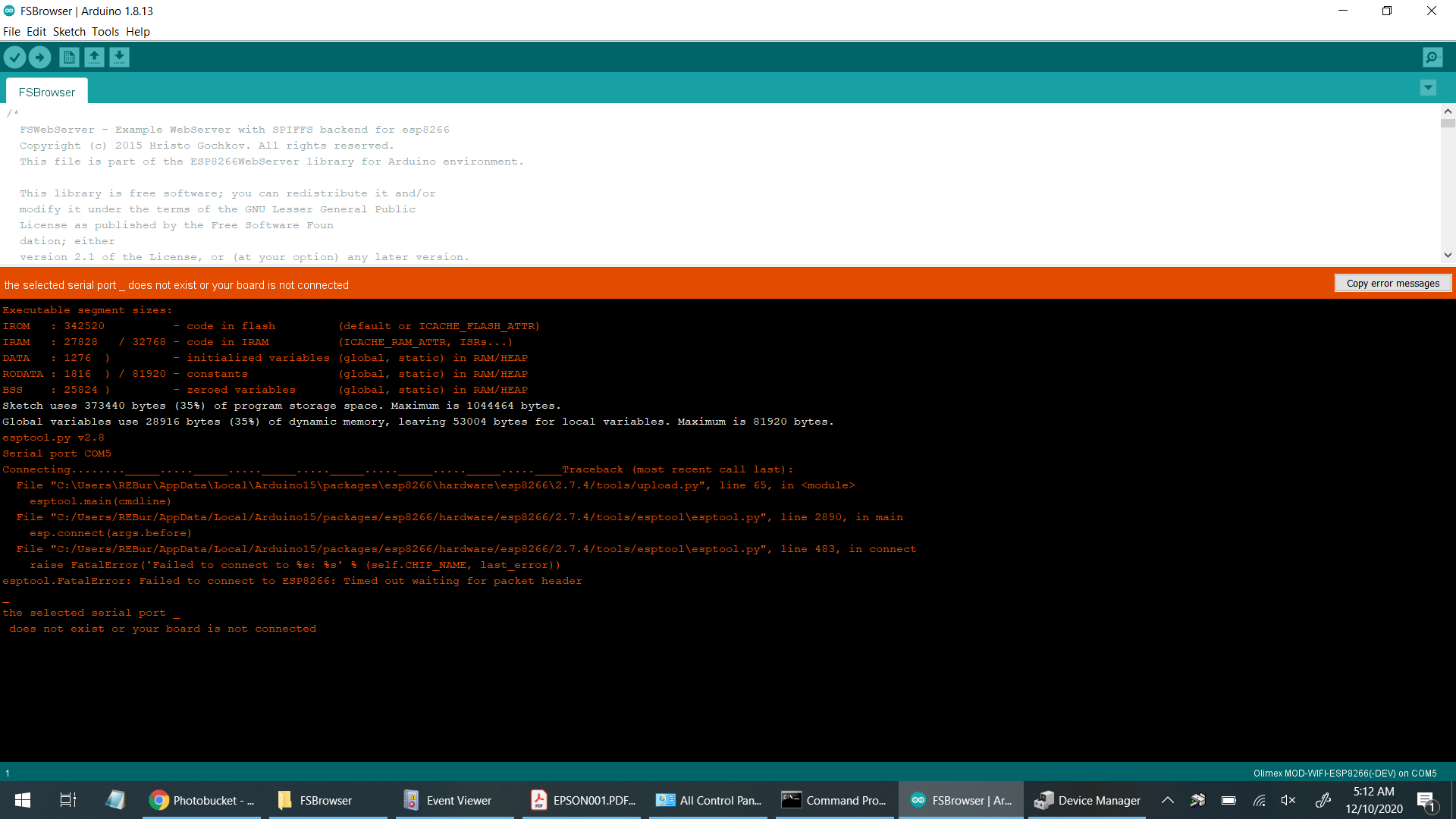

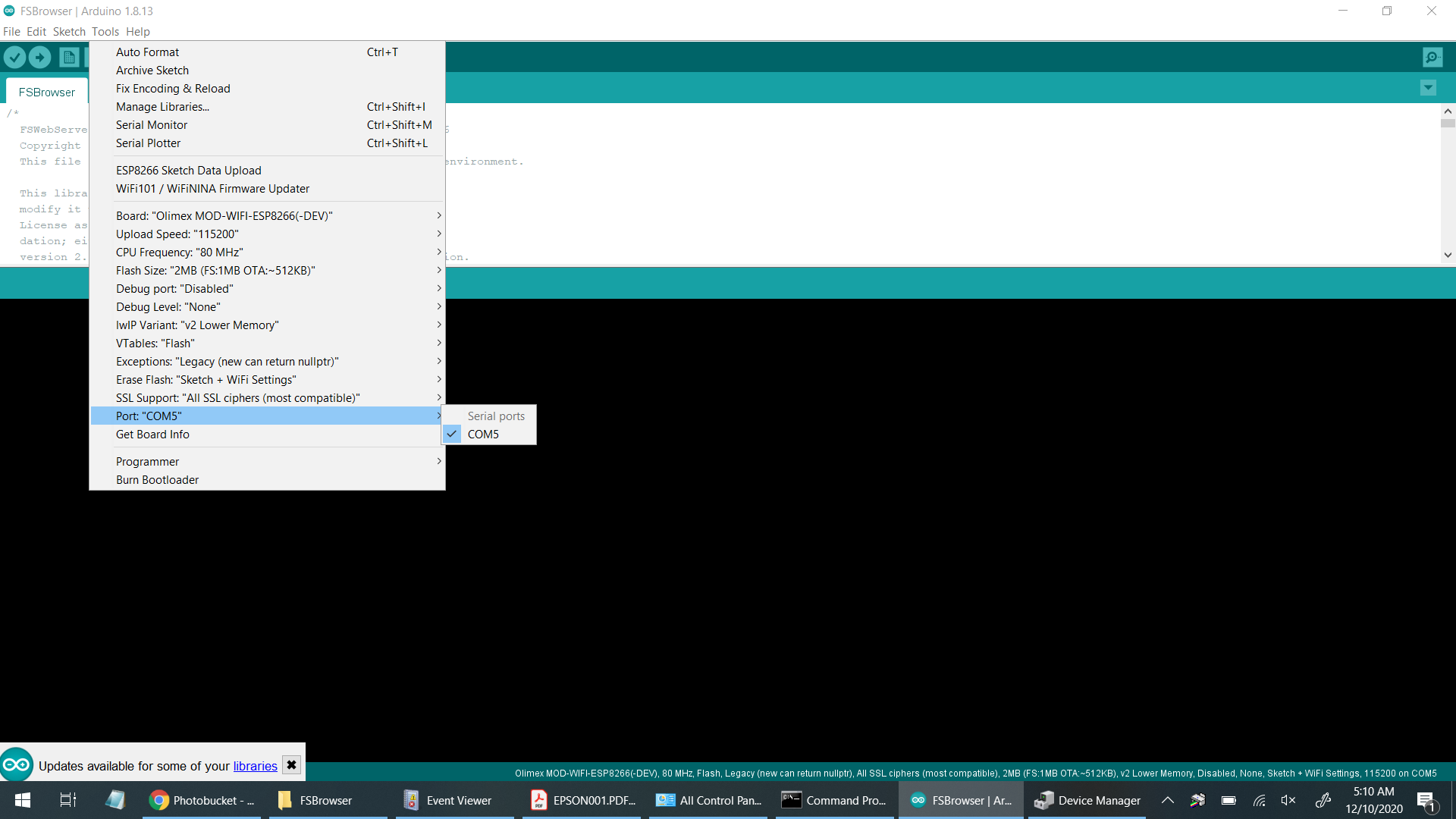

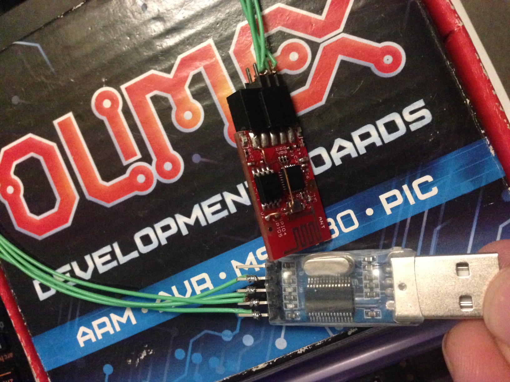

Chip is jumpered to UART. Continuity meter indicates the jumpers are good and not shorting over to an un-intended pad. Admittedly I found jumpering the small pads challenging. I have the chip powered up by a 3.3v USB source and the RX/TX wires swapped.
I've uninstalled and re-installed Python and Arduino twice. Here are the settings.
This is clicking the regular upload button (arrow). This turns on the greenlight on the chip after it finishes compiling.
This is clicking the Sketch Data Upload under tools. It also turns on the green light on the chip.
I'm not sure if I'm missing something on the install, a permissions setting on the computer, something off on the settings, or if its hardware. Thoughts?

You are using a USB-TTL adapter right?
TheSilverBuick
Posts: 187
Post by TheSilverBuick »
I'm using a USB to Serial adapter, and supplying 3.3v with the STM programmer USB stick. If it's the wrong tool, $10 isn't much to get the right one. There aren't many options with the 3.3v power supply.
dima
Posts: 157
Post by dima »
No good, need TTL.
TheSilverBuick
Posts: 187
10-4! Thanks! Living and learning. Will get the right tool and report back.
TheSilverBuick
Posts: 187
Looks like that did the trick! I need to read up on the next step, but I assume its going to involve either powering it up with the USB adapter aga or plugging it into my control board, powering it up and the logging into it with my phone.
Thanks again!

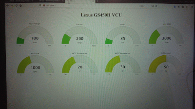

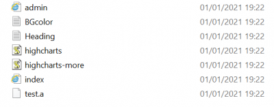

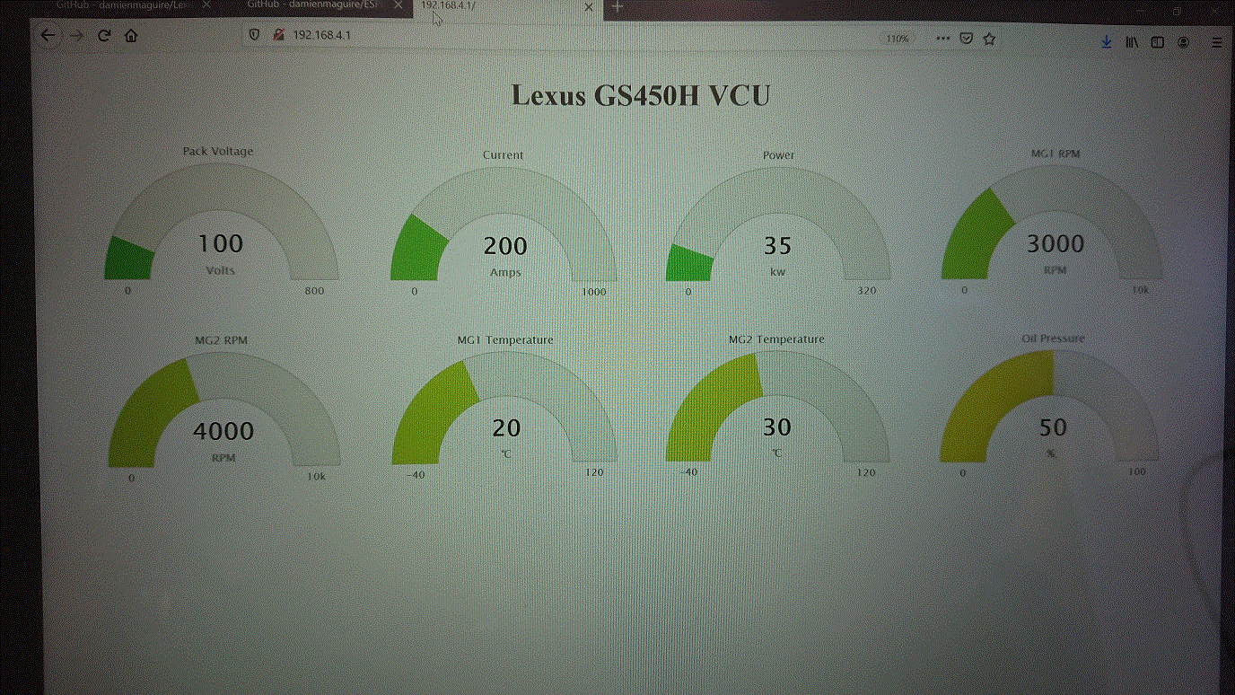

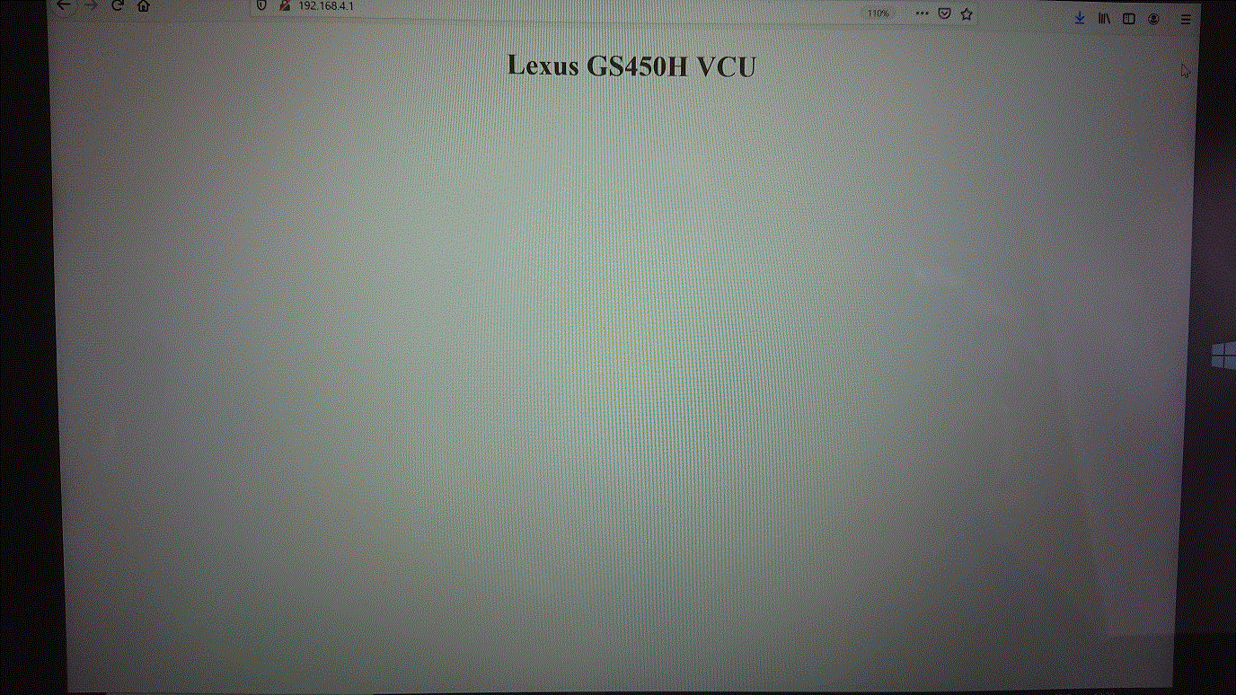

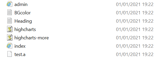

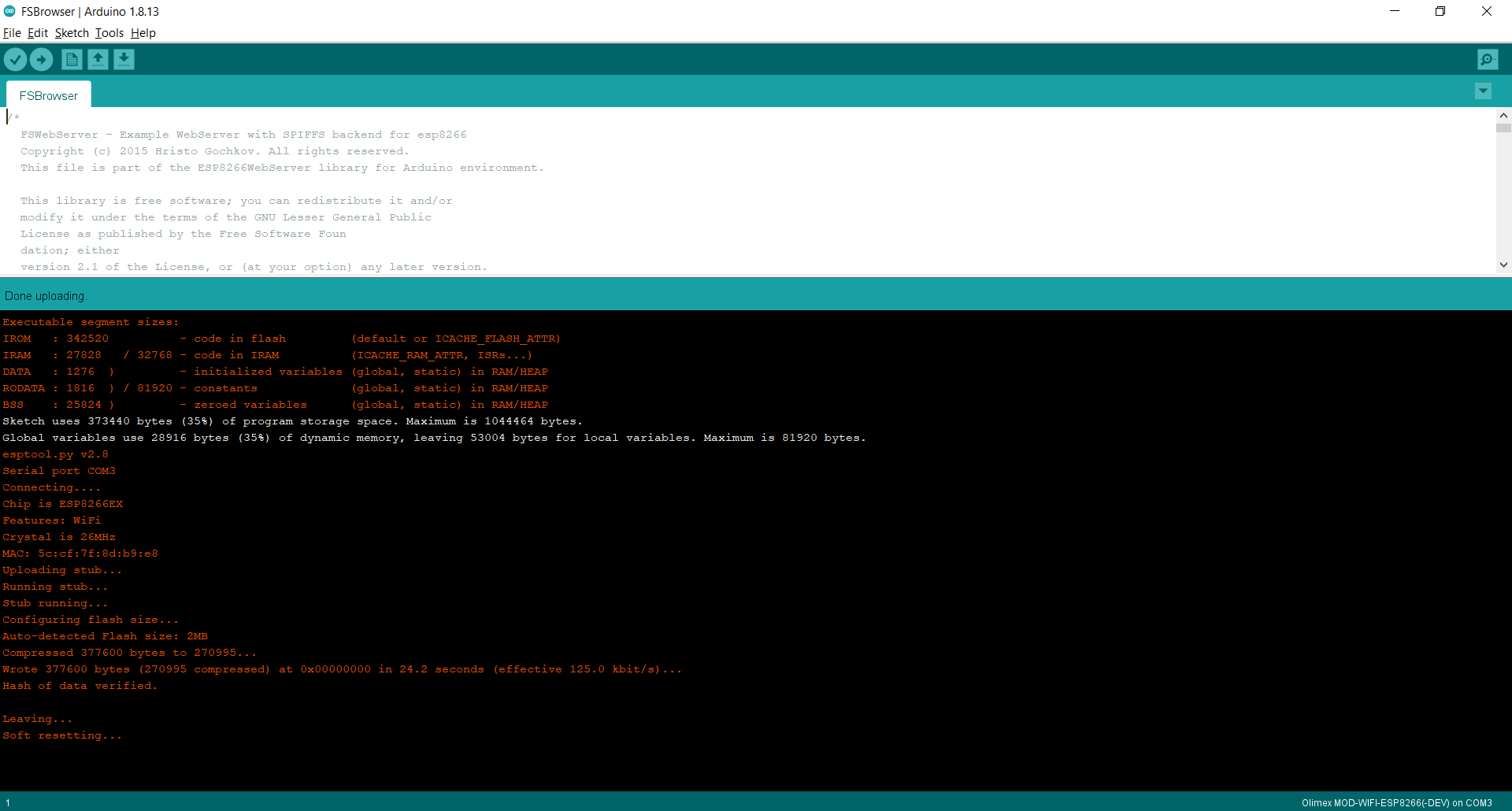

Need a little help/guidance on SPIFF's for the GS450H VCU and the Olimex Mod-Wifi-ESP8266. When set up once I received the kit, all worked over the wifi with correct data being displayed on the webpage, except for MG2 rpm which was stuck at the default 9000rpm.
Thinking this could be an issue with the esp8266 flash version, I set about updating the esp with the latest ino and SPIFFS from Damian's github:
https://github.com/damienmaguire/Lexus- ... aster/WiFi
After some troubleshooting, finally got the ino and SPIFFS updated without any errors. Soldered the esp bridges back to normal and connected up to the VCU. Connected the laptop to the esp wifi and got the screen below, no errors but no gauges, and the header is reading correctly which suggests the SPIFFs are working
Image below shows that data folder should be in correct location:
data folder1.PNG (4.61 KiB) Viewed 31947 times
And image below shows the contents of the data folder:
I'm not that familiar with SPIFF's, so wondering if the contents of the folder are complete? Looking at https://github.com/jamiejones85/ESP8266 ... er/V2/data I notice that there are extra gauges java script files in the data folder, and in the GS450H ino file, there is a call for 'solid-gauge.js' but no matching file in the data folder.
I'm wondering if I'm on the right track, although the GS450H has been working for Damian and others so I would expect that data file on Damian's github to be ok? I have to keep soldering and resoldering the bridge pads on the esp to test each iteration, so hoping someone might spot something to save me some time?

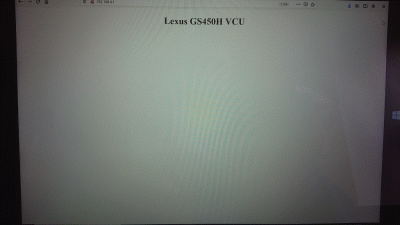

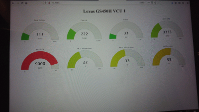

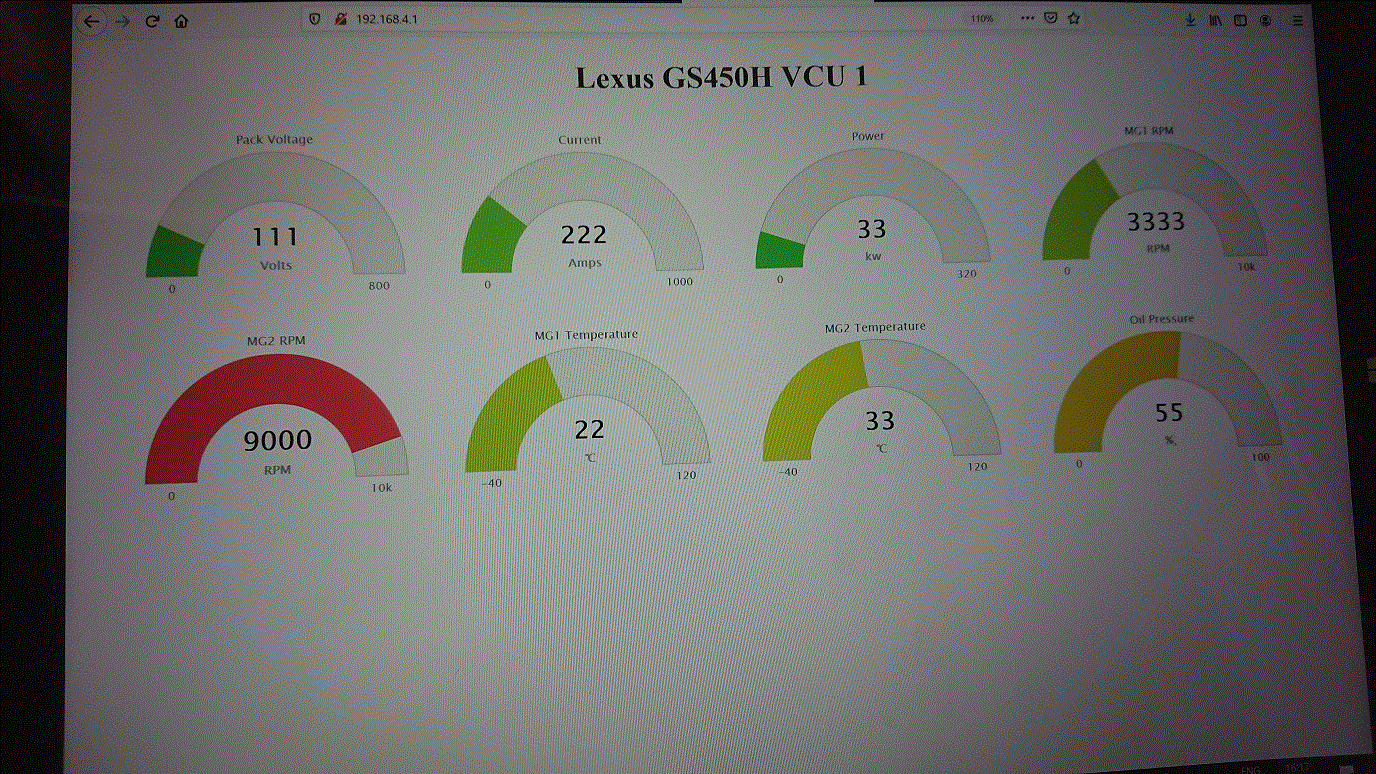

An update on flashing the ESP for the GS450H VCU following yesterdays post.
With some help and testing by the group, we've got the result we were after. The original issue was that MG2 rpm was fixed at 9000rpm and was not updating.
Decision was made to re-flash the ESP as it was suspected if could be flashed for one of the other VCU's. Using the instructions from this forum channel, I finally got the ESP flashed using Damian's github repo for the GS450H wifi (https://github.com/damienmaguire/Lexus- ... aster/WiFi). The ESP updated without errors, but when I fit it back onto the VCU board and connected via wifi, there were no gauges or values even though these had previously been there.
Looking through the GS450H_WiFi_V1 arduino file for the ESP wifi upload, there was a call for "/solid-gauge.js", but these were not included in the Data file for the SPIFF's. Thanks to some testing by the group, this was corrected by copying the 'solid-gauges.js' file from Damian's ESP8266 repo (https://github.com/damienmaguire/ESP826 ... er/V2/data) into the data folder for GS450H_WiFi_V1.
The updated ino and data folder were then flashed onto the ESP and it was tested on the VCU board once again, and this time the gauges and values appeared as normal and the MG2 rpm was now registering as expected, so the ESP appears to be working correctly now. I have not tested with the running gearbox but it is reading the correct values being sent from the GS450H VCU code, so all looks good.

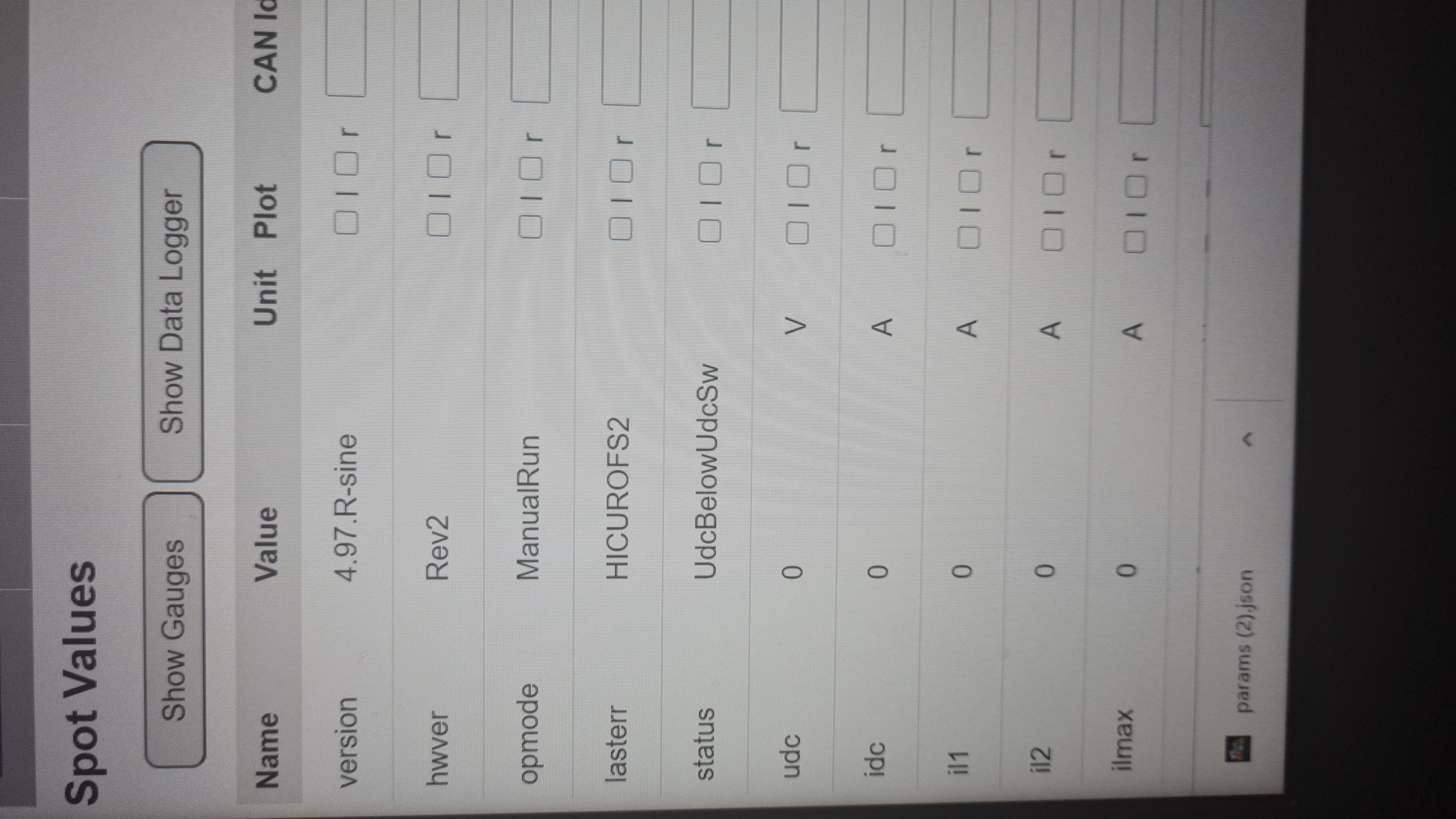

can anyone shed any light on these errors?
Isaac96
Posts: 656
Post by Isaac96 »
Hmm... Are you using Gen3 Prius hardware?
HICUROFS is not really an error; it's more of a guide saying 'check your current sensors, there *might* be an issue'
UdcBelowUdcSw means the measured voltage (udc) is less than the switch voltage (udcsw). Make sure your voltage sensors are calibrated. Usually, for initial testing, you can set udcsw to 0 and do a manual precharge -- this should only be needed if you're using a voltage which is far below your final pack voltage.
nuffz
Posts: 21
Joined: Sat Dec 12, 2020 6:22 pm
Post by nuffz »
yea im using a gen3 duel motor board. i had it running 3 leds in delta on mg1 last week, i try again this weekend and i get this
Isaac96
Posts: 656
Post by Isaac96 »
What is your udc at? (both actual and measured)
And udcsw?
It looks like it is still in run mode (manual) so should be fine. Try the LEDs again?

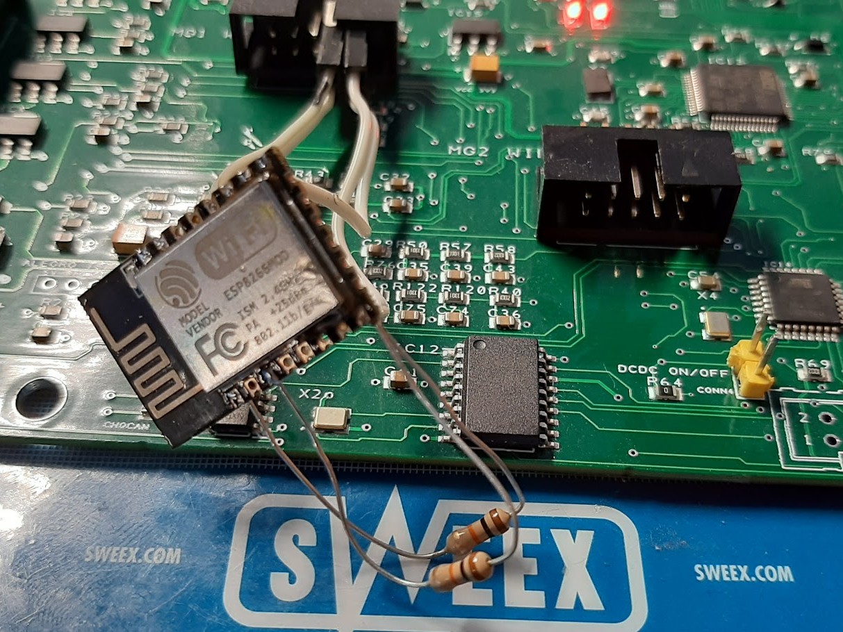

Long time no see :)

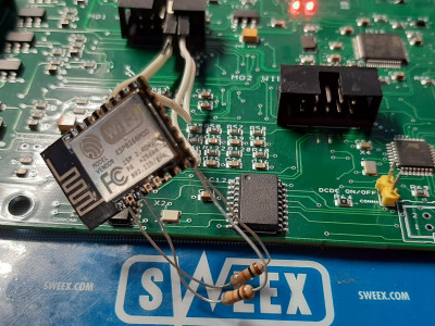

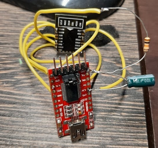

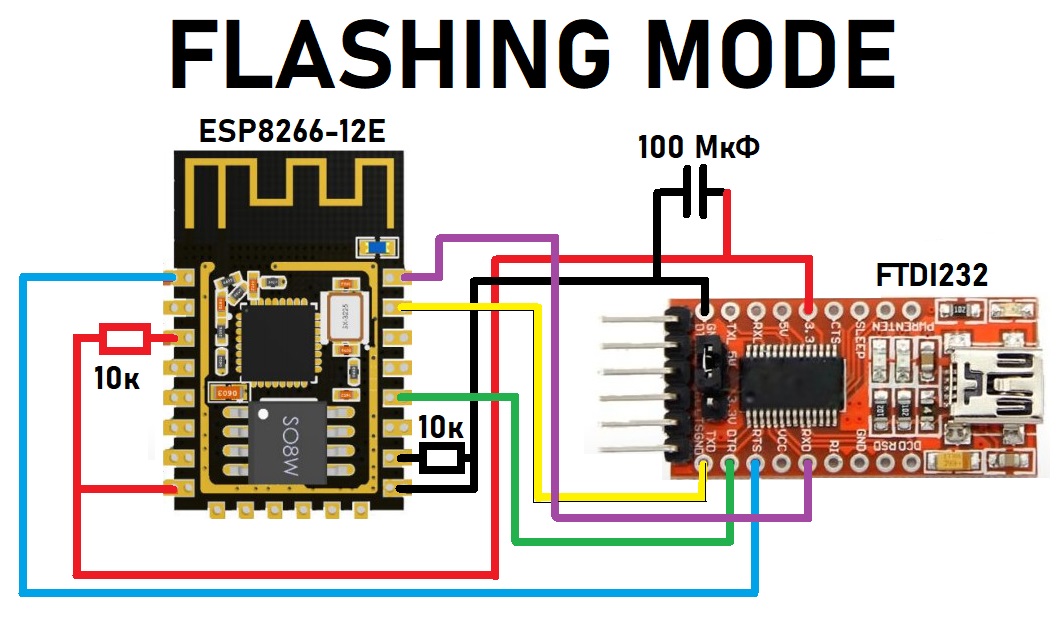

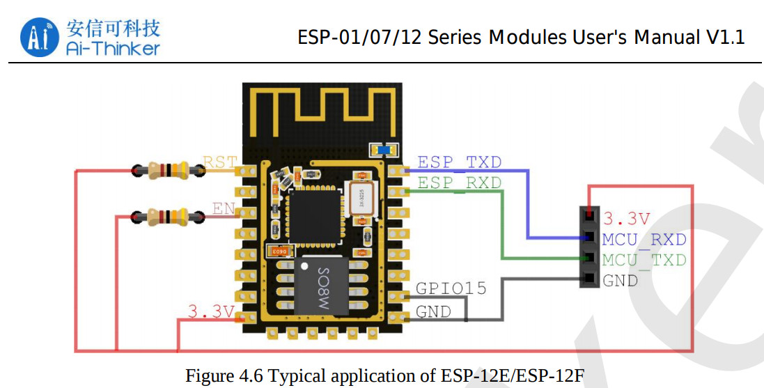

Yesterday I've flashed ESP8266-12E using nothing more than FTDI232(cheap USB-TTL, yet has got everything needed onboard), two 10k resistors and one 100MkF capacitor. No additional power supplies. I don't know why people say it need strong power supply. There are a lot of manuals on the internet, but for some reason almost none of them worked.
I created this sheme and it worked:
Then, after successful flashing and setting up module's name and password, connected it to v1d board like this(temporary) and it connected, LED is not flashing, but it is not a problem for me :)
Maybe it will be useful for someone who struggling with flashing ESP-12E or ESP-12F.
