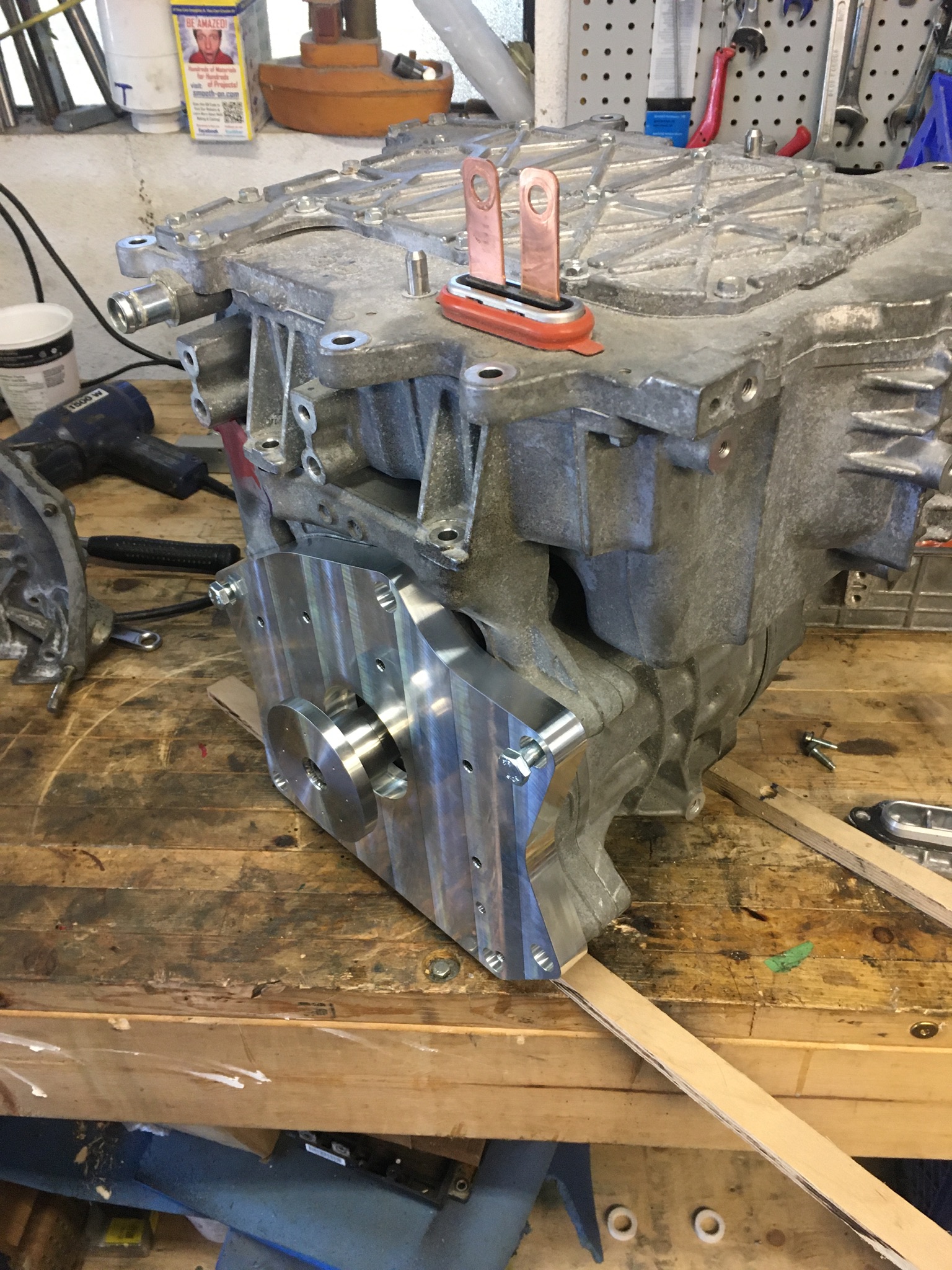

So, i've received a version of a 7/8" 20t spline friction disc meant for a Geo Tracker, same specs as the blue print 2879670, and it fits horribly.
videos of other discs meant for Fiats fit MUCH better, but i can't figure out how to source them from the US.

Have you tried Amazon? The Blueprint ADC43101 is available in the US for $55 and fits my Gen1 Motor better than that one

I just found this one which I think is for a Honda Civic 1.4 circa 2005 to 2019 so should be available everywhere
Blue Print ADH23154
Better again it has a 20mm centre which should be a tighter fit than the previous one I mentioned at 22.3mm.
Lots of interesting clutch disc related content here including a video of a guy saying the Honda Civic disc sloppy when I thought it looked pretty good.

Alibro wrote: Thu Sep 24, 2020 9:28 am Have you tried Amazon? The Blueprint ADC43101 is available in the US for $55 and fits my Gen1 Motor better than that one
great compilation of videos, that will be helpful for many. I'm liking the fit of the Honda 1.4l
I ordered a Suzuki Samurai disc a little while ago, which is reported to fit well, but also noted at 7/8" OD. We'll see!

Can anyone in europe help me source a Honda 1.4l disc??
I tried the Samurai and it's just as bad as the Geo Tracker.

I've located a 1.5l clutch disc for a NA "EF" early 90s Honda Civic. (sachs 1878654584 or M-PACT 99698D) It has the following dimensions: 27/32" X 20T (21.43mm)
I think this is likely the same spline as the 1.4l already tested by Philip. It's twice as expensive as the previous discs i've tried but we'll see how it fits.

I think you have a typo as 27/32 is 21.431mm. It sounds like it might be too tight as the shaft is 21.6mm ish. Would it be possible to go around each valley with a hack saw to try and widen it out? Not sure how hard it would be to cut with a saw.
I have ordered a friction disc 20 tooth x 22mm and will report back.

turns out it's still too big!

Alibro wrote: Wed Oct 07, 2020 8:56 pm
you're absolutely right. :|
So, I think im now going to go with a custom spline adapter.

bexander wrote: Fri Jul 09, 2021 10:35 am Anyone tested with a Daihatsu Hijet clutch plate?
Sachs specs 19,4x22-20N for 1878 991 701.
This clutch plate has the wrong profile on the splines and does not fit the leaf motor shaft.

bexander wrote: Tue Jul 20, 2021 8:27 pm
At one point I tried to find the Honda clutch plate mentioned in one of the videos in this thread, as it seemed like a nice fit but I already had the two I'm using so I didn't spend much time on it.
It might be worth a look.

I can't see anyone mention that when adapting ICE gearboxes to Electric motors they incorporate a pilot/spigot bearing to support the gearbox input shaft?
ICE gearboxes have a much longer (unsupported) input shaft than electric motor transmissions.
I would suggest this pilot bearing (usually in the centre of the flywheel) is important - especially when using motors with greatly increased torque over the original designed ICE.
These splined couplers should really only be used to transfer torque between two concentric shafts.
