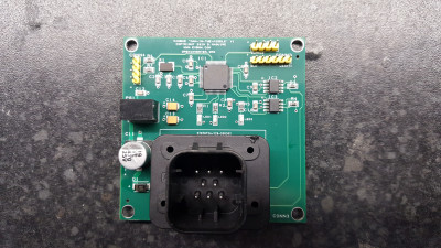

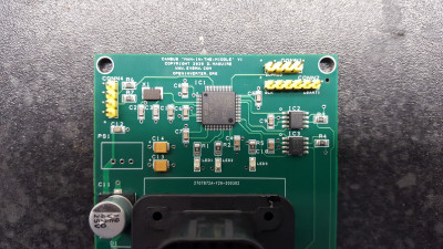

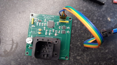

Got the boards from JLC. Communicating fine with stlink so just waiting on firmware which should be available next week.

Software now available and in beta stage for the man in the middle. I have updated the webshop and github.
https://www.evbmw.com/index.php/evbmw-w ... the-middle
https://github.com/damienmaguire/CAN-BU ... The-Middle
Basic user manual :
https://github.com/damienmaguire/CAN-BU ... manual.pdf
Basic user manual :
