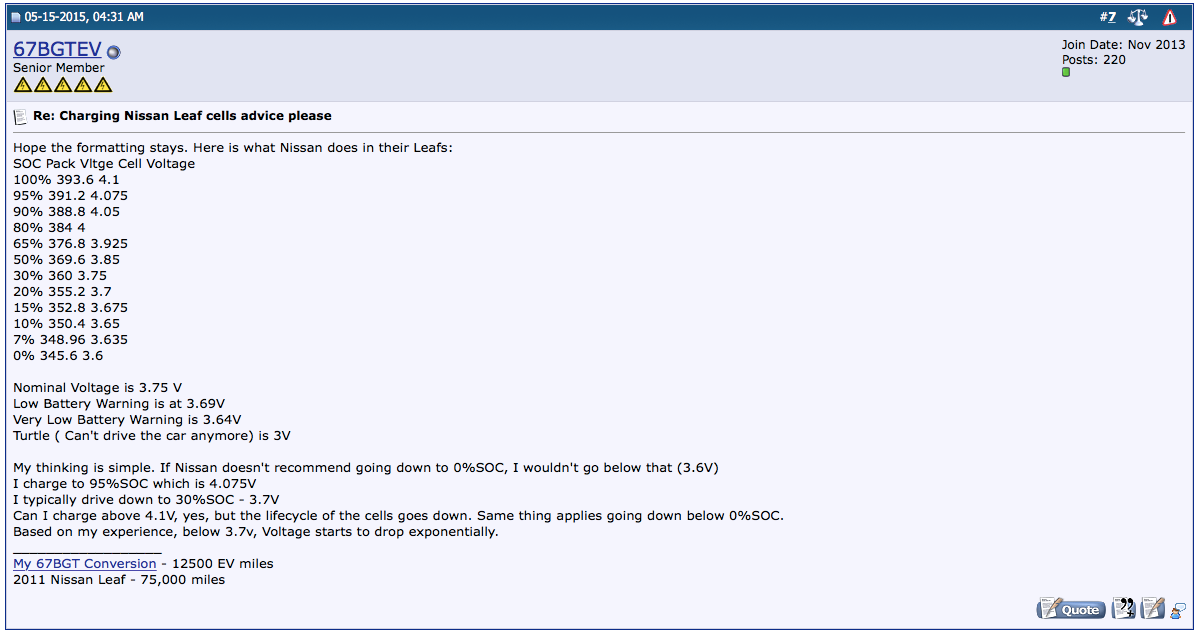

i would like to have your opinion on the state of health of my battery cells:
I hava a Gen 1 Pack that has 24Kw/h of Energy. Today i drove it down 3.2 Volts on the lowest cell and 3.4 Volts on the highest cell.
When i have less volts in my pack i can see significant differences in the cell voltage. I think i should exchange the lowest cells!
Then i fully charged it on a public charging station to see how much kw fit into the car:
This is the result, the car was 100% charged when i unplugged it: 19,08 Kw/h
What do you think? Is this the capacity to expect from the Leaf cells or should it be better?
Cheers, Philip

Zapatero wrote: Wed Sep 09, 2020 8:44 pm What do you think? Is this the capacity to expect from the Leaf cells or should it be better?
What's the history of the battery? Has it been bottom balanced? Are you using the Nissan BMS or a third party system?
3.2V is very low and a 200mV difference between cells is huge. This is a useful guide;

Johannes told me that the information above is not quite correct. He uses the leaf BMS and told me that 3.5 Volts is 15% of charge.

Zapatero wrote: Wed Sep 09, 2020 9:31 pm Johannes told me that the information above is not quite correct. He uses the leaf BMS and told me that 3.5 Volts is 15% of charge.
Hopefully he will chime in on this!
Each generation of Leaf module uses different chemistry and that might explain some differences. That said, it's critical you understand the battery limits if you are discharging down to 'zero' or below :shock:

Kevin Sharpe wrote: Wed Sep 09, 2020 9:54 pm Each generation of Leaf module uses different chemistry and that might explain some differences. That said, it's critical you understand the battery limits if you are discharging down to 'zero' or below :shock:
3.5 Volt is where the discharge rapidly increases. But still doesn't mean that the cells cant be discharged a bit more? Of course this will not have a positive effect on the lifespan!
Johannes told me that 3.5 Volt on his BMS on the same Leaf cells like i have are still 15% of charge!

Re: Leaf Gen1 Cells state of health- your opinion?
Yes, I had setup my inverter like in the DIY post cited above (low voltage limit 340V). That resulted in me getting stuck on the Autobahn while the BMS still reported 15% SoC. With the voltage limit disabled I could drive to the next charger just fine, the cell voltage was then 2.9V and the BMS still didn't report 0% but 8% or something.
Right now my car is sitting at 20,6% at an average cell voltage of 3754mV, min 3731mV, max 3773mV. This complies with the DIY post, so I assume the problem back then was that I had set up the inverter to IDLE voltage not loaded voltage. I will try to empty the battery today and report back.
