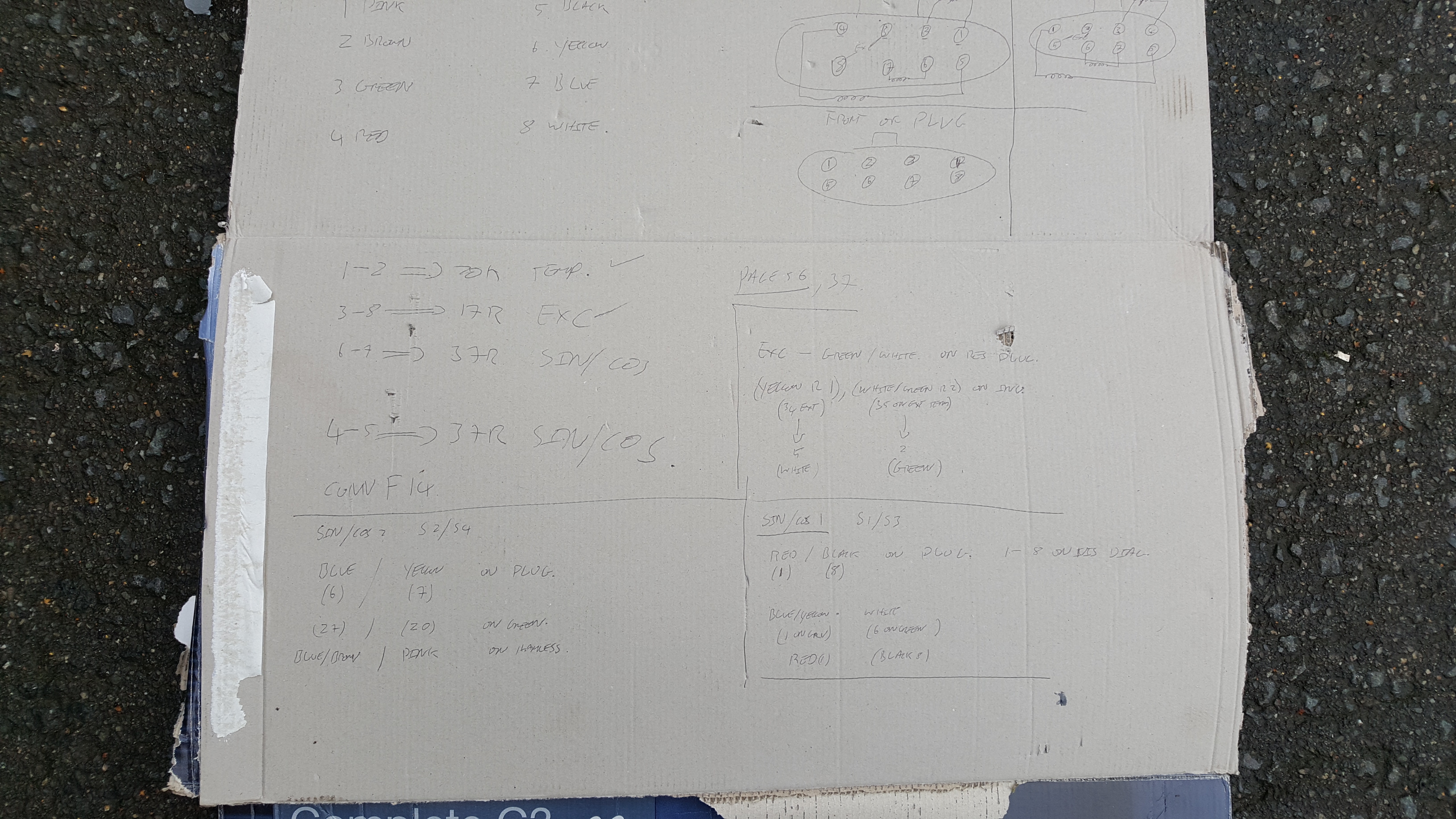

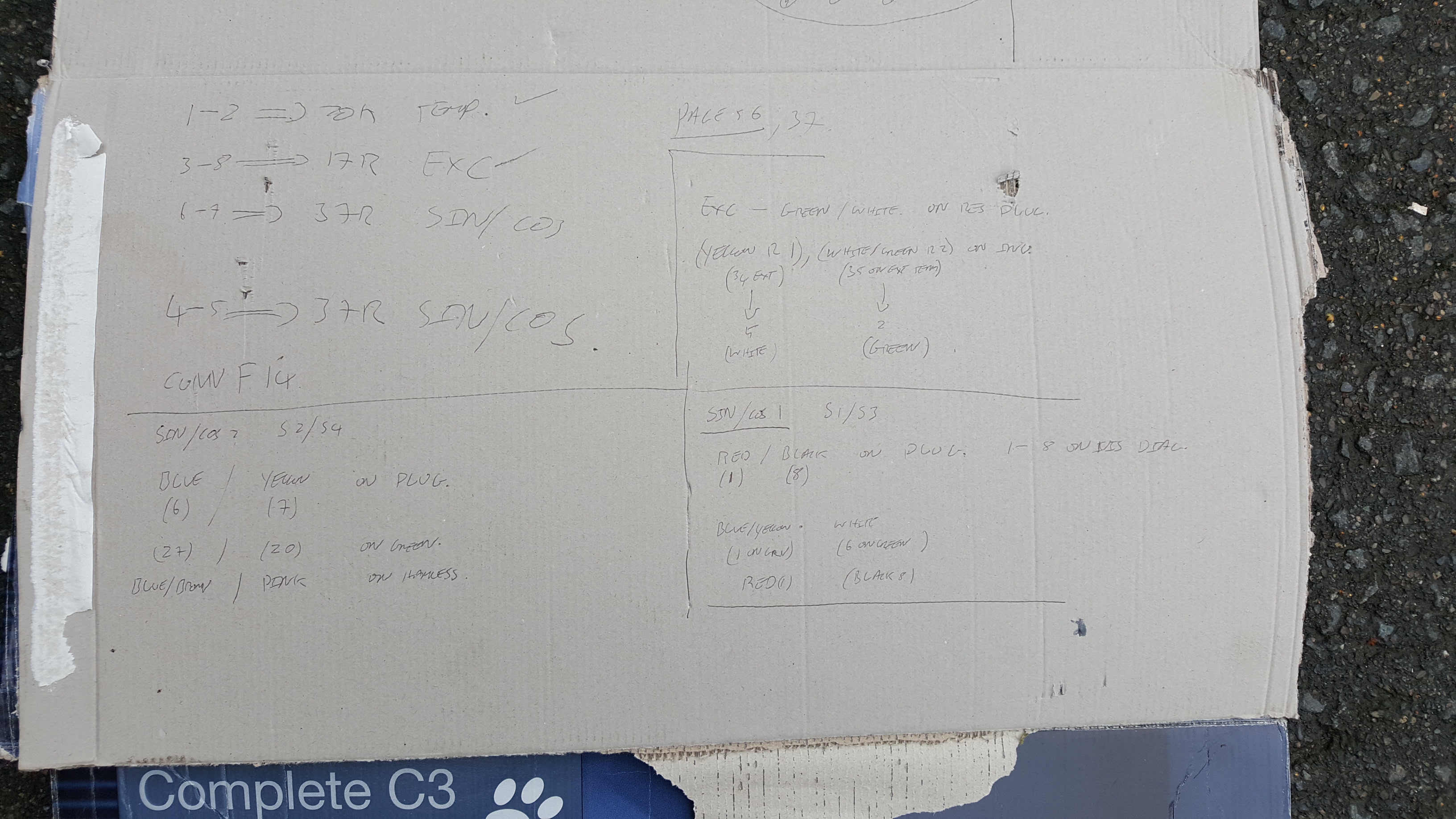

Jack Bauer wrote: Thu Aug 01, 2019 1:57 pm In other news all the wiring diagrams for the gen 1 resolver connector on the motor that I have are wrong. Correct pinout :
1-2: Temp sensor. 20k at approx 20c ambient
3-8: 17R. Exciter
6-7: 37R. Sin/Cos
4-5 : 37R. Sin/Cos
Would you mind sharing the final connection between the resolver cable and white connector on the logic board? If you remember the colours please write them too.
Did you figure out the Sin+/Sin- and Cos+/Cos-, which of 4-5 and 6-7 is what?

Here are a few pictures of my "blackboard" where I worked out the resolver connections. Will put it into something more readable.
Drove the car for the first time today:)

Wow that looks great:) its a gen 1?
