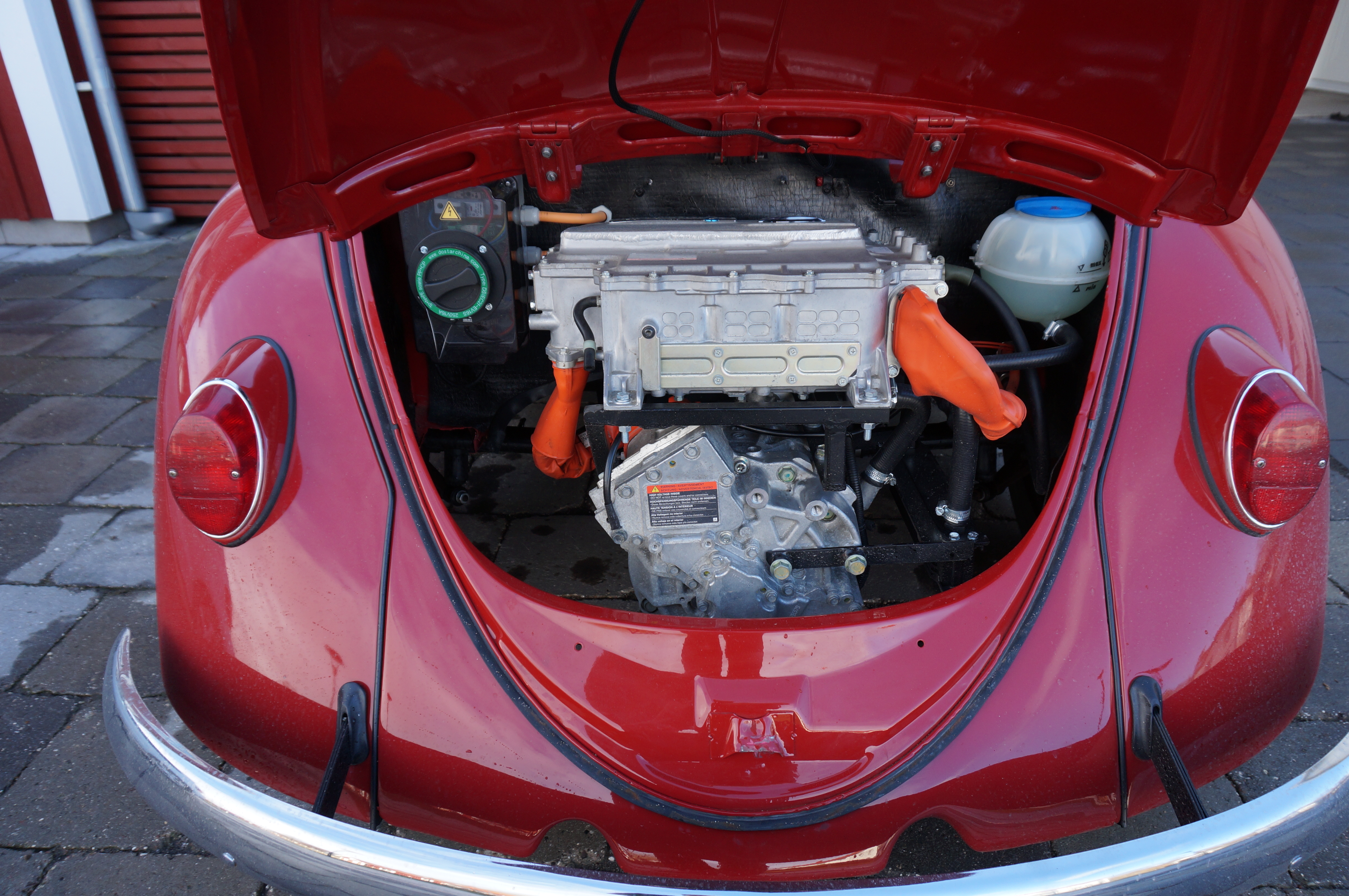

langoo
Posts: 68
Joined: Thu May 09, 2019 6:27 pm
Location: Varberg, Sweden
Re: Leaf Gen 1 Inverter Board
Post by langoo »
Robin Guldmyr
MR Electronics AB
Posts: 4000
Been thanked: 1115 times
Wow that looks great:) its a gen 1?
langoo
Posts: 68
Post by langoo »
Jack Bauer wrote: Sun Aug 18, 2019 7:56 pm Wow that looks great:) its a gen 1?
Yes it is ;)
