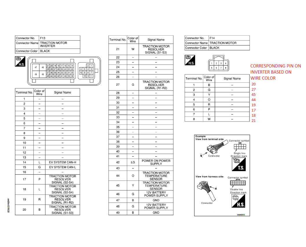

-Checked my resolver wiring and realized I might have had 2 wires backwards (pins 17/18 swapped at the connector). Swapped those physical pins and now it is juddering instead of singing. Turning the output shafts by hand, I do see the angle going up. LORESAMP comes up after pressing the accelerator.
Here's the resolver wiring I'm using (My motor didn't come with a harness so I had to buy the plug and wire it myself).

Well the harness should he the same as the OEM pinout, if the diagram I posted is correct.

I'm surprised it only shows up when pressing the accelerator, should appear right at the start. LOREAMP means the feedback voltage from the resolver is too low. May be time to do some scoping. You can also measure the exciter voltage with the AC mode of a multimeter. It should be about 3V rms. The return signal has varying amplitude but at least one of them should be around 1V rms.
