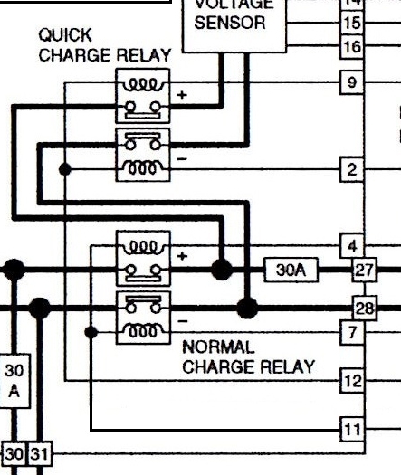

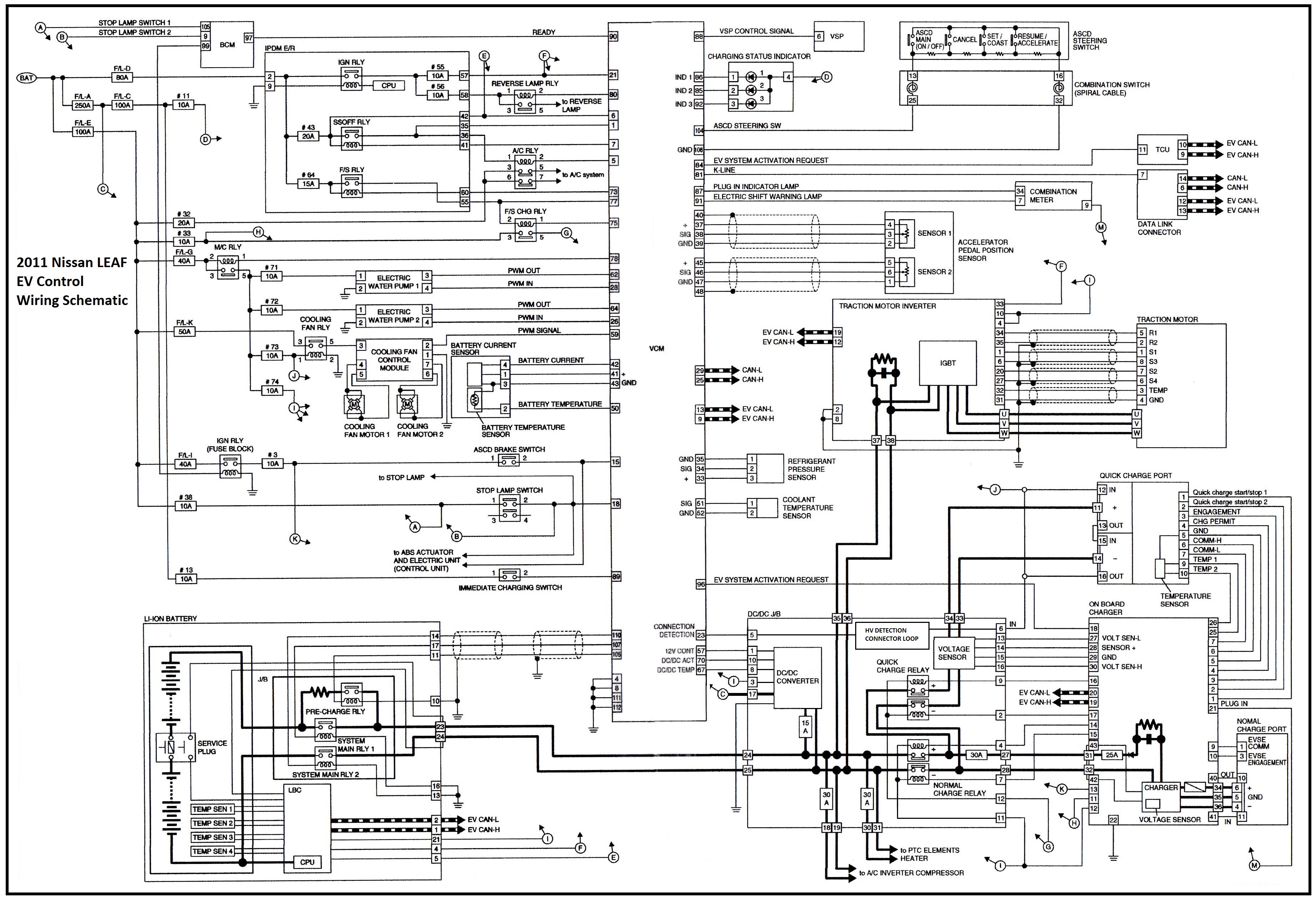

Hi EvSteeve,
From the Leaf schematics I can see that the Chademo is fully connected to the PDM,
Please see attached print-out of that page.
The PDM is connected to the CAN bus (and other components)
If you have any questions, please let me know.

Re: Chademo Leaf PDM & Zombieverter!
Thanks for your replies,
Paulheystee, that schematic, is it for a gen1 leaf? It doesn't seem to match up with the pdm wiring I Have for my gen 2.

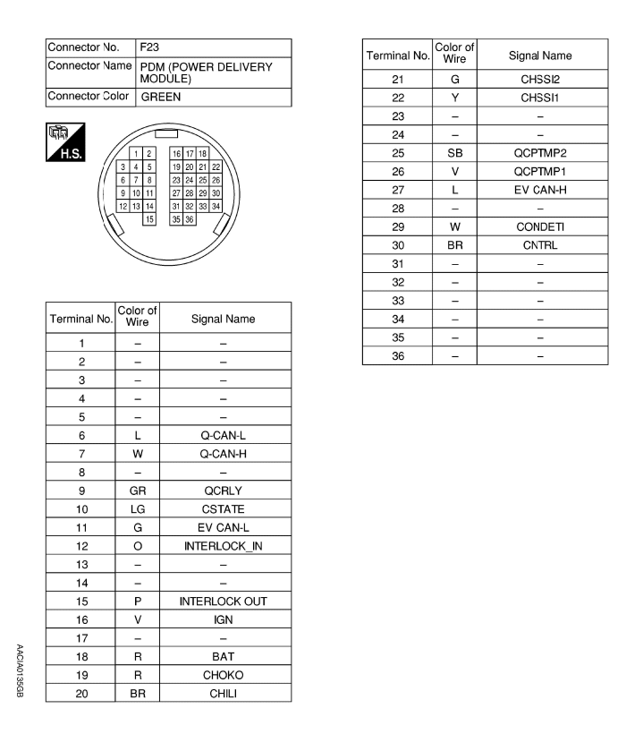

Following my previous reply here is some supporting info..
attached are my pinouts for the pdm (Gen2) and also the pinout i'm using for my fast charge plug.
As you can see my pdm plug is missing pins which are in the schematics posted. but does have fast charge related pins.
Do you have the description of the pins on the schematics to help me try identify where they need to go on my system ? Regards!
Hi EvSteeve,EvSteeve wrote: ↑Wed Feb 08, 2023 6:01 pm Following my previous reply here is some supporting info..

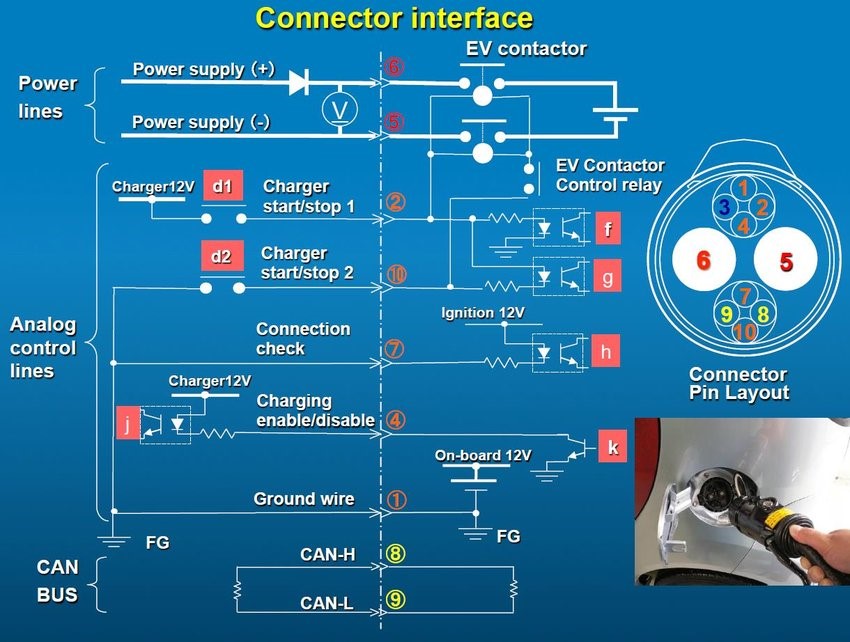

I've attached a 2018 diagram of the relationship between the Chademo connector, the PDM and the VCM. You will see in the later models the VCM controls the start/stop lines. these are 12v off/on with some resistors. I'm sure someone will know the values.
vehicle charging system.pdf- (178.39 KiB) Downloaded 390 times
Brilliant, Thankyou so much for these, extremely helpful!

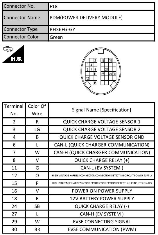

Does the PDM have a relay controlling the Chademo contactors? Assuming is does, then it would need to be enabled so that control is just from pin 2 and 10 of the Chademo connector.
Yes, so on the pdm p8 is fast charge relay (+) and p24 is fast charge relay (-) We have connected p2 and p10 from the fast charge port, but as stated the contactor does not seem to be shutting. During the test we conducted no voltage was present at P5&6.

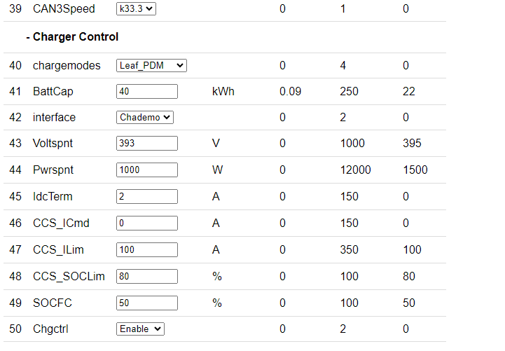

As for AC charging we have our system working fine, What issues are you experiencing? Is your zombie recognising the plug is being inserted? Damien has a very good guide on the wiki about ac charging using the leaf pdm & Zombie, perhaps worth checking out if you haven't already.
[/quote]
On version 1.08A all is working fine, Using Ext_Digi to start the charging. Main contactors shut and relay in the PDM makes and AC charging commences. (I'm using Ext_Digi to start charging as I have found the auto method upset the next T15/ Starter starting process).
Uploaded 1.11A and without changing any settings and running the same process, the main contactors shut, but the PDM relay does not make, so charing does not start. Opmode reads Charging and Chgtyp reads AC.
[/quote]

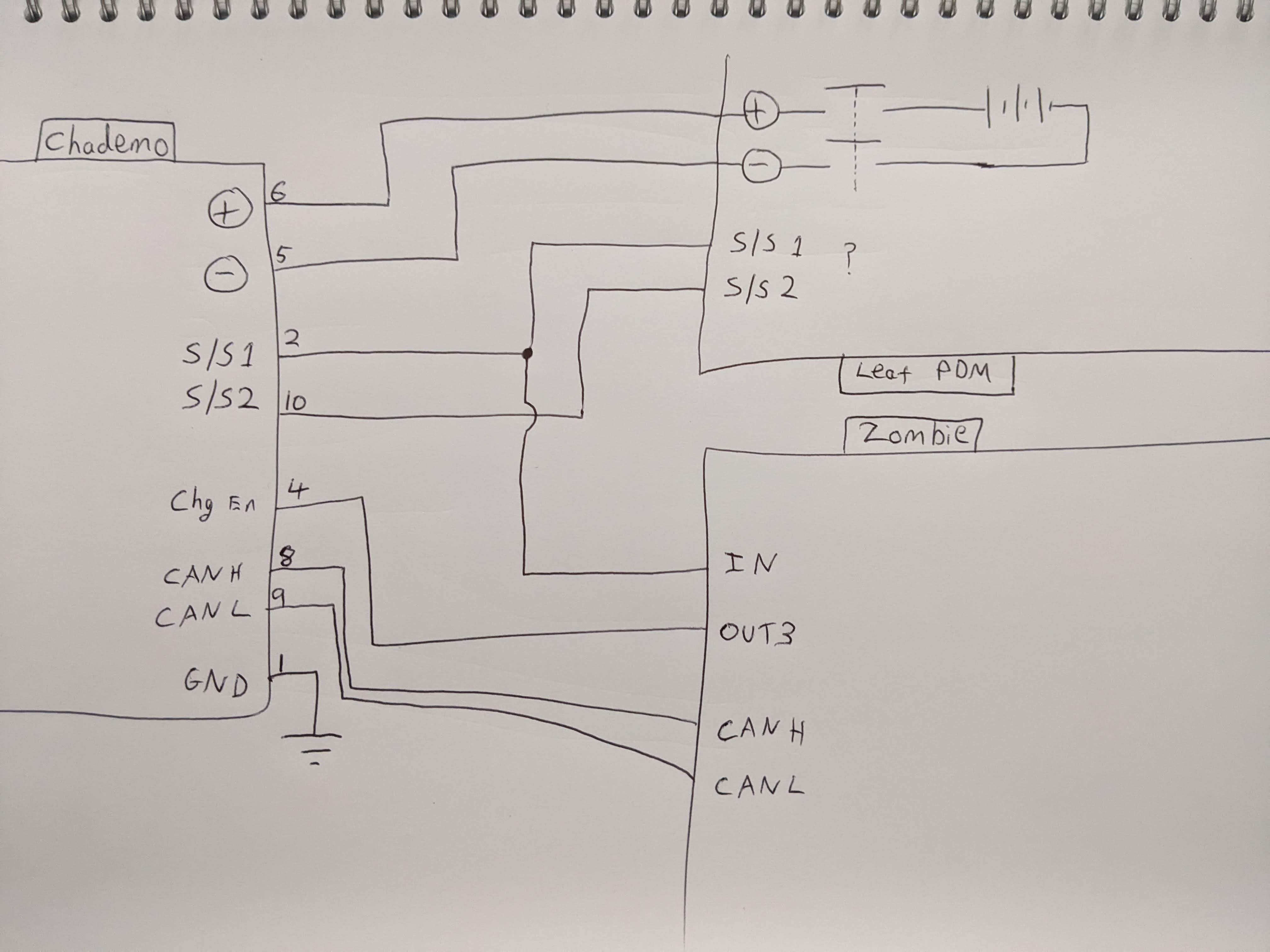

The Chademo contactors are inside the PDM. I'm not yet sure whether charge sequence signal 1 + 2 will be enough to close them, or whether we need to send the PDM anything else to enable it.

The Zombie Chademo is designed completely separate from the PDM or other Leaf stuff, right? You will have to rewire the Chademo contactors directly to Zombie as well as rewiring any other Chademo signals going into the PDM, if you're using the Leaf harness.
I might not be up to date on this but I haven't heard about any PDM Chademo reverse engineering having gotten to a completed state.

You're correct. Zombie controls Chademo on its own. This is roughly how EvSteeve's Chademo is configured: The Zombie will take care of all the negotiation, but my suspicion is that more work will be needed to persuade the PDM to chose its Chademo contactors.celeron55 wrote: ↑Mon Mar 06, 2023 7:49 am The Zombie Chademo is designed completely separate from the PDM or other Leaf stuff, right? You will have to rewire the Chademo contactors directly to Zombie as well as rewiring any other Chademo signals going into the PDM, if you're using the Leaf harness.
Edit: I hadn't realised how simple the PDM is. The Chademo contactor coil pins are directly exposed, so just a matter of connecting them to SS1/SS2.

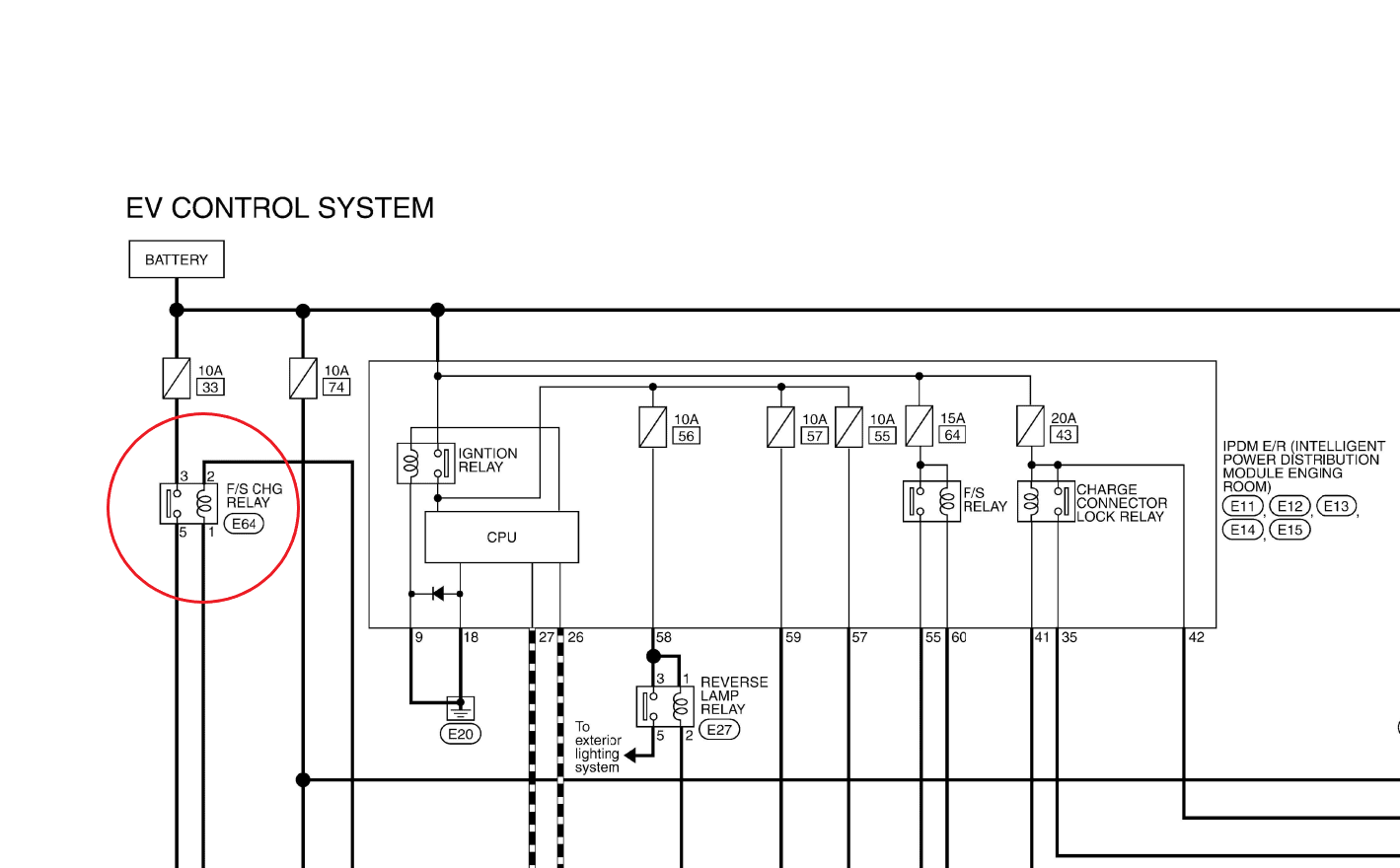

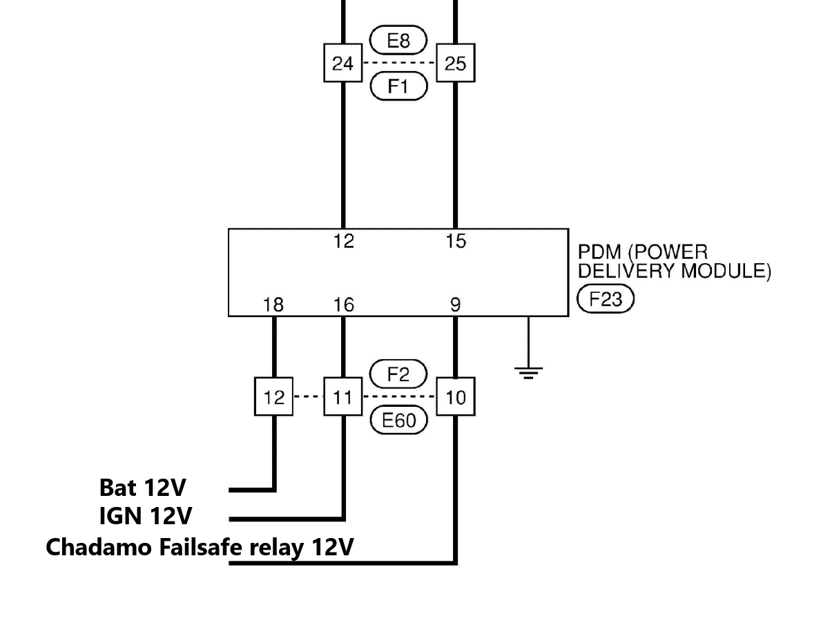

There is a relay ( F/S Chg Relay ) external to the PDM that provides 12V to the PDM during Chademo charging. I added the bold text to the 2nd digram to show the connections to the PDM. Looking at the pin out posted above ( post no. 5 ) this may be for a different version of the PDM, I think there was a change in about 2018.

No, I don't think the PDM is that simple.
I've opened it and checked this but don't remember anymore so I'm not stating this as a fact, but I do definitely expect the PDM to have a transistor or relay inside preventing the closing of the Chademo contactors with only d1/d2 power being provided but rather the MCU must want to close the contactors also. The Chademo standard expects you to have such a transistor or relay, even while in this community it's rarely added.
For the V1 PDM, the contactors are directly exposed on the low voltage port (full schematic also attached): I haven't confirmed that the V2 PDM is the same, but this document posted by EvSteeve implies that it is: He's connected C/C1 to pin 8 and C/C2 to pin 24. Will have to get CAN working and then see if this works.celeron55 wrote: ↑Mon Mar 06, 2023 4:06 pm No, I don't think the PDM is that simple.
