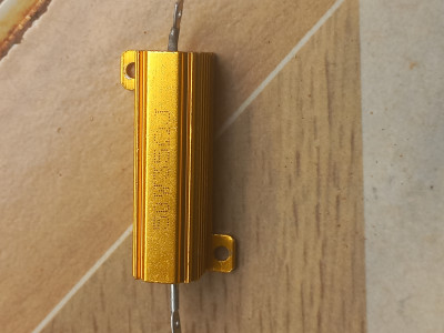

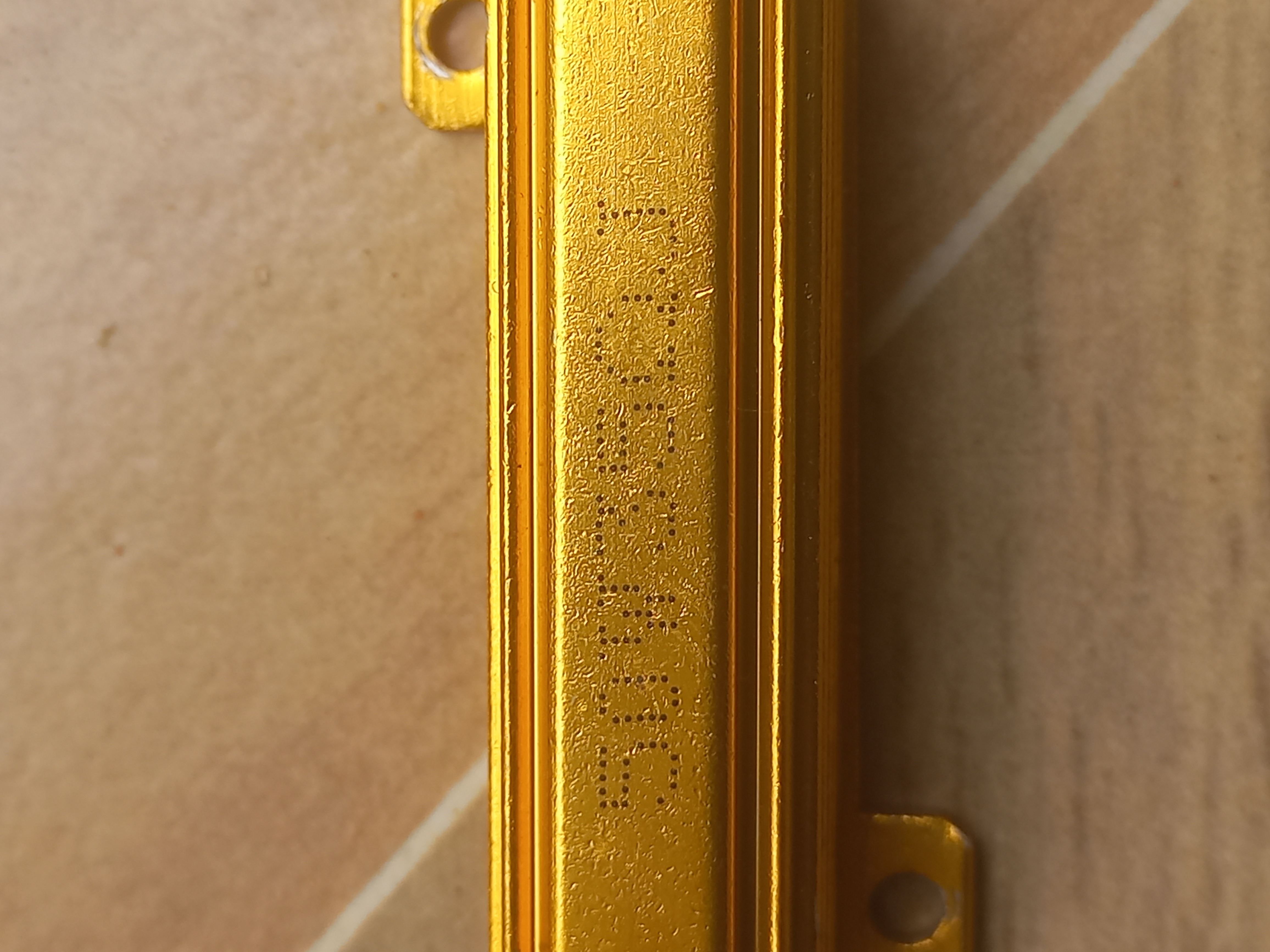

Hello,
In my EV conversion project using a Zombieverter, Nissan Leaf drivetrain, and a 400V battery pack, I’ve been using a 50W 35ΩJ resistor as part of the pre-charge circuit. However, the resistor works for a few days before failing—I’ve already replaced it three times.
I would appreciate your help in determining the correct type and rating of resistor to use for reliable and safe operation.
Thank you in advance!

The resistor in your image is 35 ohm, not 350 ohm. At 400v there is 4500 watts acting on it initially.
Tom's recommendation has 1600 watts as the initial hit.
These both sound huge but are short duration.

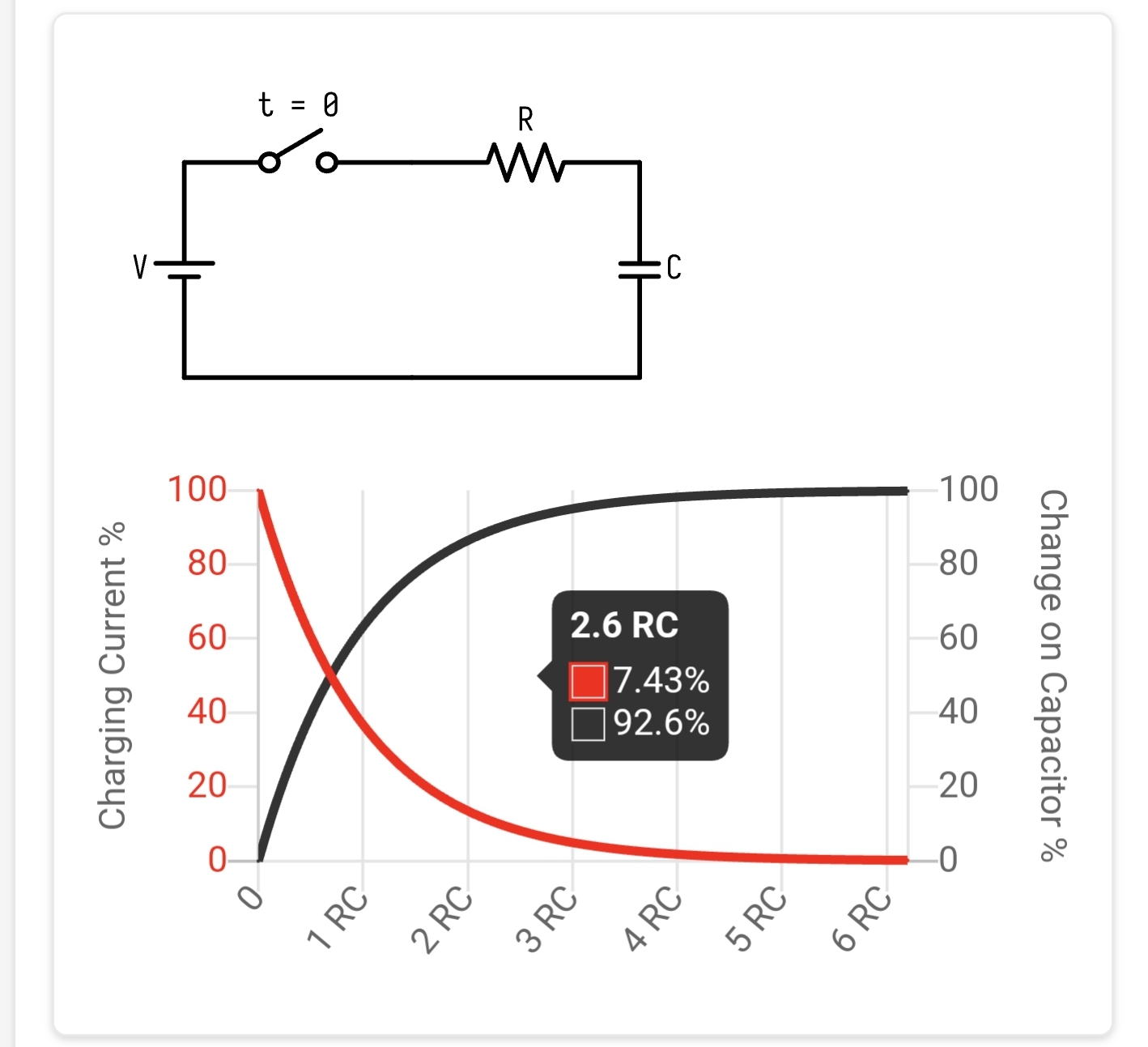

These both have wattage taper down as the voltage delta drops over time. You can use https://www.digikey.com/en/resources/co ... e-constant
To see the current and voltage over time if you know the voltage, resistance, and capacitor values of your build. This will show the time to charge as well. Something like this,
This gives you the charge time, take the joules divided by time to charge to give you the average resistor watts for this charge time.
