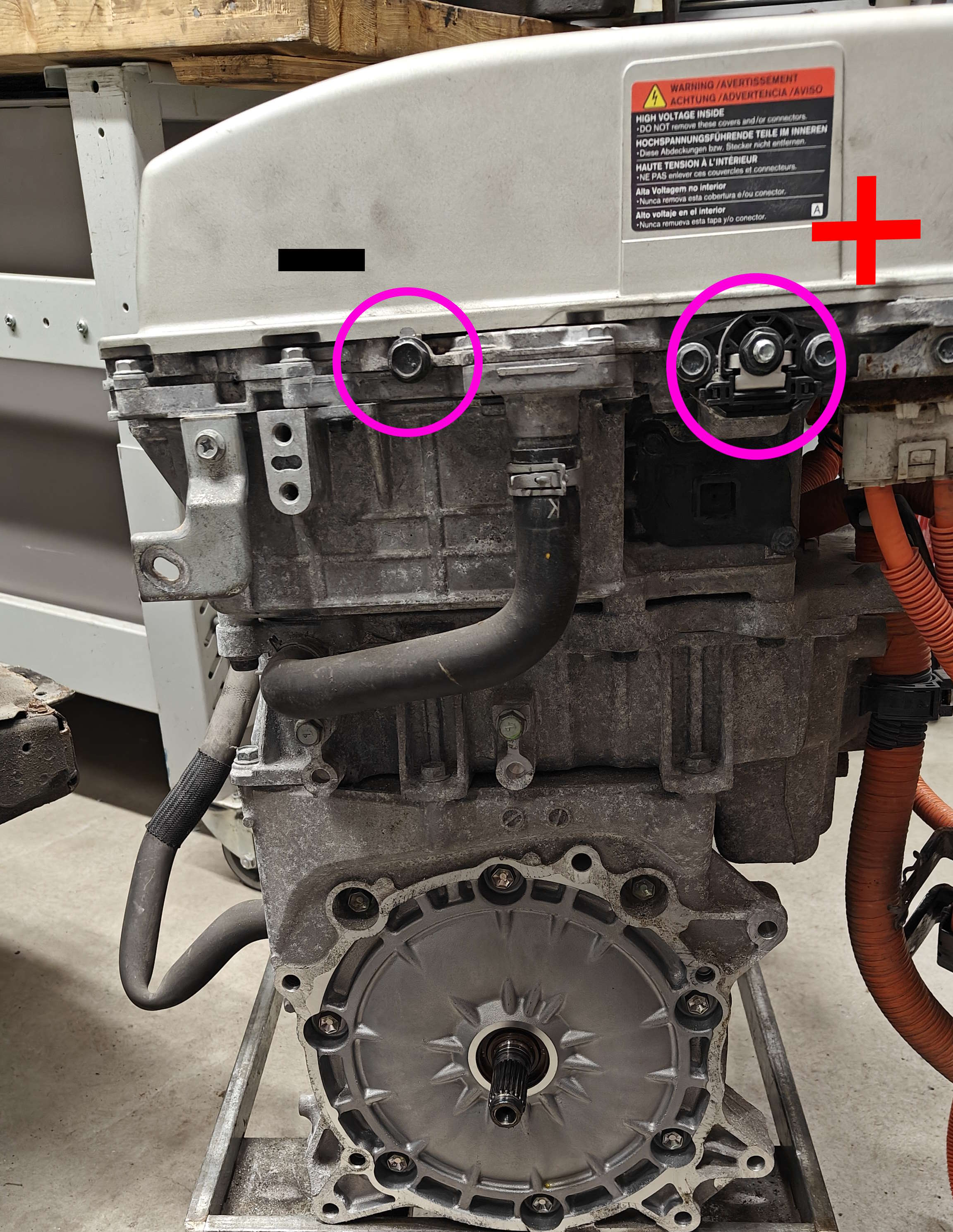

Bratitude wrote: Wed Dec 18, 2024 10:16 pm Is the pdm case grounded to the 12v battery?
This is key
These highlighted connect DIRECTLY to 12V battery

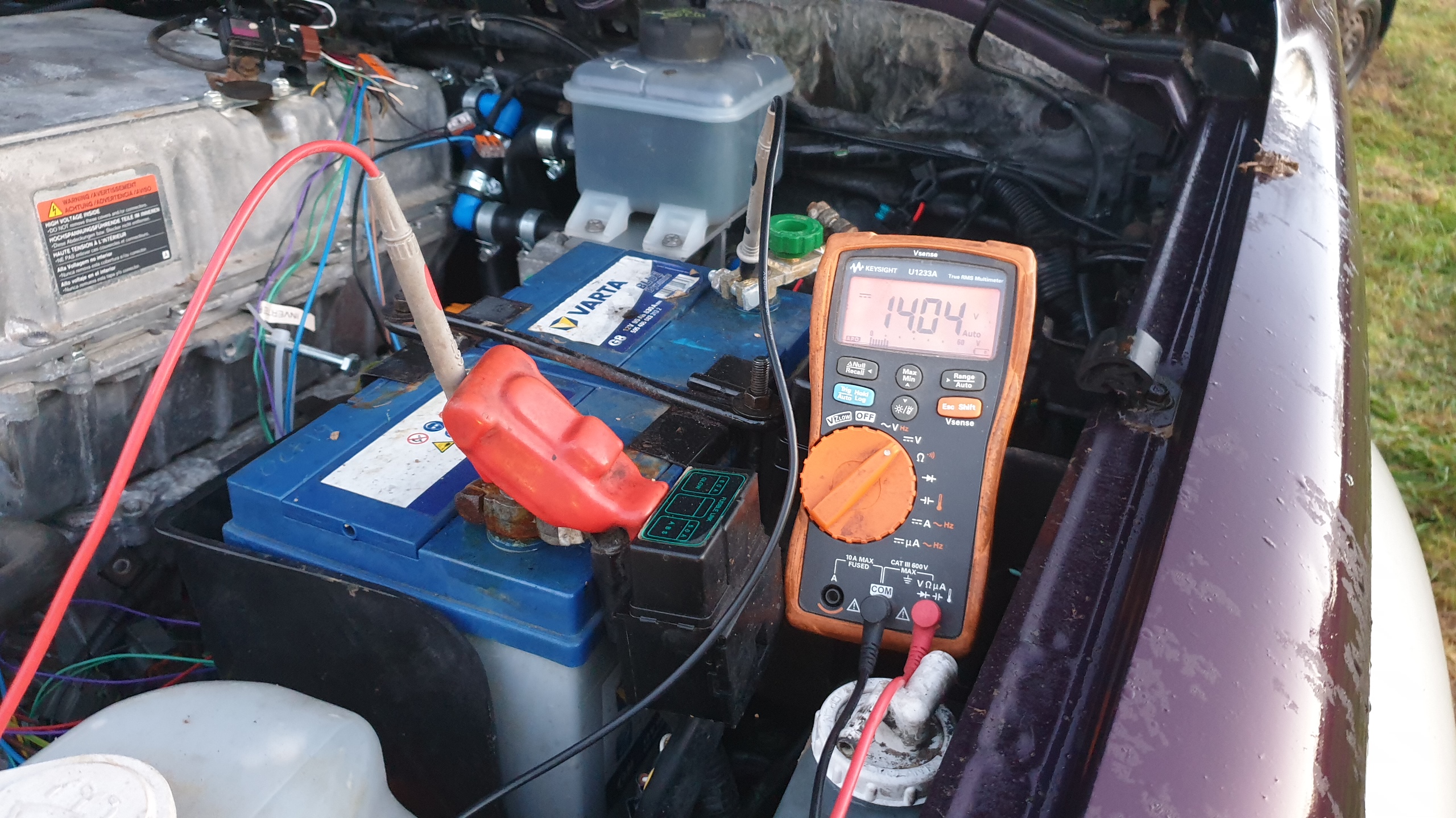

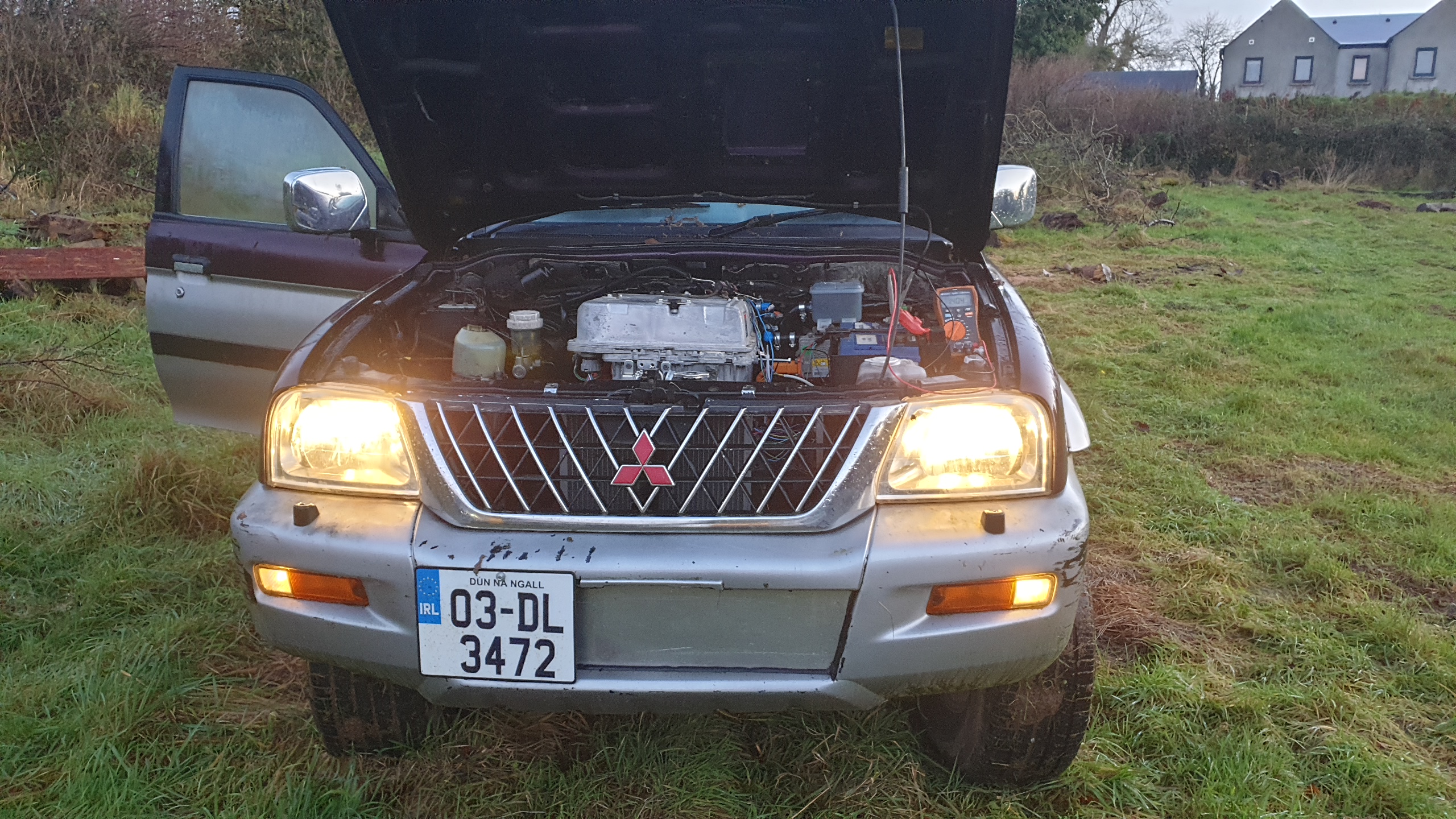

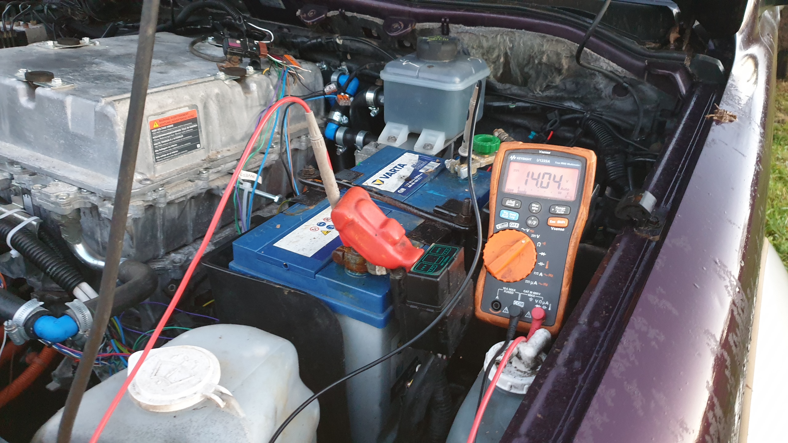

Posts: 4003
Been thanked: 1125 times
Re: Leaf DC-DC Not Working with Zombiverter
V2.20A
Headlights, heater blower and rear window heater on.

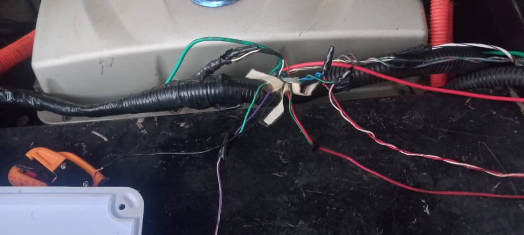

I have spent the entire day trying to fix it but still it has not worked, i opened the pdm top cover to confirm if 12v is reaching
Here are my connection details
Connection Details:
CAN Bus Connections:
PDM and Inverter VCU can connection:
Green wire (CAN H) → VCU CAN Ext 2 H
Blue wire (CAN L) → VCU CAN Ext 2 L
ISA Shunt CAN connection to VCU:
CAN H→VCU CAN Ext 2 H
CAN L→ VCU CAN Ext 2 L
ISA Shunt to VCU:
Power Supply Connections:
Permanent +12V:
Red wire from leaf harness → Connected to permanent +12V
Dark Green wire from leaf harness → Connected to permanent +12V
Switched +12V:
Purple wire from leaf harness → Connected to switched +12V
Light Green wire from leaf harness → Connected to switched +12V
EV Relay Connections (4-pin relay):
Pin 1 → Connected to permanent +12V
Pin 2 → Connected to permanent +12V
Pin 3 → Connected to VCU's Inverter Power LS switch (for control)
Pin 4 → Provides switched +12V

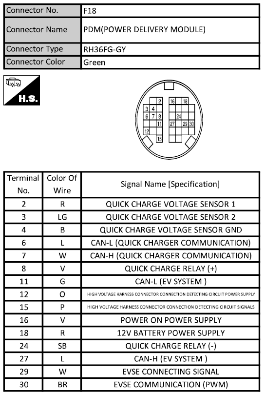

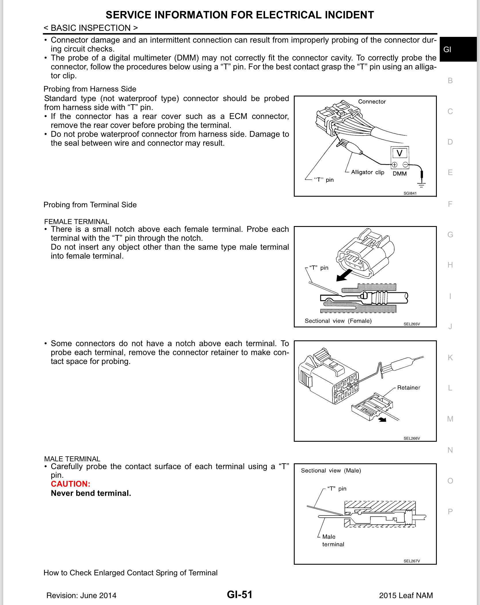

maiks wrote: Sat Dec 21, 2024 9:00 am Could you kindly provide a pinout or wiring diagram for the Nissan Leaf Gen 2?
You can’t 100% trust just colors as they have changed between year models and there are a limited number of colors, so multiple wires can be of same color. Also engine harness is super fun as some colors change in the looms between the E8/F1 engine loom connection.
You really need to check correct wiring from connector pinout.
Do you have the engine harness connector in your wiring loom? You could use the pinout for it to find all the needed connections.
If yes, you could use the Leaf main engine loom E8 doc kindly shared by Active automation in their Google https://docs.google.com/document/d/1jQd ... d1CFSV_lEo
If you have a cut loom, I’d trace the connections by measuring continuity from the PDM and inverter terminals to the flying lead end and then mark the corresponding wire with label. Just don’t push anything in the female terminals to avoid damage and continuity problems in the future.
A really good source for information (for hopefully obvious reasons) is the Leaf SM. EVC, TMS and powersupply, ground and circuit elements are probably three most useful manuals to look at. They have also details on diagnostics and signal types and voltage levels which are useful if you need to determine that things work like they shoud.

J0hannes wrote: Sat Dec 21, 2024 10:03 am You can’t 100% trust just colors as they have changed between year models and there are a limited number of colors, so multiple wires can be of same color. Also engine harness is super fun as some colors change in the looms between the E8/F1 engine loom connection.
Thank you, J0hannes.
I have carefully checked the F18 connectors, and my connections appear to be correct. The pinout is as follows:
Pin 18: 12V permanent
Pin 16: Switched 12V
Pin 11: CAN Low
Pin 27: CAN High
Pins 29 and 30: cp and pp
I have rewired everything according to the diagram here: https://openinverter.org/wiki/images/5/ ... iring1.png. The inverter is working, but the DC-DC converter is still unresponsive.

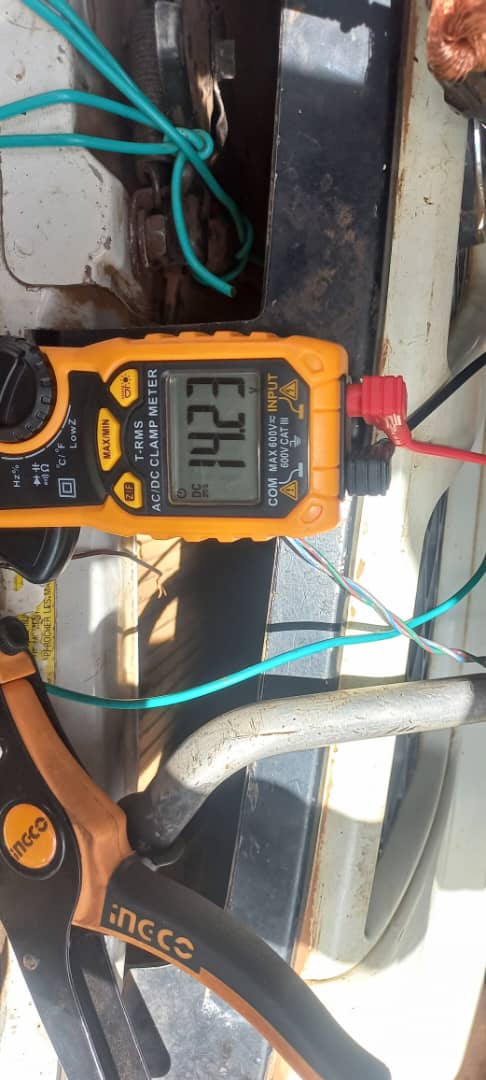

I have managed to make it work. Thank you all for your knowledge and guidance
DC-DC Solution: Upon reviewing the CAN messages, I discovered that the PDM wasn't receiving any signals. Upon opening the unit, I identified that low voltage was not reaching the PDM via connectors F18/F23. To resolve this, I implemented a bypass, and the system started functioning correctly.
AC Charging Solution
: I connected the PDM's permanent 12V (pin 18 on the F18/F23 connector) to the permanent 12V supply. Then, I routed the PDM's switched 12V (pin 16 on the F18/F23 connector) to the EV relay( controlled by the VCU switched 12V). Additionally, I established the CP and PP connections.

maiks wrote: Fri Dec 27, 2024 4:34 am
A
Can you provide ore details and photos
Is the connector pinout wrong?
was there a damaged connector?
maiks
Posts: 96
Joined: Thu May 11, 2023 9:20 am
Has thanked: 7 times
Post by maiks »
Bratitude wrote: Fri Dec 27, 2024 4:16 pm Can you provide ore details and photos
Yes my f18 connector was damaged.
The pinout is correct and l followed it to trace wires inside the pdm, cut them and made a bypass .
