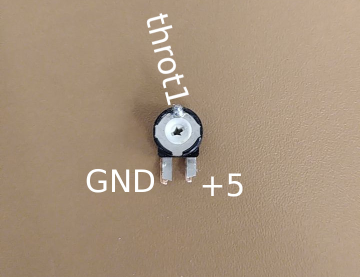

The throttle pedal. I don't have an actual throttle pedal yet, so at first I used a 3-wire 50kOhm potentiometer, in potmode SingleChannel.
I carefully tested it separately to find the correct pins, and confirm that if given 5V, it would give between 0 and 5V.
Once connected to the VCU, the pot value stays between 0 and 1, sometimes 1 and 2.
Therefore, even setting potmin to 0 and potmax to 2-3, potnom always stays at 0%.

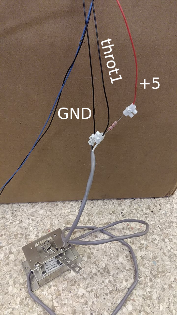

Thinking my potentiometer somehow died between the tests and now, I removed it and borrowed a Curtis PB-6 that my brother had lying around. I had to add a resistor to turn it into a "3-wire potentiometer". I once again tested it separately, and it worked.
Connected it to the VCU, and same story. That's when I decided to measure the voltage given to the potentiometer.
And it's nowhere near 5V. It's between 0 and 1mV. So noise basically.

The THROTTLE1/2 inputs effectivly have 2Kohms to ground, so even with a good 5V supply the 50K pot will have most of is adjustment close to one end. Looking at the spec of the Curtis pot it is 5K which is still a little high but should work. The two Bosch pedals I have are less than 2K. Not sure what resistor you were using from the 5V but is looks like a very low value ( 1ohm ?), this will not act as a divider so THROTTLE1 would be at 5V,.

royhen99 wrote: Wed Feb 22, 2023 8:33 pm The THROTTLE1/2 inputs effectivly have 2Kohms to ground, so even with a good 5V supply the 50K pot will have most of is adjustment close to one end. Looking at the spec of the Curtis pot it is 5K which is still a little high but should work. The two Bosch pedals I have are less than 2K. Not sure what resistor you were using from the 5V but is looks like a very low value ( 1ohm ?), this will not act as a divider so THROTTLE1 would be at 5V,.

Indeed, it was only an 80Ohm resistor that I had on hand. When testing separately from the VCU, it made for a correct voltage divider, so I went with it.
But as you said, with such a small resistor, I should have 5V at Throttle 1 (pin 47), therefore 100% throttle, but it's 0V, because the +5v Throttle (pin 48) is at 0V.
