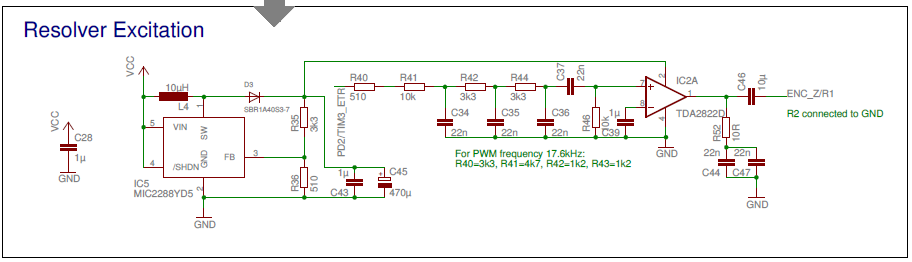

According to BOM from link above I have question. I want to connect this board to Leaf inverter+motor via Johannes interface board, so which resistors should I populate in group R40-R43, where is speed selection?
Another headache are R50-R51 - I think depends of which current measurement I have. In case of Leaf inverter I think I should populate them, correct?

A more official link if here https://github.com/jsphuebner/inverter- ... rdv1.1.pdf
If you need 17.6kHz PWM then R40-R43 follow the drawing

Thanks for updated link to schematic.
Do I need 17.6kHz PWM now is question. Really sorry for my ignorance, but really I don't know if for stock Leaf resolver in motor from Leaf, should I take higher or lower PWM and which is better in my situation. Maybe someone with already soldered board can look at board and write what have on board?

The Leaf inverter should be operated at 8.8kHz. At an earlier stage I thought it had to be 17.6.
With the latest software the excitation frequency is decoupled from the inverter frequency. It is now always 4.4kHz. So the values denoted in the schematic (0.51, 10k, 3k3) are what you want.

Hello again,
Today I finished soldering v3 board and after power on ofcourse board doesn't work
PWR led isn't working, so I checked voltages and both VCC-5V and VCCIO-3,3V are about 1,2V.
On beginning I had D1 and D2 B540C, then I replaced them to 1N5819, because now I can't obtain CDBA540-HF. For now also C20-470uf/16V I left normal thrue hole version. It can be some problem with this power supply or somewhere else? Any other part isn't hot/smoked/etc so can be, that LM2596 is broken?

I think there is a short somewhere, can you check 3V3 and 5V against GND with ohms range?

Similar values on mine. You can remove the 3V3 reg and see if 5V are stable.
Re: Rev 3
The same, VCC output 1,2V without IC8 3,3V reg.
Can You check on Your board R11 (in resolver mode) resistance in both directions?

What a shame with voltage regulator LM2596
Today after big investigation what is wrong I discovered what I exactly ordered from Farnell - it was LM2596-ADJ instead of LM2596-5
Good, that the output voltage was 1,2V and not 12V, otherwise will be a little mess.
So, now I'm waiting for next parts delivery and then I will try with this - thanks Johannes for Your time in search of my error.
