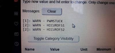

- Posts: 1884
- Has thanked: 91 times
- Been thanked: 517 times
Re: Johannes in a Blue Pill
Oops, I get an error on index.html, cannot parse json.
If I look at request or hit 'http://x.x.x.x/cmd?cmd=json' I get
I've tried with the Olimex Mod-WiFi that I know works as I pulled it from my inverter.
j��)BMW E91 2006
