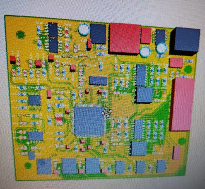

Ok so i made some Taycan CMC gateway boards but to make the board more versatile i added to the board:
V2:
- ST32F107 / GD32 based
- 2x CAN interface;
- RS-232 interface;
- LIN interface;
- 4 Digital Inputs;(1 shared with LINBUS)
- 3 PWM outputs;
- 3 Digital Outputs (sinking)
- 4 Analog Inputs (12volts) (shared with MC33364 pins)
- 2x MC33364 interface
V3 is out.
- 2x CAN interface;
- RS-232 interface;
- LIN interface;
- 2 PWM outputs (high and low current);
- 4 Digital Outputs (sinking) 3A / 5Aamp
The idea is that over the CAN Bus we can interface easyly to the module and read/write the inputs / data like if they where in the VCU.
So basicly an IO extension device.
In my case i wanted to mount one in the rear of the car to facilitate for example the DC/DC converter which isn't CAN based (Chevrolet Volt) it needs PWM.
But the use cases can be extended to command and control pumps or whatever you need.
The idea is that its a simple IO device which we control from the VCU over CAN.

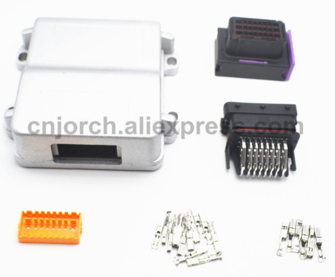

The housing :
In order to give the device a double role and even more purpose i added some IO's.
The idea is that in the VCU we can read/write those io's. (RIO = Remote Inputs / Outputs).

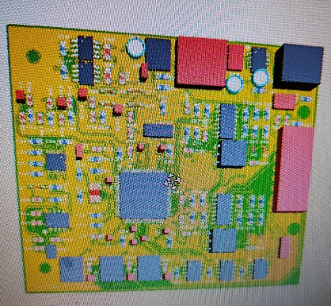

Ok boards are ordered at JCL. Hopefully they are "right" i took the GD CPU but i'm not sure if we should care about that.
I do need to find these components to complete the board but the most important one i already have :)
IC29
FAN3122TMX SOIC127P600X175-8N 1
D3
PESD5V0F1BRLDYL PESD5V0S1ULD315 1
IC32
MC33664ATL1EG SOIC127P600X175-16N 1
IC14
TJA1020T_CM,118 SOIC127P600X175-8N 1

Ok so i have progress and i have good news and bad news. Lets start with the bad news.
The badnews, in my first ever PCB run i made some NOOB mistakes.
Like ground symbols not connected to GND net and some more.
(like i didn't know that you cant remap one pin, always the complete device function is remapped).
Yes i should have know but hey i was in a hurry to have Chips available at JCLPCB...
Now the good news after some pretty long debug sessions i made it work! I have a working taycan battery block slave controller!
Updates will follow as i progress to show something for that i'm working on a GUI app too.
For now the situation is as follows:
V1 board, when modified:
Dual CAN and Remote IO and Single Channel MC33664 string (up to 15 blocks);
or Single CAN and less Remote IO and Dual Channel MC33664 string (up to 30 blocks);
The taycan uses originally 4 strings but that's done because they wanted a faster scan rate of their bricks / needed more then a dual channel anyway.
The main CPU i have used (resoldered) is a STM32F107 one, don't know if the GDones will work.
I will post updates as i progress. LIN is to be tested and the UARTS etc.

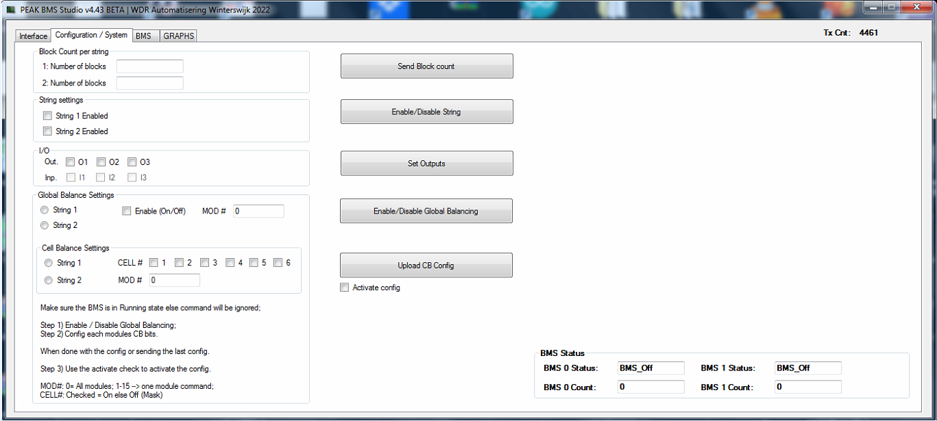

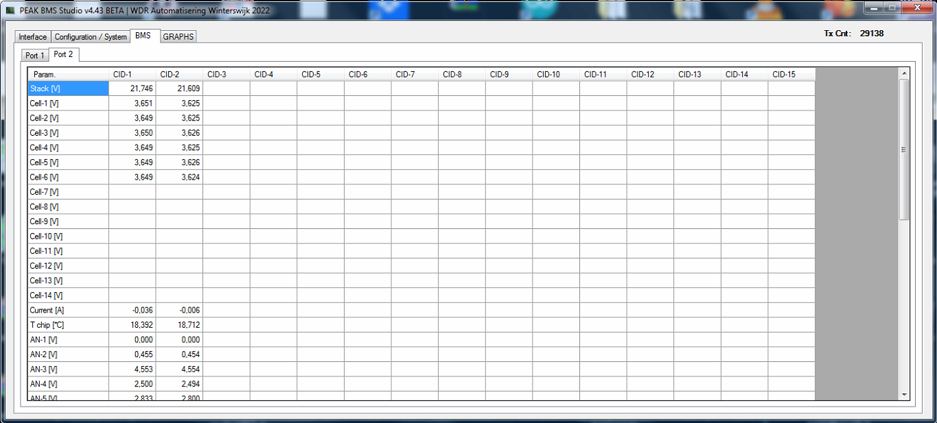

It works!

tom91 wrote: Mon Nov 15, 2021 8:01 am Very good progress. Did you write the software from scratch or are you running the example from NXP?
I'm running my software on my own board with an STM32F107 CPU and new C# GUI using the CanBus as interface. Next step is validating it on a GD32 device. Hard part is the crucial layer: spi chip --> driver.
If someone feels the need to influence how I should proceed shout your ideas I'm all ears. There is quite some data to transmit per block so we need something smart. I'm thinking a request of the master can change the PDO's of the slave? Or we should implement functions into the chip itself.

Ok I made some corrections and ordered V2.
I also confirmed that the GD32 chip is working with the current firmware.

Progress V2.0 Validation:
CANBus 1: OK
CANBus 2:
String 1: OK
String 2: OK
GP Input 1:
GP Input 2:
GP Input 3:
GP Input 4 : NOK, needs small fix.
LIM :
PWM 1. :
PWM 2. :
PWM 3. :
GPOUT 1:
GPOUT 2:
GPOUT 3:
mux

Ok lots of progress:
- Balancing command implemented en tested;
- GUI tool updated with all commands;
- BUSMUST CanBus USB support;
- 2High current outputs and 2Normal ones (4 outputs);

Lalle wrote: Tue May 10, 2022 3:07 pm So the dongle is not useful to connect to Taycan battery BMS?
Lennart
That dongle is a generic dongle, but i implemented its API in the GUI tools. Currently i support 2 dongles: a profi one (PEAK) and a economic solution (your dongle).
Its use is thus for me in the GUI tools to connect to the TayCan battery CMC Gateway;
With the GUI tools you can check your pack and listen allong on the canbus.
