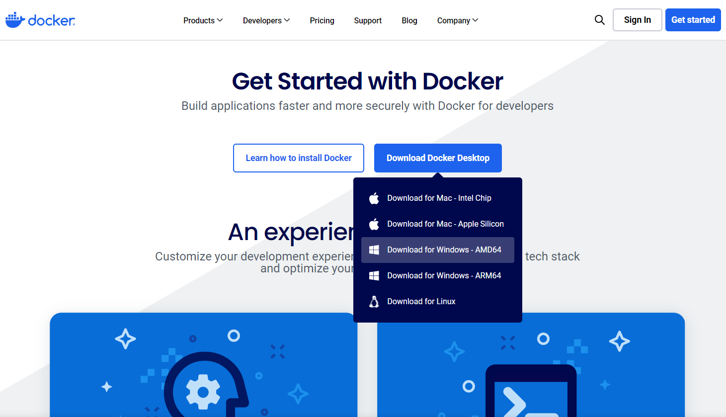

I just went through this again on a new laptop and found a couple of things that would make it easier for future installs & big thanks for setting up the Git and links as they are very helpful.
Can I suggest the following.
your link to the windows docker installer doesn't have a windows intel version listed (yeah yeah yeah) however it can be found here https://docs.docker.com/desktop/install ... s-install/
add the instruction to "download ZIP" from the Git 'Code', unzip the contents into what will become the projects base folder and then run the SetupContainer.bat
thanks again.
TED
crasbe
Posts: 294
Location: Germany
Has thanked: 47 times
Been thanked: 146 times
Re: How to setup a PC to edit and compile a bin that can be uploaded to the VCU or Mini board
Post by crasbe »
"AMD64" is the version for all x86_64 processors (including Intel), so the link to the Getting Started page is correct:
I could add the instructions how to download the zip archive, however I did not anticipate that that would be an issue.
The README is already updated.
