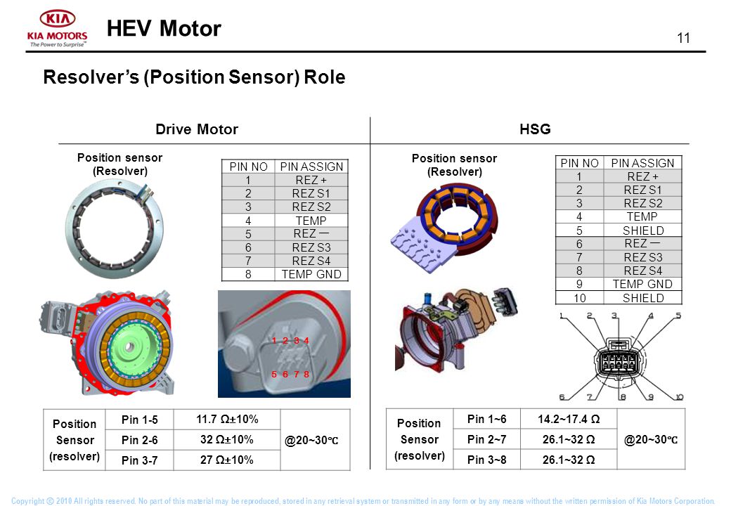

I just got one HSG motors AND Honda IMA inverter. I intend to make a small setup of about 52V or so to drive a DIY 3wheeler for my son.
I found resolver connector is really easy to get from ebay or aliexpress. 10P male connector on the motor requires sealed female connector wired.
https://www.ebay.com/itm/20-set-1-2-3-4 ... 3233166806
What i dont have is resolver pinout and eventual thermistor so i can make a connector and test the motor with my Volt inverter before i proceed to make a Lebowski brain for IMA. I seem to remember you discussed HSG resolver pins somewhere online.

http://www.kniro.net/hybrid_starter_gen ... s-762.html is useful but has the wrong pinout, but http://www.kniro.net/resolver_sensor_sc ... s-768.html has the right resolver pinout for the HSG

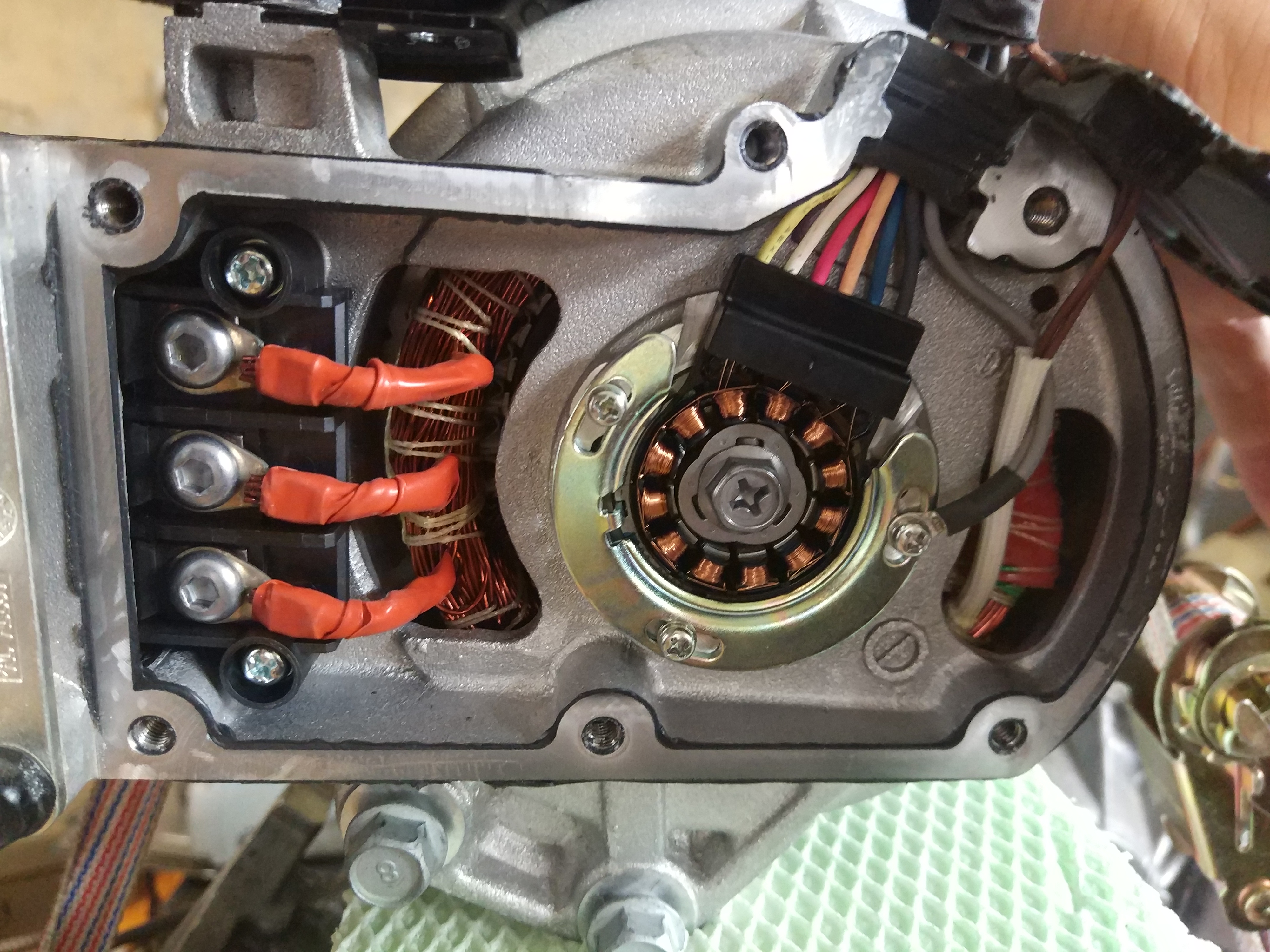

Excitor coil is on pink/white. Feed back signals are on blue/yellow and black/red. I have almost finished my IMA/Lebowski board that includes resolver support for the HSG. Off to the pcb manufacturers shortly. I got plugs from Aliexpress but Autoclick in the UK have them too. I also tracked down the IMA main plug, digikey part number 670-2925-ND and pins 670-2268-1-ND

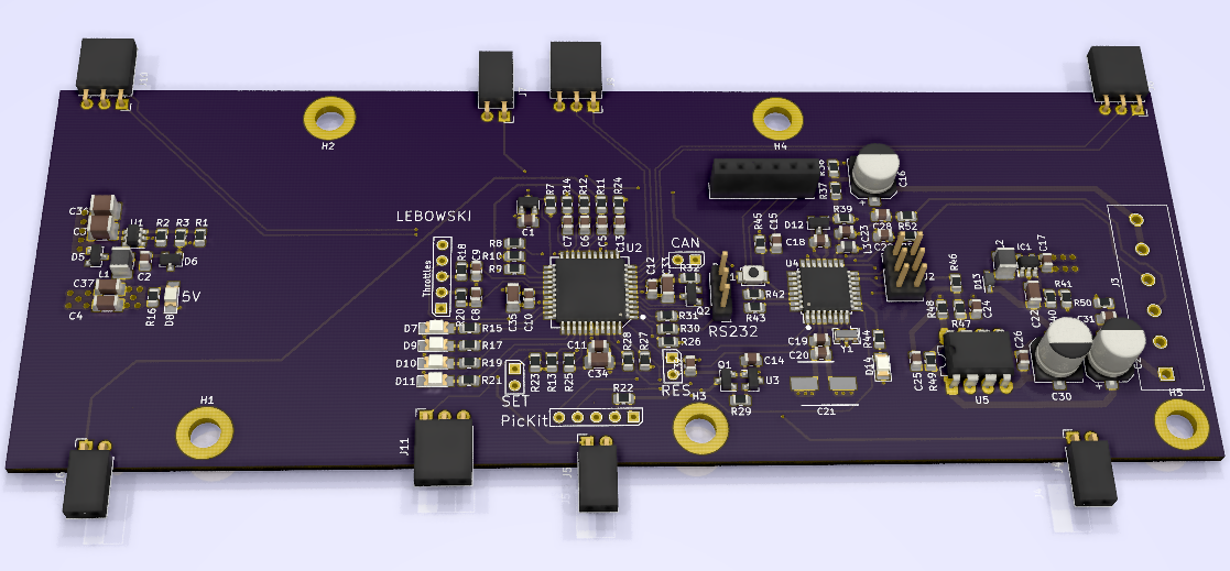

marengo wrote: Mon Apr 12, 2021 12:32 pm I've scouted the lebowski route. Kiwifiat, do you want to build two lebowskis for fun and profit? :)
I only have one remaining BobC board available and the required resolver to Hall converter for an IMA conversion. There are three guys in the US and one in the UK working on Lebowski/IMA conversions now and Arber333 is about to start one. The single board solution for the IMA inverter is a little way off. PM me for details.

Coleasterling from DIY and ES who has been driving the Lebowski/HSG project forward supplied me with a dismantled IMA board, a couple of working IMA inverters and an HSG motor. In the first instance the original brain pcb has a six output fully isolated 16V supplys for the IGBT gate driver boards. Secondly It is has components on both sides and has what appears to be support circuitry for the gate drive boards on top and bottom. Lastly it is an absolute pain to remove from the IGBT gate drive boards below with quite delicate pins projecting up from the three IGBT's below. I entertained the same idea but in the end the pragmatic solution has been to design a board that will mount on short standoffs over the original pcb and have very short jumpers going to the gate drives, current sensors, and bus voltage feedback. I plan on utilizing the original IMA socket to make all connections to the outside world. I am not saying you can not do what you propose only that from my perspective the cost/benefit does not look good. In the case of the Ampera/Volt inverter it is plainly the best option to replace the entire original brain board since there is basically nothing other than the isolated bus voltage feedback that gets sacrificed.

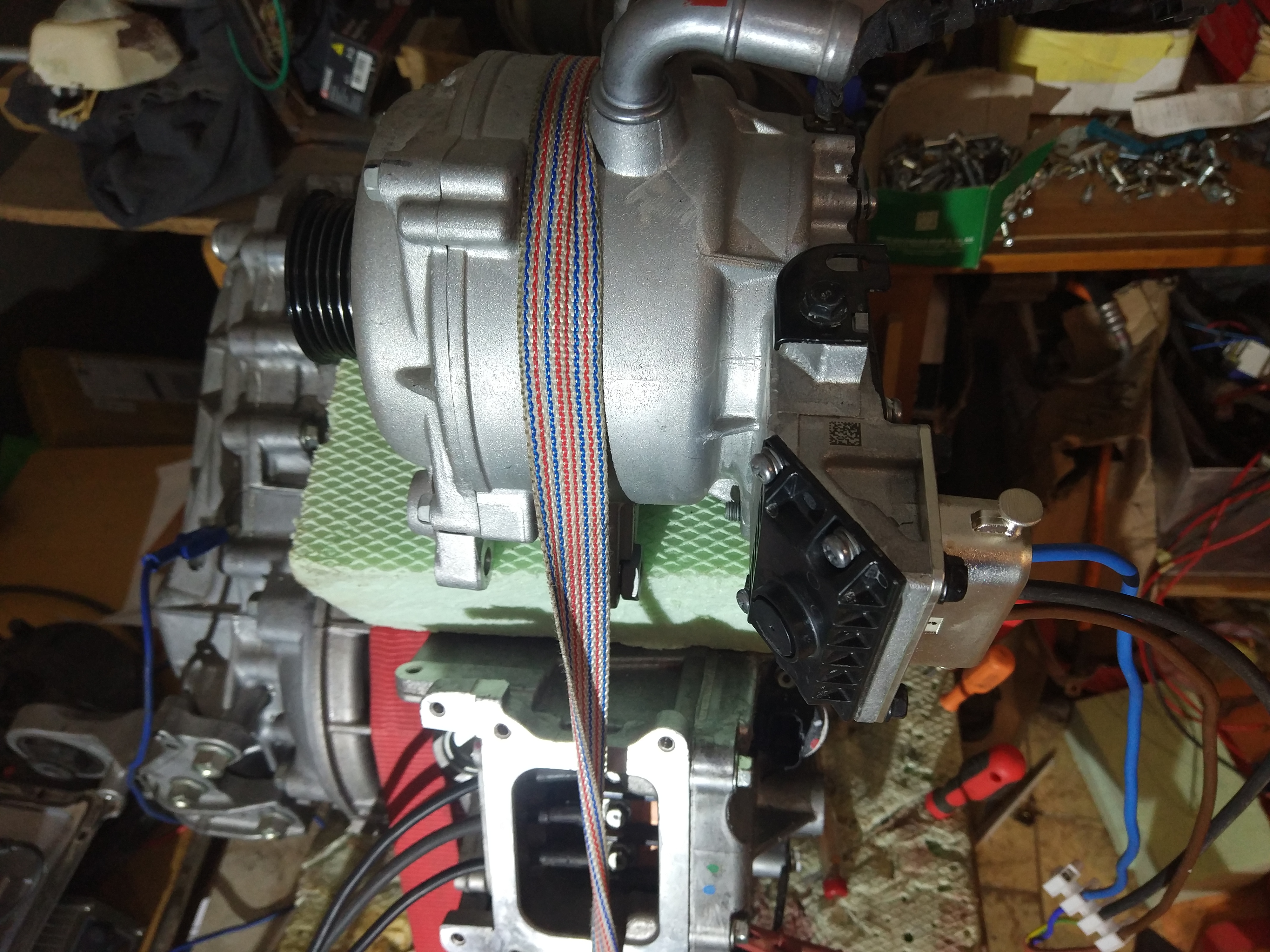

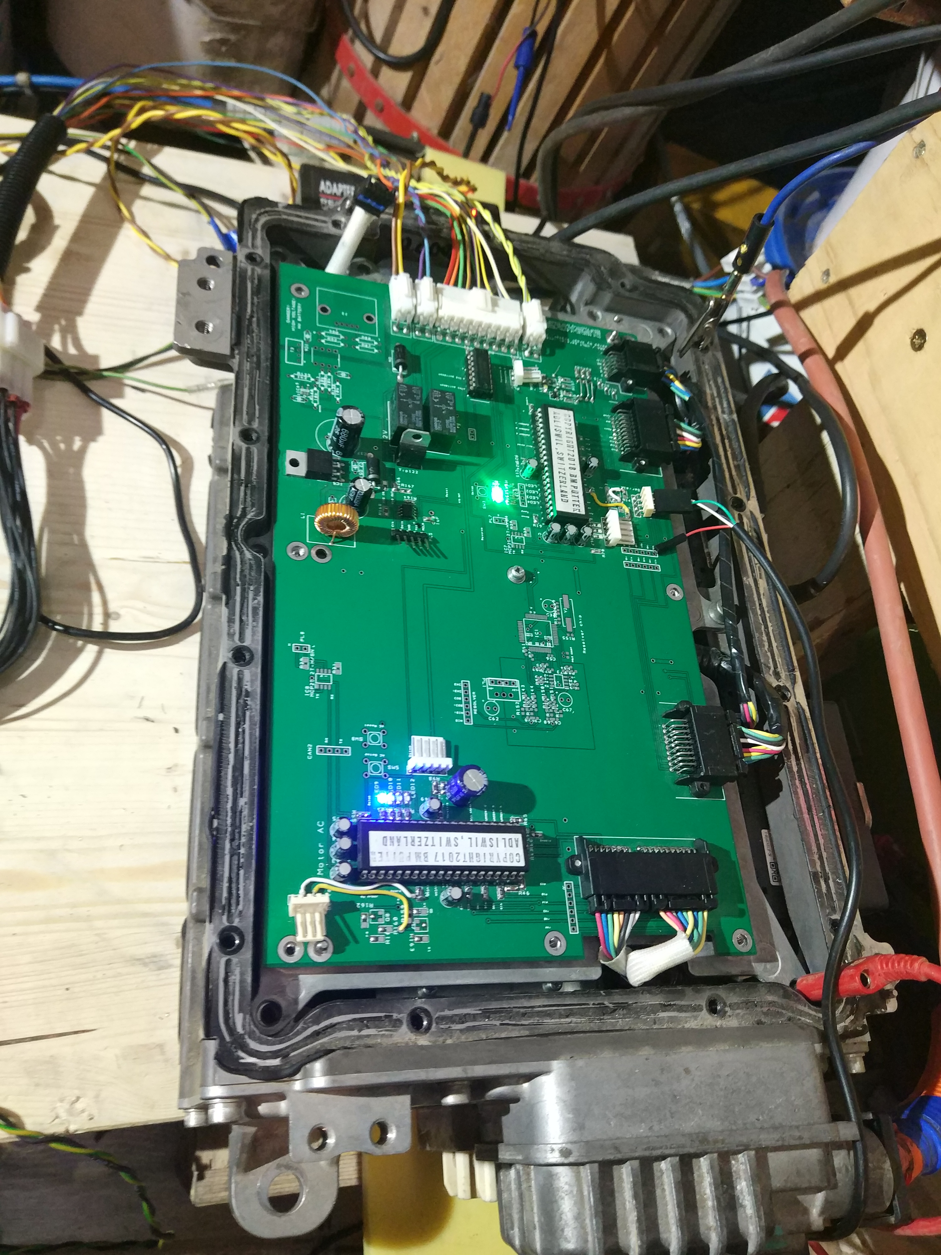

I will hijack this thread since everything about HSG is already here.
I got one HSG motor and i prepared my Volt test inverter to drive it with 360Vdc. That is correct! I applied full pack voltage to motor that in OEM uses 120Vdc 240Vdc or so. I made cables from 6mm2 wire and i added large fastons on the ends. That makes for super easy connection.
My inverter of choice for first run is Lebowski since i already have the board made. The board is Volt Lebowski ver3 with sensorless interface.
However there is a twist 8-). Since i will also be trying to run Outlander motor via BOTH power sections i decided to connect my HSG motor via the small power section meant to drive the Volt transmission Aux oil pump.
Lebowski makes this almost too easy and i was spinning the motor via settings for regular Prius AC compressor in no time. :twisted: 9000rpm at 35000erpm, go figure... This means motor is 4 pole pairs! I measured phase resistance and got 460mohm so i divide this between phases and i get 230mohm for a single phase.
I tried FOC calibration and got some more results.
HSG settings
Current settings
Sensor transimpedance 40 mV/A current sensors
Max motor currents 20A Set 20A for start
Max batt currents 10A Set 10A for start
FOC impedance measurement
- Inductance 1500uH
- resistance 230mOhm
Next i will need to setup Openinverter with full resolver interface.
marengo

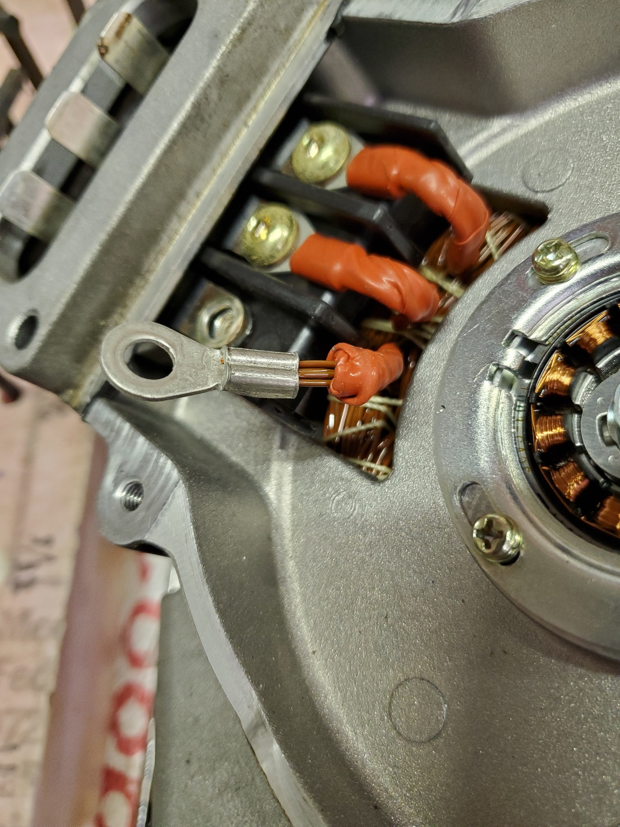

I was surprised to see each cable is just 6 strands of the motor winding wires crimped to a ring terminal. Does this limit the amps it can be force-fed?
Posts: 3795
Been thanked: 411 times
Re: HSG - Hyundai/Kia

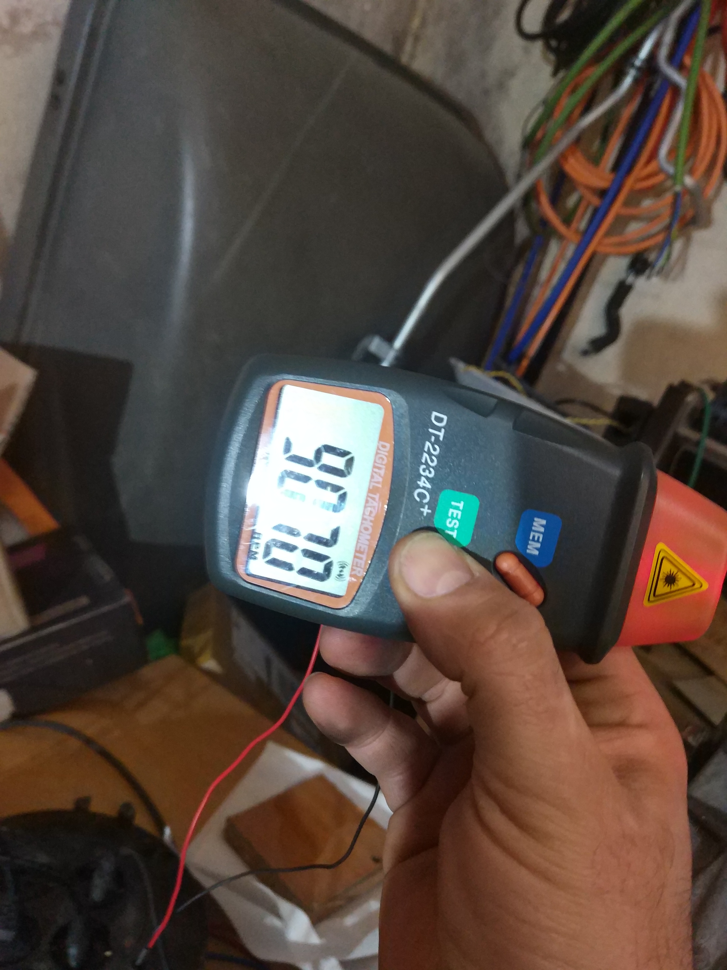

Maybe 6mm2? That would mean some 60A to 100A current limit.
It will not be force fed. It just wont accept more amps once stator is saturated.
On start from 360v i see 8A that falls to 1A with steady acceleration about 5000erpm/s. I may try for main power connections since small power section is limited to about 25A max.

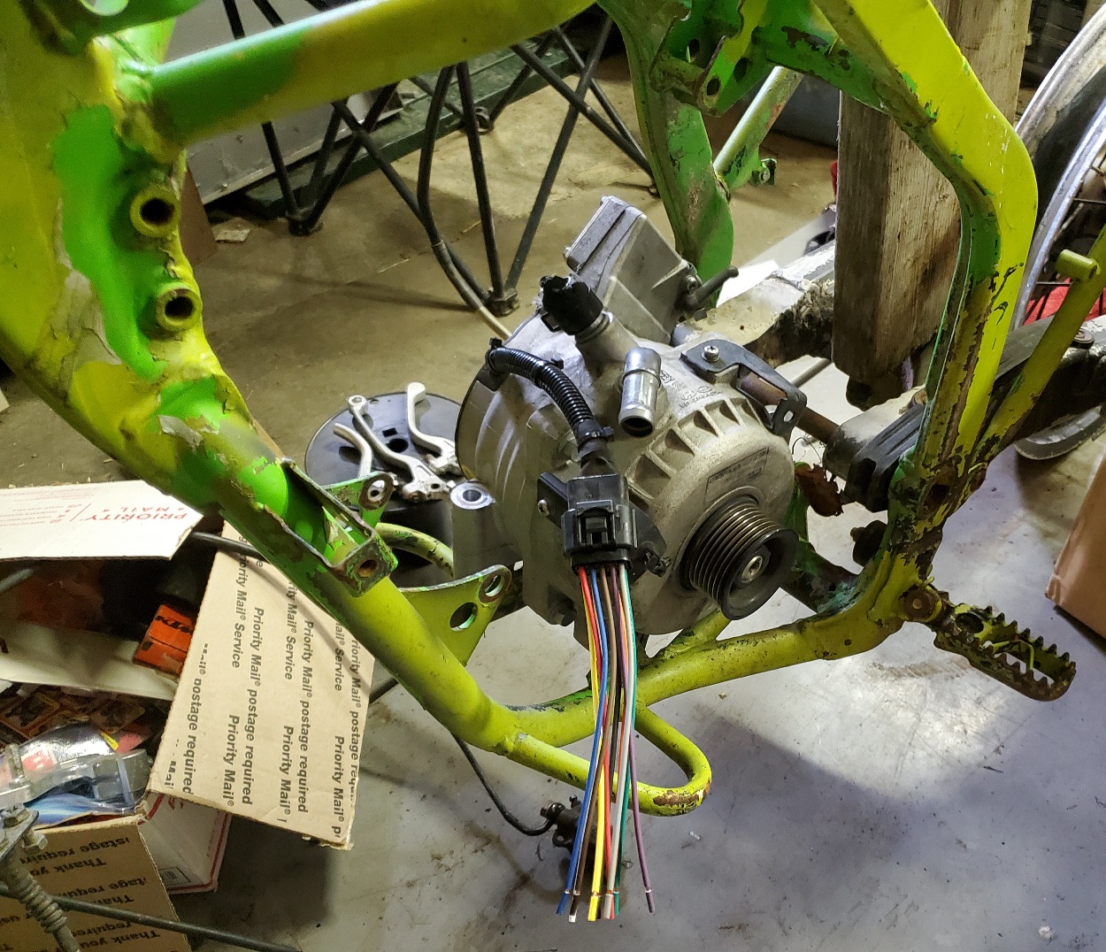

so im using one of these as a generator for my electric mazda rx8 project. im only needing 80 amps and 265 volts

Dylan Witt wrote: Mon Dec 20, 2021 9:19 am so im using one of these as a generator for my electric mazda rx8 project. im only needing 80 amps and 265 volts
What are you going to drive it with?
I’ve been looking for a sprocket that would fit onto the shaft, no luck so far as it’s 22mm diameter shaft with a 4mm width woodruff notch. the standard for a 22mm shaft is a 6mm width notch.
