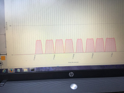

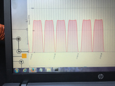

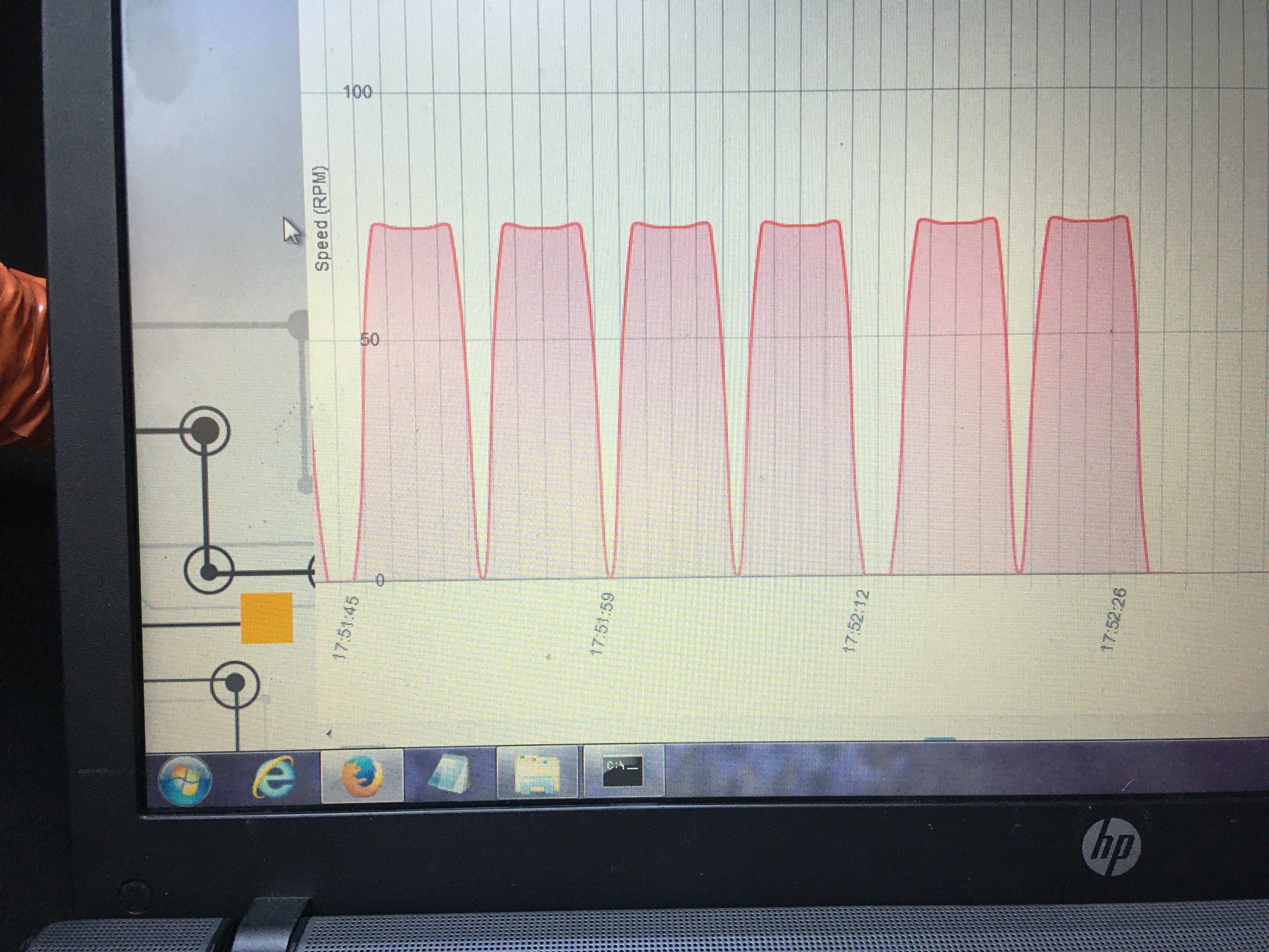

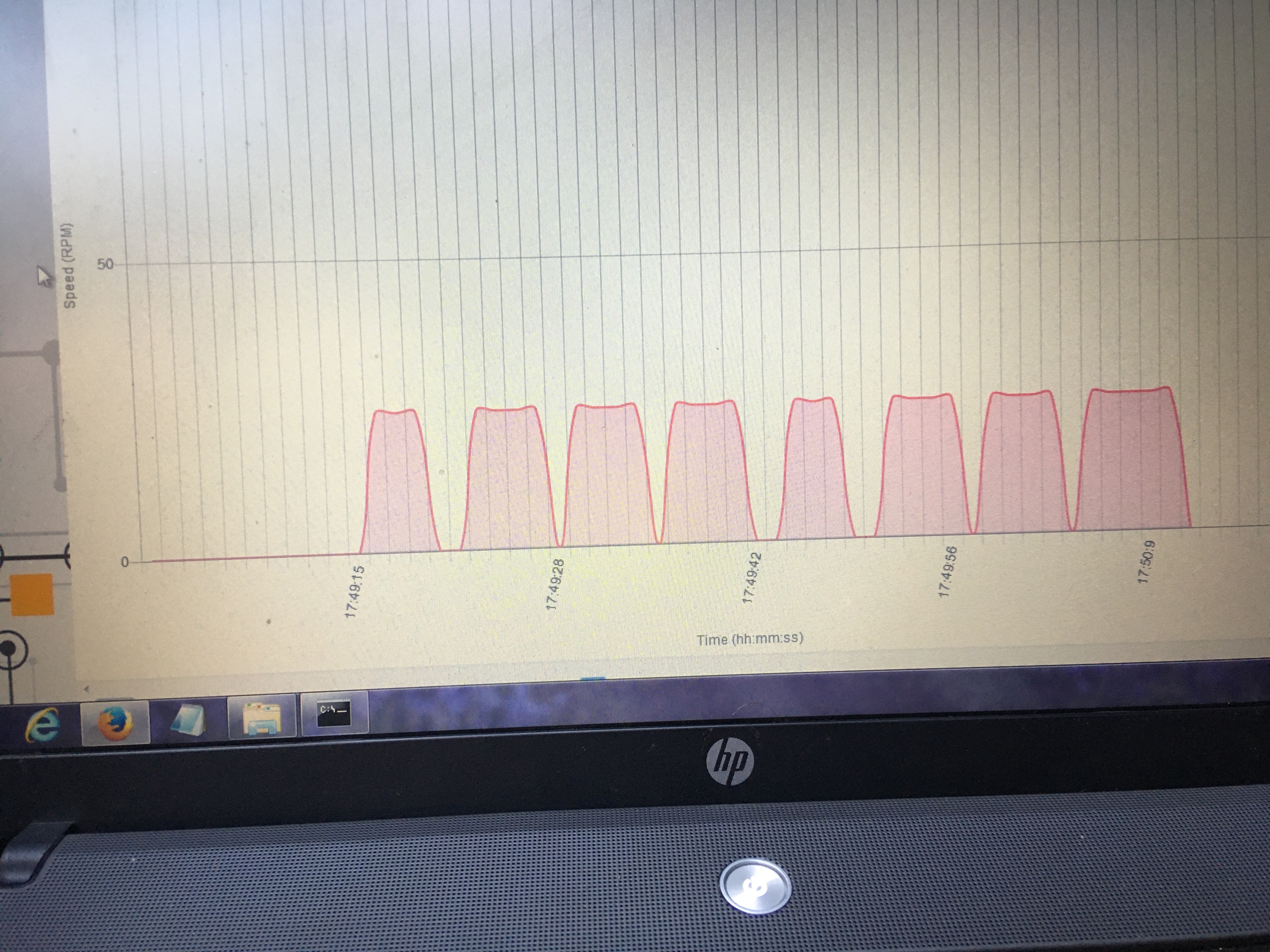

Re: Enova(!) Parameters
I don’t think I can get an angle plot. I’m on old software and didn’t want to update until I had it running to prevent any potential new problems arising.
I did get a couple of photos of the weird rpm plot I’m getting. This is with the inverter on and set to forward but with no throttle input. If it’s in neutral the rpm plot is flat. It will repeatably produce one of these two plots.
Seems really strange that it’s such a neat graph and can be produced consistently.
I’m going to start looking into a different encoder but if those plots mean anything to anyone then let me know.
