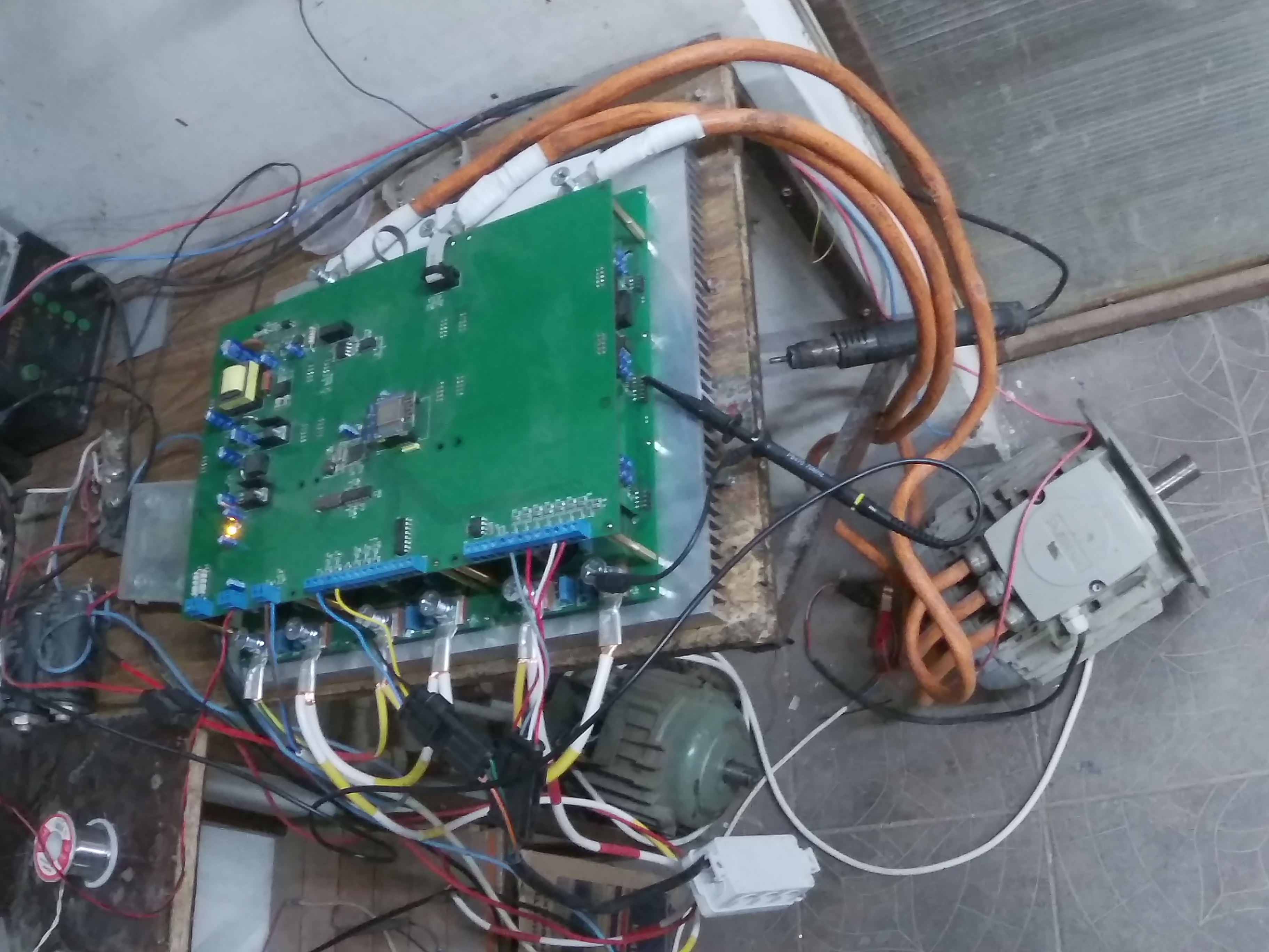

Hi, I want to build an inverter for 120V and 600A current, according to the reference for field-effect transistors are well suited IRFP4568 plan to use 12pcs for 1 phase, who will advise can there be low-voltage modules for high current?

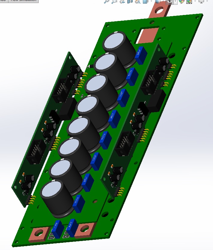

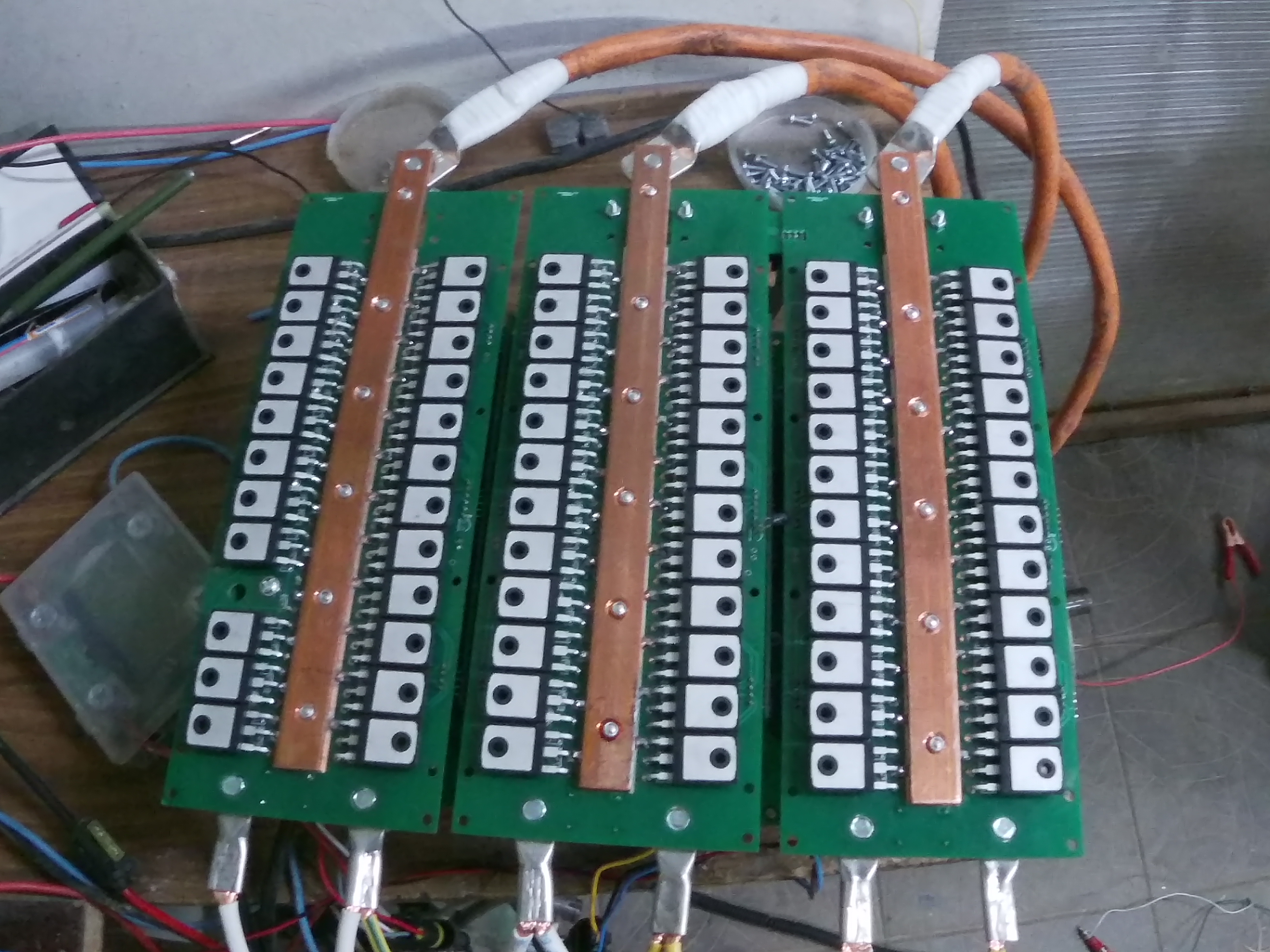

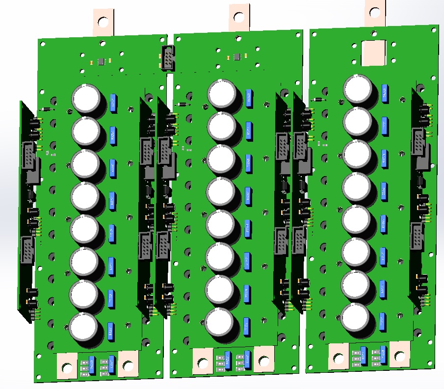

Well, since no one advised me, I will use a n mosfet, that's how will look the whole Assembly

Well if you want to use mosfets you need to use transistor pair p and n to get halfh bridge for one phase. Then 3 phases...
What will you use for brains?

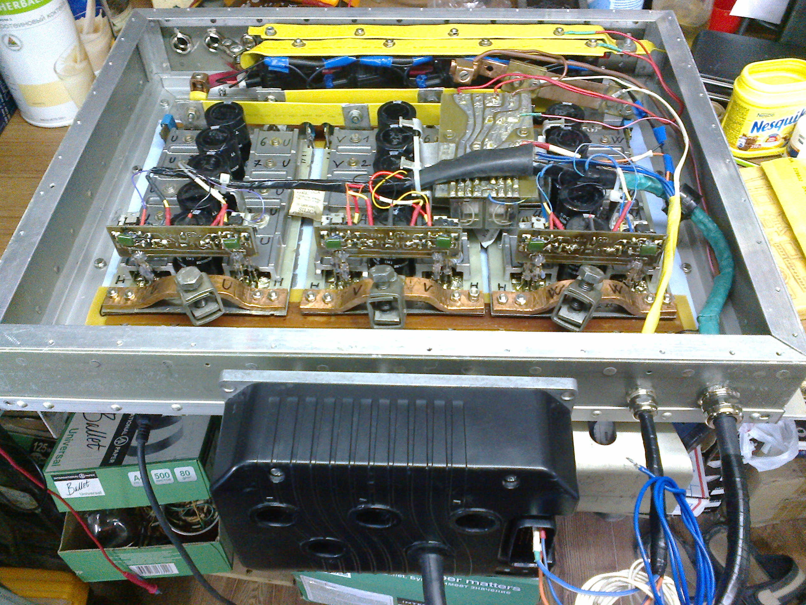

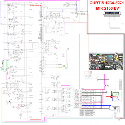

hi yaroslav. i used igbt transistor AUIRGP50B60PD1E.

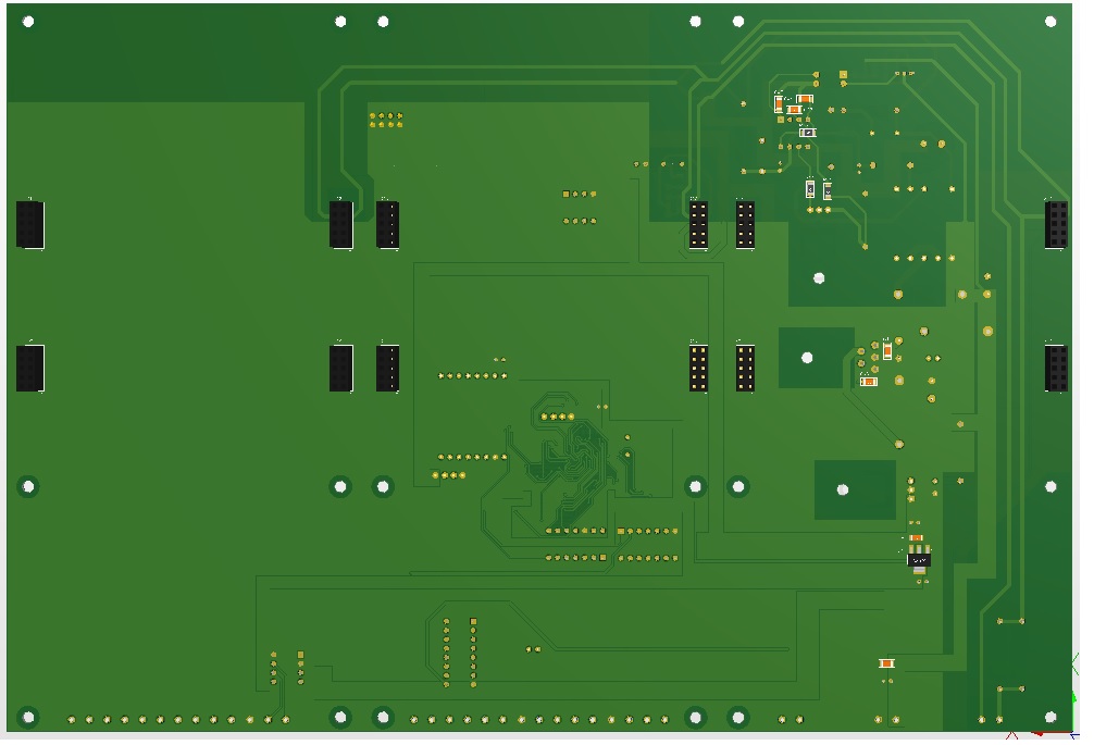

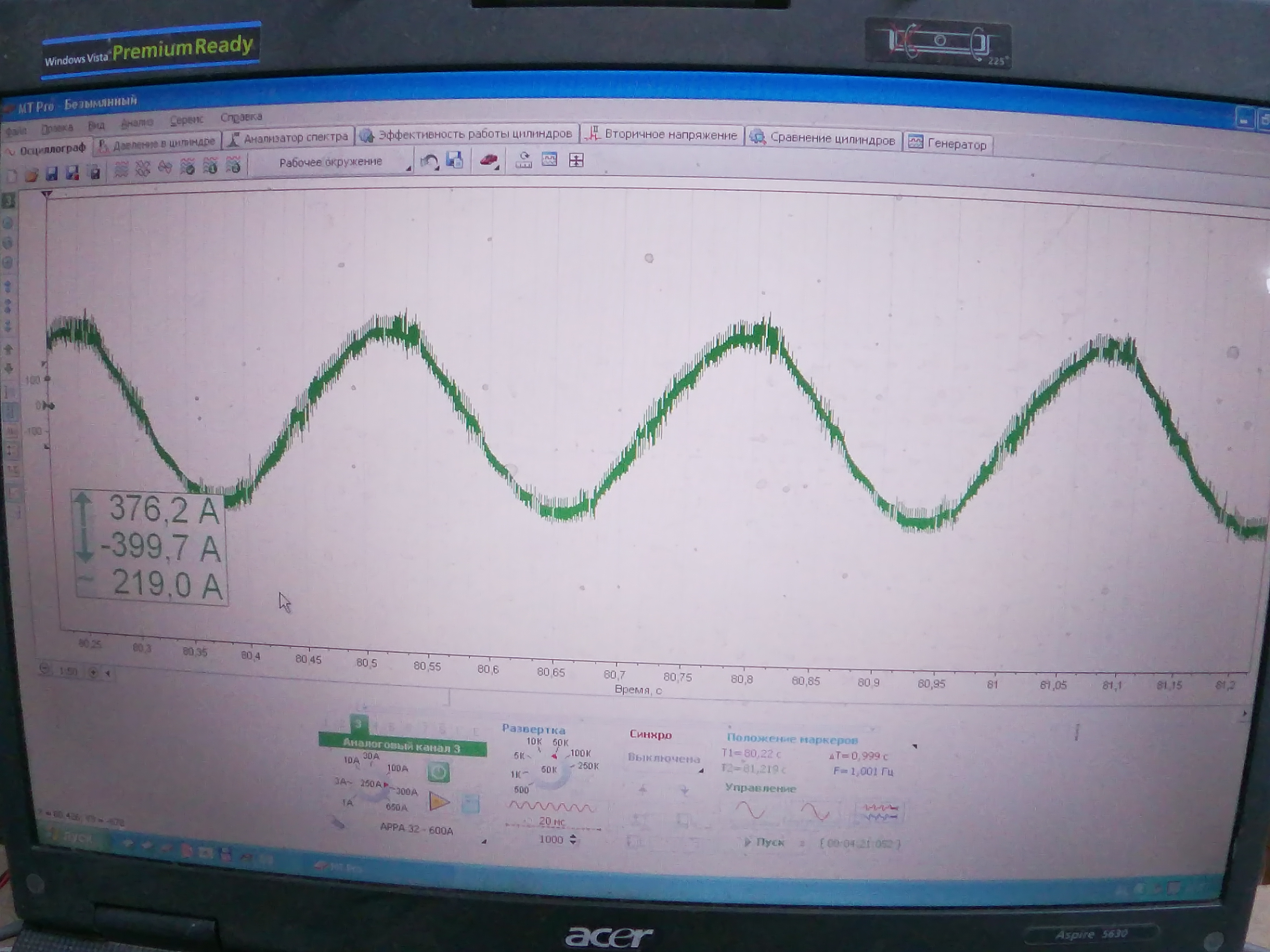

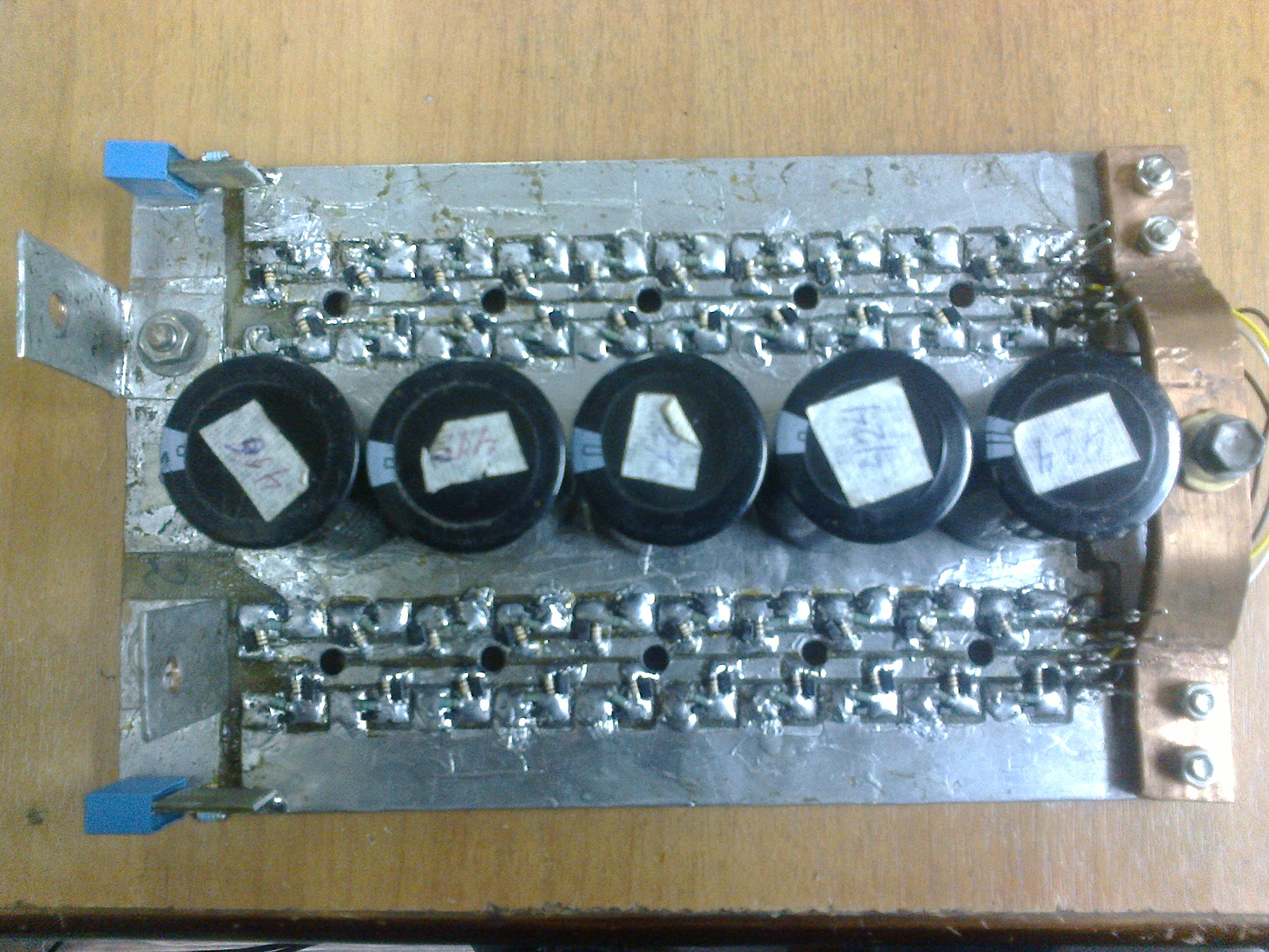

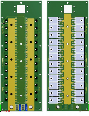

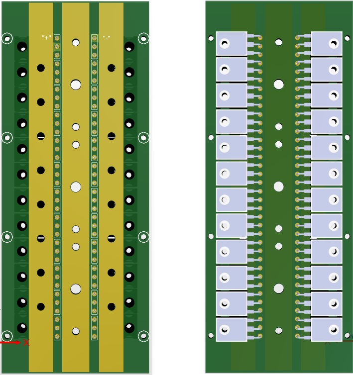

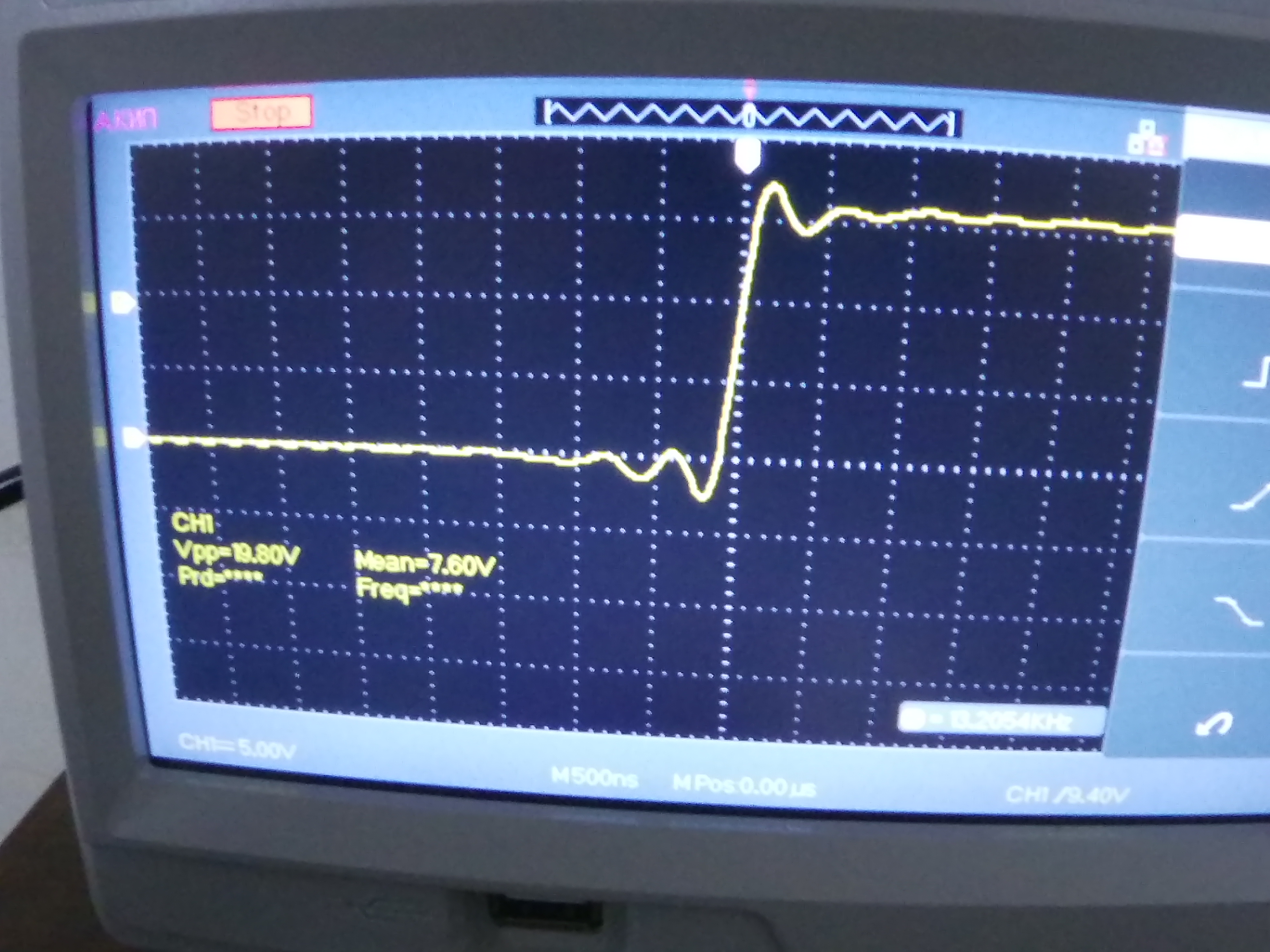

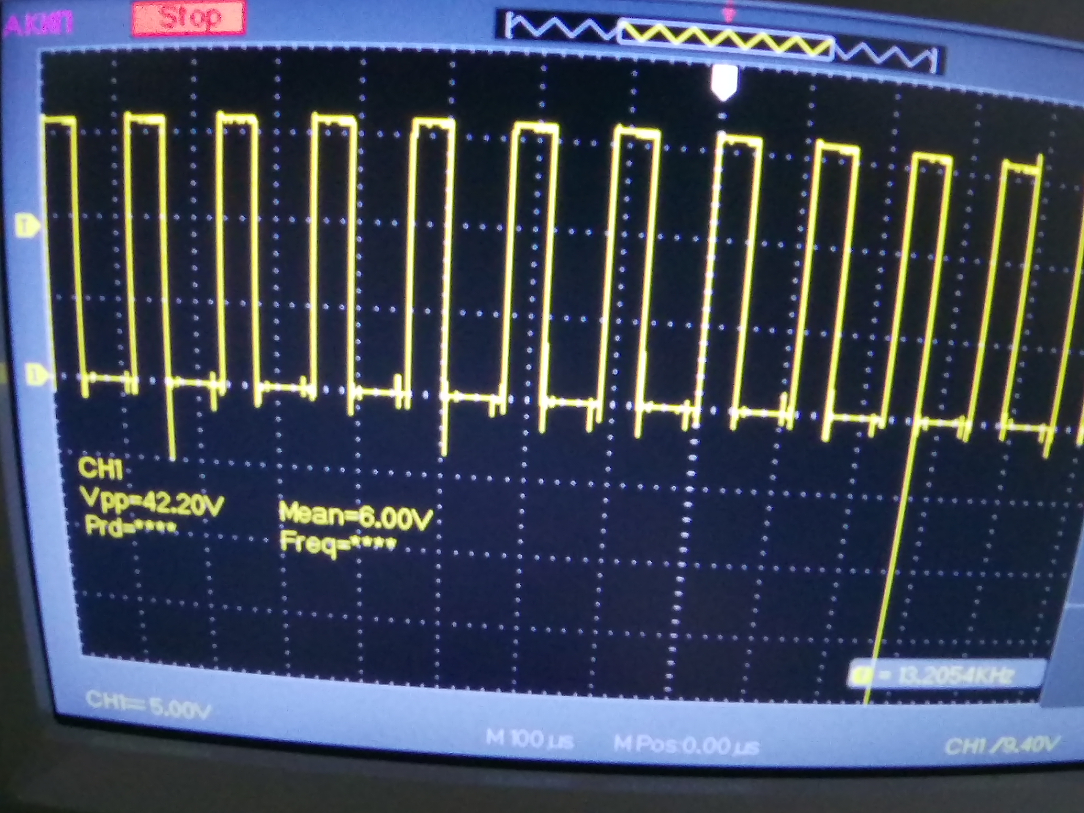

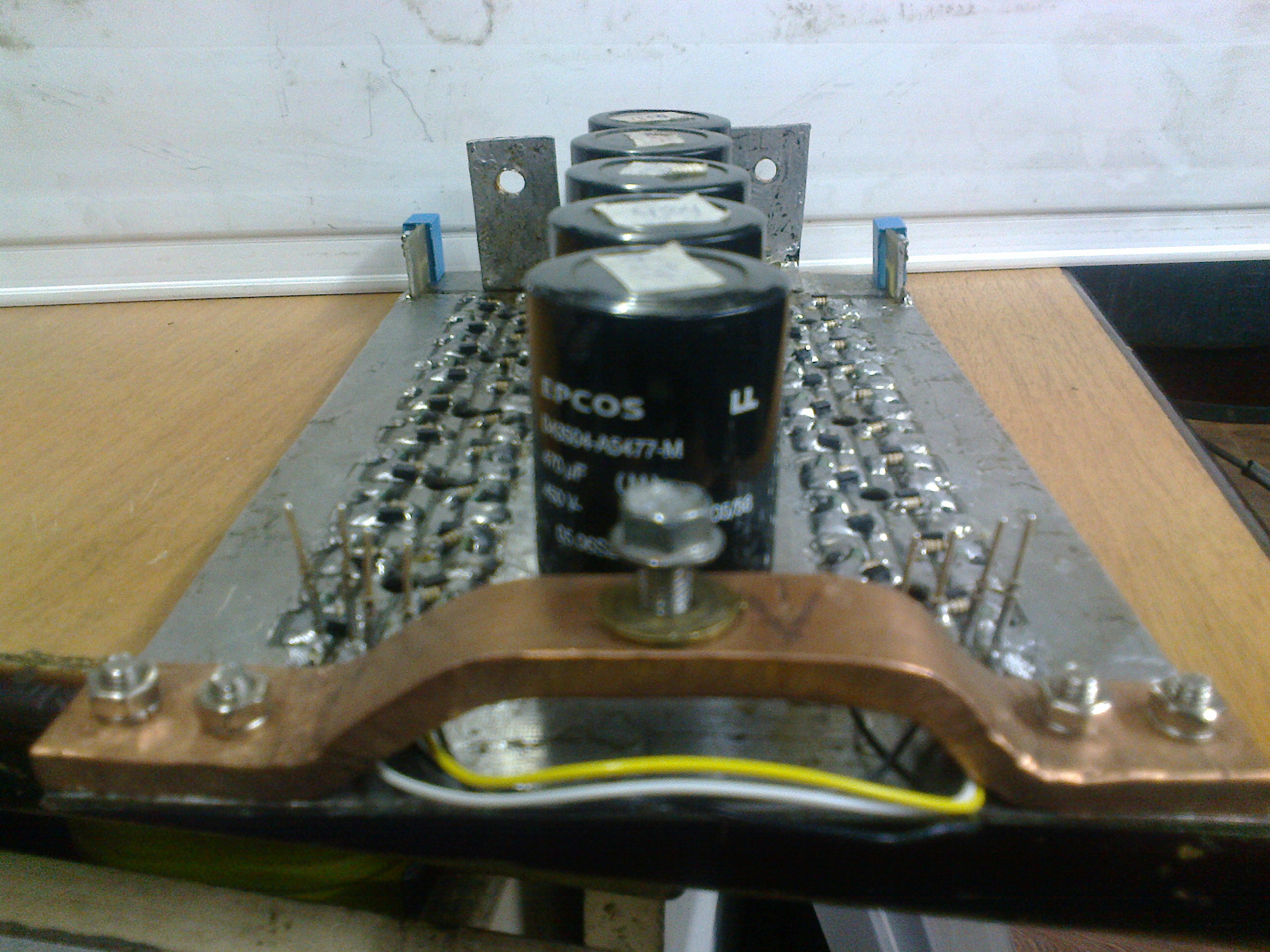

Hi all, I collected an inverter, but have difficulties, asking for help from the forum, can someone tell me, when working on the phases of the motor is very dirty sine, I suppose this is due to improper PCB layout and sub-zero tires, how to connect the drivers to the gates of a large number of field-effect transistors?

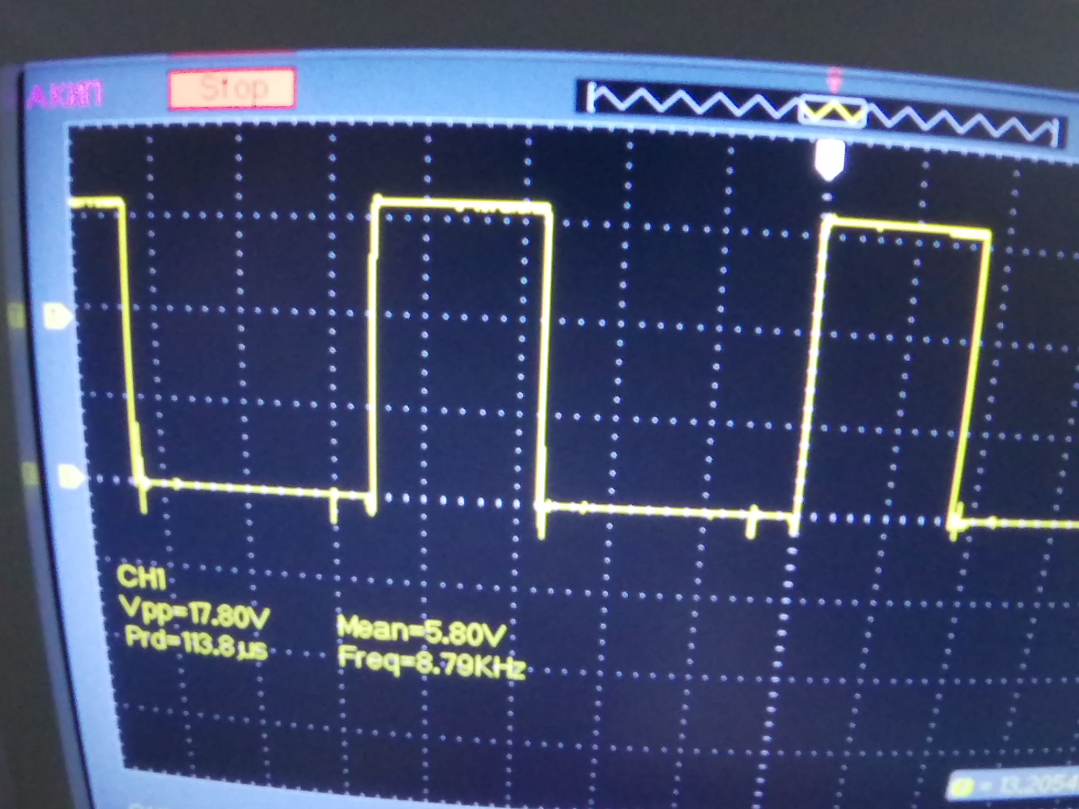

Can you post a picture of the waveform you see? Also check out this paper on oscillation between paralleled MOSFETS.

Post by yaroslav »

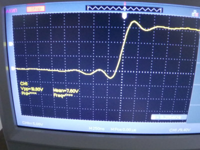

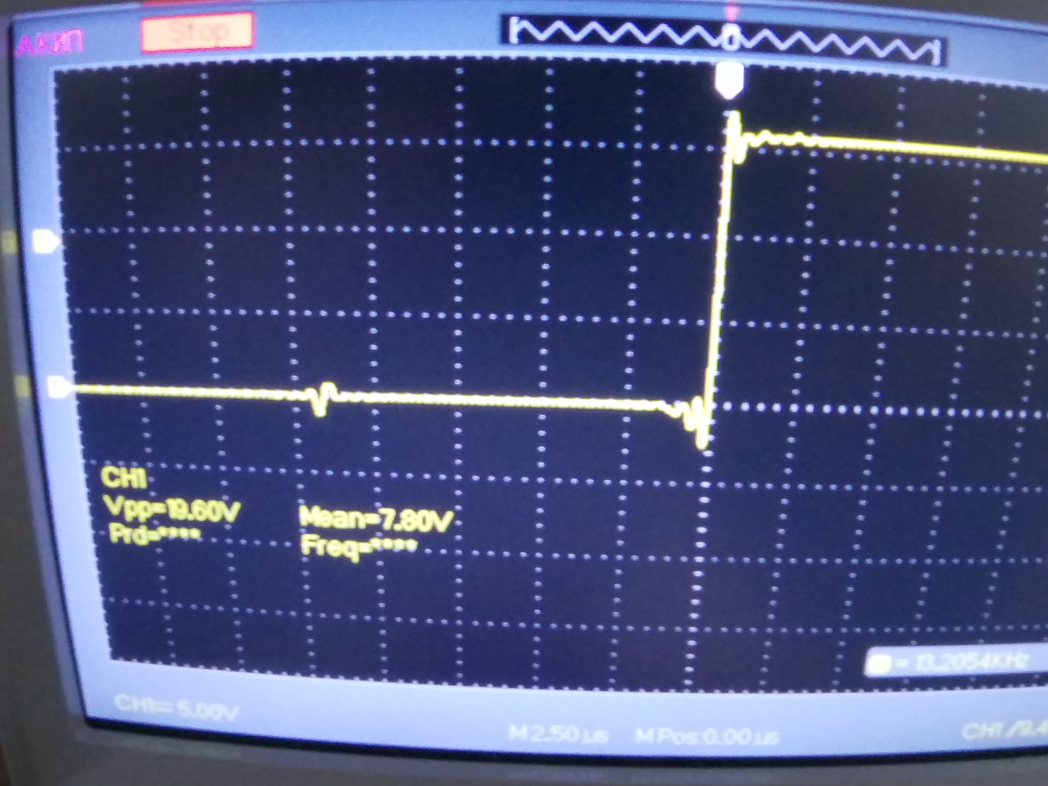

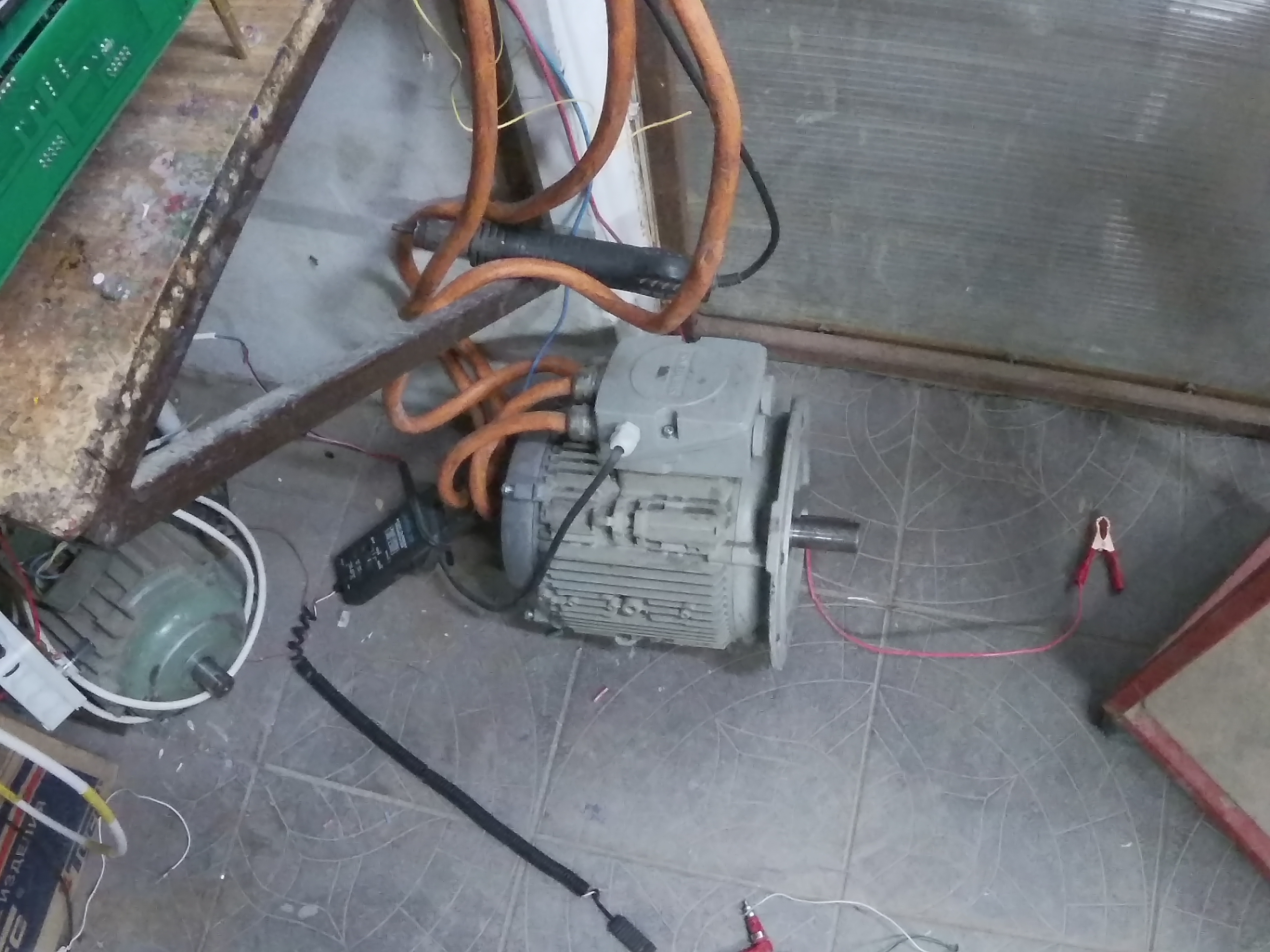

I took the signal with an oscilloscope, maybe even this is normal? But when I gave more current, it led to overheating of the transistors, one transistor in the bridge broke through due to overheating, those that are closer to the power supply are heated more than those transistors that are closer to the output terminals. I also took an oscillogram on the gates transistor, at first glance everything seems to be fine.

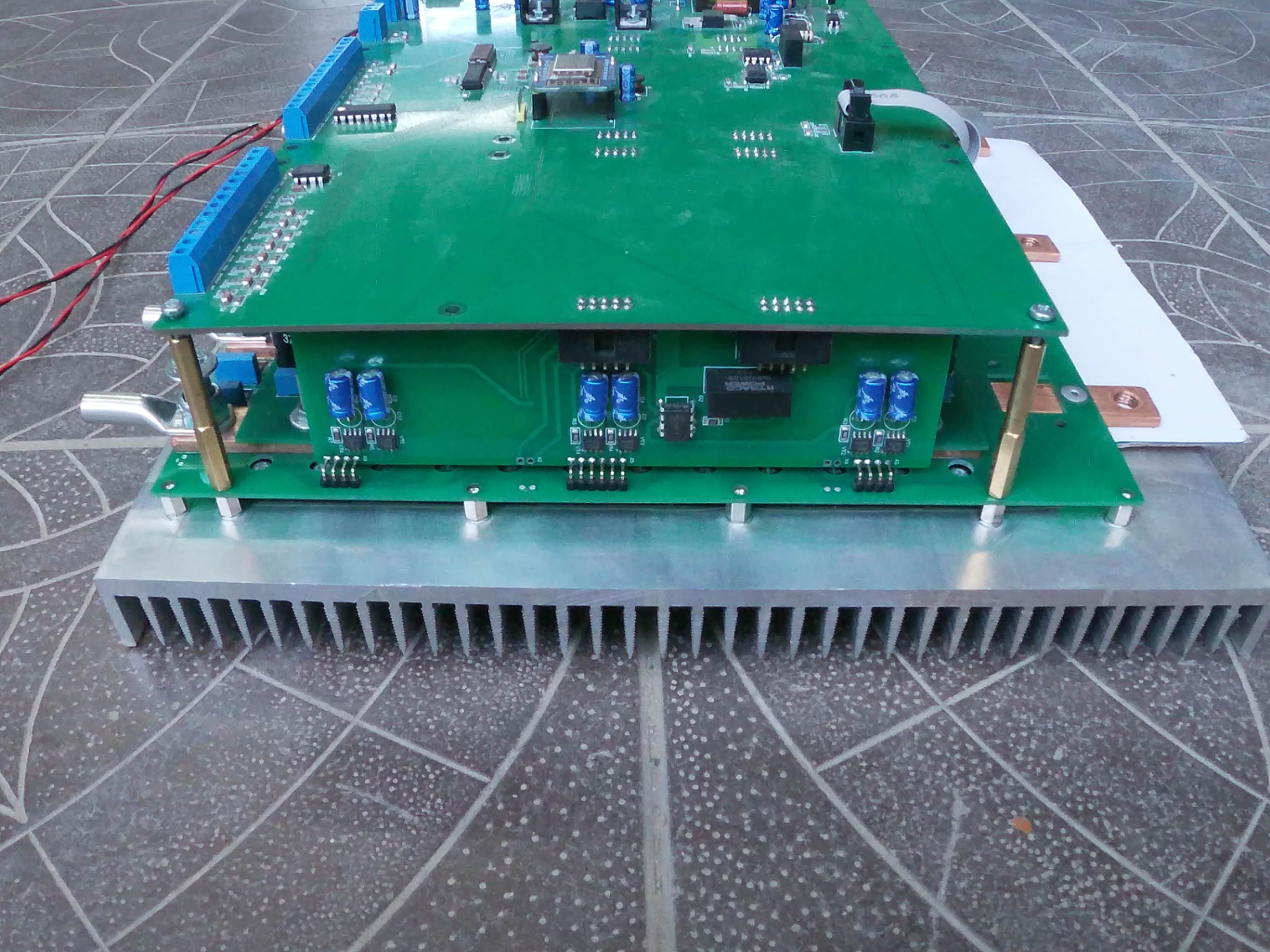

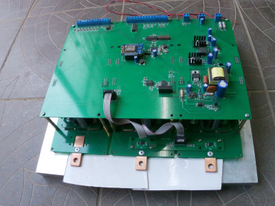

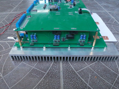

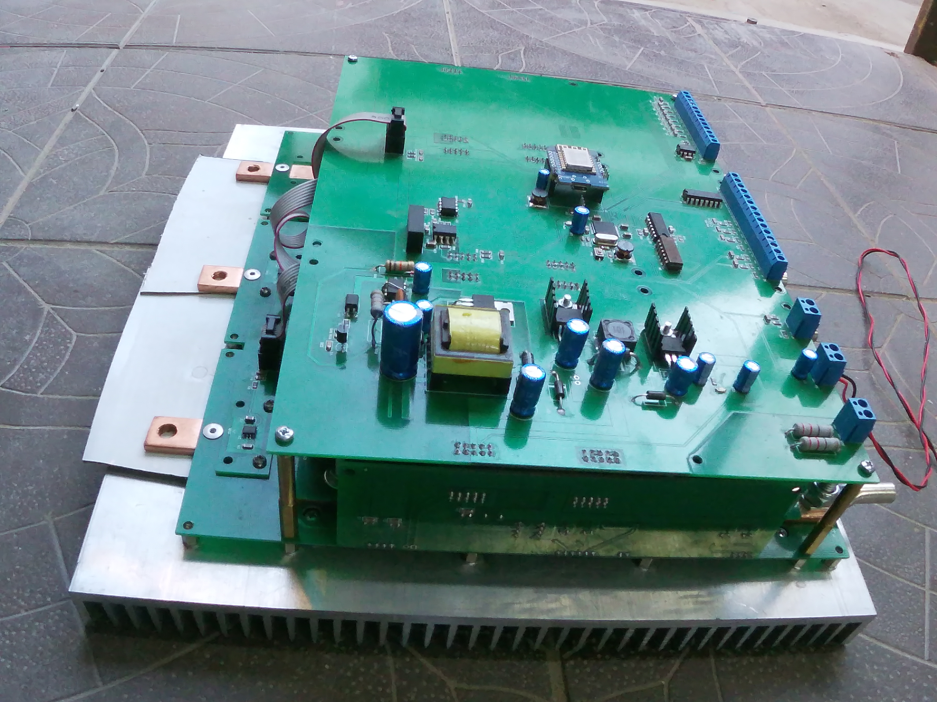

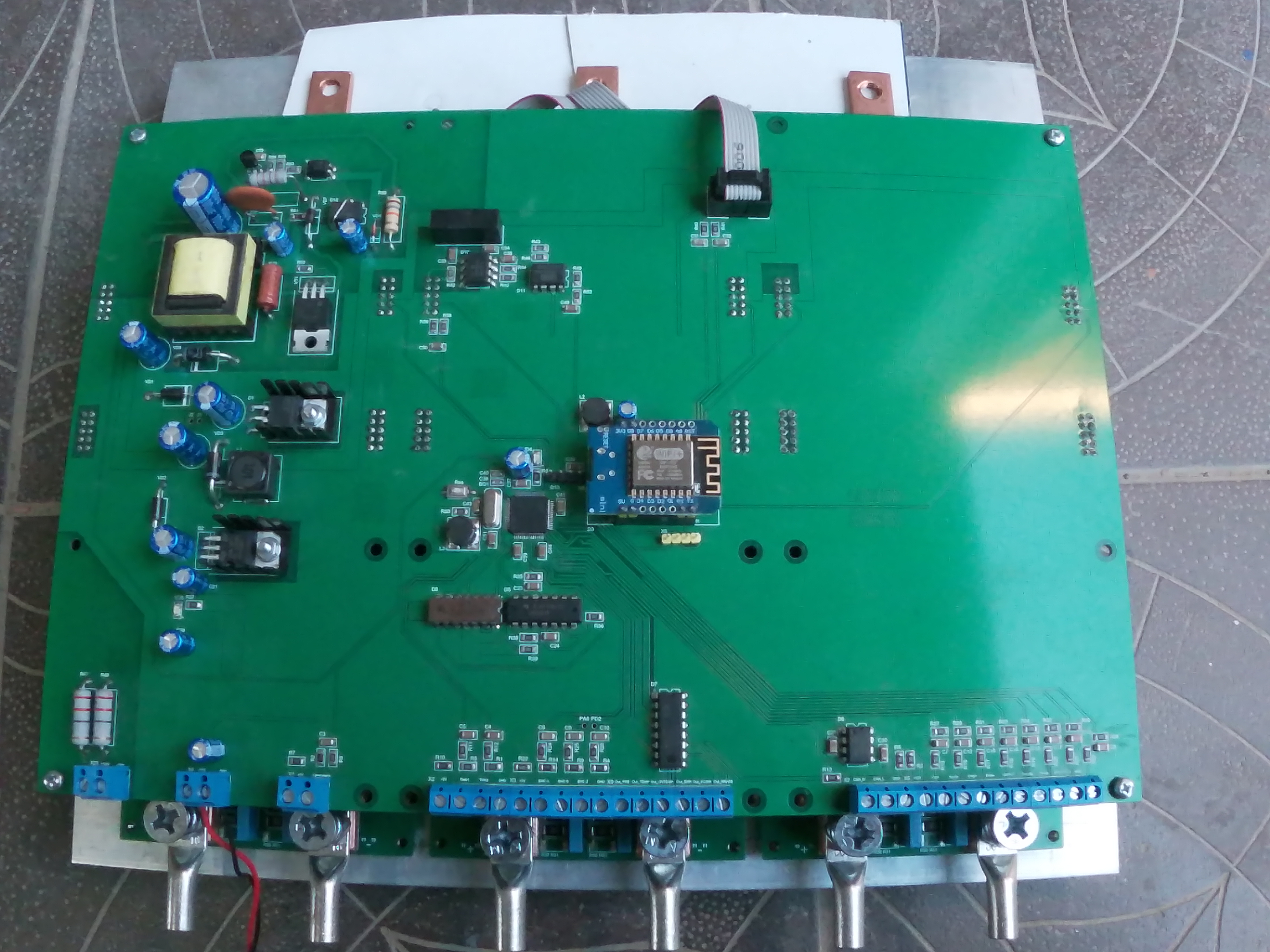

Here is the waveform itself, and the view of the inverter itself unscrewed from the radiator

Here are the signals on thHere are the signals on the gates mosfete gates mosfet
