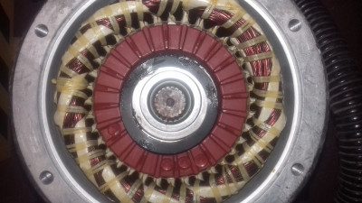

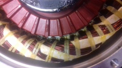

Since I have a spare motor and inverter, I took a look inside. No different to what I recall seeing inside 3 phase induction motors, but it was a long time ago and I am no motor expert. Looks like quality kit to me. Not got the rotor or phase connection end out yet tho and i wonder whether the motor is connected in star or delta? Anything else I should look at inside? - edit: looks like a Delta connection as the only terminals are the 3 that connect to the inverter directly. Makes sense to me, I guess that's the same for all 3 phase EV motors?
So far im now sure it is a 4 pole, 2 pole pair motor.
Pole pairs = 60.freq/Ns = 60.121 / 3600 or 60.305/9000. Both = 2 pole pairs.
Motor has 36 slots. The number of slots per pole & phase = 36 slots / 2 x 2 pole pairs x 3 phases = 3 (which you can see from the top)

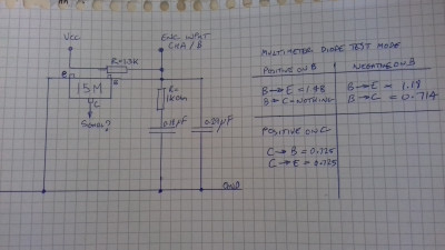

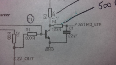

So I have been looking at the original Enova board trying to work out what it has. So far i can see a low pass filter, a pull up to Vcc and what appears to be a transistor, but i am somewhat unsure about it as to me it tests like a PNP type?
I couldnt easily find where the signal went from there, but i think i may try connecting to the Avago encoder to see what i get on this board. I would like to use the original type of encoder as i need the full 9000 rpm with the ratios i have on my car, and i note the 6000rpm limit of the Omron encoder i have.

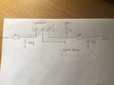

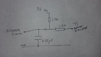

Looking at the specs of the Omron encoder you have it should work in exactly the same way as mine. The only differences I can see are that the overall size and shaft diameter are larger and yours can take a 5V-24V supply (mine’s 12-24V).
The output is an open collector so should be either ground or floating. You’ll need a pull up resistor so that the square wave alternates between ground and 3.3V (or 5V depending on your inverter board circuitry).
I’ve attached a sketch of what my encoder circuit now looks like.

Thanks Tom, might try going directly into the Olimex too.

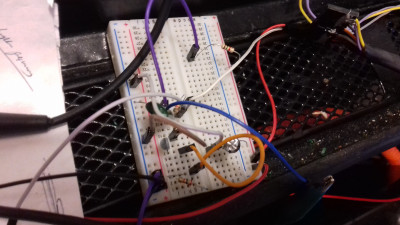

Had another go separating the encoder lines away from all the 3 phase connections and from all the inverter main boards other connections. Used 1.5k resistors and cap on encoder signal before T1 base. This appears to have reduced interference. Signal from encoder seems good shown on the handheld scope, albeit very low rpm limits, however i think i may have damaged T1 or 3.3V power supply (from the Olimex i think?) and need to replace it as the noise and fluctuation comes from at the transistor T1 collector as shown on my old scope in this video:

Good news at last. I have smooth drive much higher rpm than before - not sure how high, but my battery test wires were getting a bit warm anyhow.
T1 seemed ok via multimeter, so no idea what was causing that issue, so i decided to connect as Tom sketched and remove it anyway, the only difference i have a 1,5k pull up and 5V at encoder. Looks like mainboard version 2 encoder connection for induction motor as well from what i can see. Thanks for all the help
I will report further tests. Time for some decent batteries.

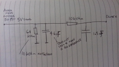

Having had the wheels spin reasonably well with car on stands, albeit not with the smoothest starting, i cant seem to get the car going well with wheels on the ground? Played around with parameters fslipmin, fmin, slipstart etc.. quite a bit and still i get encoder error, despite signal being good?as far as i know shown here:
I tried old software V.2.97 and it was similar to using the latest, thinking the old encflt parameter was reason i could drive car in the past, not so it seems.
Wondering if there is need for a pull down resistor as 0V is not being registered by the olimex, despite encoder being push pull signal? I removed a pull up to 5V using 1.5K ohm resistor from the encoder signal line and that appeared to make no difference, so i now just have a 10kOhm resistor inline to olimex and a 1.3 nanofarad cap to gnd taking the 5V signal from 50 ppr Avago encoder.
Edit - 5k pulldown on signal gives a nice smooth start, 10k helps too, but not so good. But little speed at full pot signal, so fingers crossed a play with parameters and ill get going.

getting better. No encoder error now, and smooth starting. Now have a 6.8K Ohm pull down on encoder signal, with 10 kohm inline to olimex and 1.3 nanofarad cap to ground on the mainboard.
Hoping parameter settings are the reason for such slow max speed at full throttle.

Yes filtering cap is very important here. When you have good drive allo the time you need to try the max speed too. If you filter the signal too much it may close the window for variations. You may be better off with using lower pulse count wheel. I use 60ppr just because it was easy to make on the mill. Dial 6° per cut, gives you 60 cuts per 360°.EVElvis wrote: ↑Sun Jul 26, 2020 8:44 pm getting better. No encoder error now, and smooth starting. Now have a 6.8K Ohm pull down on encoder signal, with 10 kohm inline to olimex and 1.3 nanofarad cap to ground on the mainboard.

Thanks for the help everyone, particularly arber & Tom, seems that the encoder circuit and Olimex sensing is very sensitive and needs setting up depending on what encoder signal you have in single encoder mode. I thought it was plug and play, lol. My understanding of this now is that the Olimex needs to clearly see 0V, no current for low state, then some voltage and current for high state. The push-pull signal from encoder has its limit in being able to sink current? so thats why i rekon adding the pull down 6.8 kOhm resisitor made things work ok? - 10 kOhm was too little and drive was less smooth. Better quality 5V power supply seemed to help lots with the interference i was seeing (previously used 5v off the sensor board). Better shielding and filtering probably also needed some improvement in my case too.
So far so good at a higher vehicle speed now. No more encoder errors and smooth starting
Not smooth stopping tho, but shows there must be regen working.
fweak 70, but probably could be lower with the voltage of 75V on the bus, fslipmax set to 10 made a big difference to max speed being achieved. slipstart, fmin, fslipmin played with too.
