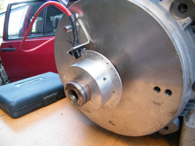

Recently i noticed an unsettling event while driving my Mazda in winter.
While at slow speed and/or in a stop with throttle released i frequently get an OC limit error and inverter stops. I can reset it immediately though even if car and motor are at RPM. After some experimenting i discovered more details.
1. This only happens at low speed or at a stop light.
2. Also this happens while throttle is released or if i just released car from braking.
3. This happens with certainty if the car was kept in cold place (parking outside)
Quriously this does not happen if i apply BMS pin and limit regen to 0 and torque to 75%.
This never happens at high speeds.
Resulting error is allways "overcurrent".
Did someone noticed such behaviour? I am concerned that now at sub 0 deg is having an influence on comparator chips inside inverter. But i know i used ones rated to -40deg.

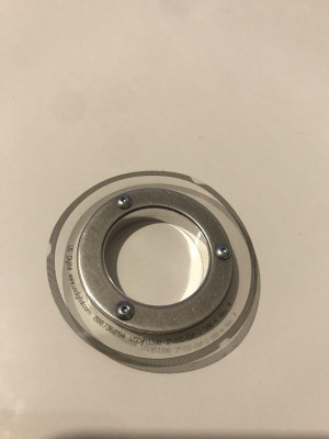

Can you monitor the speed with a data logger? Is there any spike?
I had a similar issue too. Nothing was happening at high RPMs, even at full throttle. But it was tripping at very low speeds. Later I found that it was my encoder (US Digital E6-512-984-NE-S-D-D-B).
Inside the encoder, there is a nylon disk (photo attached). It was directly coupled to the rotor shaft. Turns out that the encoder cannot go above 80+ degrees. The disk curled a bit due to the heat from the motor and after curling, due to the friction between the optical sensor and the disk, some lines on the disk were removed. As a result, it was reading momentary but huge speed spikes. Like 6500 RPM instead of 500 RPM. So I replaced the encoder and coupled the new one with a different coupler, no issues so far.

Yes, but my sensor is totaly enclosed and is automotive inductive sensor. This should mean it gets funny ticks only after signal enters the main board.
