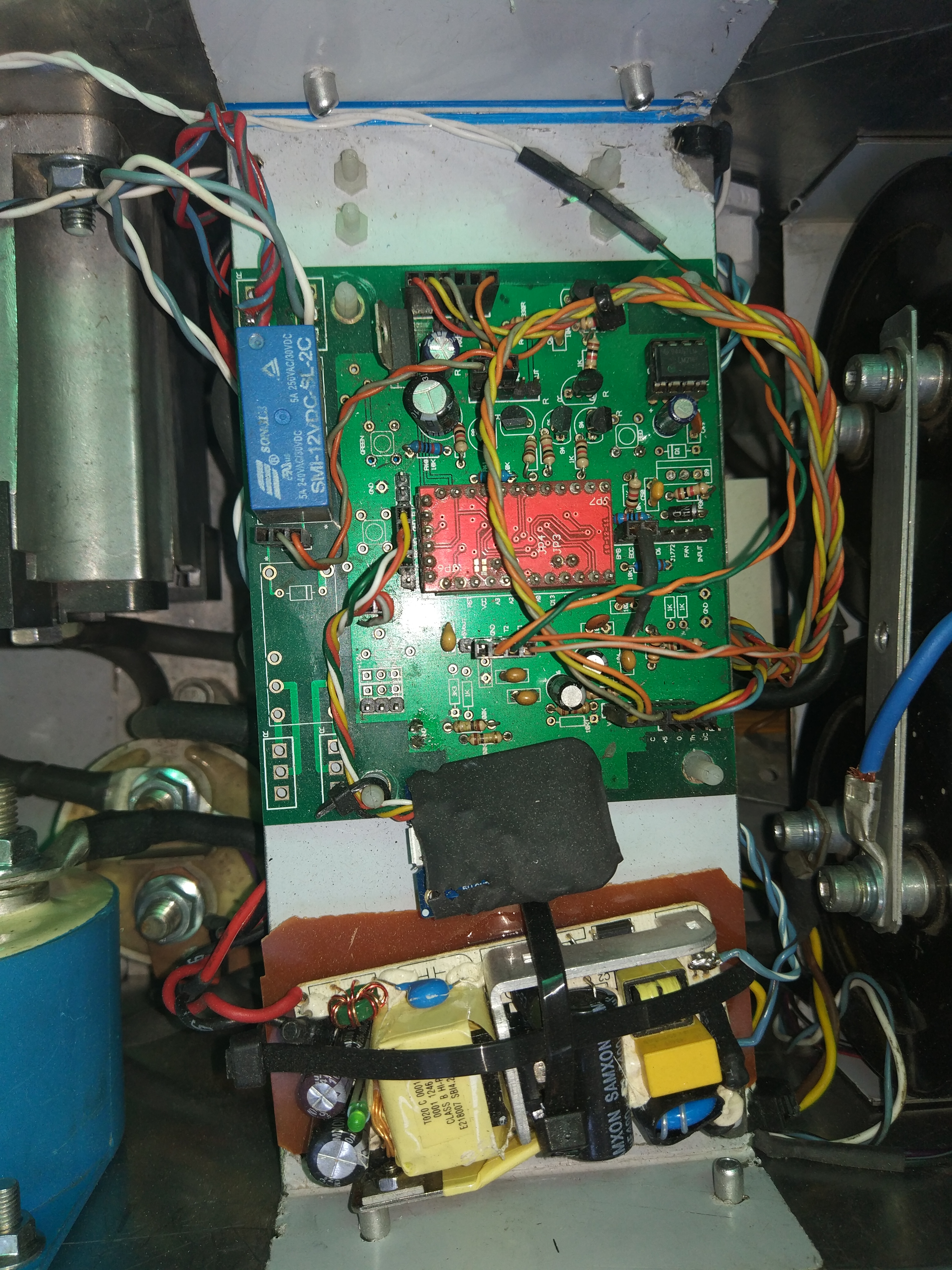

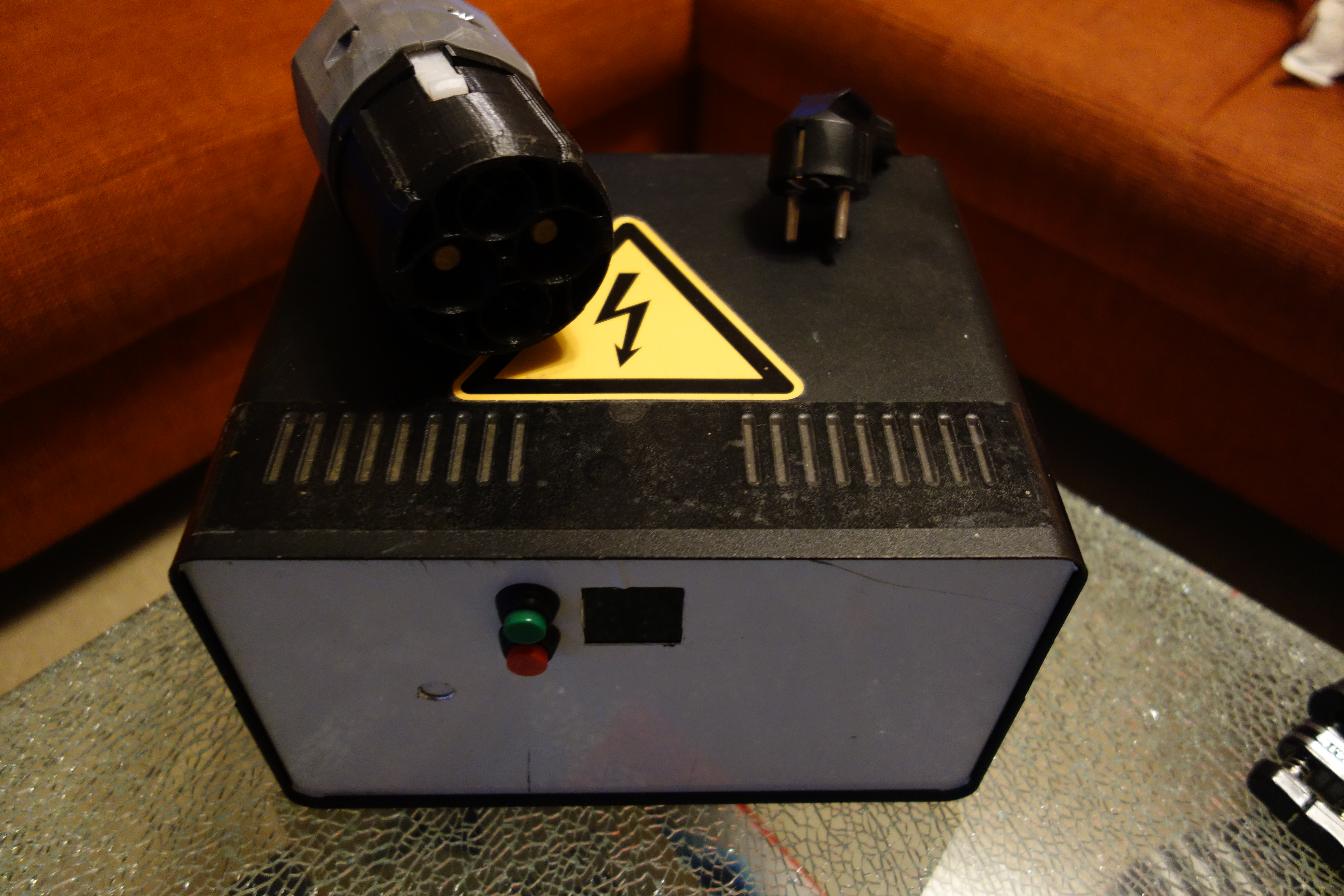

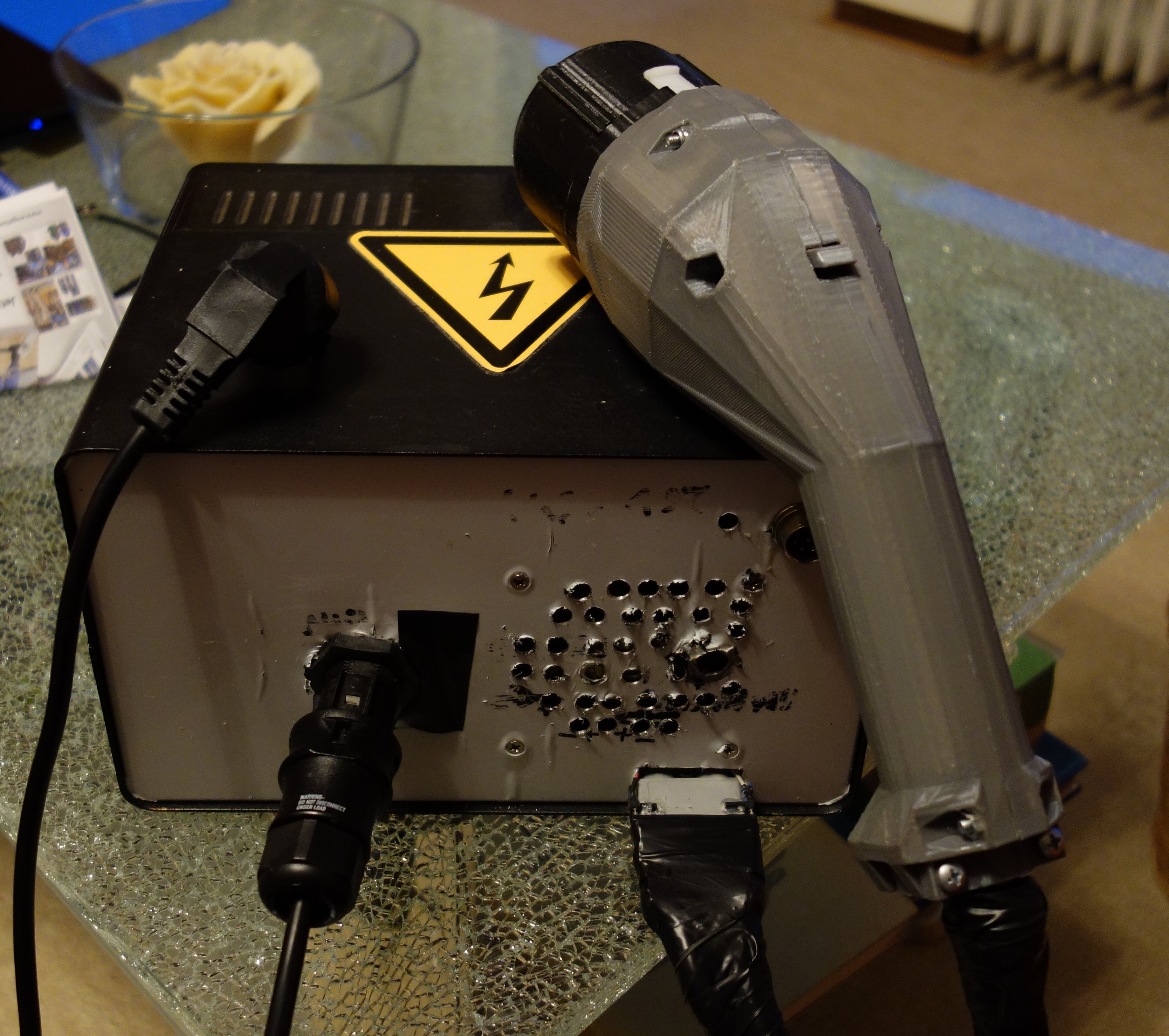

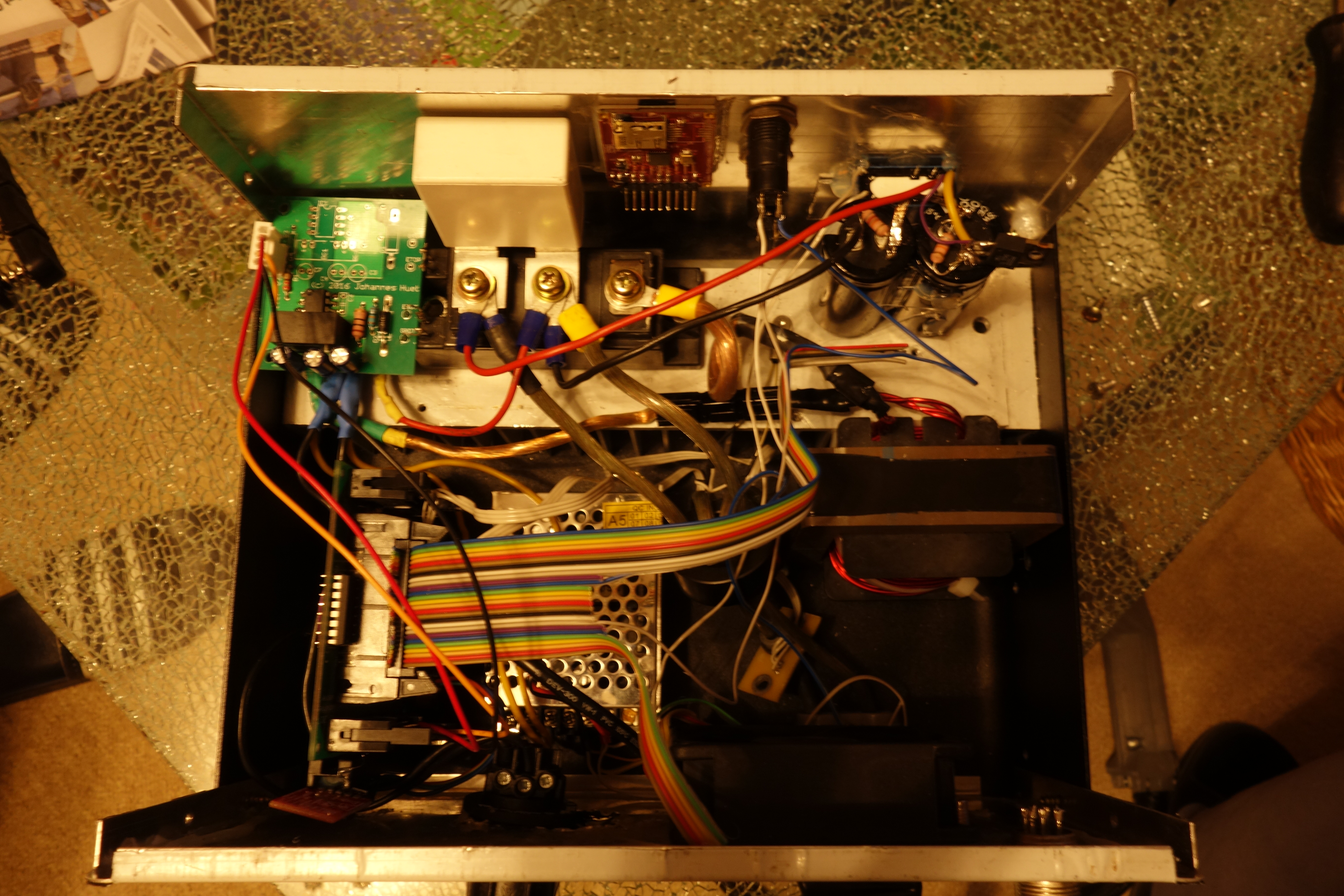

So since Touran has no built-in AC charger at all I created various hacky ChaDeMo chargers to still be able to charge it at home. On my upcoming road trip I will do some home charging where there are no 3-phase outlets. So that meant I had to create a 1-phase version as well. Power path is simple, rectifier -> booster -> cap -> output.
Let me walk you through this electric mayhem.
Ingredients
  • Metal enclosure that has to be lurking about in your basement (don't buy new)
  • Heat sink (must also be left over from a previous project - scrapped audio amplifier in my case)
  • Fan (who doesn't have multiple 80mm fans in a box of fans?)
  • Rev2 or 3 inverter brain board
  • Rev2 gate driver - half populated
  • About 50A IGBT brick (half bridge)
  • Current sensor (here: remainder of the good old EMW charger)
  • inductor (boost inductor from EMW charger)
  • Some elcaps and a precharge resistor, discharge resistor
  • elcaps (here: 2x680µF in series, so 340µF)
  • IC sockets (that are hot-glued to the Anderson connector to carry the ChaDeMo control signals)
  • Switch mode 12V power supply
Update: the IC sockets were bullshit, replaced them with a separate 7 pole connector left over from, guess what, the EMW charger.
Operation:
  1. Plug in ChaDeMo (best do this first, as the output goes live as soon as you plug in - who needs an output relay :evil: )
  2. Plug in mains, hit start
  3. The cars battery relay is closed
  4. 4s later the precharge relay is closed - this is boost mode so no use precharging to grid voltage, we must precharge to battery voltage
  5. The configured max charge current is transmitted via ChaDeMo
  6. The current command from ChaDeMo is obeyed

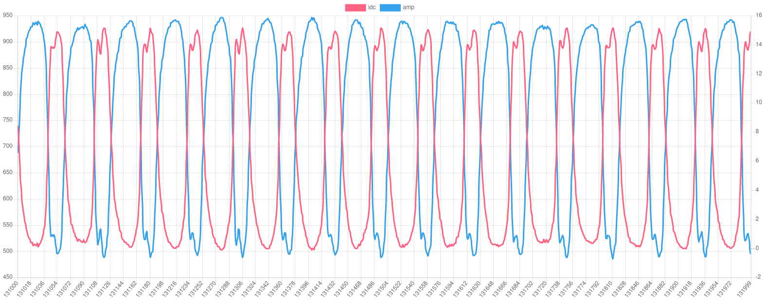

To my surprise the PI regulator makes a good effort to do some power factor correction. It boosts strongly in the "valley" and boosts just half that at the peak. According to my cheapo power meter the power factor is 0.9. I took it up to 3kW (7A average) with not much heat generated.
I couldn't be bothered to fire up the display, but one of the buttons acts as start. Stop button would be neat, actually...
If you're interested I can upload the software to github. Works the same as the inverter software. Web interface, CAN mapping and all that.
But strong disclaimer: this charger is a mayhem, it offers multiple chances to be electrocuted - don't do this at home.

Wow! That is really good PF. And the handle looks good also.

Do you have a CAD layout for the precise placement of the vent holes as shown on your enclosure? :D
Been thanked: 1913 times
Re: Poor mans ChaDeMo charger (1-phase)
I do, but thats proprietary air vortex plus technology :P
Ported the code to the inverter software today, for charge mode. Now Polo obtains a 0.92 power factor :)

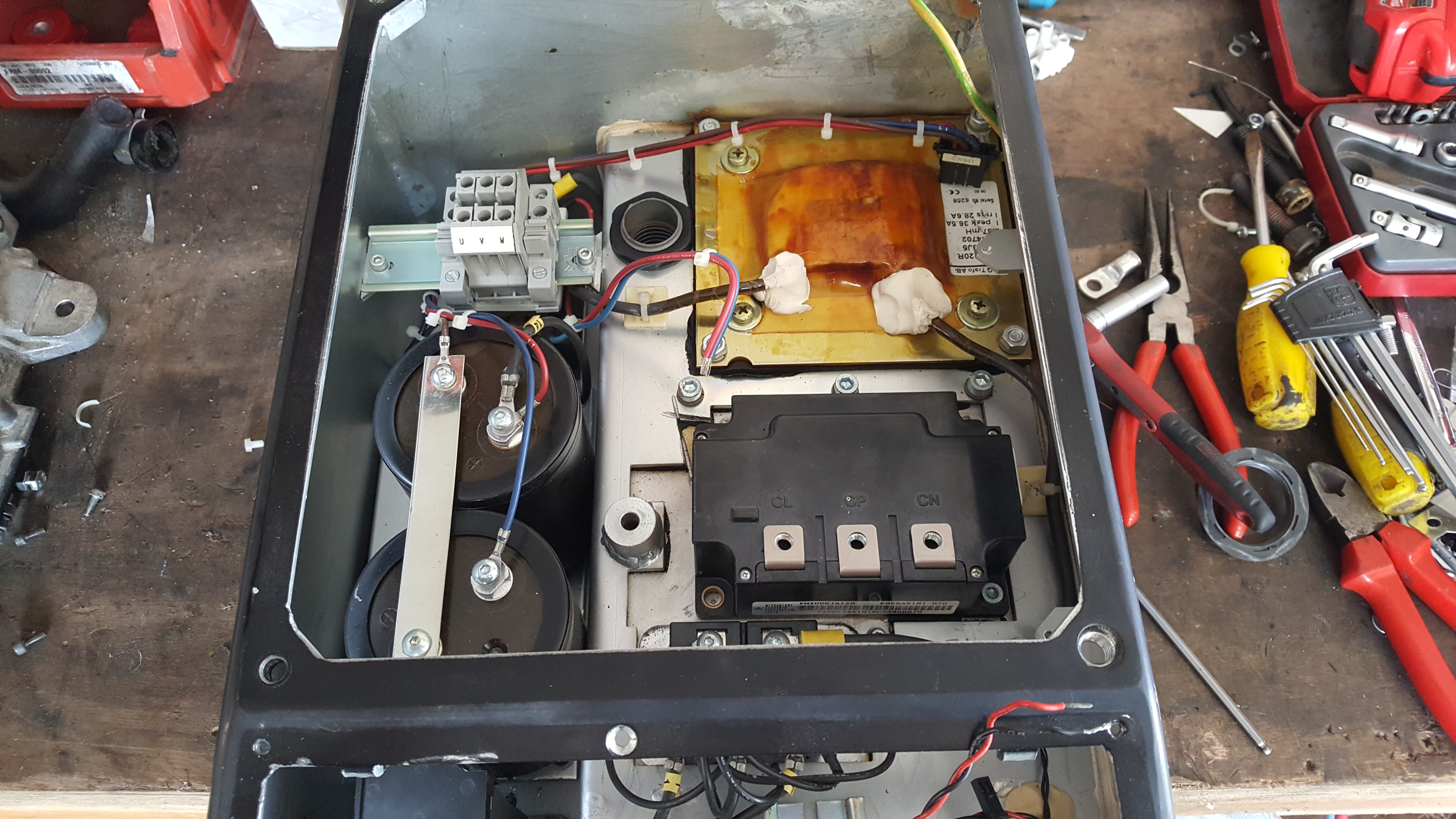

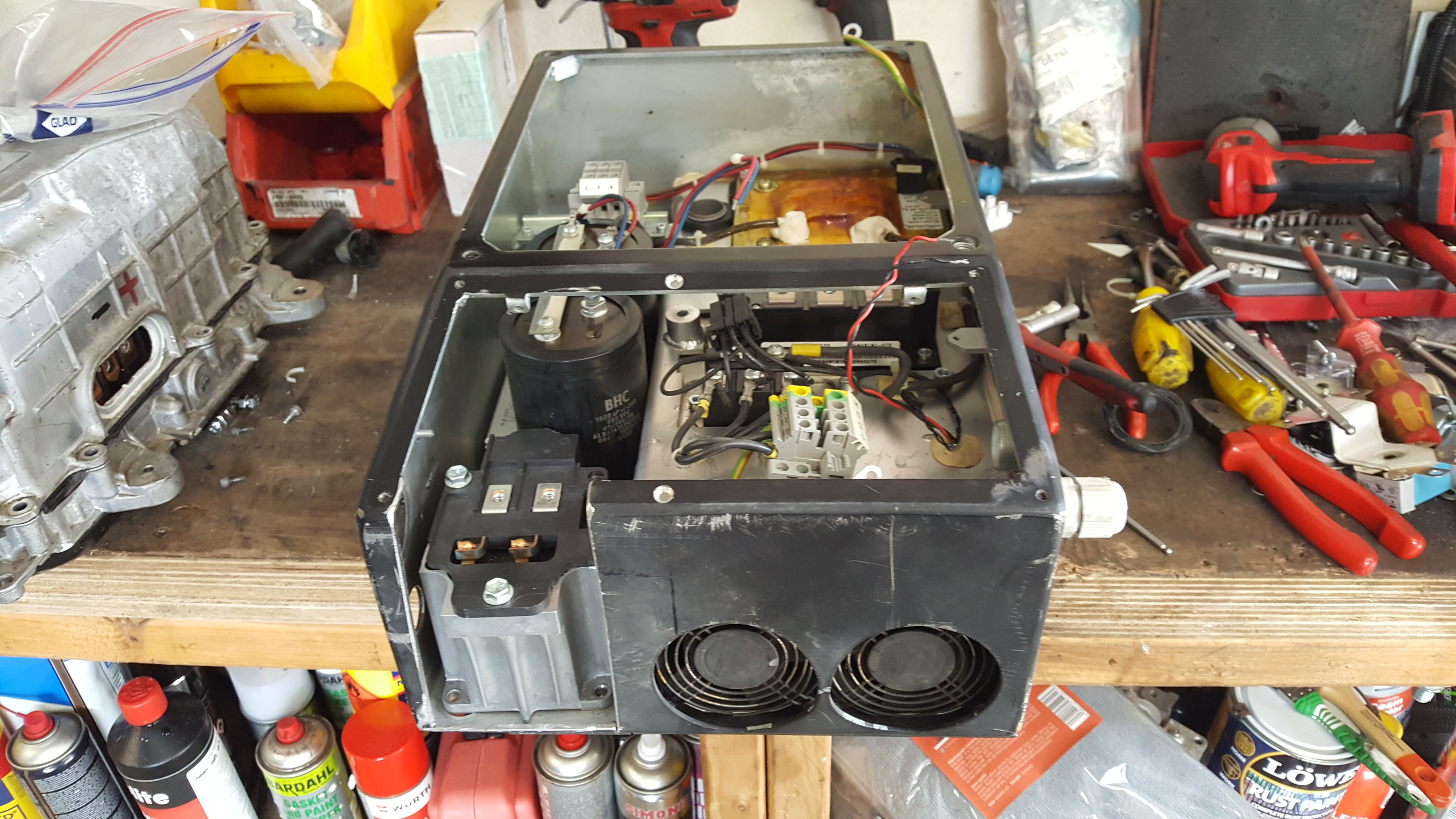

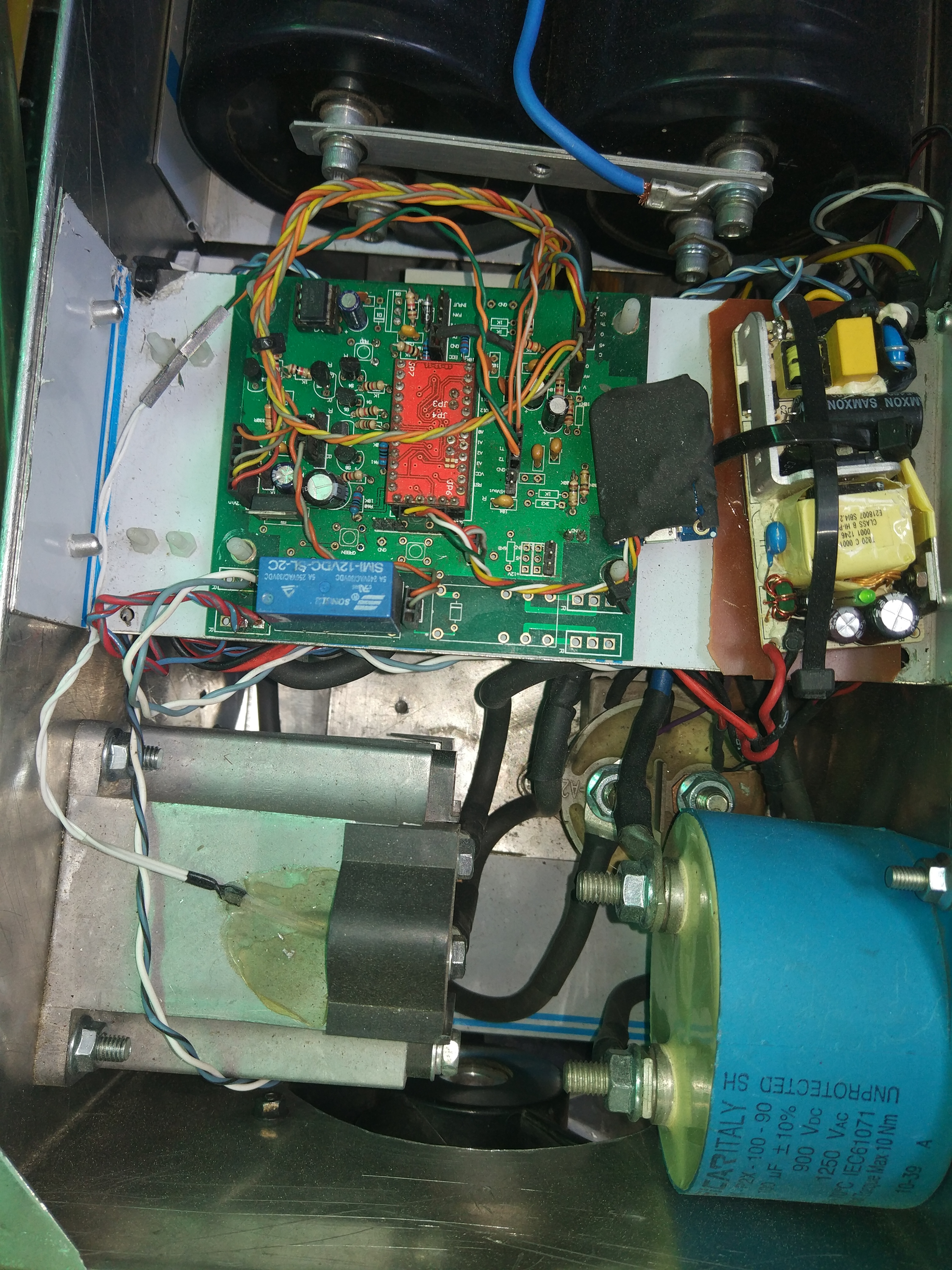

Given the restrictive nature of the licensensing of this design and the onerous requirements to use only available parts it has taken some ingenuity and legal wrangling with Johannes's high powered lawyers to get the project started. A scrap 15kw 3 phase vfd is providing most of the parts along with the inductor and buck/boost module from a gen 2 prius inverter.
I'm still unsure if this will the the poor or rich mans version so stay tuned and I will reveal as much as the air tight nda I had to sign will allow.

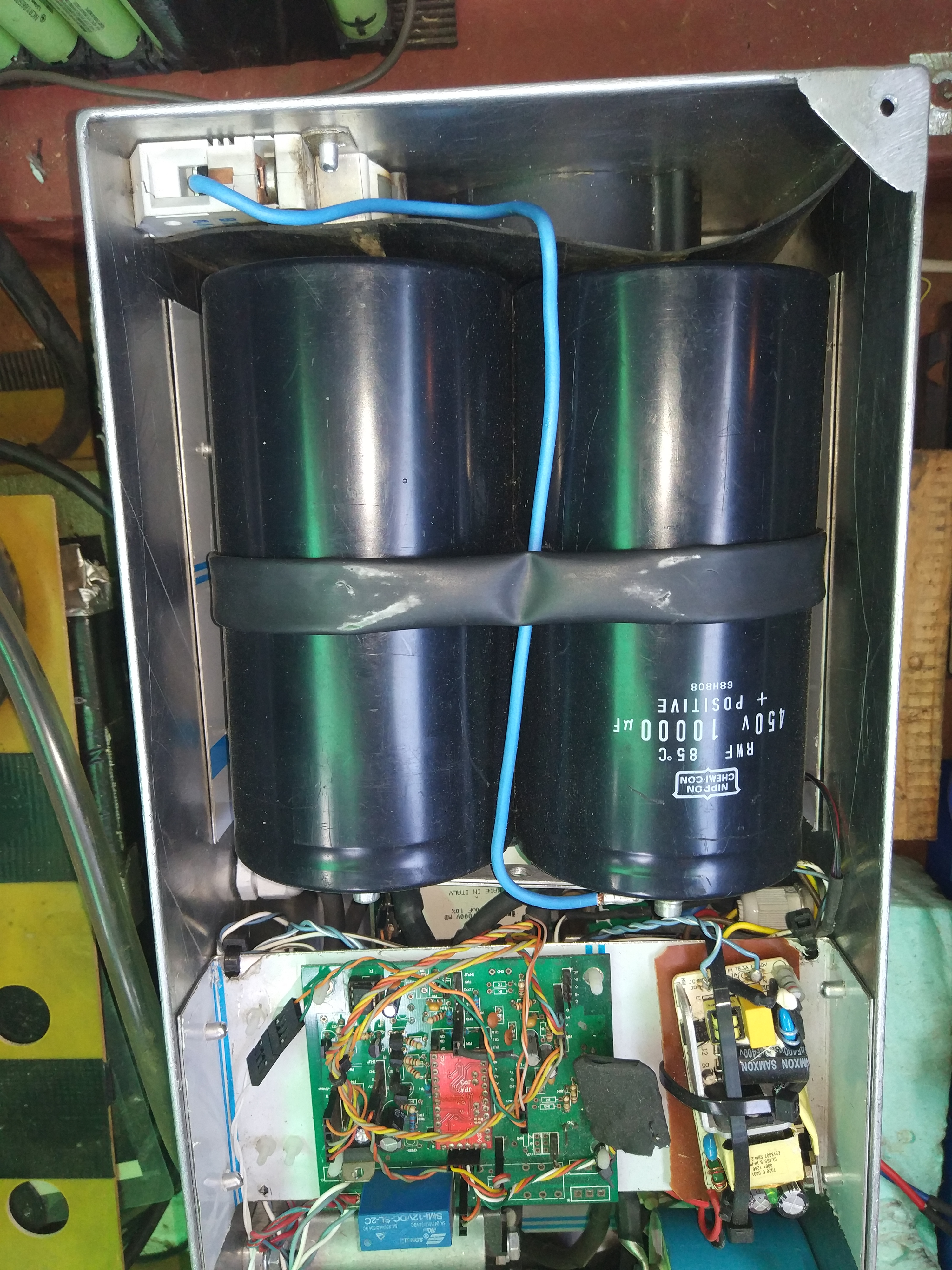

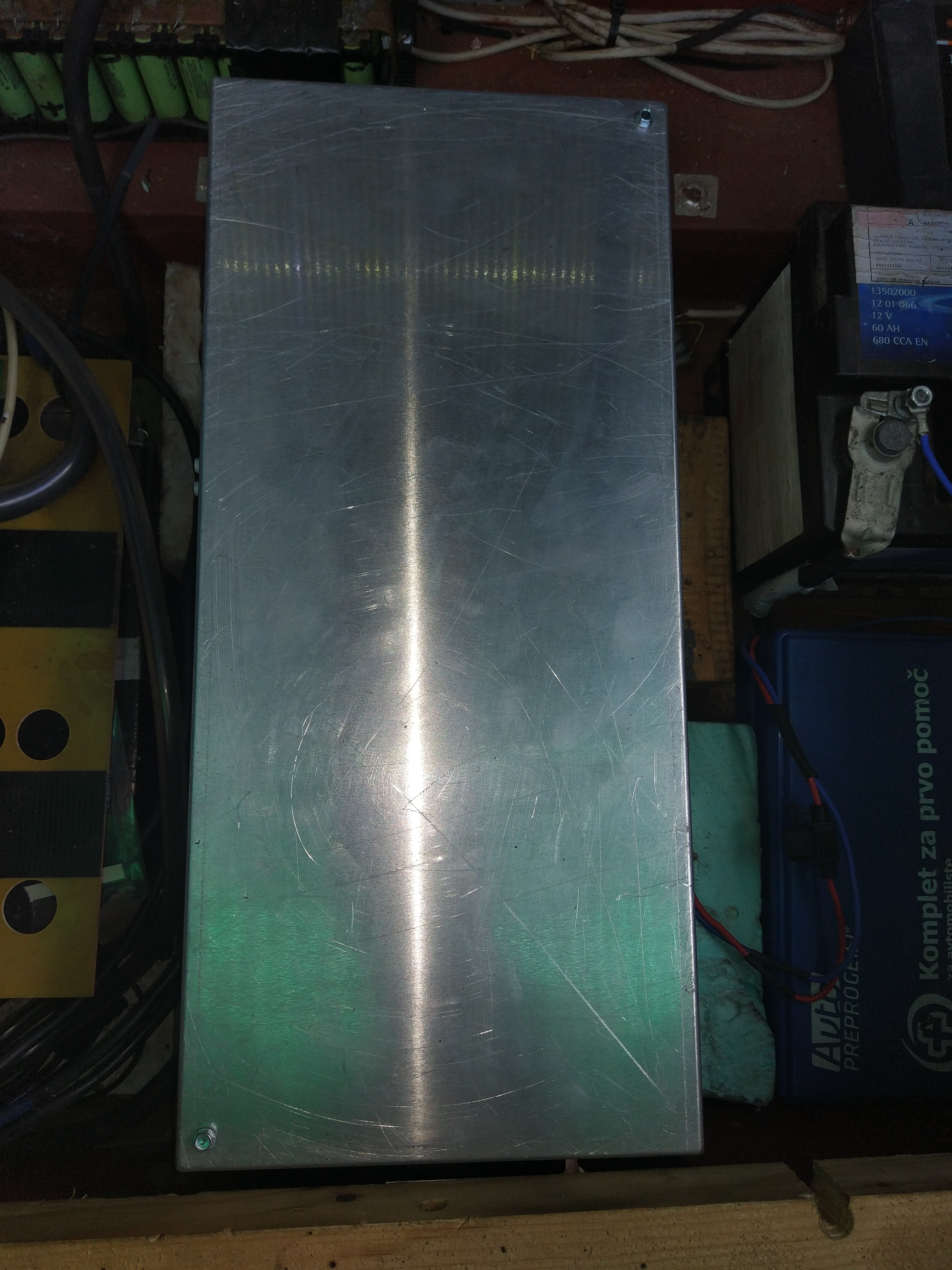

Looks like youve got some 16kW there. I recommend you add one centrifugal blower aimed at cooling fins in from the front. Also i found out Prius inductor doesnt need a lot of cooling, but i still added one fan in the back to scoop air over it.
Here is how i did it.
There is a large alu finned cooler under there. I bolt my IGBT and rectifier there. Caps are 2nd hand from a medical laser device which has strict standards so they should work in my application for some time. Of course Prius inductor bolts to the casing and is directly inside 120mm fan airflow. From the side you may notice additional 12V going directly to the battery. I didnt trust 2A supply to hold under load with heavy contactor and the powerfull fan, so i use additional power which is turned on by a small relay on the EMW board.
This is a 3phase charger and can take power from any L2 EVSE.
Notice Weimos D1 connected to EMW board. I never leave home without my Wifi friend :).
Also see the 16A autofuse which brings the N line to capacitor center tap. This allows me to charge from single phase in case of emergency. I connect 310Vdc rectified and center tap doubles it to some 620Vdc which can effectively buck down to my battery. This was a simple measure and doesnt let me to use full 3kW potential from a single phase, but is a good alternative if there is no 3phase available.
rstevens81

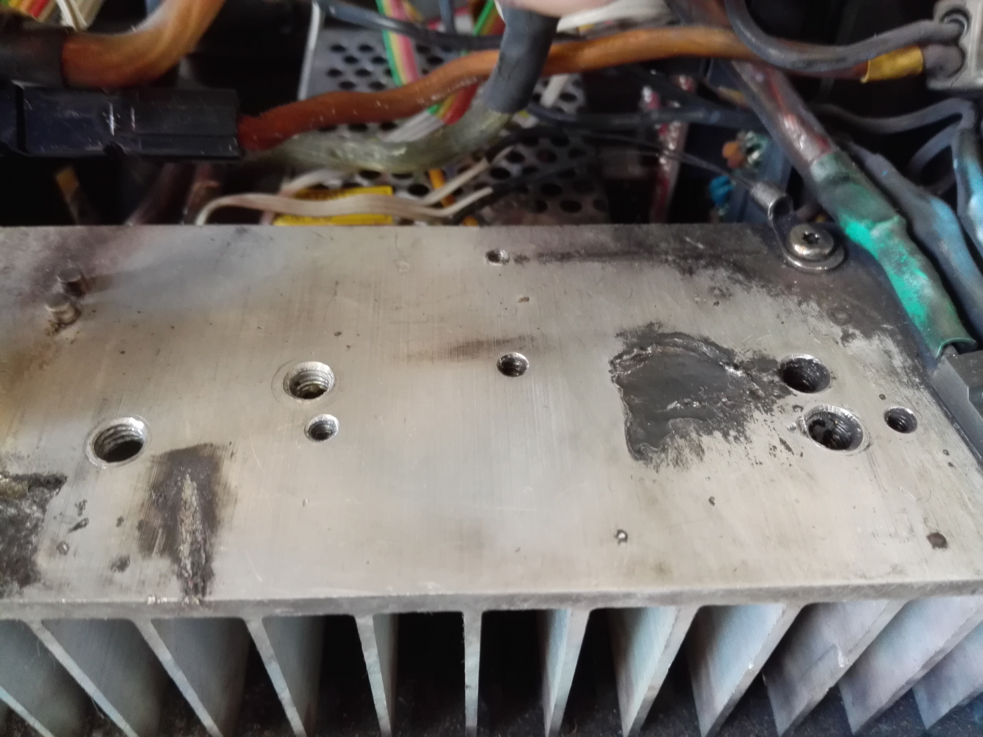

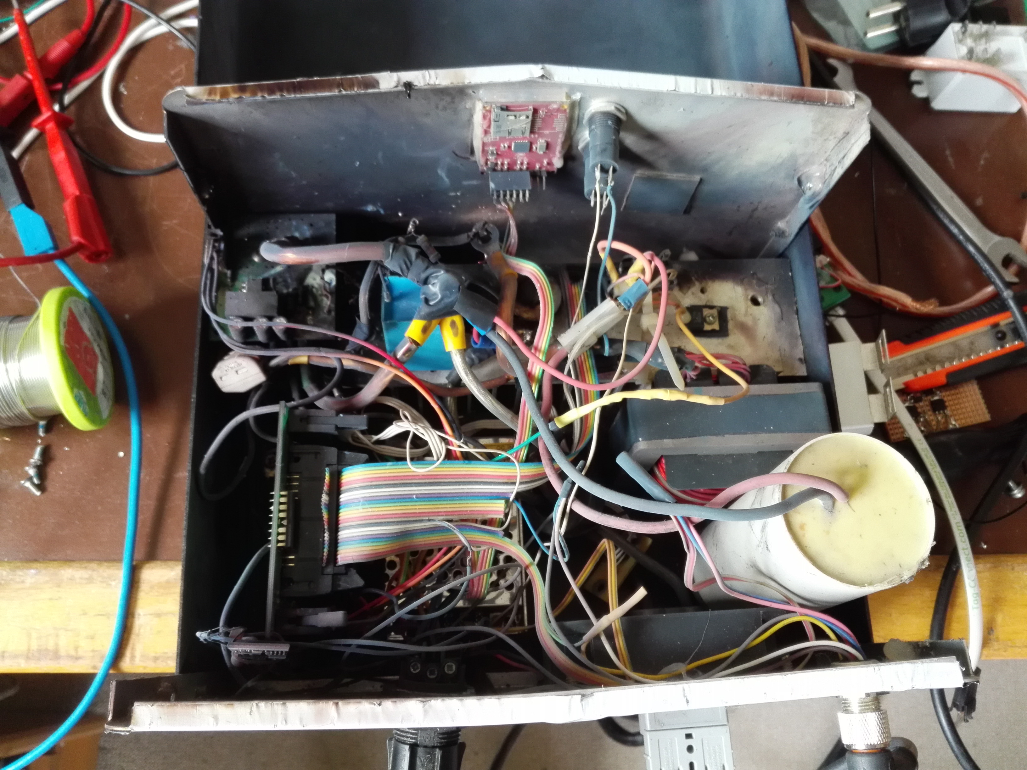

As mentioned elsewhere I overvolted the IGBT brick in poor mans charger. Since I don't have a spare one handy I thought lets just replace it with a discrete IGBT and diode. I wouldn't say this came out too well:
Anyone got a 1 phase charger left over? Just need to make it chademo compatible in some way.
update:
To my surprise the bridge rectifier has survived and the logic board seems fine as well.
Should I decide to repair this with a new IGBT brick I should be aware that it won't be cooled so well:
Some of the heatsink has been turned into plasma
