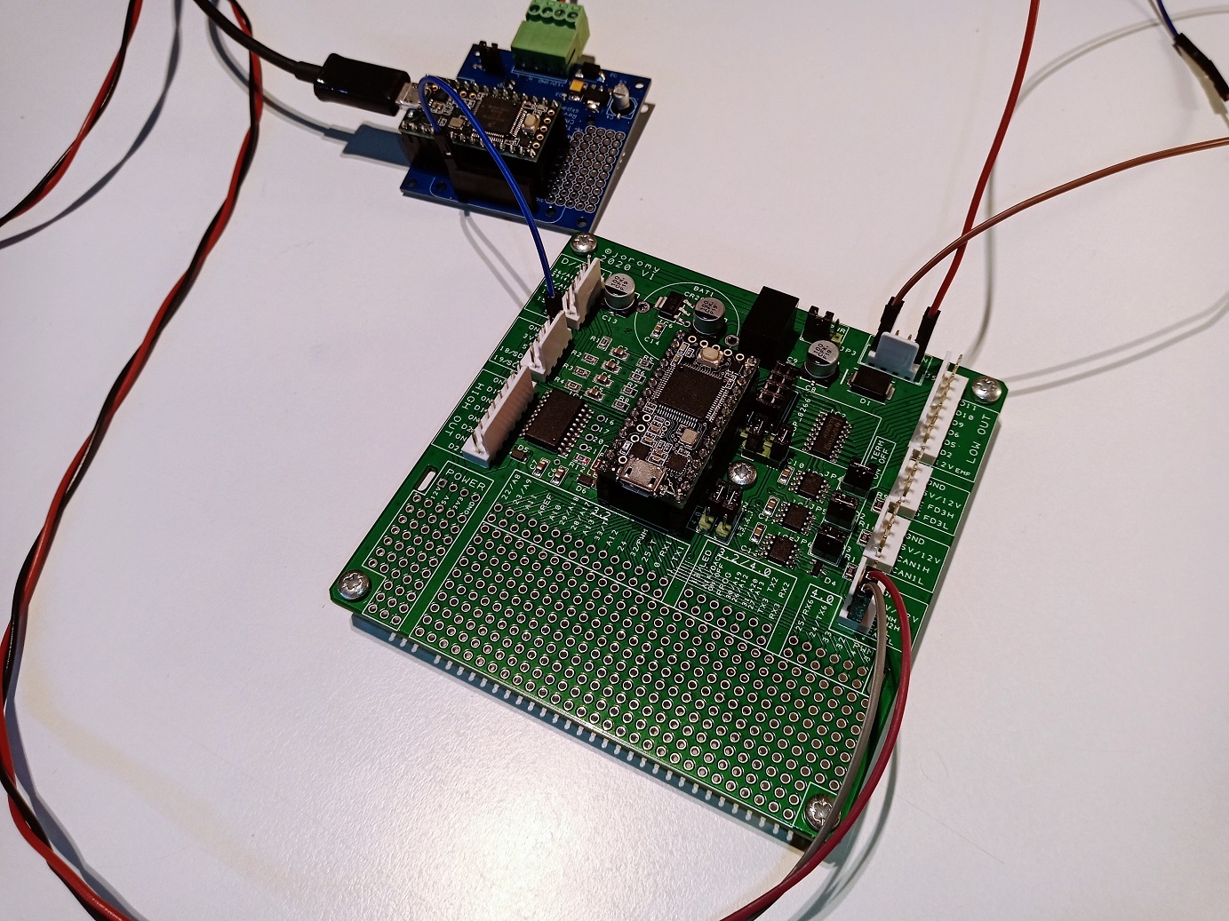

Have made a CAN bus board with high and low side drivers, overkill for the task, but then it can be used for several other projects.
Testing simple CAN bus communication between two boards:
The board will live inside the IAA module, where all the controls for the instruments are.
The IAA modulule also controls a lot of other stuff, like the cabin heater, so it will be possible to control those to. (like preheat the cabin)
The new "IAA" board will communicate with (for now, only receive) the Simp BMS, Tesla charger and the new TIM (Traction Inverter Module) and put out the SOC, ECONOMY, DTE (distance to empty) on the gauges and also some of the lights like POWER LIMIT.
So it looks like the 20 year truck will be "fully" CAN bus controlled, next up self driving......

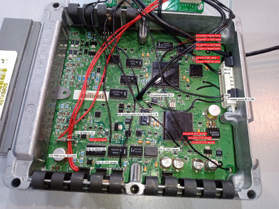

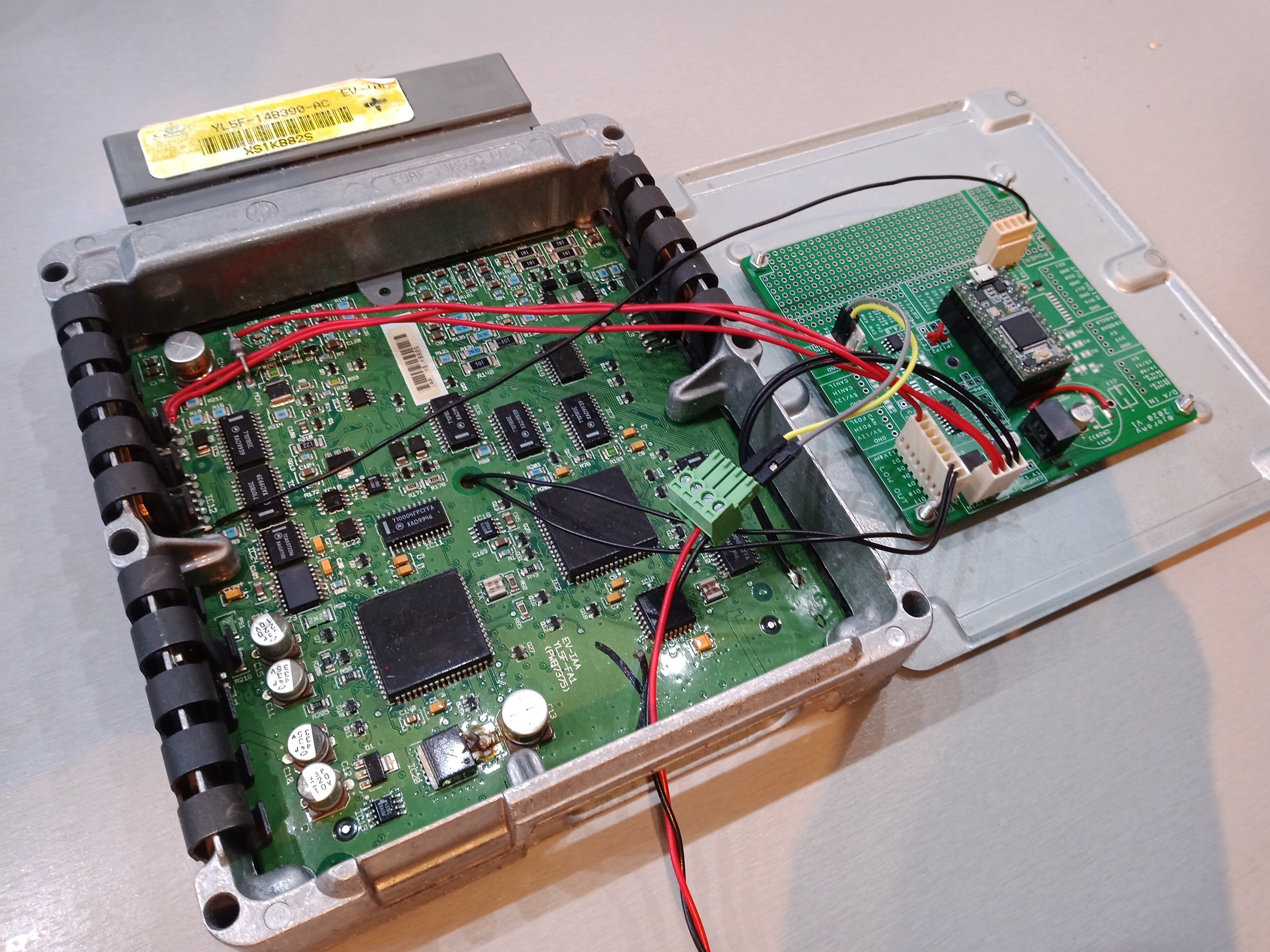

Have mounted the CAN bus board in the IAA.
Got Power Limit light and charge light to work.
DTE gauge is also working with square wave 31Hz to 210Hz (zero to full)
The SOC gauge needs PWM with POS duty from 10% to 75%, at 20kHz.

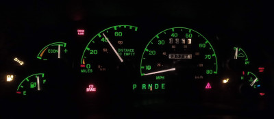

"NEW" lamp function:
EL Hazard lamp:
ON by inverter or BMS, drive not possible. Turn ON by isolation monitor, while charging.
Charge lamp:
ON while charging, blink if plugged in, slow blink if battery heating/cooling.
Power limit lamp:
ON by inverter derating or BMS. Blink if reduced regen (ABS)
MIL lamp:
ON if fault code, from iverter, charger or BMS, blink if CAN comm error.
Low SOC lamp:
ON by BMS at 20% SOC, blink at 10%.
Low oil lamp:
ON if motor oilpump has low pressure, blink if zero pressure.
The gauges have same functions as before, except for ECO gauge. This will show pos/neg power use.
The speedo is controlled directly by inverter.
The temp gauge is controlled by the IAA module, as before.

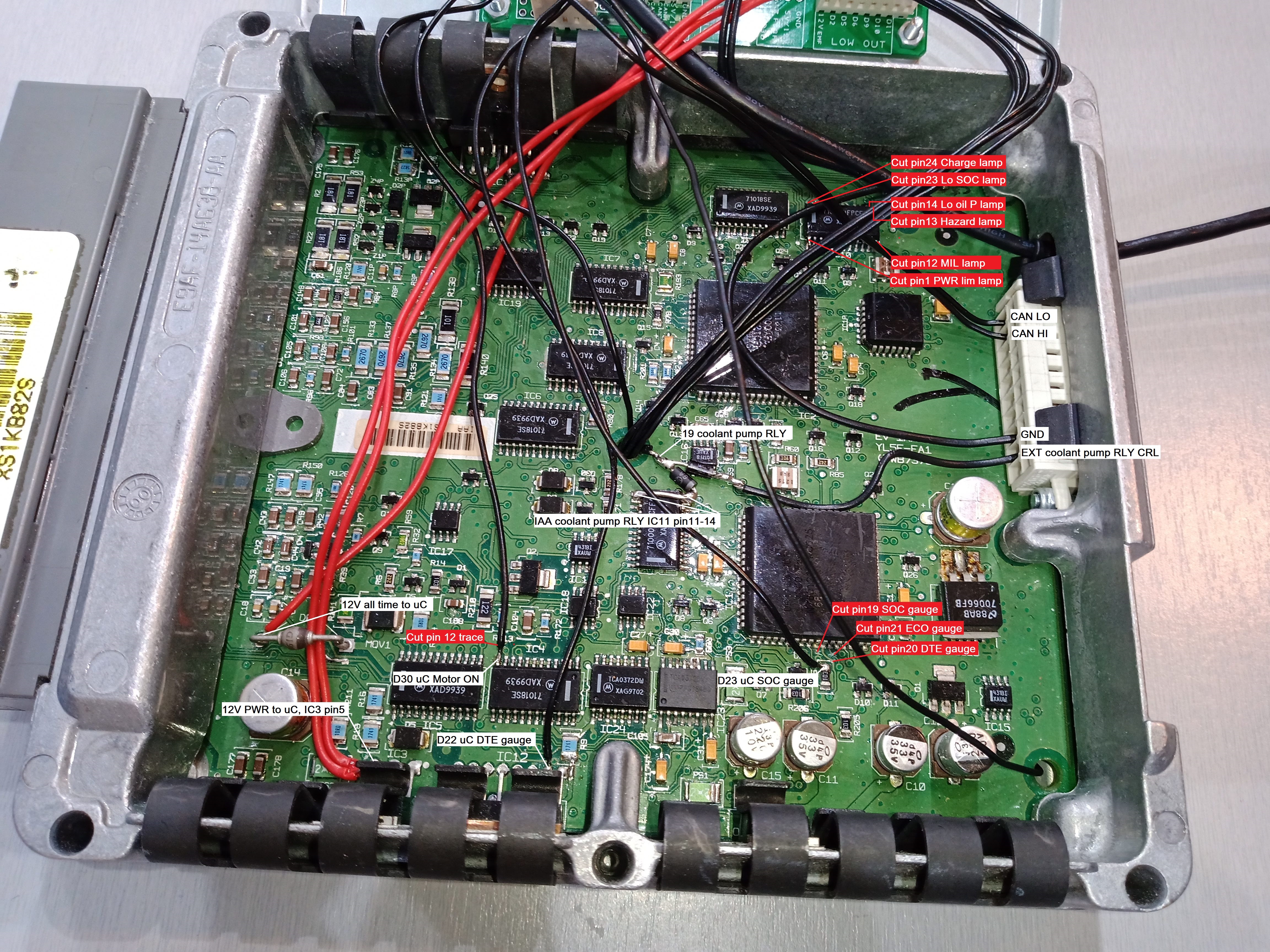

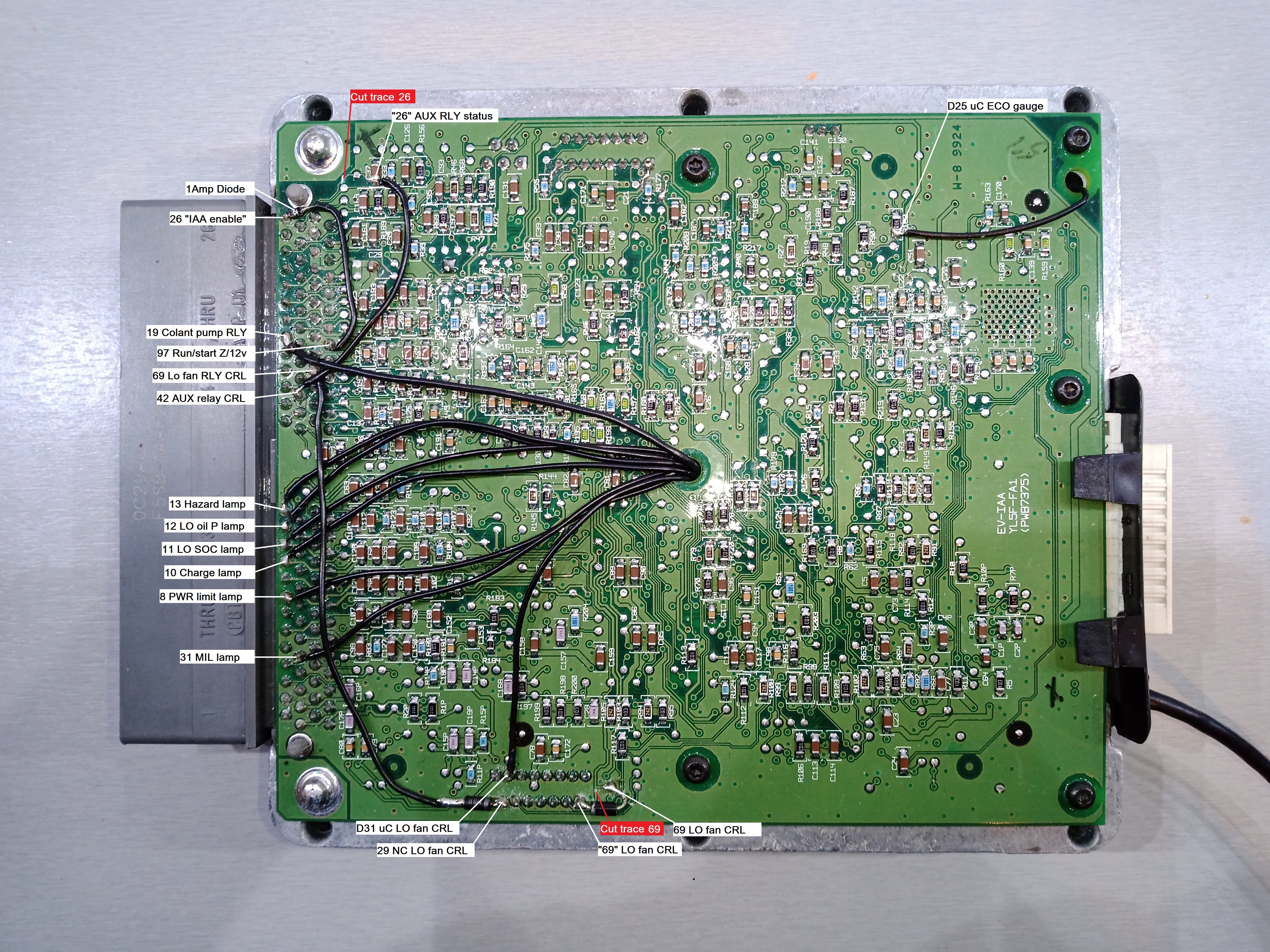

IAA to CAN bus modifications.
Water pump and radiator fan control mods, is only needed if you want to add heat exchanger and water heating/cooling of battery pack!
21-feb-20 updated pictures, now easier to mod. (do not use old ver.2)
(right click and "open/save link" to get big picture)

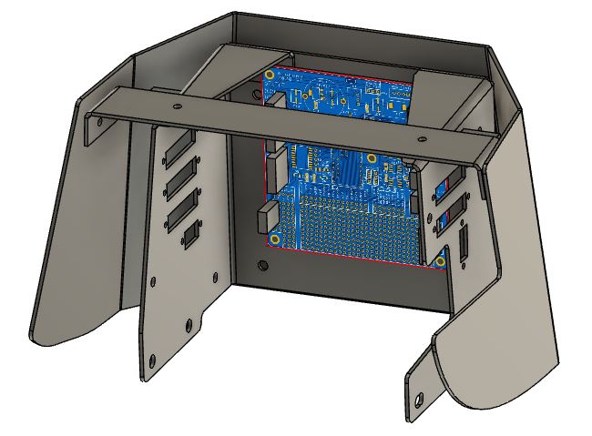

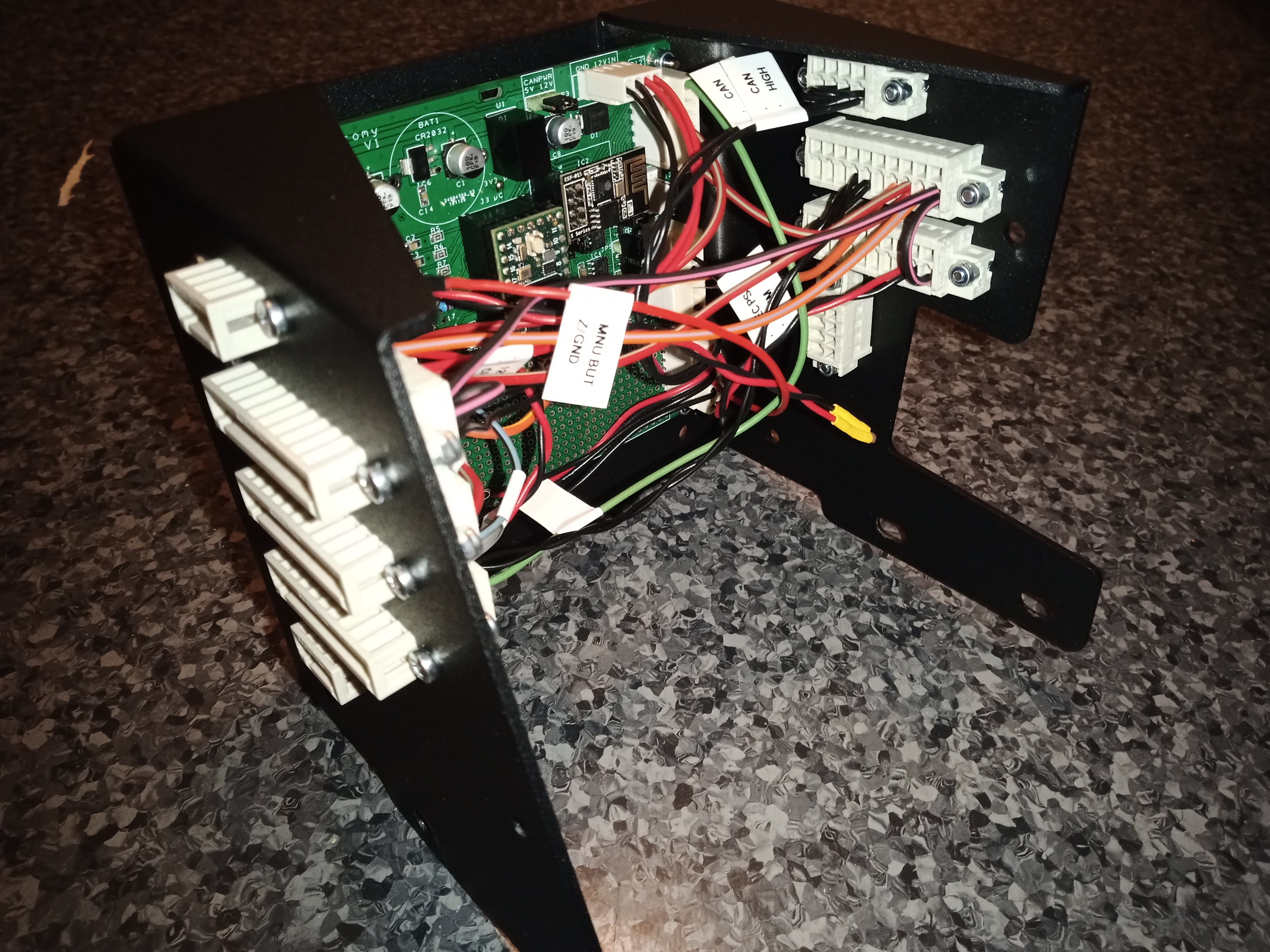

Finally I got time to install the box and cover for the main ECU (Teensy 4)
Have made a cad file, if you want to do the same.
Will only fit in the Ford Ranger, without drilling, using existing fixing holes.
Can make it and powder coat it for you, if you don't have equipment to make it.

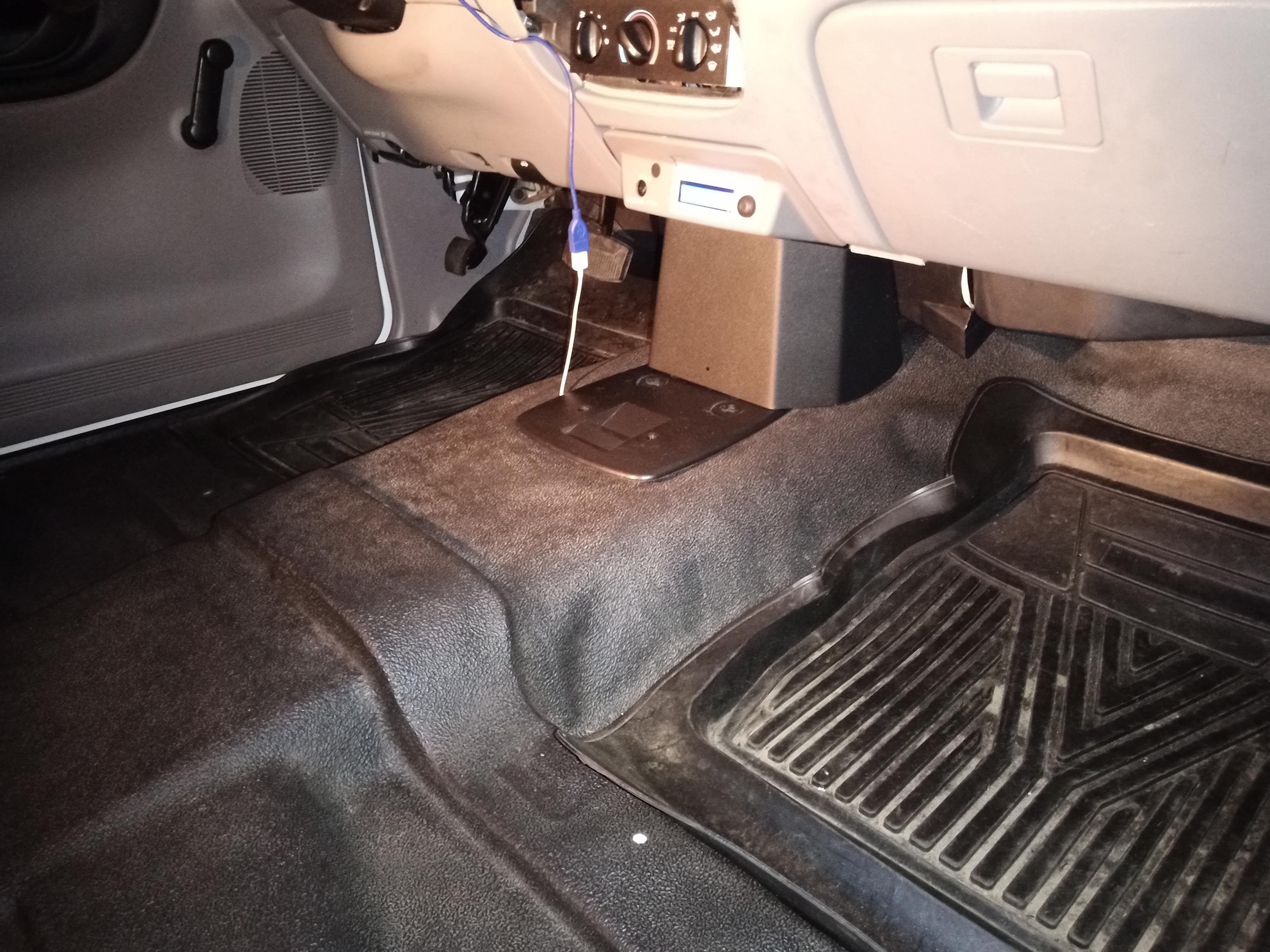

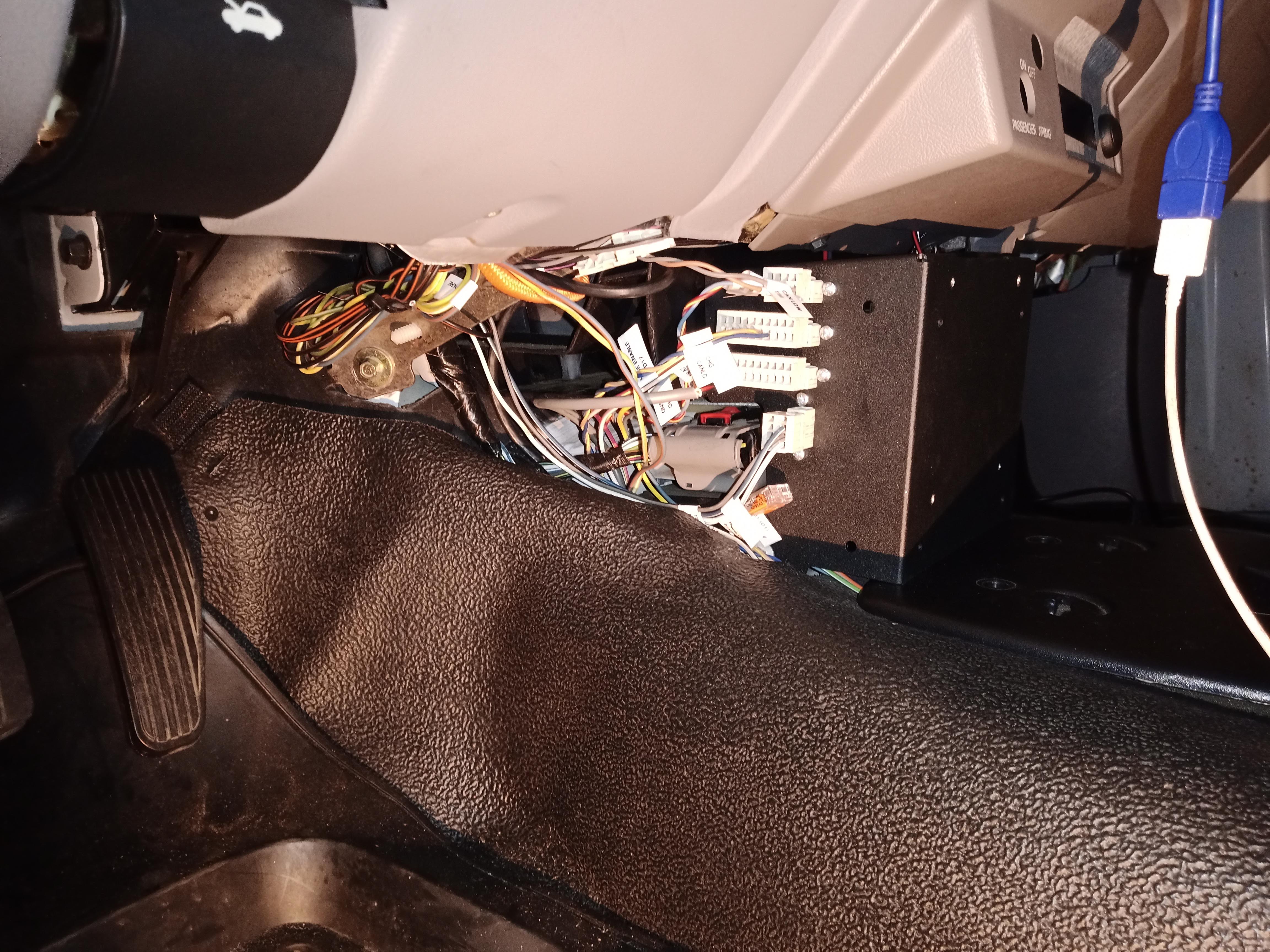

There are room for connecting more stuff.....
Easy access to connectors, without the cover.
Finished, all cables fixed, just put the seats back in.

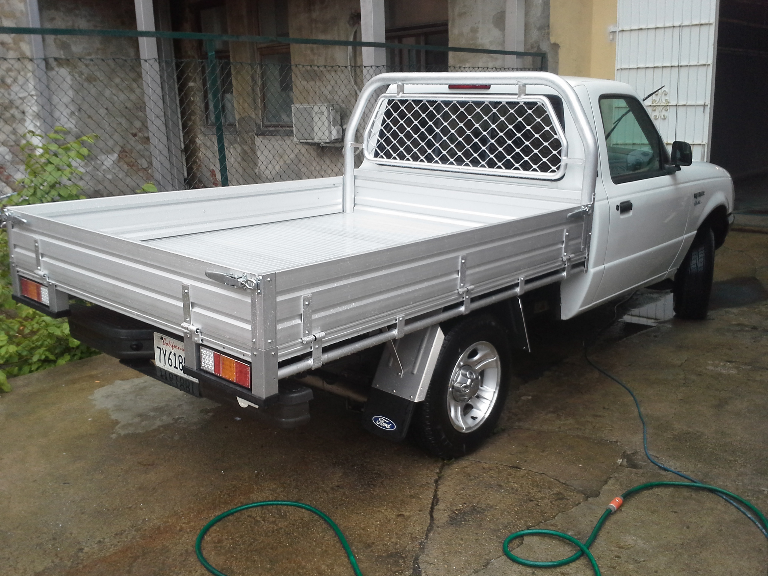

This was a OEM compliance car, result of the California emission legislation.
Its a 1999 model. with only 33k miles.
The instruments are original. Are trying to keep everything to look original.
I don't understand that this is not more popular in the UTE countries.... :)

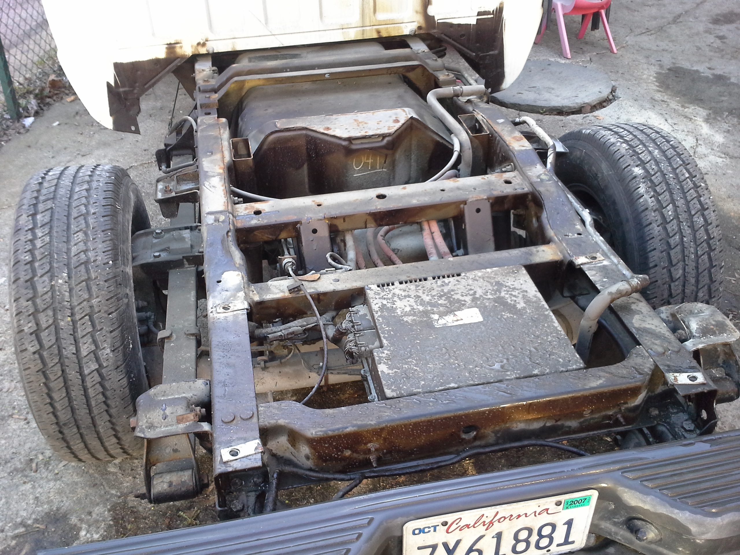

This tray was only on a few special build models. I also managed to get the first Postal version of this truck, I think there where only build a few of them.
The instruments are not originally CAN bus, that's why i modified it to CAN.
I have a truck for sale if interested, without batteries and motor/inverter.
Was thinking to fit it with a Tesla drivetrain, but time and money...
This is a perfect truck for battery upgrade, since it has a huge battery box.
viewtopic.php?f=16&t=226#p3385
And "easy" to fit a Tesla motor since it already have the fixture for the Siemens motor. Lots of room for the drivetrain.

The IAA module is originally controlling the instrument cluster, and a lot of other tings like cabin heat radiator fan.
I think it's called IAA module in Ranger ICE truck to.
But many of this functions will not work when the original BCM (BMS) is removed.
That why I made the Teensy board.
