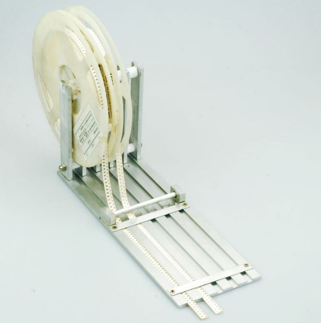

The pick and place is most time consuming.
Just ordered some manual trays, only EUR 11 from aliexpress.
Paste one board only take 20 min.
Heating the board on hotplate and using gun, works great. It's very therapeutic to see solder melt around the components.
I will consider other methods/equipment if the sale take off :)

I'm with Johannes on the stencil and oven. Stencils are cheap, quick to setup, and even quicker to use once setup and give nice consistent results.
I use a cheap toaster oven with my own controller (code now on github) which will cook as many boards as you can fit in a couple of minutes. Placing components is the biggest pain especially with my eyesight.
