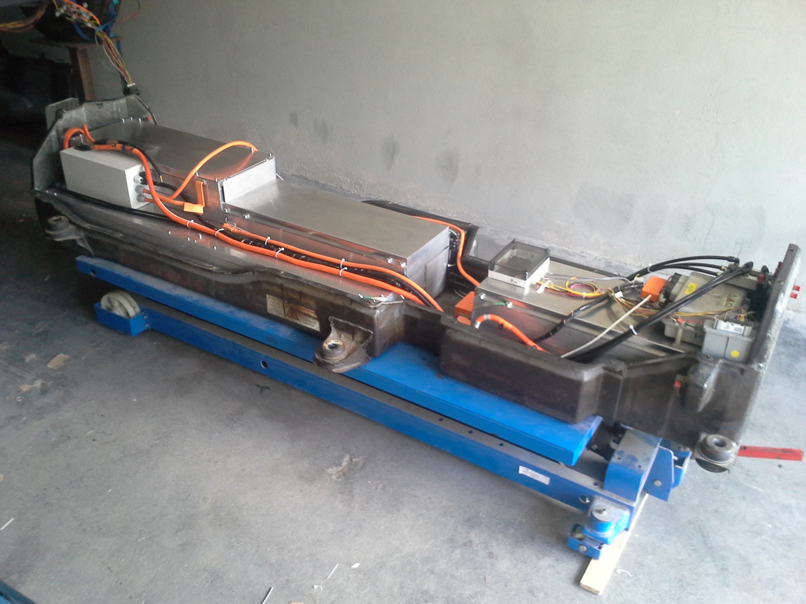

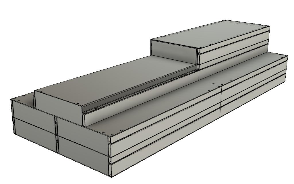

Made 3D model of the aluminium frame for the battery modules.
It's made of standard aluminium square tube, 15x50mm and 15x25mm for side. And 20x80mm for end.
It's 11 modules in the back and 3 in front.
Step file:
Tesla_pack_assembly v2.zip
(1.63 MiB) Downloaded 795 times

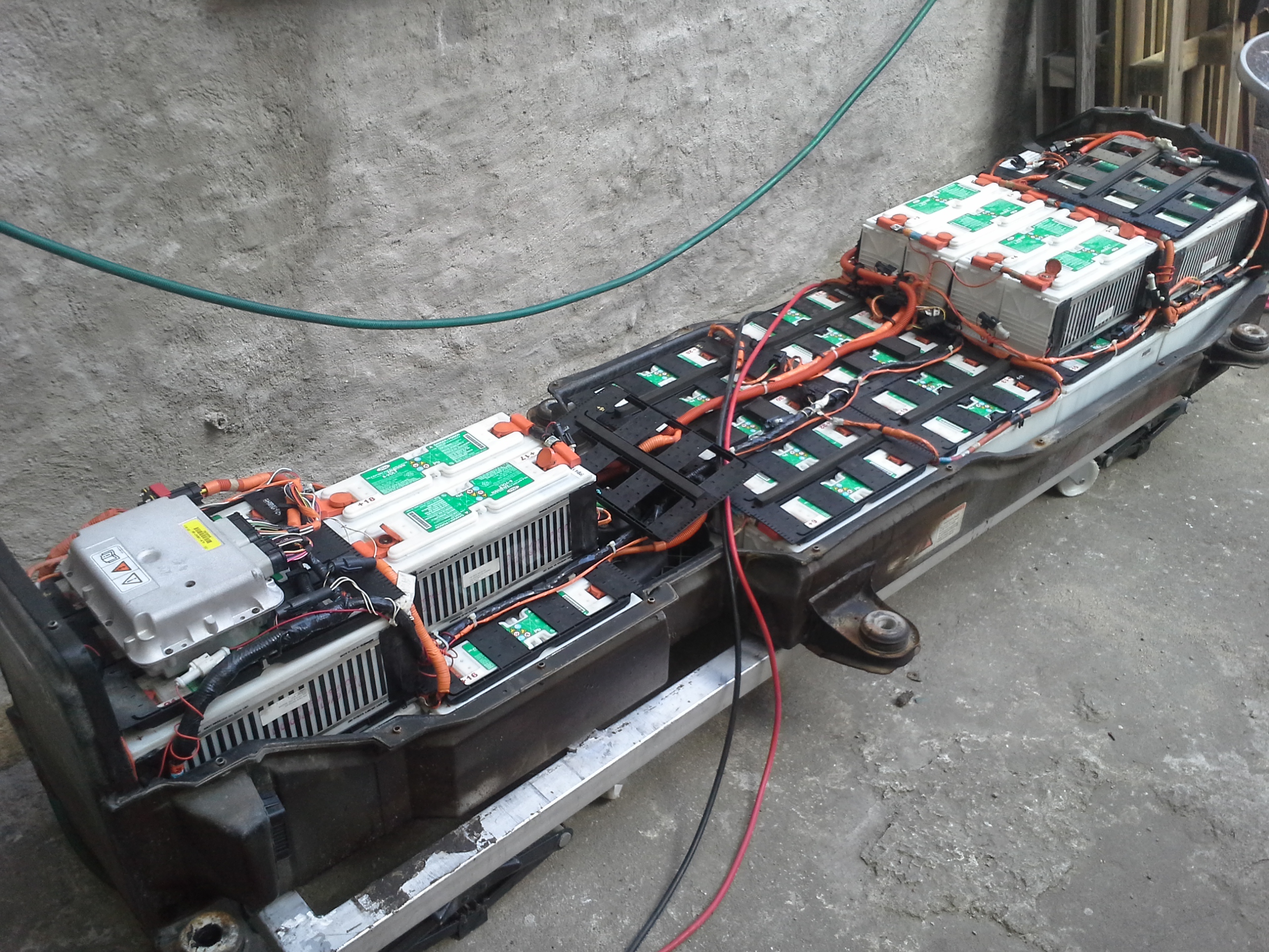

This is how it looks half way:

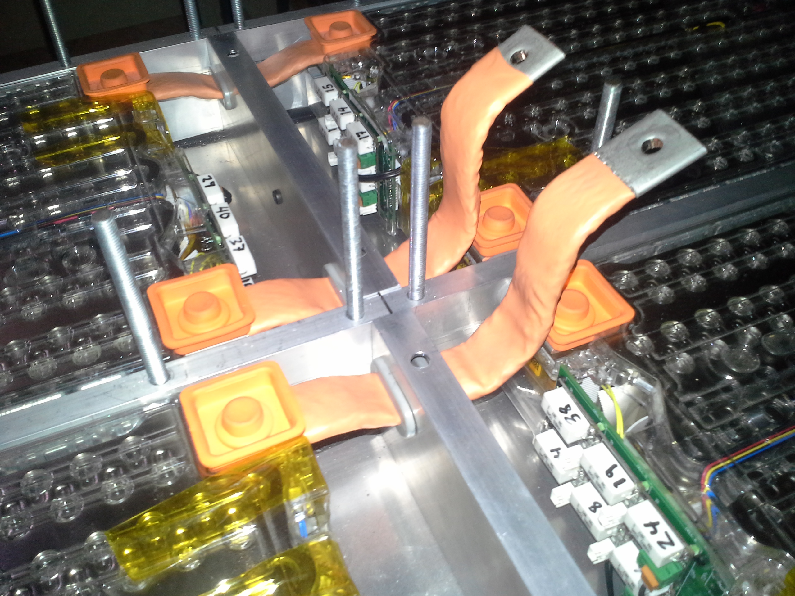

Details of the HV connections:

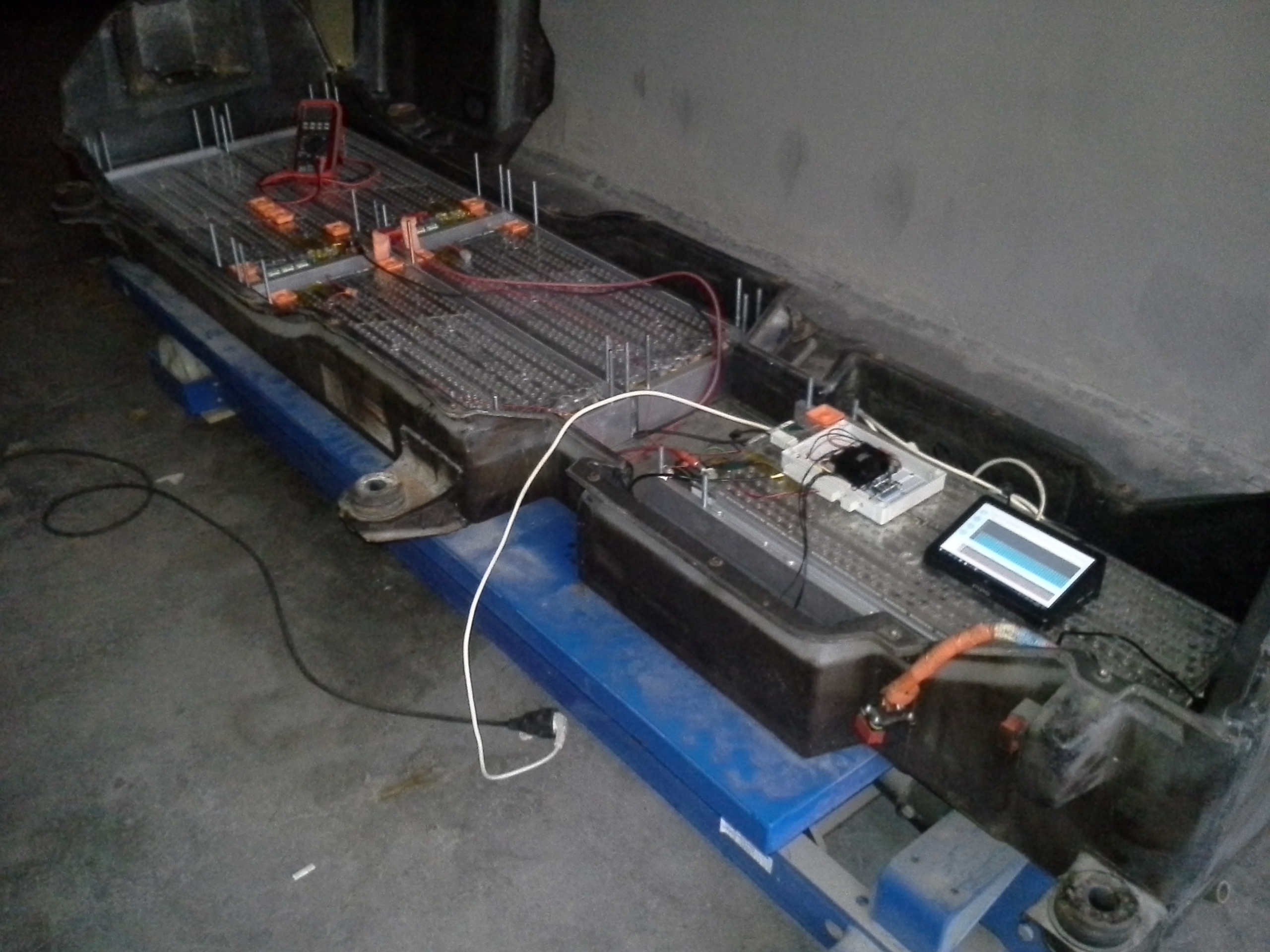

And almost finished:

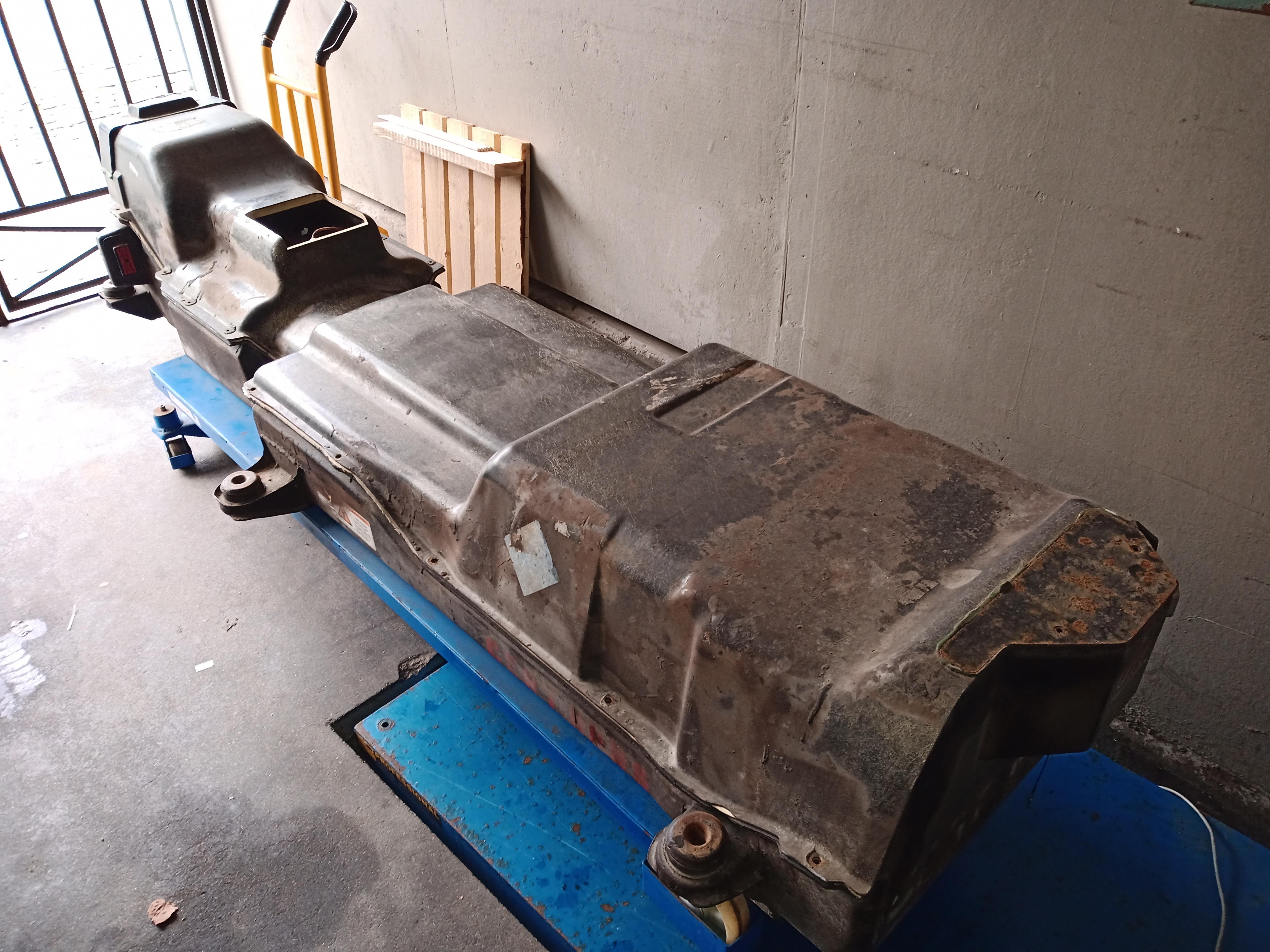

This is how it looks with the lid on.
And yes it will fit inside :)
Here you can see, there is room for more batteries. (Original led acid pack)
