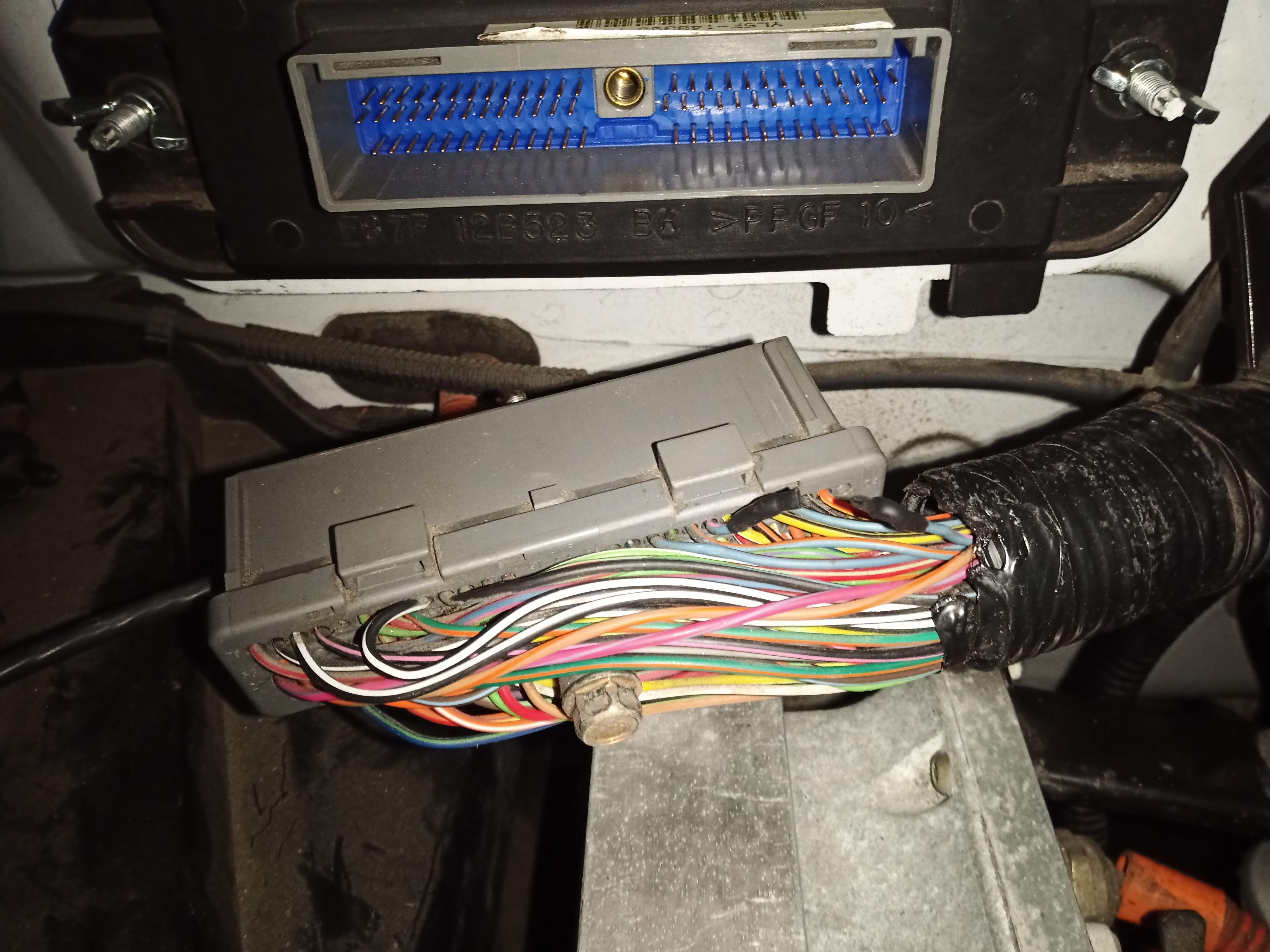

Don't forget this mod, if not you will burn your HV AUX relay after a while, because the IAA close the AUX to fast, before the BMS has precharged the AUX circuits.
IAA cut pin9 7 295 (LB/PK) wire, run/start.
And run new wire from the BMS to the IAA pin 97.

I have been thinking about your precharge relay/resistor issue.
Have you done this:
viewtopic.php?f=16&t=186&start=40#p6938
If not the IAA module could command the power steering and DC/DC to start and draw power before the HW aux relay has closed.
This will burn the precharge resistor after a while. (I burned mine this way)
This happens because the IAA module has almost immediate startup, much faster than the BMS!!
Now I start (ign. in) the IAA with the BMS relay output, and the IAA is closing the HV aux relay.
Have a look at the connections in Ranger_setup_new_8 - Schematic.pdf here:
viewtopic.php?f=16&t=186#p1869
I have done mods internal in the IAA module, then I don't have to route new outside wires.
I use pin 26 as the "new" IAA enable, and cut the outside wire from ignition pin 97. Also cut the "cut trace 26" and put a wire from "42 aux relay control" back to the "26 aux relay status" (this is so the IAA knows that the aux relay has closed)
NB! you don't need the diode at pin 26.
