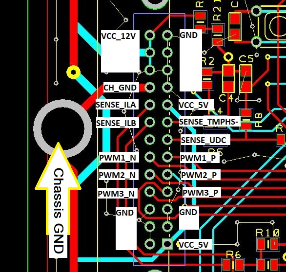

Re: Ford Ranger Inverter board Support Thread
Reuse of the TIM connector
This is one of the most challenging task, with building the inverter.

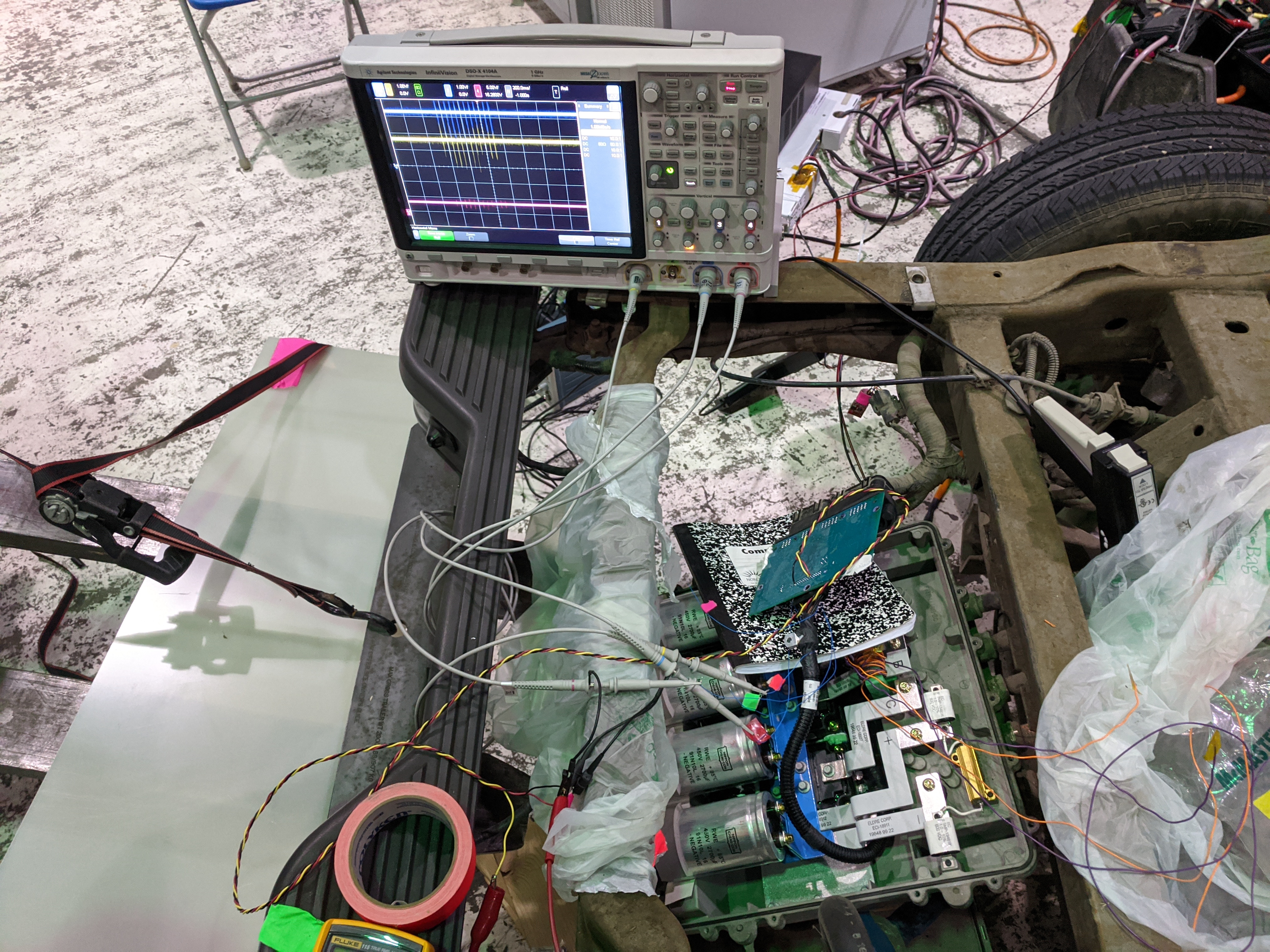

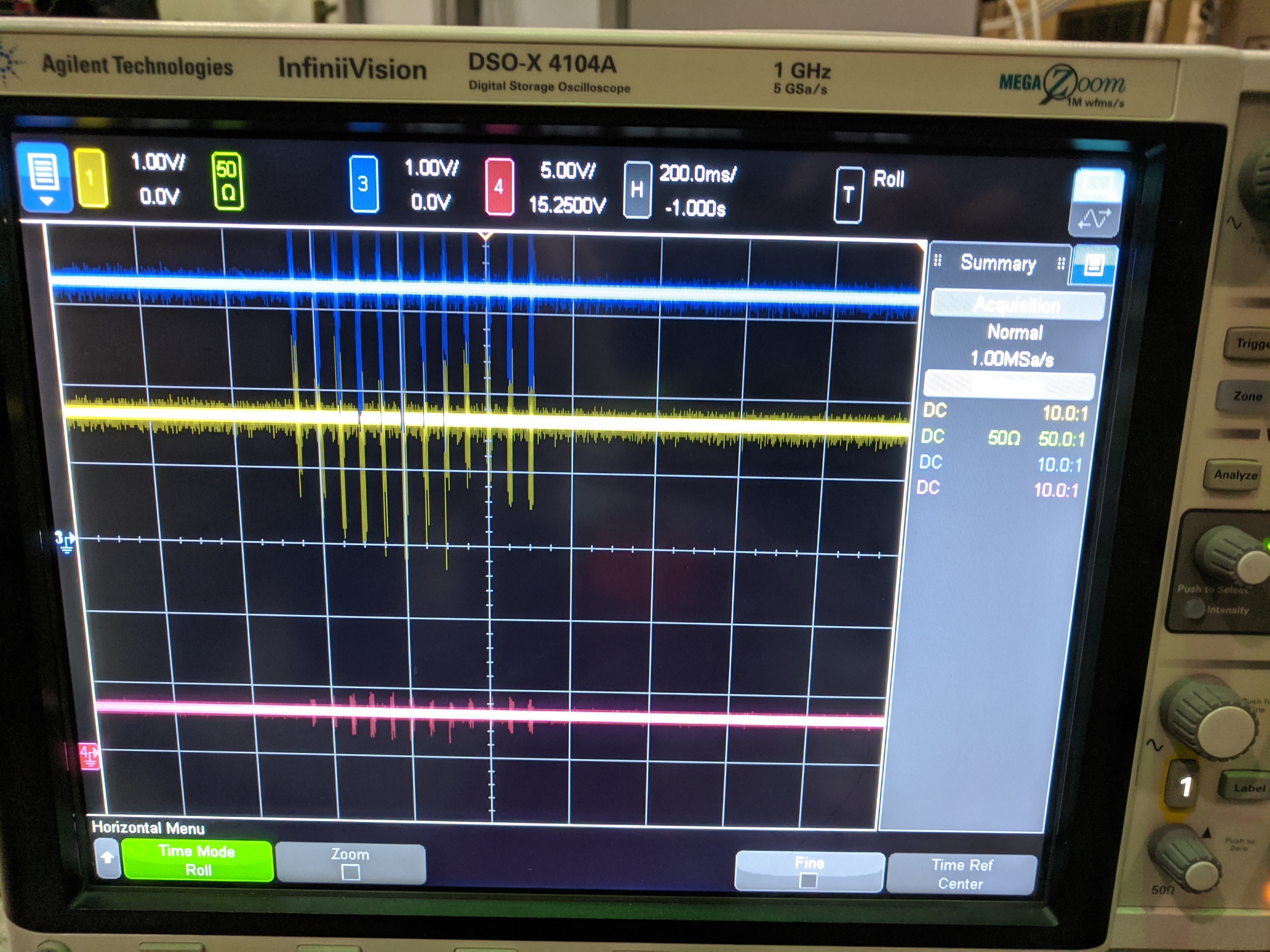

Hi Johannes,
Just wanted to add some details about our setup and the problem we're having:
- We've modified the ranger's contact box and verified that the TIM can control all the relays properly. Our power supply is connected to the contactor box and we've tried up to 300V limited at up to 1.5A. The TIM is able to successfully precharge. If we switch ignition to "start", the TIM will go into the "RUN" opmode and close the main DC contactor.
- With the brake depressed, we can shift into drive and see that the inverter begins switching and delivering some current to the motor. This was visible in the web interface and we verified using current meters on an oscilloscope (the 8.8kHz switching frequency was visible).
- As soon as we let go of the brake, the TIM will error out and open the DC contactors. The error is hardware overcurrent. Oscilloscope shows that switching stops suddenly, with no spikes in motor AC current or DC current to inverter.
- Both trucks are experiencing the same issue.
TIM telemetry notes (web interface screenshots attached):
- DC voltage measurement is working.
- Motor speed sensor is working.
- pot measures accelerator pedal correctly (ranges from ~830 at minimum to ~3600 at maximum).
- pot2 measures brake pressure correctly. Your documentation specifies pot2min and pot2max to both be 4095. Should we change this to reflect the actual min and max values?
- "dir" indicator reflects gear selector position accurately (NEUTRAL, FWD, or REV).
- tmphs reads inverter temperature correctly.
- "tmpm" reads motor temperature correctly.
- "din_brake" is 1 when brake is depressed, 0 if not
- "dout_prec" and "dout_dcsw" always seem to show 0 even though the contactors are being controlled correctly.
Additionally the motor oil pump doesn't seem to be running. As I understand, the oil pump relay is controlled by the same signal that controls the main contactor, which is working. Is there a harness or other modification we need to make for the oil pump to run?
Thanks,
-Johnny
We applied 300V at 10A and still have the same behavior of the truck opening the main relay when the brake pedal is depressed after ignition is and the gear selector is in drive. We are now going to try updating the firmware on the Joromy board.

Firmware version 4.71 sine.bin was able to update via wifi web interface. Test parameters from the attached sheet were entered into the configurations though there were a few parameter options on the latest firmware version that were not listed on the sheet.
We conducted the test mentioned in a previous post in which the brake pedal was depressed after the ignition is on and the gear is in drive. The main contactor opened again even after the firmware update and parameters updated.

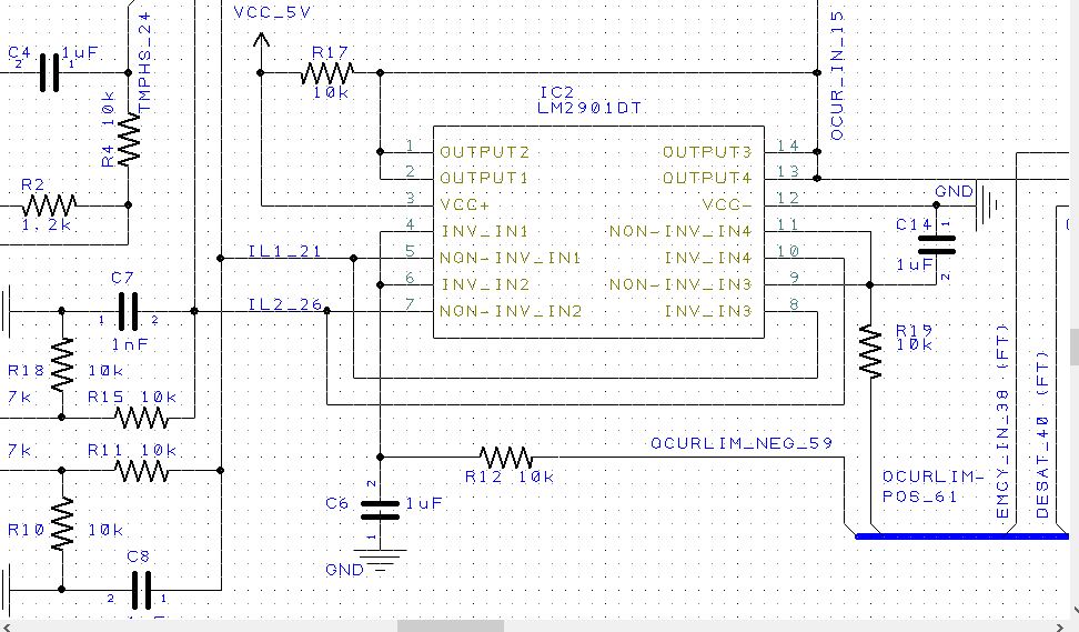

The oscilloscope in the photo captured a spike at the moment of the brake depression that may the source of the over current error. We were measuring one of the comparator circuits. I will update tmrw which circuit exactly we were measuring.
We also noticed similar spikes while switching the gear selector. It's possible the comparator circuit is picking up some noise that is causing it to send a possible erroneous signal which may seem like a current surge and opens the main contactors.

There is a bug in the board version that you have, that may be relevant. The chassis ground in to the board has one function, and that is to give ground to the gnd shield in the current sensor signal wire. You could solder a wire with ground lug to this screw hole in the board.
I have not done this in my truck or others, but it would not harm....
Chassis gnd is located here:
BUT more important!! if you don't have the braided ground strip that should go from inverter casing to truck chassis, you have no chassis ground at all, that is not good for emi noise
