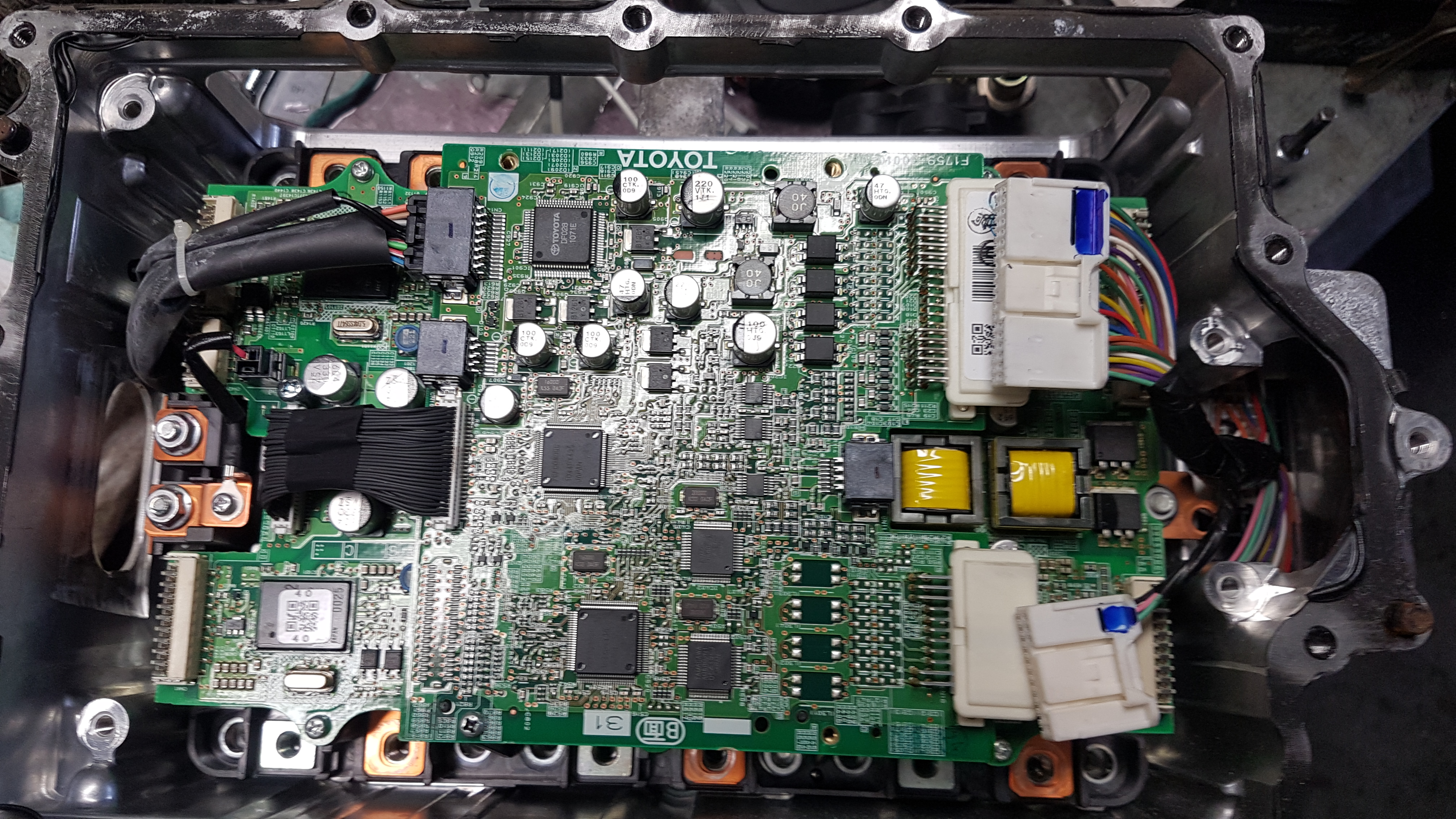

a few on here would of seen a post i made on the LS600h inverter thread saying i have repaired my 2006 gs450h inverter using camry inverter parts.
As brought up by Lwerewolf i think it was the Camrys have less igbts .
So not sure if this will give us less out put or drive the ones in there harder .
I also replaced the thermal paste on the heat sync (with krynought grizzly) its what all the overclockers use (in one test i seen the stock thermal past was running a chip at 70c and the krynought held it at 56c and it last longer )
I have now been driving this car most days hard acc off the line ,hard throttle passing from 90kmph and on long trips while monitoring inverter temps all seams well heres a quick how to .
Again all though this makes the car driveable it may have less power (i have not felt it )
For a RHD GS450H u need to buy an inverter out of an 2007-2011 camry (i think this may even work for the LHD but i can not confirm )

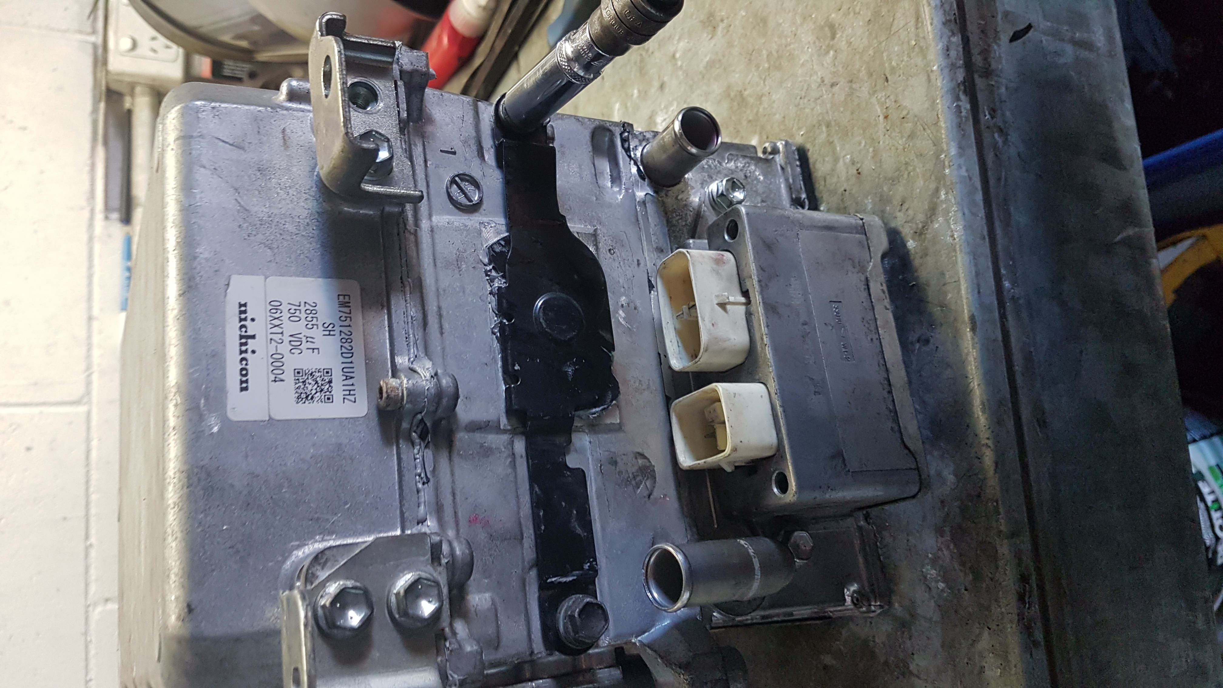

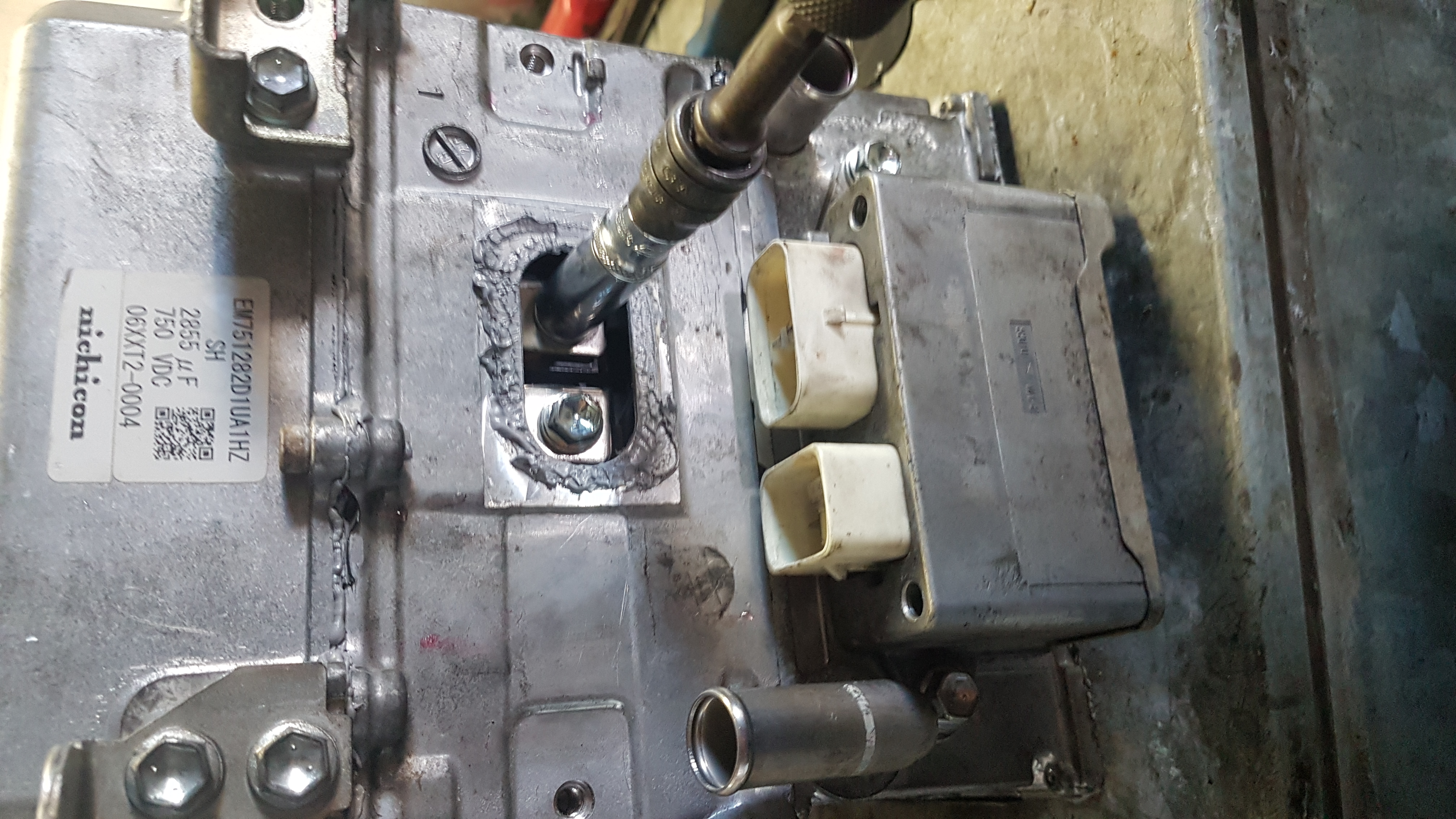

Now strip the lower half of the camry inverter off by
First removing 2x 10mm bolts on the coolant conection side holding the black plate on

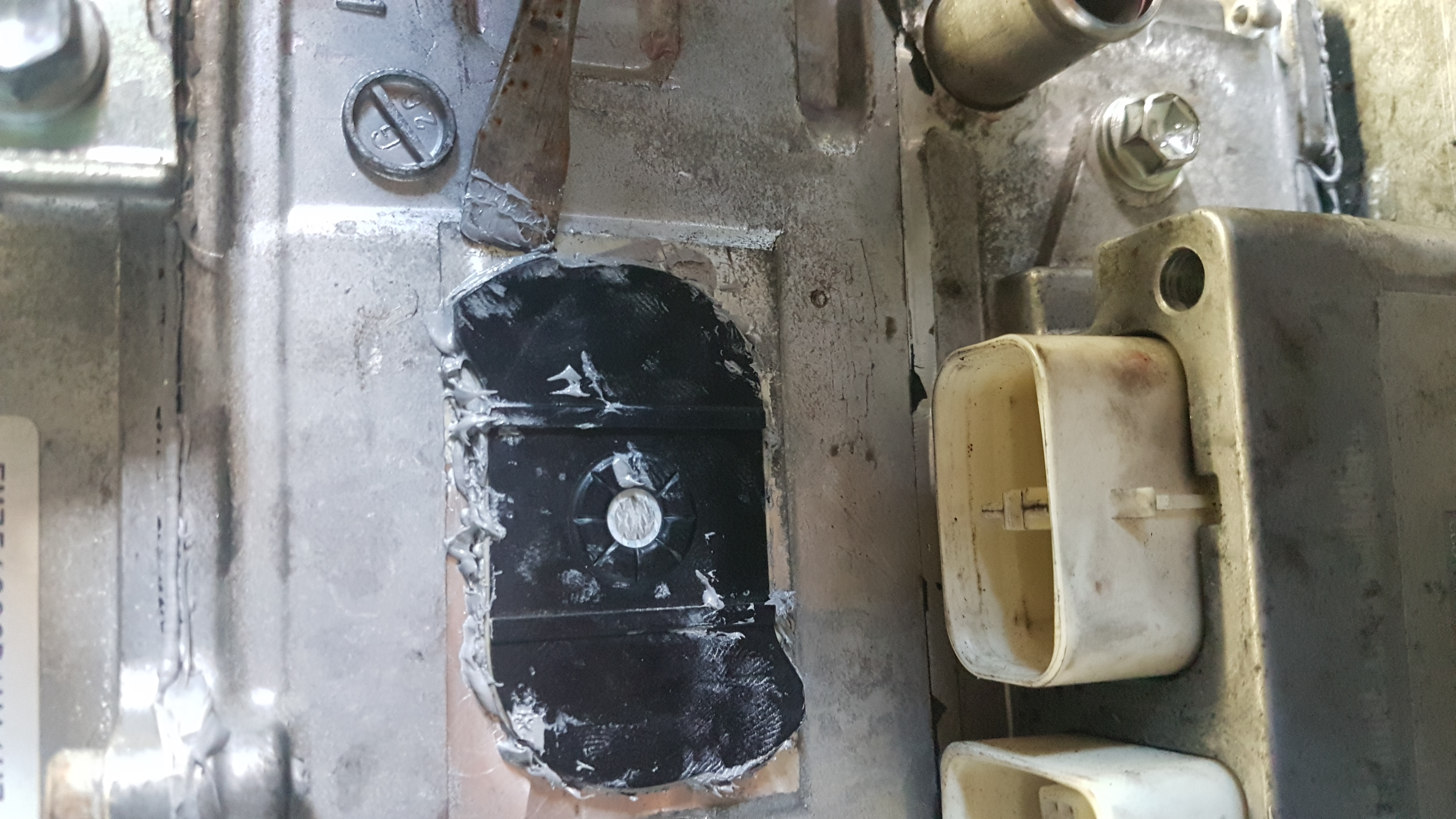

Then pry the black plastic plug out ( dont damage this to much u need it)
Undo the 2x 10mm u see in the hole
Now undo the 4mm allen bolts holding the lower half on

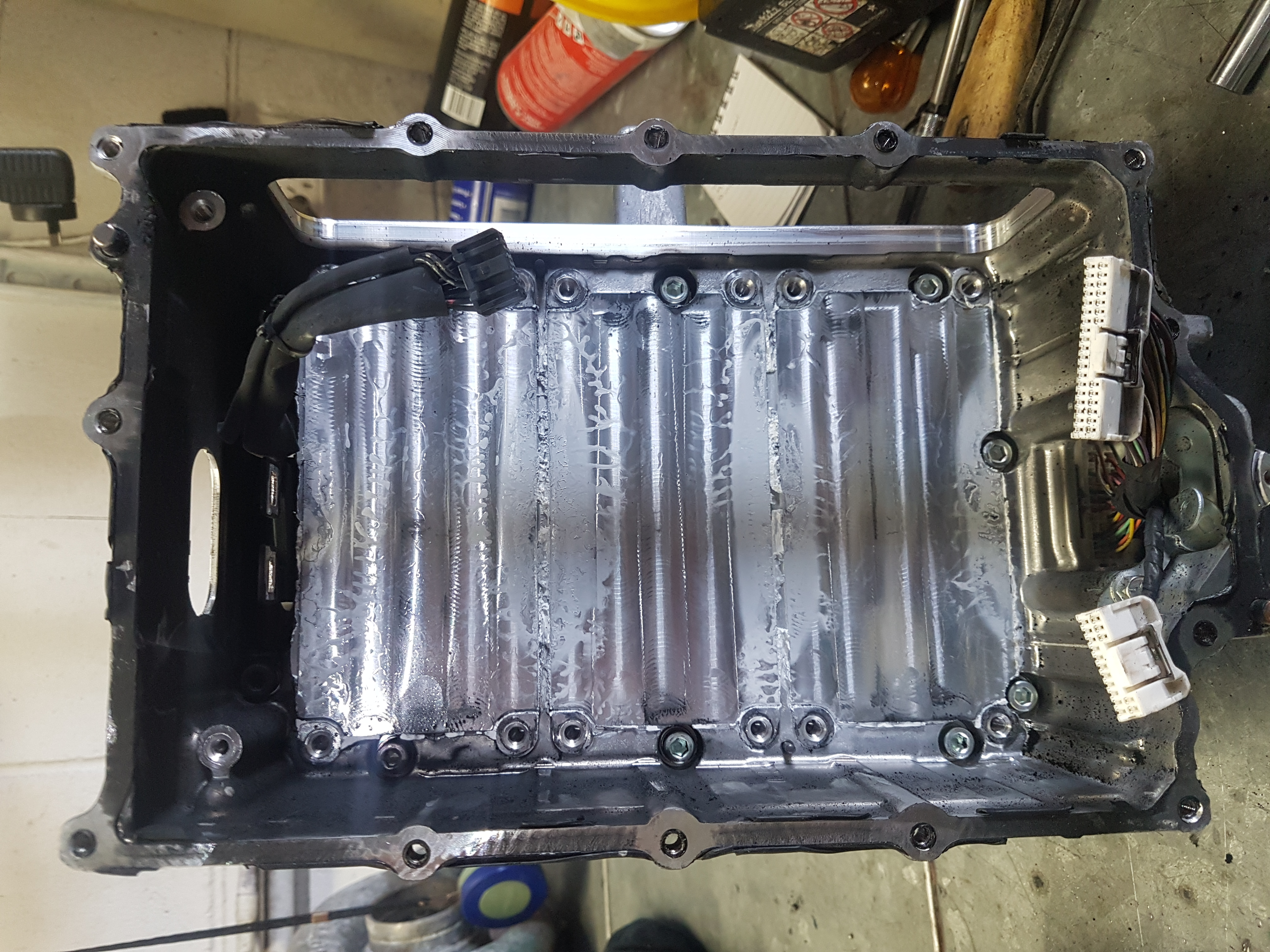

And very cearfully pry the base off (note the 2x dowels i start at the end with the coolant connections at the dowel) remove base

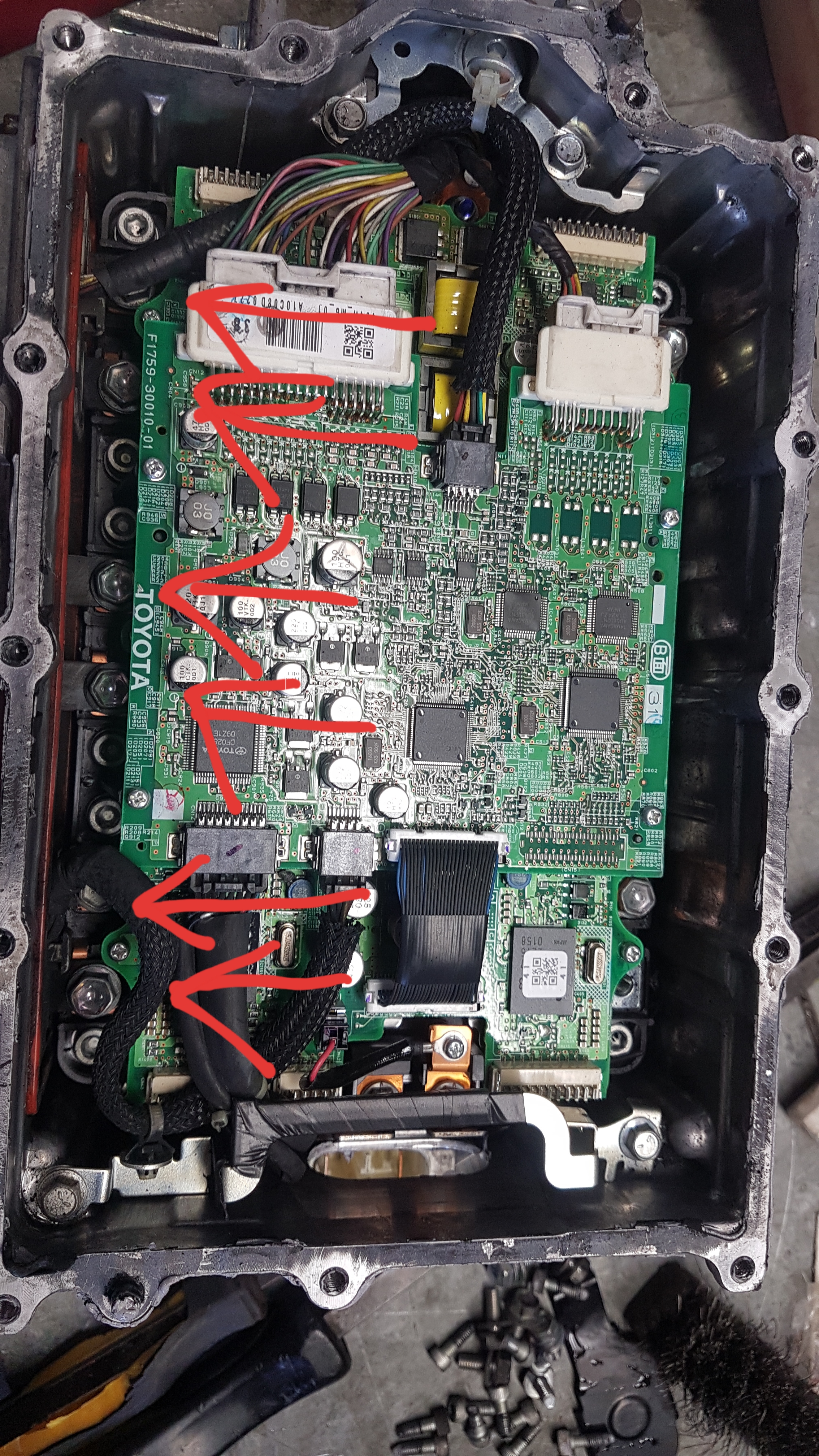

Remove the board with 4x screws and 6x plugs
Now undo the 4x 10mm in the side that hold the two motor/gen cables
Now remove the 6x 10mm bolts (ones with red arrows in pic) holding the motor/gen bus bar connectors and pry the connector and housing off

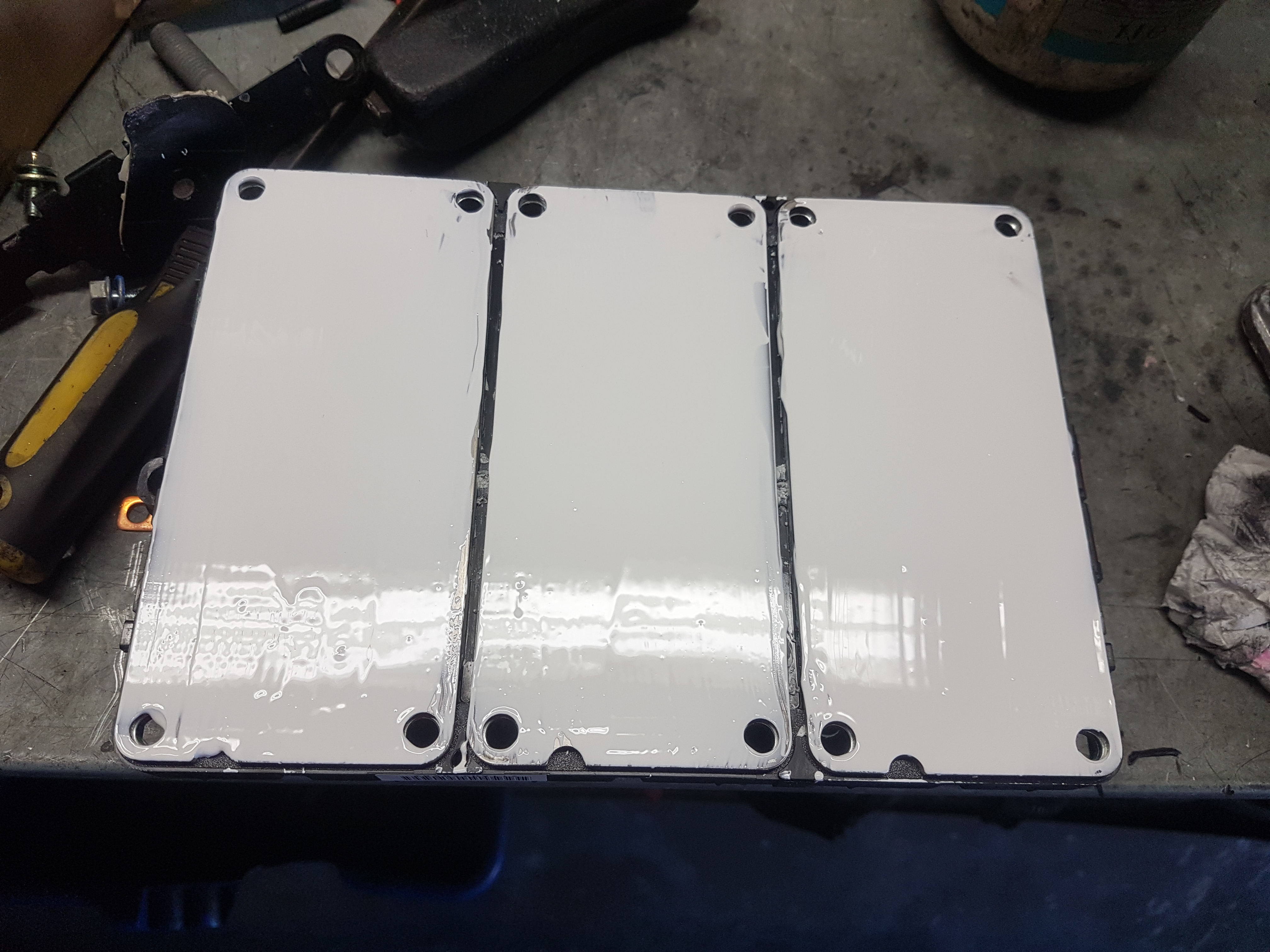

Now remove the 12x6mm allen screws holding the IGBTs to the inverter body
Now remove the IGTBs and soldered on board (this is all u need from the camry inverter)
Now strip ur GS450H inverter same as above
Remove the board with 4x screws and 6x plugs and keep you need to refit this

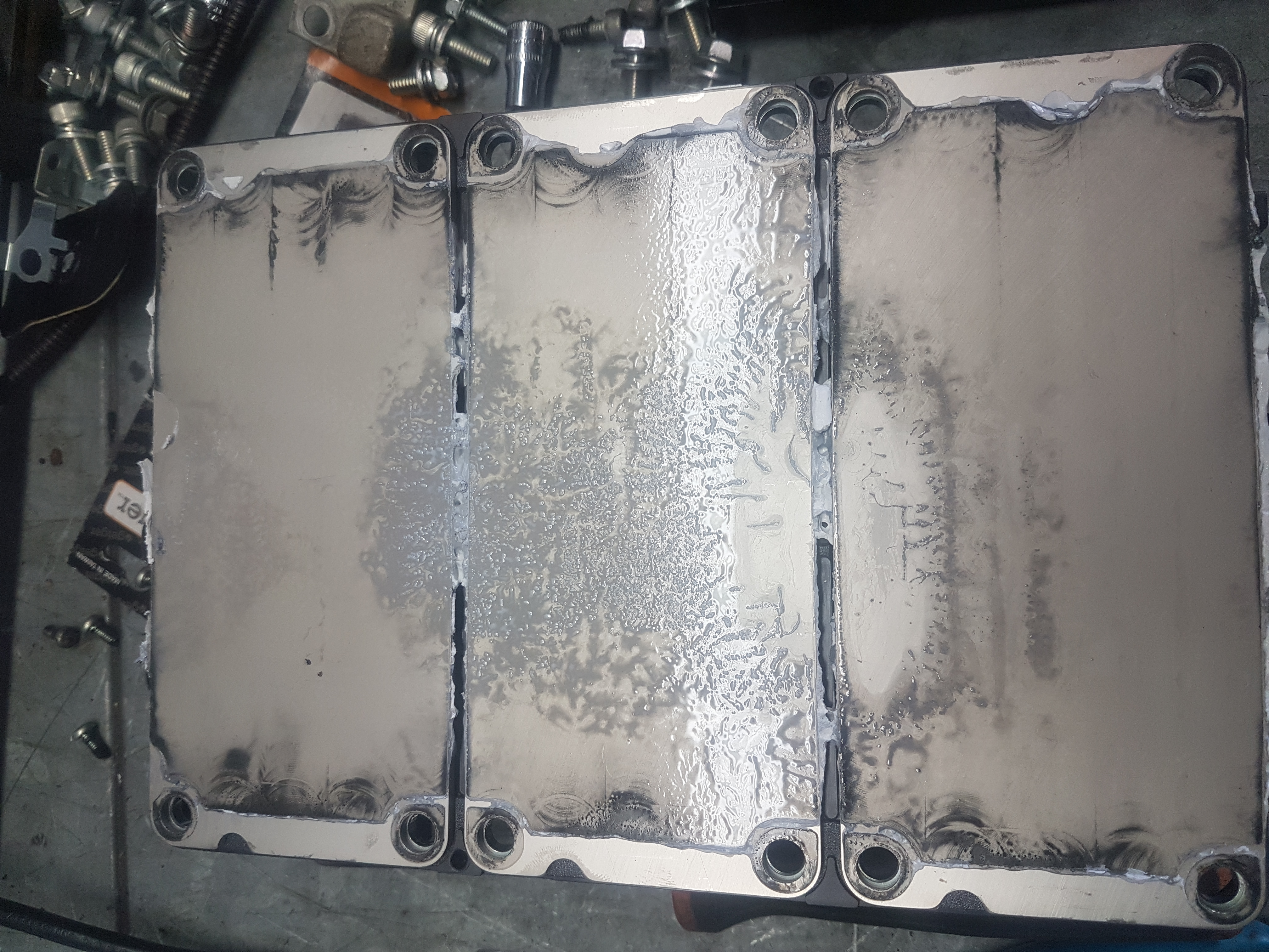

Now remove the IGTBs and soldered on board (if u look under the board you will see the blowen IGBTs) and discard
Clean off all the thermal paste off of both inverter and IGBTs
Reapply a very thin layer of thermal paste to the IGBT side (if u leave the paste in a cup of hot water it is easyer to work with)
Now fit the IGTBs and soldered on board from the camry to ur GS450H inverter in the reverse of above
Refit the board out of the GS450H that was held on with 4xscrews and 6x plugs ( if u use the camry one ur car will still drive but it will use the engine more often ICE starting will be more noticeable and it will kick out of reverse if it uses to much power )
Reasamble the lower half of the inverter with UTV sealant
Blown GS450h hybrid inverter repaired (with cheap camry inverter parts)

I am about to embark on a GS450H inverter repair. So far I have followed the lexus_tech diagnostics using techstream which revealed fuse14 (IGCT No.2) a 7.5A fuse keep blowing. Is this normal for a blown IGBT or do I perhaps have an issue on the logic board ?

Hi, nice thread. A question for you. Where you marked, does this means that is where the IGBTs are, or you are just pointing at the PCB, where they are mounted?
