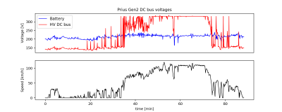

Here's a plot of the DC bus and battery voltages as reported by the OBD interface that my wife made from a 1.5h drive in her Gen2 Prius. Interestingly, the DC bus voltage is actually reported to be lower than the battery when the car is driving very slowly. These data are from stop 'n go traffic in downtown Stockholm and rush hour on the motorway. No chance for pedal-to-the-metal here. Is that the only difference to Damien's experimental values or is the OBD lying??

Very nice, but are you sure there isn't a scaling error? Voltage after a boost converter can never be lower than before. input -> inductor -> diode -> output.

That would make sense. The numbers are straight out of the app Car Scanner (v. 1.67.9 carscanner.info) and the effect is the same when displayed in the app. I'll try to see if we can get some full throttle data to compare the highest voltages observed on the bus directly with the numbers in Damien's video. The battery voltage at least seems realistic.

In the plot, at low speeds the "Battery" and the "HV DC Bus" looks identical in shape.
Max "HV DC Bus" voltage at speed is about 350V in graph and according to Damiens video it is 500V.
If you scale the "HV DC Bus" voltage to the "Battery" voltage at low speed you end up with 500V at high speed, as per 350V (max HV DC Bus) x 200 (battery) / 140 (min HV DC Bus) = 500V.
A scaling error seem very likely.
