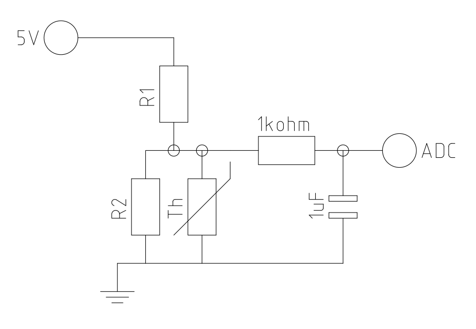

To my knowledge there is today no support for the motor temperature sensors used in Toyota/Lexus motors in the inverter firmware.
I have not found any specifications from Toyota but some information can be found on this forum as well as other forums that the sensor used seem to be a 47kohm NTC thermistor with a beta of around 3900K.
According to my own very crude measurements this seem to be the case for the MGR as well.
It makes sens to me that Toyota would use the same sensor in all motors.
To make this sensor useful some hardware is required. To make greatest use of this sensor it should be made accurate at temperatures of 100-170 degree C and not at all important below 50 degree C.
My circuit suggestion:
Where R1=3,3kohm and R2=5,6kohm. Th is the sensor.
This gives a non-linear detection but provides accuracy where needed.
Calculations can found here:
Toyota Motor Winding Thermistor Data.ods
(61.33 KiB) Downloaded 222 times
Please comment what your thoughts are. What should be different and why?
When we can agree on a good solution this then can be implemented in the HW and SW.

Now added to new firmware but with R1=1,2kohm and R2=2,2kohm.

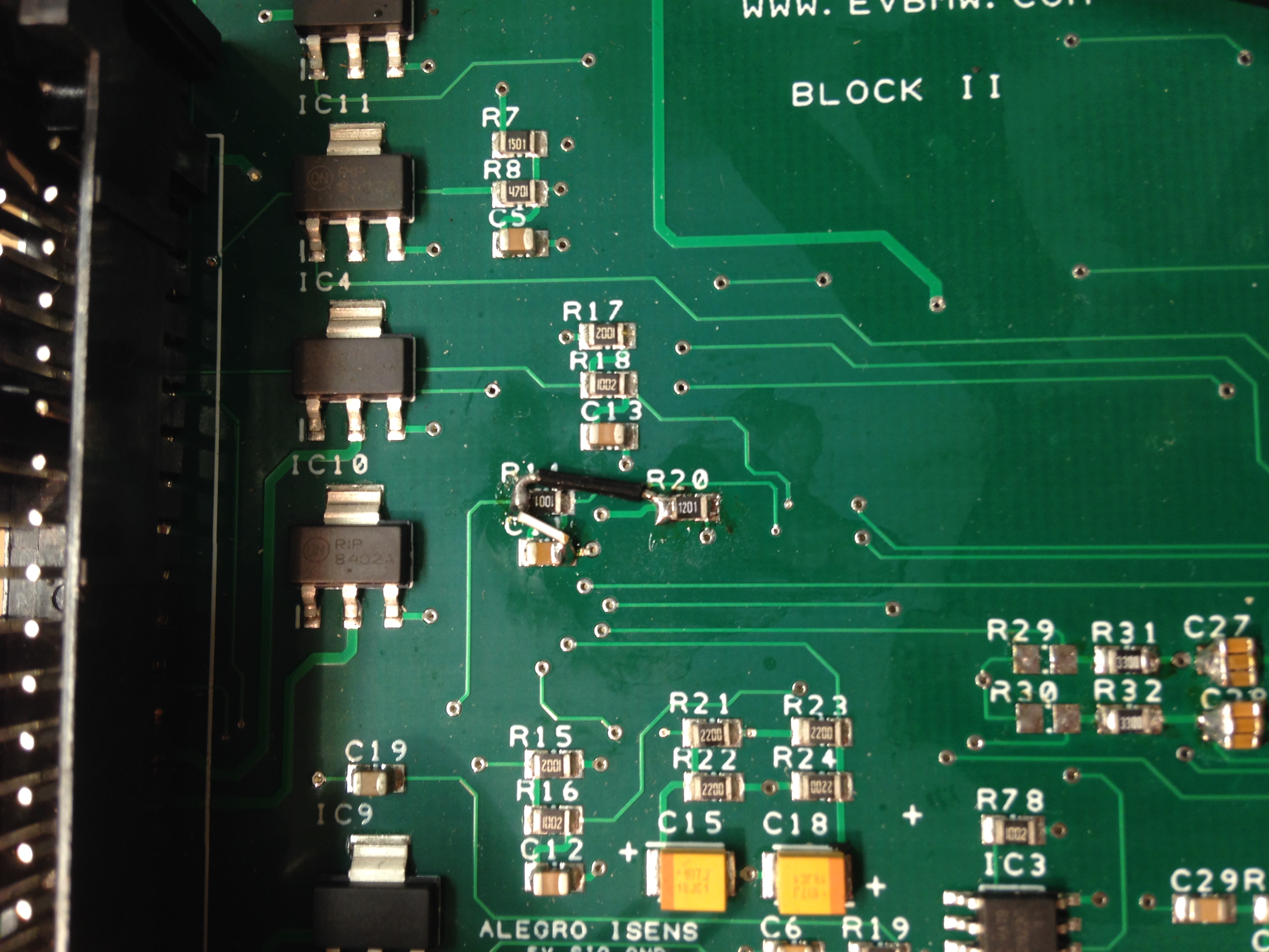

Will post picture of how I did the mods needed on my Yaris board when it's done.

I have now done the mods to my Yaris board and tested with the motor temperature sensor. Seems to give reasonable readings.
A picture of how I did the mod to my board.
R20 changed to 1,2kohm.
A resistor of 2,2kohm from MG2_STATOR_T2 (R14) to GND (C11).
A wire from MG2_STATOR_T1 (R20) to MG2_STATOR_T2 (R14).
Connecting temperature sensor from MG2_STATOR_T1 or T2 (J1:24 or J1:23) to GND (any available GND pin will work)

BTW on the Prius Gen2 SMT board "R1" is R21 and "R2" is R16. So R21 must be swapped for 1k2 and R16 swapped for 2k2. And also MTEMP- is shorted to MTEMP+. Sensor connects to there and GND.

ZooKeeper wrote: Tue Nov 03, 2020 11:18 pm Much better, maybe some tweaking with sensor ground resistance ;)
4k7 = 75*C (low by 15*)
2k2 = 108*C (nearly dead-on :) )
1k0 = 145*C (high by 15*)
470 = 183*C (high by 17*)
047 = 200*C+ (saturated)
010 = 200*C++ (saturated)
Why do you want to tweak it? To me, there is no need to have a accurate motor temperature reading below 50degC.
Also, be careful as the resistor values are selected to feed less than 3,3V to the STM32, even if no sensor is connected.

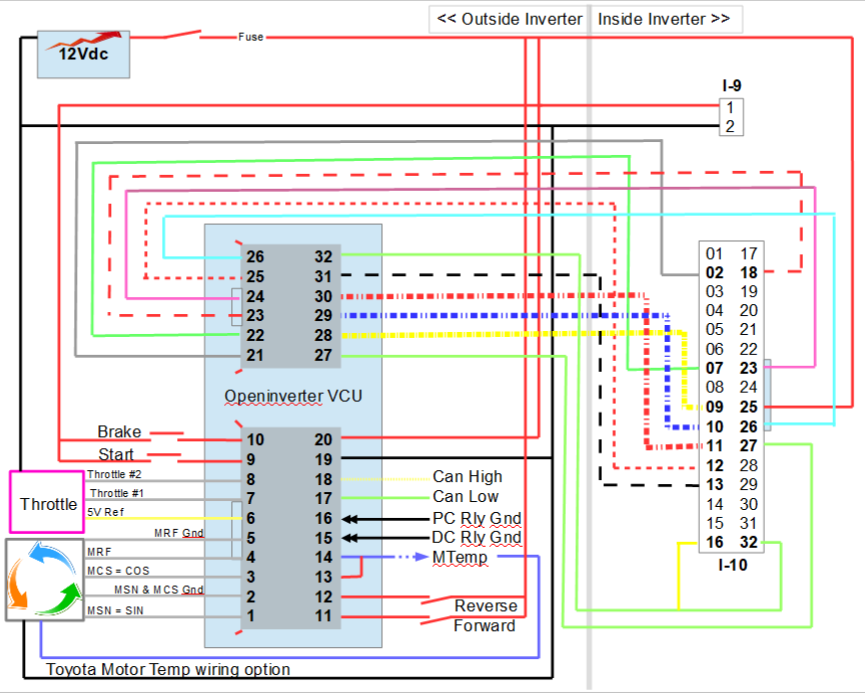

I re-drew the VCU diagram I made to incorporate the Toyota Motor Temp Sensor Wiring Option, which I have attached for reference.
Disclaimer: This is NOT for non-Toyota motor temp sensors and has NOT been validated on all Toyota hybrid motors.
VCU > Toyota MTemp
VCU > Toyota MTemp
