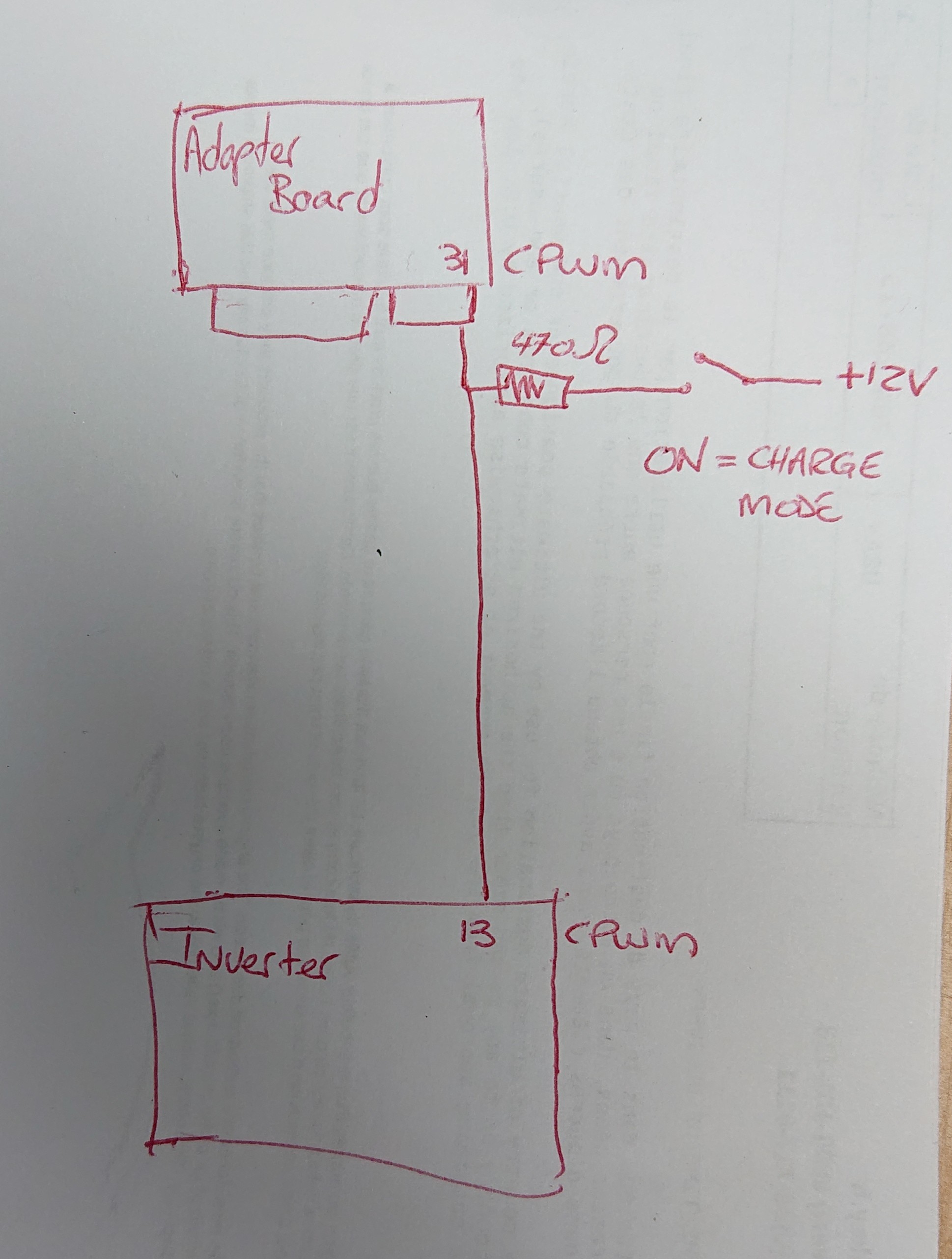

Hope everyone is OK with me setting up a new Topic for using Prius Gen 2 and Adapter board in CHARGE MODE.
Latest Update software means Charge Function requires BUCK MODE when using MG1 as rectifier and have battery connected to stock battery input
So if I understand correctly:
1 - FORWARD and REVERSE signals HIGH (inverter in RUN Mode) AND HV DC contactors OPEN - No connection to 200V battey.
2. CPWM with 470R to switch Charge mode - HIGH
3. Precharge DC to rectified AC (One 400W halogen light for the moment) with connections as mentioned in previous post.
4. Set duty cycle (40% = 320V down to 200 V) (I noted, the higher the duty cycle, the higher the voltage)
5.Close DC contactor and AC Main contactor at same time. (To be confirmed)
For the "switch to PI charge controller", this would be the regulation of current and/or voltage into the Battery Pack?
From my basic automotive electrics undertsanding, If the potential is different between two batteries, there will be a transfer of current to balance each other. The greater the difference, the greater the current flow.
So if I set duty cycle "a bit higher" than pack voltage, I will have a current flow towards pack. If I set it to around 10 Amps MAX (Ampmeter on HV Cable), I could monitor it over a few hours of charging. (the simple way until BMS knowledge is improved)
From what I understand, using Johu's existing Wiki diagram, and previous discussions, this would be the correct wiring set up to the Inverter for CHARGE MODE.
This is my understanding, and hope to post on the Wiki (If forum agrees) IF it's correct!

This is what I understand from set up procedure instructions
"Connect CPWM to 12v via 480 ohn resistor for Charge mode... Looks correct?
Been thanked: 1913 times
Re: Prius Gen2 Adapter Board for CHARGING
Yes

OK, I manage to get Boost Mode (no Ac connected as yet)
MacGyver precharge system in place.
Have 12 volt battery connected to HV DC side of inverter.
Next stupid question... How to set Duty Cycle in Parameters?
