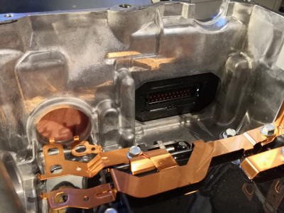

Hi Damien I can model up the PCB holder /sealing unit and get it 3d printed this weekend if you send me dimension for the opening in the inverter and PCB. Ironically I bought the printer to make up the high voltage connector to seal around the brass HV lugs on my is300h inverter( I have HV orange filament).

Is there any need to connect the negative battery cable through the weird hole? I think you only need one brass post there to connect the positive and use Toyota's intended terminal for the negative.

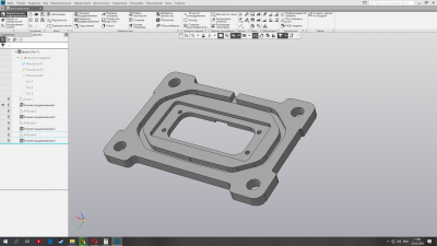

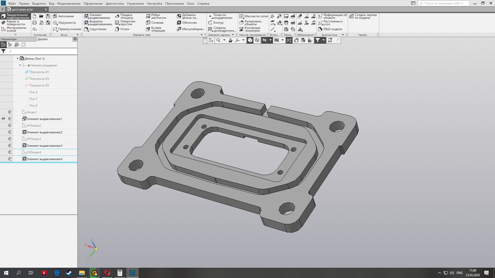

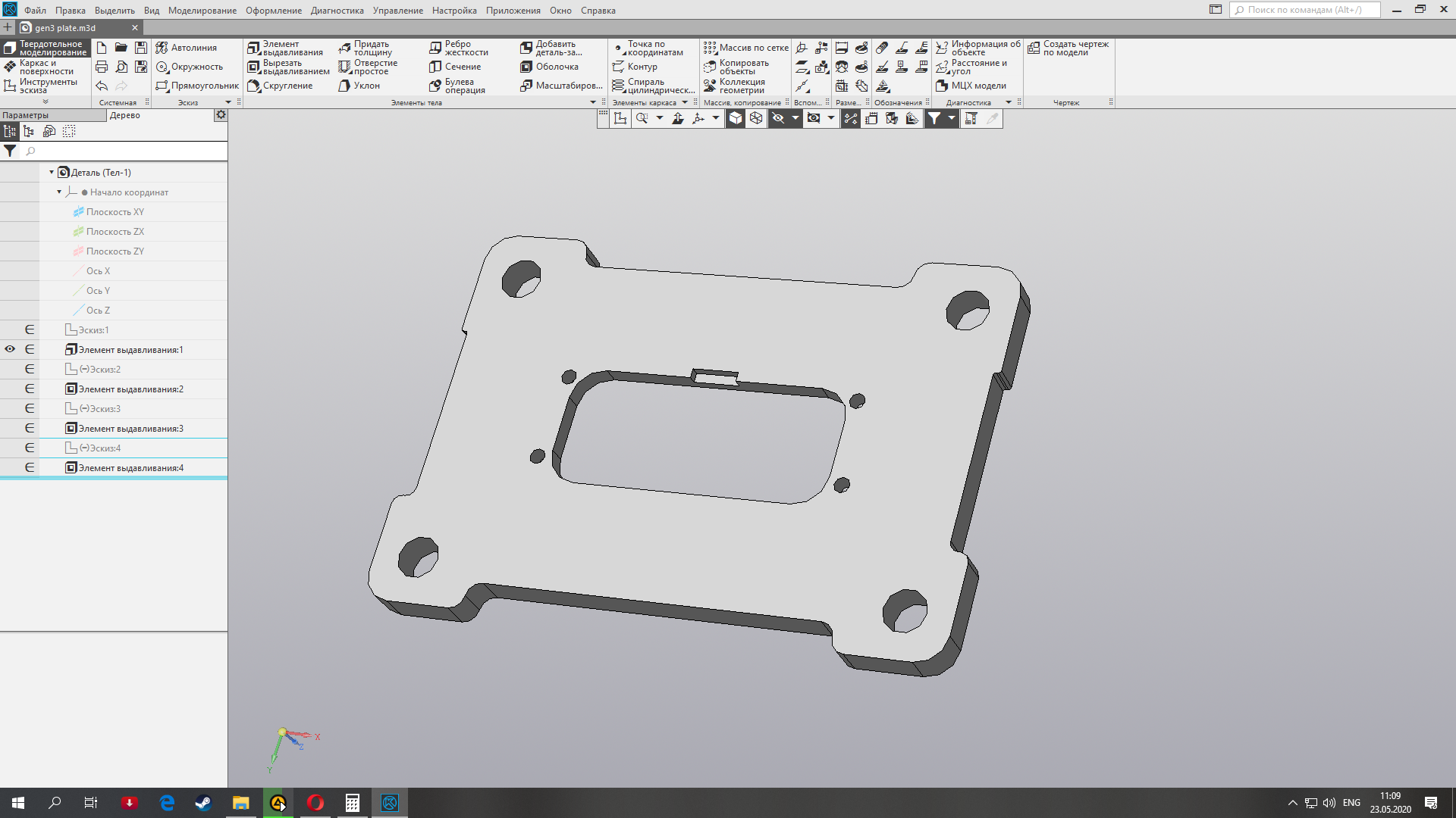

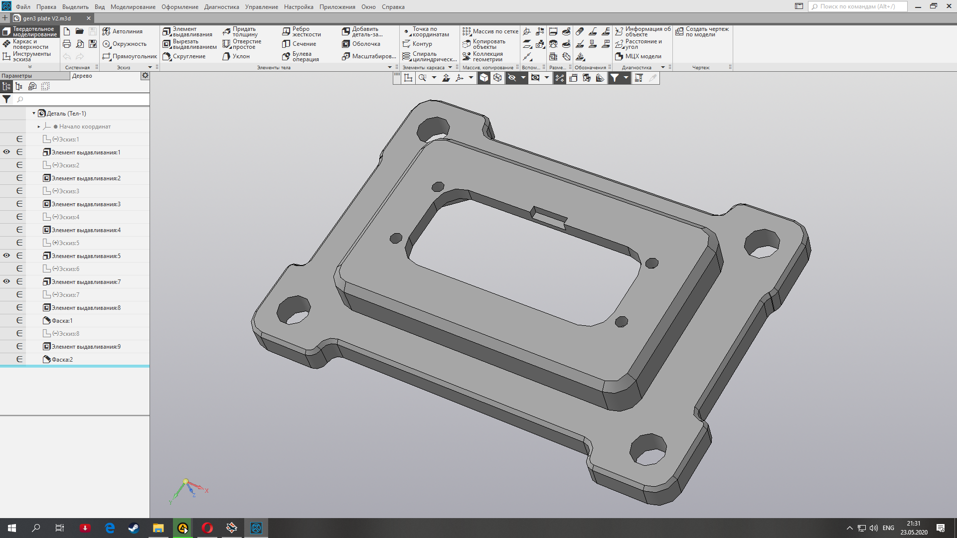

In wich format do you guys need a 3D model for a printing?
I believe for this design we gonna need 90 degrees angle ampseal connector and plate placed horizontally.
Attached archive with *.stl file. There is a little mistake on picture, it is corrected in 3D model in archive.

Also I want to point out that I might missed the sealant groove dimensions. If anybody who will print it and place a sealant inside, let me know if it is an misalignment. I'll correct it.

Brilliant. Thanks Damien. Resistors ordered, along with a finer tip for my soldering iron, some of that TechSpray braid, and some tweezers.
Konstantin - thanks for that 3D model too - I was planning to do that but you've saved me a job!

This plate, I've designed is literally a plate of plastic. It can be fabficated with simple drill and dremel. Too bad, I've got no ampseal socket on hand, and If I order one abroad, it will arrive too late for design testing.

I have an Ampseal handy. I'll throw it on the printer now and let you know.konstantin8818 wrote: ↑Sat May 23, 2020 11:42 am This plate, I've designed is literally a plate of plastic. It can be fabficated with simple drill and dremel. Too bad, I've got no ampseal socket on hand, and If I order one abroad, it will arrive too late for design testing.

Much appreciated!bobby_come_lately wrote: ↑Sat May 23, 2020 12:04 pm I have an Ampseal handy. I'll throw it on the printer now and let you know.

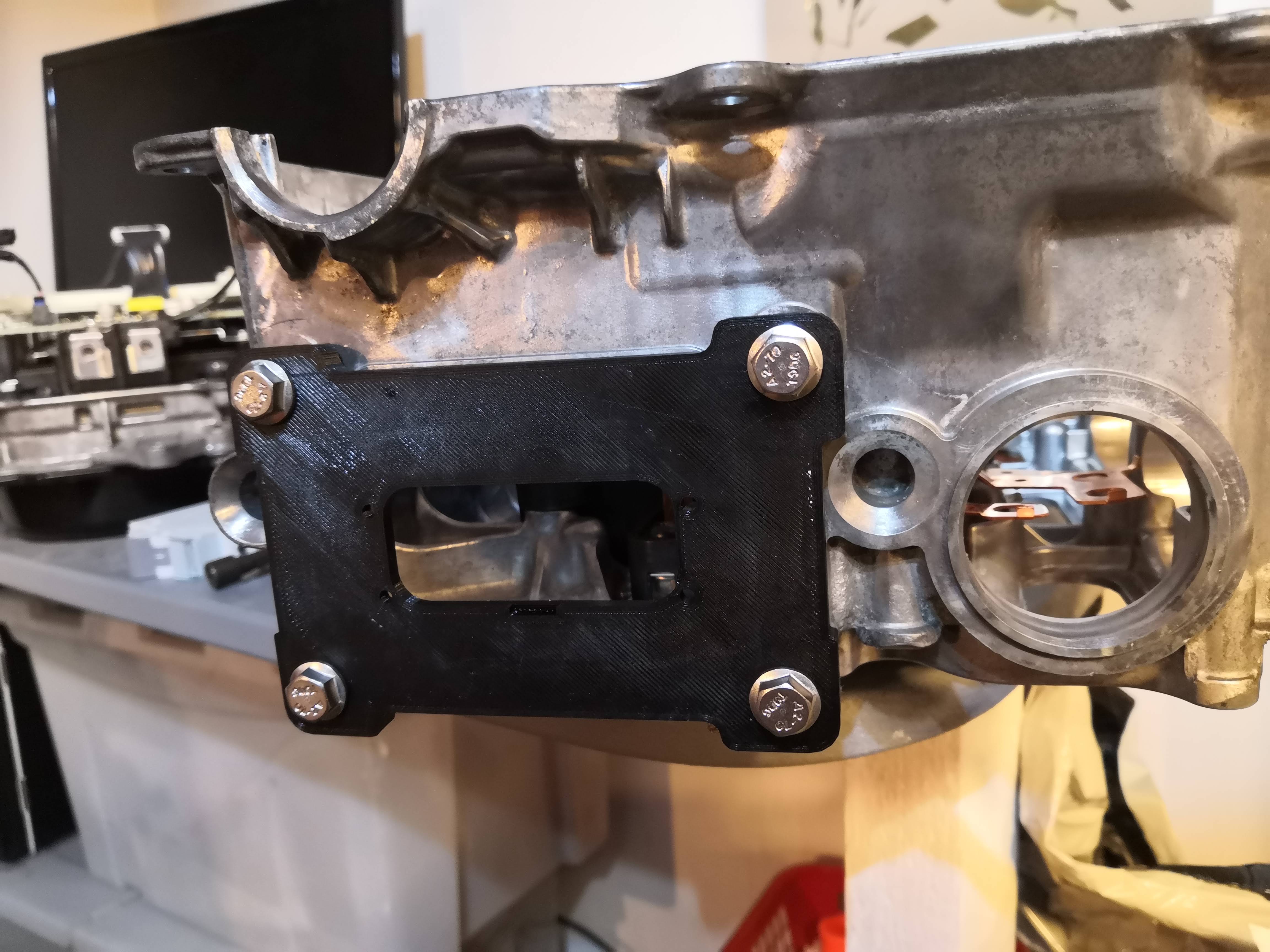

Doh! I am, as we say here, a numpty. Printed it out and realised I only have the Ampseal plug - the socket hasn't arrived yet.
Anyway, it looks good in situ (assuming I have it the right way around?) and the plug matches up very well to the hole. As soon as the socket arrives I'll test that.

Wrong way=) groove must contain a red sealant and face towards inverter=)
Also socket must go thrue plate like this:

Aha! I did wonder. Reinstalled the right way around, with the seal.

So how it sits? Does it fall off or hangs in? It is pretty soft so I believe when you tighten all bolts there is no gap left between plate and casing?bobby_come_lately wrote: ↑Sat May 23, 2020 4:06 pm Aha! I did wonder. Reinstalled the right way around, with the seal.

Fits fairly well. But printed in PLA there's a bit of bowing around the middle from the pressure of the sealant ring - see picture. I wonder if it would be better in ABS/PETG? Or whether it's worth stretching the mounting holes out a fraction of a millimetre to provide some tension?konstantin8818 wrote: ↑Sat May 23, 2020 4:14 pmSo how it sits? Does it fall off or hangs in? It is pretty soft so I believe when you tighten all bolts there is no gap left between plate and casing?bobby_come_lately wrote: ↑Sat May 23, 2020 4:06 pm Aha! I did wonder. Reinstalled the right way around, with the seal.

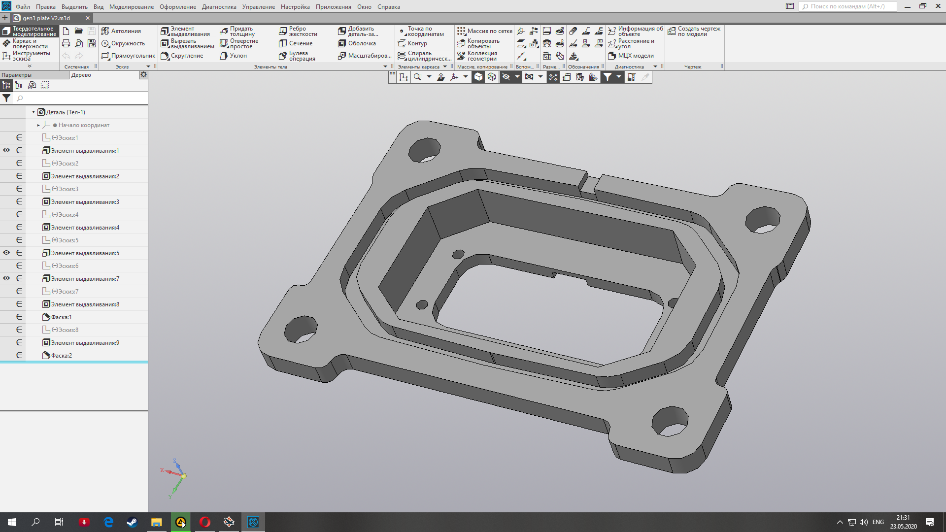

Maybe when ampseal socket will be screwed to plate, it will straighten it. Or maybe oppositebobby_come_lately wrote: ↑Sat May 23, 2020 5:38 pm Fits fairly well. But printed in PLA there's a bit of bowing around the middle from the pressure of the sealant ring - see picture. I wonder if it would be better in ABS/PETG? Or whether it's worth stretching the mounting holes out a fraction of a millimetre to provide some tension?
Anyways, I've made second version: with 10mm offset to make it more sturdy. Looks almost OEM
